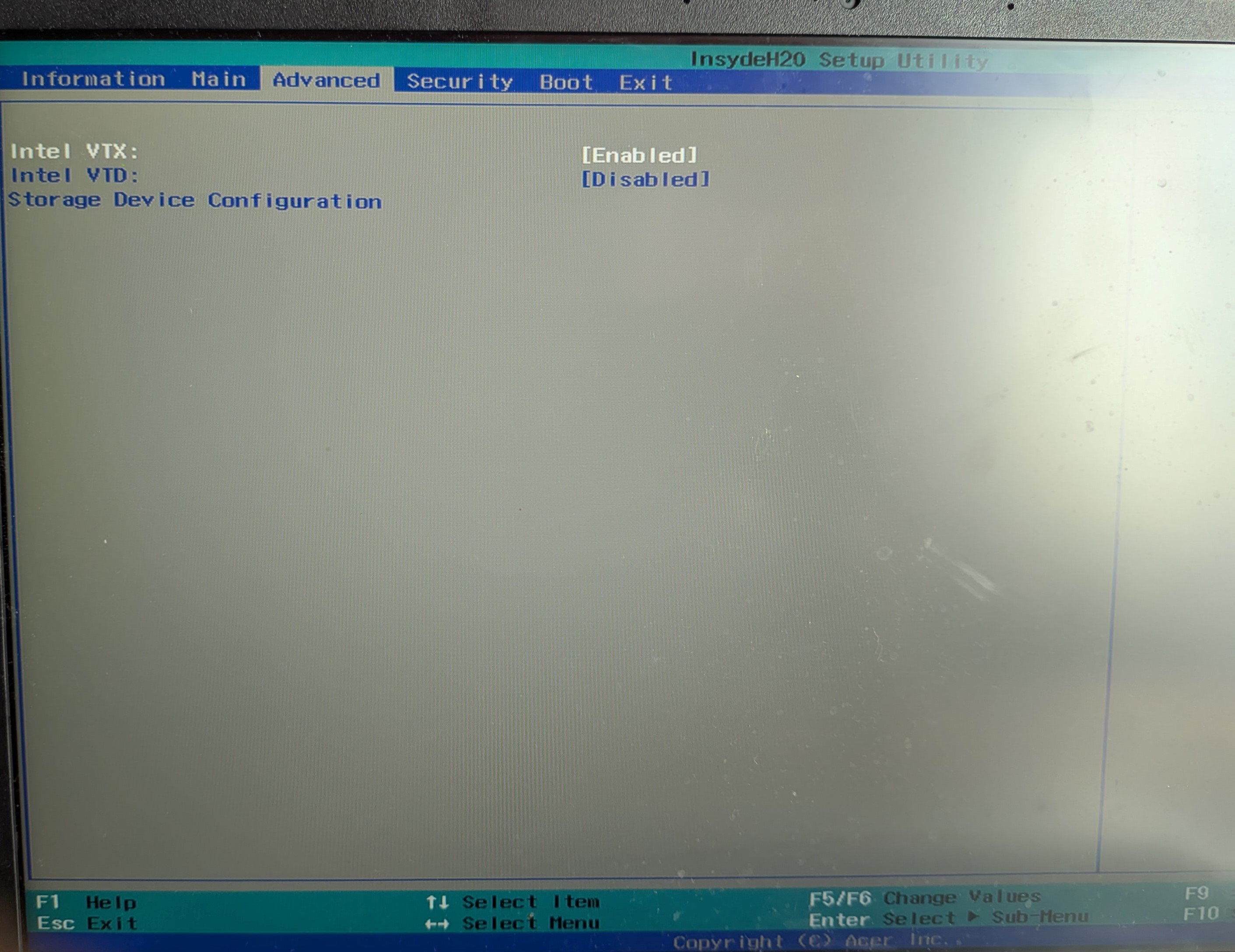

spakk Posted 17 hours ago Share Posted 17 hours ago 1 hour ago, spakk said: Can you disable the E-Cores in BIOS? Check here: Advanced → CPU Configuration → E-Cores → Disabled Or: Intel Thread Director → Disabled Let's do another test. All about OpenCore BIOS remains unchanged, do not disable E-Cores or Intel Thread Director. The entire configuration runs via OpenCore: SSDT-PLUG-ALT.aml for Alder Lake Hybrid architecture CpuTscSync.kext for TSC synchronization CpuFriend.kext for frequency management RestrictEvents.kext for CPU information Boot args: „-v keepsyms=1 debug=0x100 -wegnoigpu -revpatch=sbvmm“ BIOS → Advanced: Intel VT-x → Enabled Intel VT-d → Disabled Everything else remains at default. EFI_new4 Edit: Download USBToolBox! You need to configure the USB ports correctly. The USBToolBox tool is a USB mapping tool that supports Windows and macOS. It allows you to create a custom injector kext on Windows and macOS. Steps: Download USBToolBox: https://github.com/USBToolBox/tool/releases Run the tool and scan the USB ports: Start USBToolBox.exe Click "Detect Ports" Connect USB devices (USB flash drive, mouse, keyboard, etc.) to EACH port and scan again Create UTBMap.kext Install the kext: EFI/OC/Kexts/UTBMap.kext Import the new drivers using OCAuxiliaryTools and modify the config.plist accordingly. Quote Link to comment https://www.insanelymac.com/forum/topic/362754-stuck-on-exitbsstart/page/2/#findComment-2850840 Share on other sites More sharing options...
