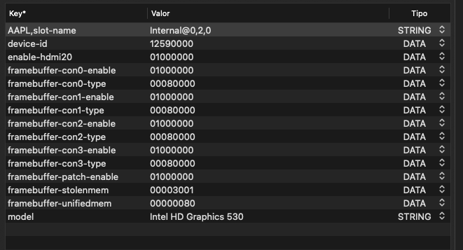

kaoskinkae Posted December 30, 2025 Share Posted December 30, 2025 I have a fully functional OLD2 system running on a Skylake motherboard with a fake 530 iGPU that functions as a 630, working perfectly with both Tahoe and Tahoe Beta. See the OLD2 specifications. However, I can't get it to go into sleep mode, and when I wake from sleep, the monitor stays on static with no possibility of activating the fake graphics. Link to comment https://www.insanelymac.com/forum/topic/362156-resting-on-a-skylake-with-a-fake-530-igpu-disguised-as-a-630/ Share on other sites More sharing options...

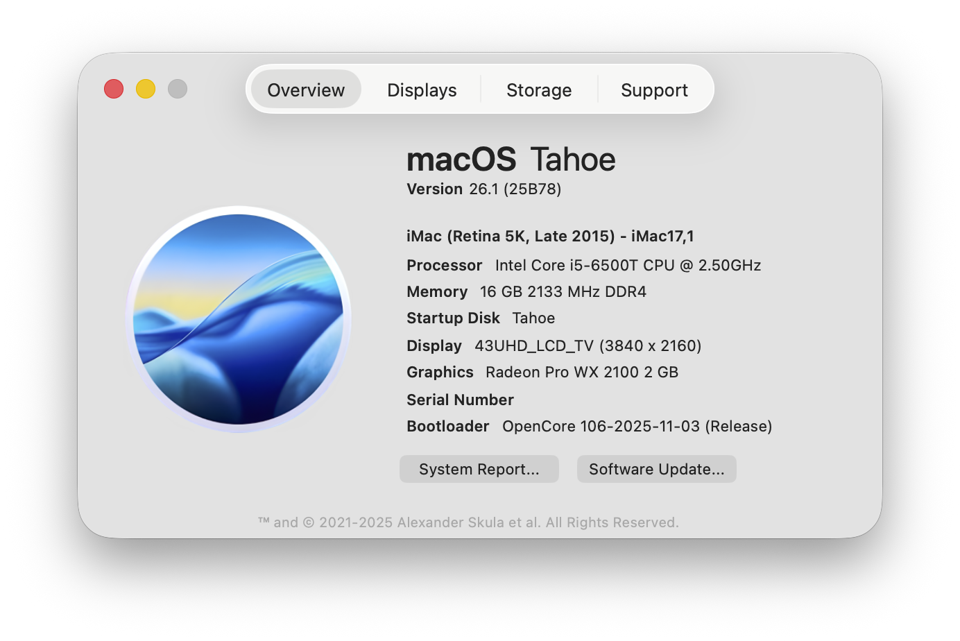

robi62 Posted December 30, 2025 Share Posted December 30, 2025 (edited) yep that's why I bought a cheap Radeon WX 2100 Pro for 30 euros and now sleep is working😀 Edited December 31, 2025 by robi62 moreinfo 3 Link to comment https://www.insanelymac.com/forum/topic/362156-resting-on-a-skylake-with-a-fake-530-igpu-disguised-as-a-630/#findComment-2845601 Share on other sites More sharing options...

robi62 Posted December 31, 2025 Share Posted December 31, 2025 (edited) Hi I did try a solution for my thinkcentre m700 but it only woke up from sleep on first 2 times then it did not .( Sequoia) I did clone @xenophon efi as he too had a Lenovo m700 athought his is a tiny one. https://www.insanelymac.com/forum/topic/355419-90-solved-hibernatemode-25-successfully-working-on-intel-hd-630-igpu-but-glitch-issues-on-first-wake-screen/ I also did try to change frame buffer for one of a laptop as sleep work on them but I could not get the frame buffer right. I did have A Nvidia gt730 but I thought the radeon is a bit better . For 30 euro I can't complain I did not want to spend anymore for a better card. Edited December 31, 2025 by robi62 1 Link to comment https://www.insanelymac.com/forum/topic/362156-resting-on-a-skylake-with-a-fake-530-igpu-disguised-as-a-630/#findComment-2845626 Share on other sites More sharing options...
kaoskinkae Posted December 31, 2025 Author Share Posted December 31, 2025 28 minutes ago, robi62 said: Hi I did try a solution for my thinkcentre m700 but it only woke up from sleep on first 2 times then it did not .( Sequoia) I did clone @xenophon efi as he too had a Lenovo m700 athought his is a tiny one. https://www.insanelymac.com/forum/topic/355419-90-solved-hibernatemode-25-successfully-working-on-intel-hd-630-igpu-but-glitch-issues-on-first-wake-screen/ I also did try to change frame buffer for one of a laptop as sleep work on them but I could not get the frame buffer right. I did have A Nvidia gt730 but I thought the radeon is a bit better . For 30 euro I can't complain I did not want to spend anymore for a better card. AAPL,GfxYTile = 01000000 (Datos) I'm not too worried about it; I've never used sleep mode on any of my computers. But now it's more of an obsession with having it perfect, within the limits of what's possible on an old Tahoe machine, than with actual functionality. I'm going to try this command to see if sleep mode doesn't work if the monitor wakes up from standby and then wakes up. Link to comment https://www.insanelymac.com/forum/topic/362156-resting-on-a-skylake-with-a-fake-530-igpu-disguised-as-a-630/#findComment-2845627 Share on other sites More sharing options...

kaoskinkae Posted January 23 Author Share Posted January 23 (edited) 19 hours ago, Asural said: Lo estoy probando en este hilo , pero no se activa a menos que agregue force-online = <01000000>. AGREGAR: No puedo entender las especificaciones de la PC solo por OLD2 = Pavilion, por lo que me gustaría que se muestren en un formato de búsqueda. It didn't work as I told you. Let's see if the translation from Spanish to English is correct. The computer I'm going to show you is the OLD2 of my represented systems: Pavilion | i5-6400 CPU @ 3.30GHz Skylake | Intel HD Graphics 530 | iMac 17.1 | OpenCore 1.0. The 530 graphics card doesn't work in Tahoe, so I've modified the graphics card and it works perfectly. This computer is only for testing with the Tahoe system. I know it would work great on previous systems, but that's not my goal, as what I intend is to learn and try to make this work. This is truly the essence of Hackintosh at its best. The issue with this computer, after modifying the 530 graphics card to a 560, is that they work relatively well without the sleep mode. Seeing that it had two HDMI outputs, I wanted to try with another monitor to see if I had a video signal on both, but it didn't work with the 530/560 spoofing. However, if I leave it without data, the computer boots to the graphics card with no gigabytes allocated, but both monitors work. Therefore, it's a problem with the graphics card spoofing. I don't know if it can be fixed, but I'm leaving this here in case anyone has managed to fix it on these Skulake Intel HD Graphics 530 systems, as well as Taho EO and Sonoma. The descriptive method you put in the link didn't work for me. Edited January 23 by kaoskinkae 1 Link to comment https://www.insanelymac.com/forum/topic/362156-resting-on-a-skylake-with-a-fake-530-igpu-disguised-as-a-630/#findComment-2846798 Share on other sites More sharing options...
