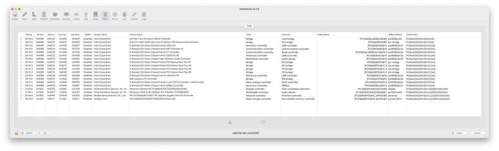

vamose Posted January 14 Share Posted January 14 (edited) @MakAsrock I have no clue what needs to be done From Hackintool, the info is as below 01:00.0 1002 67DF 1682 C580 Disabl Advanced Micro Devices, Inc. [ Ellesmere [Radeon RX 470/480/570/570X/580/580X/590 Display controller VGA compatible contr 0/PEG0@1/GFX0@0 display PciRoot(0x0)/Pci(0x1,0x0)/Pci(0x0,0x0) In my config file I have the following <?xml version="1.0" encoding="UTF-8"?> <!DOCTYPE plist PUBLIC "-//Apple//DTD PLIST 1.0//EN" "http://www.apple.com/DTDs/PropertyList-1.0.dtd"> <plist version="1.0"> <dict> <key>Add</key> <dict> <key>PciRoot(0x0)/Pci(0x1b,0x0)</key> <dict> <key>layout-id</key> <integer>7</integer> </dict> <key>PciRoot(0x0)/Pci(0x2,0x0)</key> <dict> <key>disable-gpu</key> <true/> </dict> </dict> <key>Delete</key> <dict/> </dict> </plist> I do not understand the instructions and do not know what to do next. Can you guide me? @Slice Переделка видеобиоса в UEFI-видеобиос Произошла неожиданная ошибка. Пожалуйста, попробуйте позже ещё раз. This is all I get to see. Request if you can share the download link instead. please. Edited January 14 by vamose 1 Link to comment https://www.insanelymac.com/forum/topic/362078-release-macos-tahoe-262/page/5/#findComment-2846407 Share on other sites More sharing options...
Matgen84 Posted January 14 Share Posted January 14 @vamose According to @MakAsrock, your XFX Rx580 works fine (like my MSI Radeon RX580 8Go OC). Update vBios seems to be unnecessary. PciRoot(0x0)/Pci(0x1,0x0)/Pci(0x0,0x0) is correct instead fo your entry in config.plist. Why this incorrect entry is setting to disable ??? 2 Link to comment https://www.insanelymac.com/forum/topic/362078-release-macos-tahoe-262/page/5/#findComment-2846409 Share on other sites More sharing options...
vamose Posted January 14 Share Posted January 14 @Matgen84 help me what needs to be done. I have followed guides blindly, so I do not know the logical reasoning behind. Help is needed.. 1 Link to comment https://www.insanelymac.com/forum/topic/362078-release-macos-tahoe-262/page/5/#findComment-2846414 Share on other sites More sharing options...
MakAsrock Posted January 14 Share Posted January 14 (edited) 57 minutes ago, vamose said: @Matgen84 help me what needs to be done. I have followed guides blindly, so I do not know the logical reasoning behind. Help is needed.. Send me output from gfxutil in any macOS where everything works for you. Usage: path/to/gfxutil -f IGPU path/to/gfxutil -f PEGP path/to/gfxutil -f GFX0 gfxutil.zip Edited January 14 by MakAsrock 1 Link to comment https://www.insanelymac.com/forum/topic/362078-release-macos-tahoe-262/page/5/#findComment-2846419 Share on other sites More sharing options...
vamose Posted January 14 Share Posted January 14 @MakAsrock - Attached output. /Users/xoxo/Downloads/gfxutil ; exit; xoxo@xoxos-Mac-Pro ~ % /Users/xoxo/Downloads/gfxutil ; exit; 00:00.0 8086:0c00 /PCI0@0/pci8086,c00@0 = PciRoot(0x0)/Pci(0x0,0x0) 00:01.0 8086:0c01 /PCI0@0/PEG0@1 = PciRoot(0x0)/Pci(0x1,0x0) 00:14.0 8086:8c31 /PCI0@0/XHC@14 = PciRoot(0x0)/Pci(0x14,0x0) 00:16.0 8086:8c3a /PCI0@0/IMEI@16 = PciRoot(0x0)/Pci(0x16,0x0) 00:16.3 8086:8c3d /PCI0@0/pci8086,8c3d@16,3 = PciRoot(0x0)/Pci(0x16,0x3) 00:1a.0 8086:8c2d /PCI0@0/EHC2@1A = PciRoot(0x0)/Pci(0x1A,0x0) 00:1b.0 8086:8c20 /PCI0@0/HDEF@1B = PciRoot(0x0)/Pci(0x1B,0x0) 00:1c.0 8086:8c10 /PCI0@0/RP01@1C = PciRoot(0x0)/Pci(0x1C,0x0) 00:1c.2 8086:8c14 /PCI0@0/RP03@1C,2 = PciRoot(0x0)/Pci(0x1C,0x2) 00:1c.3 8086:8c16 /PCI0@0/RP04@1C,3 = PciRoot(0x0)/Pci(0x1C,0x3) 00:1c.4 8086:8c18 /PCI0@0/RP05@1C,4 = PciRoot(0x0)/Pci(0x1C,0x4) 00:1d.0 8086:8c26 /PCI0@0/EHC1@1D = PciRoot(0x0)/Pci(0x1D,0x0) 00:1f.0 8086:8c50 /PCI0@0/LPCB@1F = PciRoot(0x0)/Pci(0x1F,0x0) 00:1f.2 8086:8c02 /PCI0@0/SAT0@1F,2 = PciRoot(0x0)/Pci(0x1F,0x2) 00:1f.3 8086:8c22 /PCI0@0/SBUS@1F,3 = PciRoot(0x0)/Pci(0x1F,0x3) 01:00.0 1002:67df /PCI0@0/PEG0@1/GFX0@0 = PciRoot(0x0)/Pci(0x1,0x0)/Pci(0x0,0x0) 01:00.1 1002:aaf0 /PCI0@0/PEG0@1/HDAU@0,1 = PciRoot(0x0)/Pci(0x1,0x0)/Pci(0x0,0x1) 03:00.0 10ec:8168 /PCI0@0/RP03@1C,2/PXSX@0 = PciRoot(0x0)/Pci(0x1C,0x2)/Pci(0x0,0x0) 06:00.0 15b7:5017 /PCI0@0/RP05@1C,4/PXSX@0 = PciRoot(0x0)/Pci(0x1C,0x4)/Pci(0x0,0x0) Saving session... ...copying shared history... ...saving history...truncating history files... ...completed. pcidevices.plistpcidevices.jsonpcidevices.dsl [Process completed] 1 Link to comment https://www.insanelymac.com/forum/topic/362078-release-macos-tahoe-262/page/5/#findComment-2846422 Share on other sites More sharing options...

MakAsrock Posted January 14 Share Posted January 14 2 hours ago, vamose said: @MakAsrock - Attached output. /Users/xoxo/Downloads/gfxutil ; exit; xoxo@xoxos-Mac-Pro ~ % /Users/xoxo/Downloads/gfxutil ; exit; 00:00.0 8086:0c00 /PCI0@0/pci8086,c00@0 = PciRoot(0x0)/Pci(0x0,0x0) 00:01.0 8086:0c01 /PCI0@0/PEG0@1 = PciRoot(0x0)/Pci(0x1,0x0) 00:14.0 8086:8c31 /PCI0@0/XHC@14 = PciRoot(0x0)/Pci(0x14,0x0) 00:16.0 8086:8c3a /PCI0@0/IMEI@16 = PciRoot(0x0)/Pci(0x16,0x0) 00:16.3 8086:8c3d /PCI0@0/pci8086,8c3d@16,3 = PciRoot(0x0)/Pci(0x16,0x3) 00:1a.0 8086:8c2d /PCI0@0/EHC2@1A = PciRoot(0x0)/Pci(0x1A,0x0) 00:1b.0 8086:8c20 /PCI0@0/HDEF@1B = PciRoot(0x0)/Pci(0x1B,0x0) 00:1c.0 8086:8c10 /PCI0@0/RP01@1C = PciRoot(0x0)/Pci(0x1C,0x0) 00:1c.2 8086:8c14 /PCI0@0/RP03@1C,2 = PciRoot(0x0)/Pci(0x1C,0x2) 00:1c.3 8086:8c16 /PCI0@0/RP04@1C,3 = PciRoot(0x0)/Pci(0x1C,0x3) 00:1c.4 8086:8c18 /PCI0@0/RP05@1C,4 = PciRoot(0x0)/Pci(0x1C,0x4) 00:1d.0 8086:8c26 /PCI0@0/EHC1@1D = PciRoot(0x0)/Pci(0x1D,0x0) 00:1f.0 8086:8c50 /PCI0@0/LPCB@1F = PciRoot(0x0)/Pci(0x1F,0x0) 00:1f.2 8086:8c02 /PCI0@0/SAT0@1F,2 = PciRoot(0x0)/Pci(0x1F,0x2) 00:1f.3 8086:8c22 /PCI0@0/SBUS@1F,3 = PciRoot(0x0)/Pci(0x1F,0x3) 01:00.0 1002:67df /PCI0@0/PEG0@1/GFX0@0 = PciRoot(0x0)/Pci(0x1,0x0)/Pci(0x0,0x0) 01:00.1 1002:aaf0 /PCI0@0/PEG0@1/HDAU@0,1 = PciRoot(0x0)/Pci(0x1,0x0)/Pci(0x0,0x1) 03:00.0 10ec:8168 /PCI0@0/RP03@1C,2/PXSX@0 = PciRoot(0x0)/Pci(0x1C,0x2)/Pci(0x0,0x0) 06:00.0 15b7:5017 /PCI0@0/RP05@1C,4/PXSX@0 = PciRoot(0x0)/Pci(0x1C,0x4)/Pci(0x0,0x0) Saving session... ...copying shared history... ...saving history...truncating history files... ...completed. pcidevices.plist 5.79 kB · 0 downloads pcidevices.json 14.75 kB · 0 downloads pcidevices.dsl 7.2 kB · 0 downloads [Process completed] So, you need to disable this: 00:01.0 8086:0c01 /PCI0@0/PEG0@1 = PciRoot(0x0)/Pci(0x1,0x0) And try the new Lilu-1.7.2-RELEASE fix, which enables the use of WhateverGreen. I hope it works out for you. 😉 Lilu.kext.zip 1 1 Link to comment https://www.insanelymac.com/forum/topic/362078-release-macos-tahoe-262/page/5/#findComment-2846435 Share on other sites More sharing options...
MakAsrock Posted January 14 Share Posted January 14 (edited) 3 hours ago, MakAsrock said: So, you need to disable this: 00:01.0 8086:0c01 /PCI0@0/PEG0@1 = PciRoot(0x0)/Pci(0x1,0x0) And try the new Lilu-1.7.2-RELEASE fix, which enables the use of WhateverGreen. I hope it works out for you. 😉 Lilu.kext.zip 185.63 kB · 4 downloads I'm sorry, but I was mistaken. You don't need to disable anything. The integrated video controller isn't showing up in the device list, which means, like mine, the RX580 automatically disables it when installed in the first slot. Just update WhateverGreen and Lilu. Later, I'll edit pcidevices.plist for you. And yes, all 8GB RX580 cards already include GOP. RX580 4GB cards may not. So don't flash anything. pcidevices.plist Edited January 14 by MakAsrock 1 Link to comment https://www.insanelymac.com/forum/topic/362078-release-macos-tahoe-262/page/5/#findComment-2846441 Share on other sites More sharing options...
