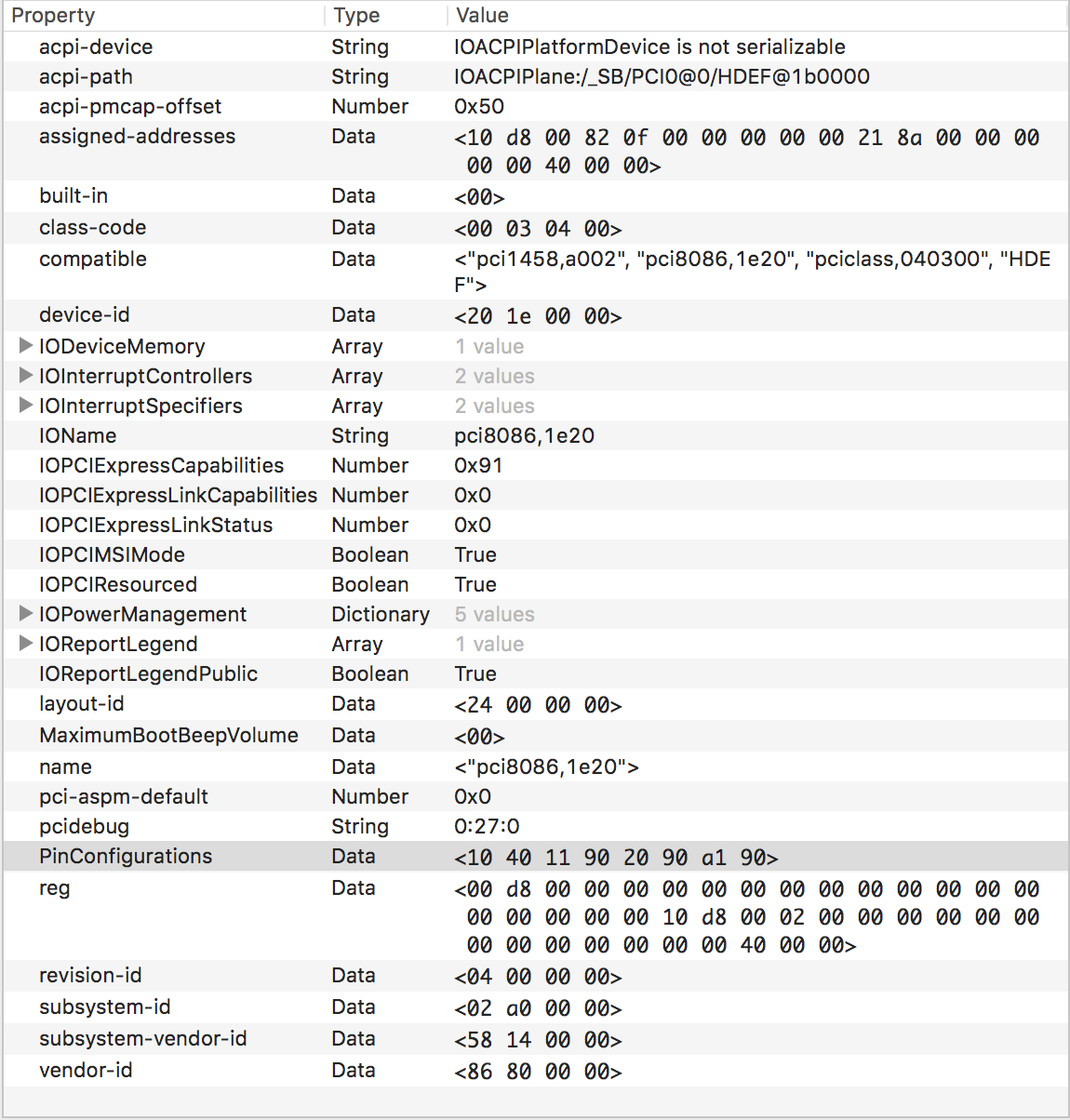

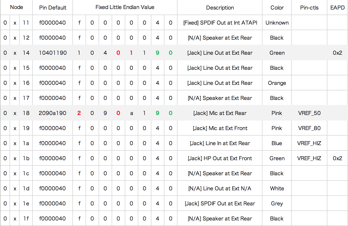

I fixed pinconfigration and node path from codec.
Speaker EAPD = 21470c02
Mic MuteGPIO = 1342242840
Green LineOut:
20 → 12 → 2
Pink Mic:
09 → 34 → 24
I patched AppleHDA.kext manually.
LayoutID = 36, injected by clover device part
Clover KextsToPatch: Find 8508EC10 Replace 9208EC10
I installed patched kext and reboot, ofcouse I repaired permissions and rebuilt caches.

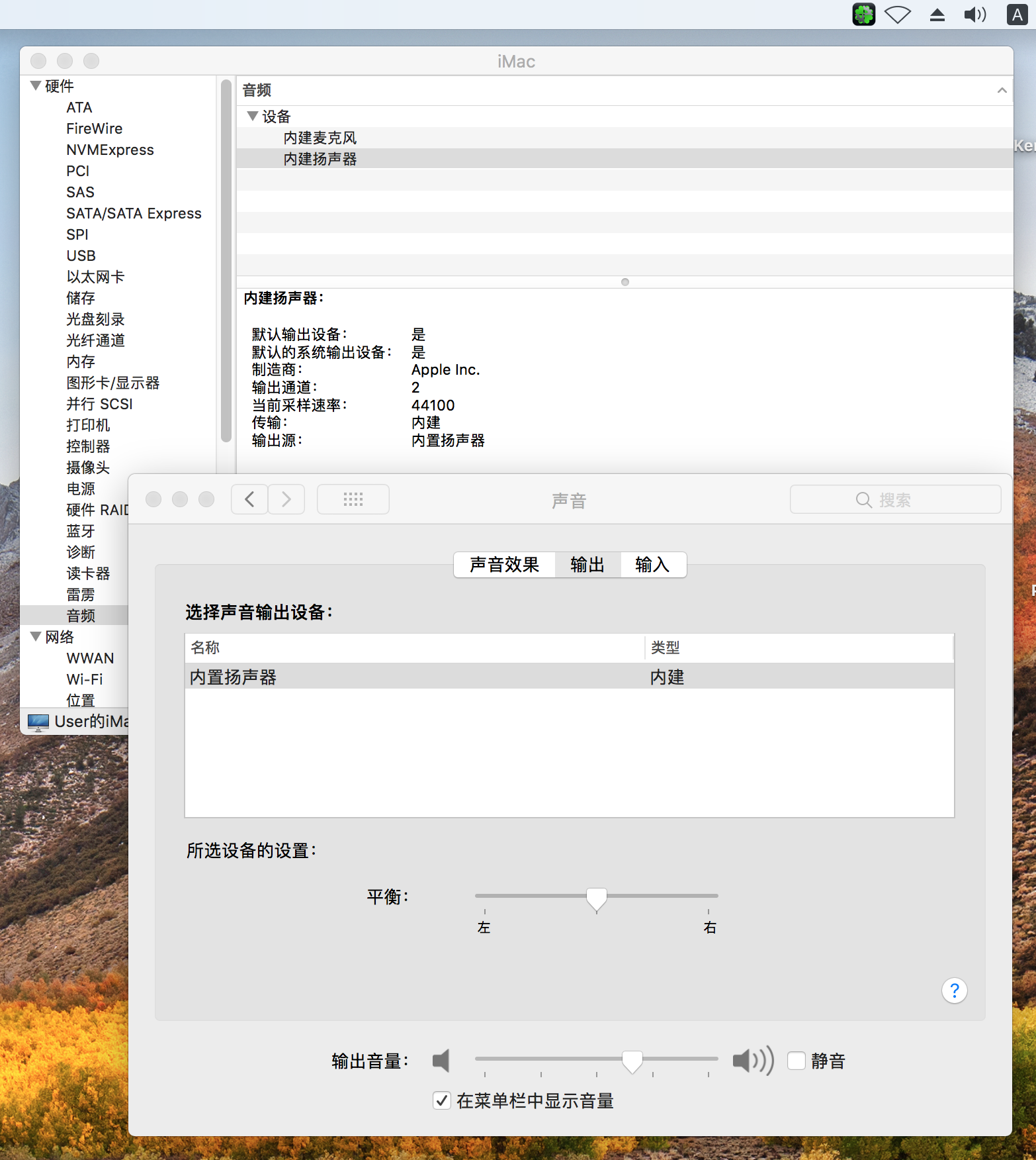

Everything shows right but there is no sound.
I also use the same data to applealc with alcid=1, it works fine.
I do not know which step is wrong when I patched applehda.kext.
could anybody help? thanks ~
