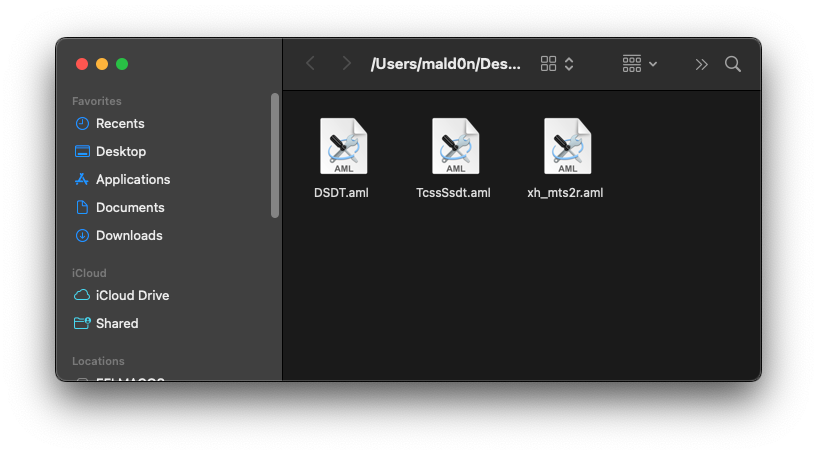

MaLd0n Posted December 18, 2024 Author Share Posted December 18, 2024 Native USB Solution on Chipset Z890 DSDT DSDT.Z890.zip SSDT USB SSDT USB xh_mts2r.zip 10 Link to comment https://www.insanelymac.com/forum/topic/360341-cinebench-results-intel-core-ultra-9-285k-on-macos-sequoia/#findComment-2828996 Share on other sites More sharing options...

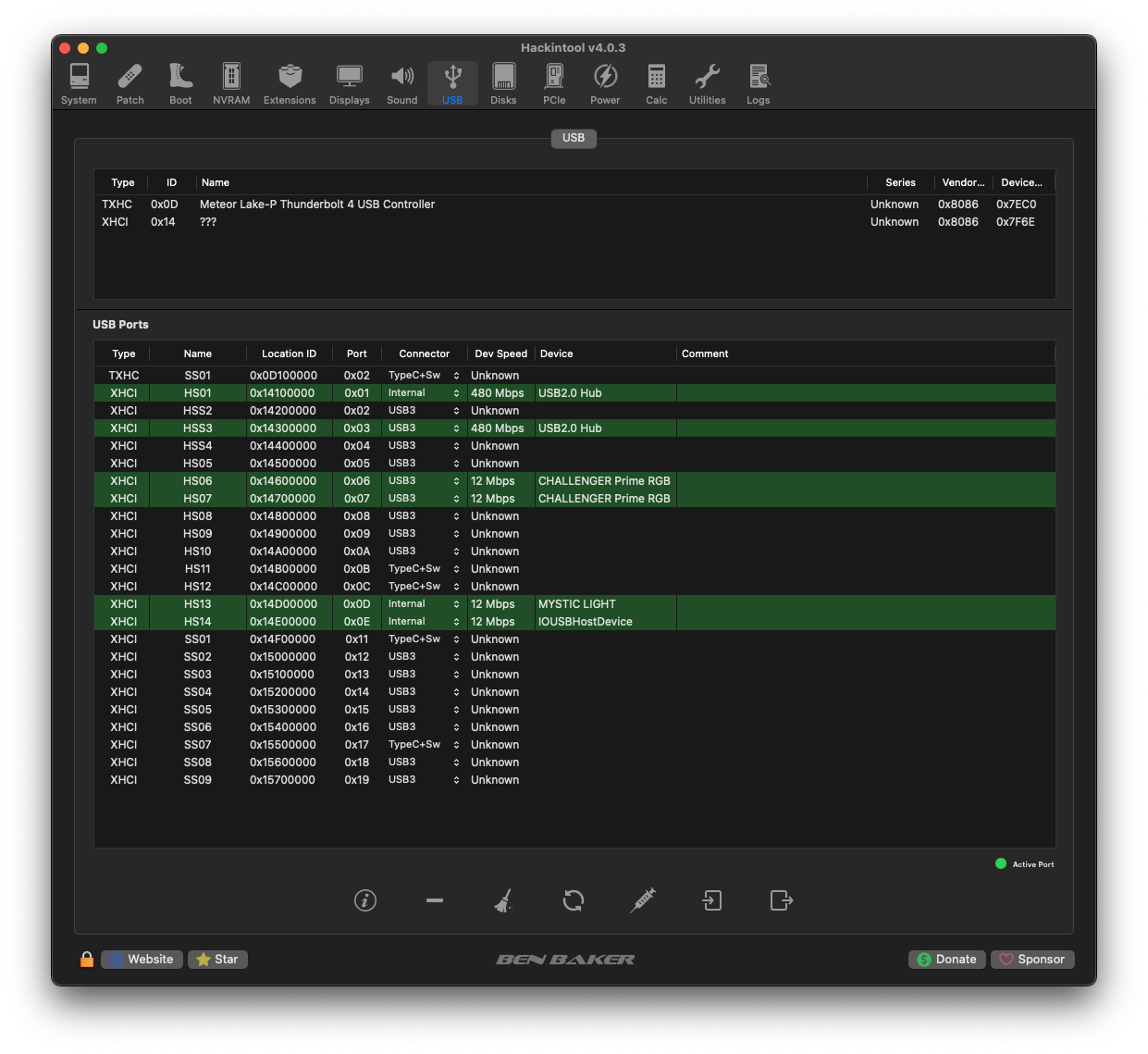

MaLd0n Posted May 22, 2025 Author Share Posted May 22, 2025 Full ACPI solution for USB and Thunderbolt for MSI Z890 motherboard ACPI.zip 4 1 Link to comment https://www.insanelymac.com/forum/topic/360341-cinebench-results-intel-core-ultra-9-285k-on-macos-sequoia/#findComment-2832503 Share on other sites More sharing options...

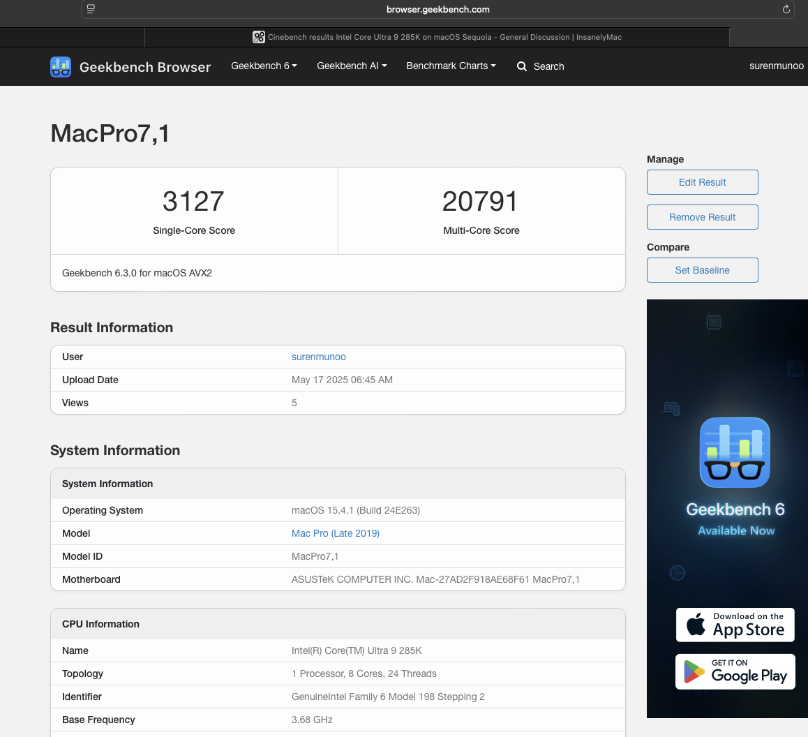

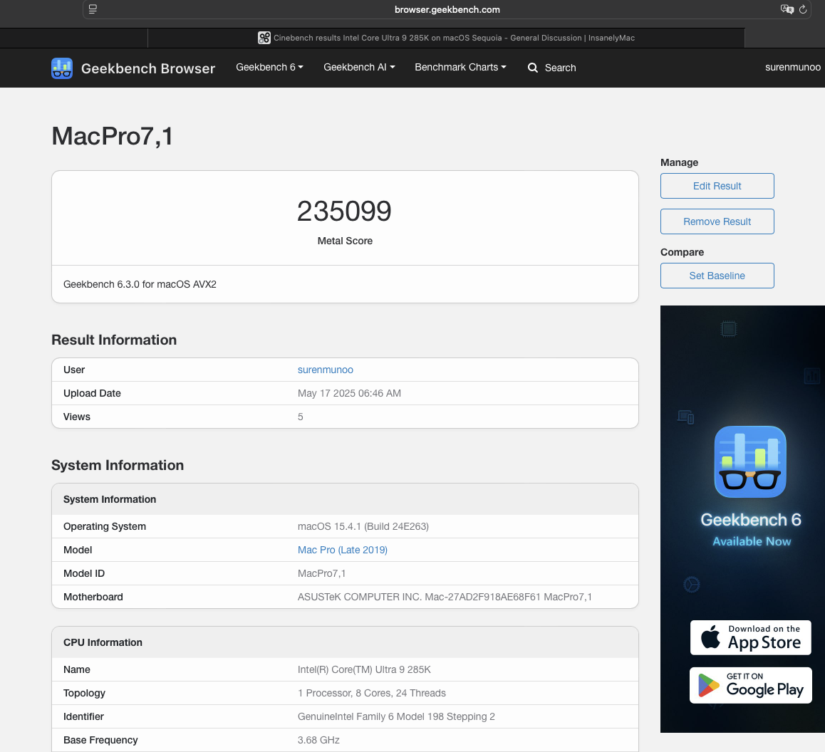

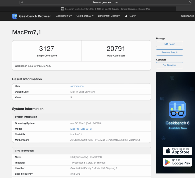

surenmunoo Posted May 22, 2025 Share Posted May 22, 2025 On 4/12/2025 at 2:58 PM, Balamut said: I was looking into ProArt z890 for it, maybe in the summer. Great Job MaLd0n. Trust me when I say only @MaLd0n Can help in getting this hac working. I have the Z890 ProArt with the Ultra 9 285K CPU and a RX6800XT. This hack was the biggest headache I had and regretted getting it but when it works, it's amazing. To get it to boot from a usb installer is virtually not possible and to get an OS like Ventura to upgrade to Sequoia is almost impossible unless you remove the onboard front usb c header, the front usb 3 header, the usb 2.0 header and 1 stick of Ram. Once all that is removed, proceed and update and then put everything back. I spent days trying to figure out the correct sequence and this was the only way. Maybe I have a Haunted Ghost board but this is the only way it works. Then I re-enable VT-d, XMP1 etc and it works like a dream machine, much faster than my M2 Max Studio. 2 Link to comment https://www.insanelymac.com/forum/topic/360341-cinebench-results-intel-core-ultra-9-285k-on-macos-sequoia/#findComment-2832518 Share on other sites More sharing options...
