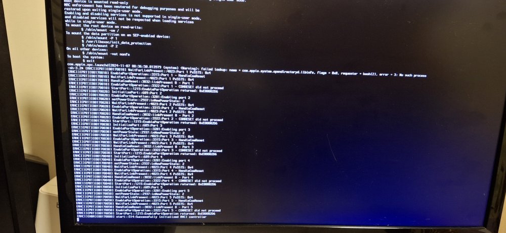

Lost-Entrepreneur439 Posted November 6, 2024 Share Posted November 6, 2024 After the verbose log on my MSI RX 580 Gaming X 4GB, the screen just goes black. There's no noticeable errors so I'm not sure what's going on. I've tested with multiple different monitors and it happens across all of them with both HDMI and DVI. I don't have a DisplayPort monitor or adapter to test. Anyone know how I could resolve this? This system's specs are in my signature. EFI is attached to the topic. EFI.zip 1 Quote Link to comment https://www.insanelymac.com/forum/topic/360222-rx-580-msi-black-screen-after-verbose/ Share on other sites More sharing options...

Max.1974 Posted November 7, 2024 Share Posted November 7, 2024 (edited) Some ROMS like Chinese 2048sp need enable CSM. If your hardware is native RX 580 4GB, maybe ROM need update or need flash to Sapphire ROM 4GB. I will test my card RX 580 Sapphire 4GB and report here... EDIT: Also same almost results here, using Clover 5160 and iMacPro1,1, two monitors and one HDMI one Dvi, stuck on verbose screen. I will try using recommendation by @Cyberdevs Spoiler Edited November 7, 2024 by Max.1974 1 Quote Link to comment https://www.insanelymac.com/forum/topic/360222-rx-580-msi-black-screen-after-verbose/#findComment-2827498 Share on other sites More sharing options...
