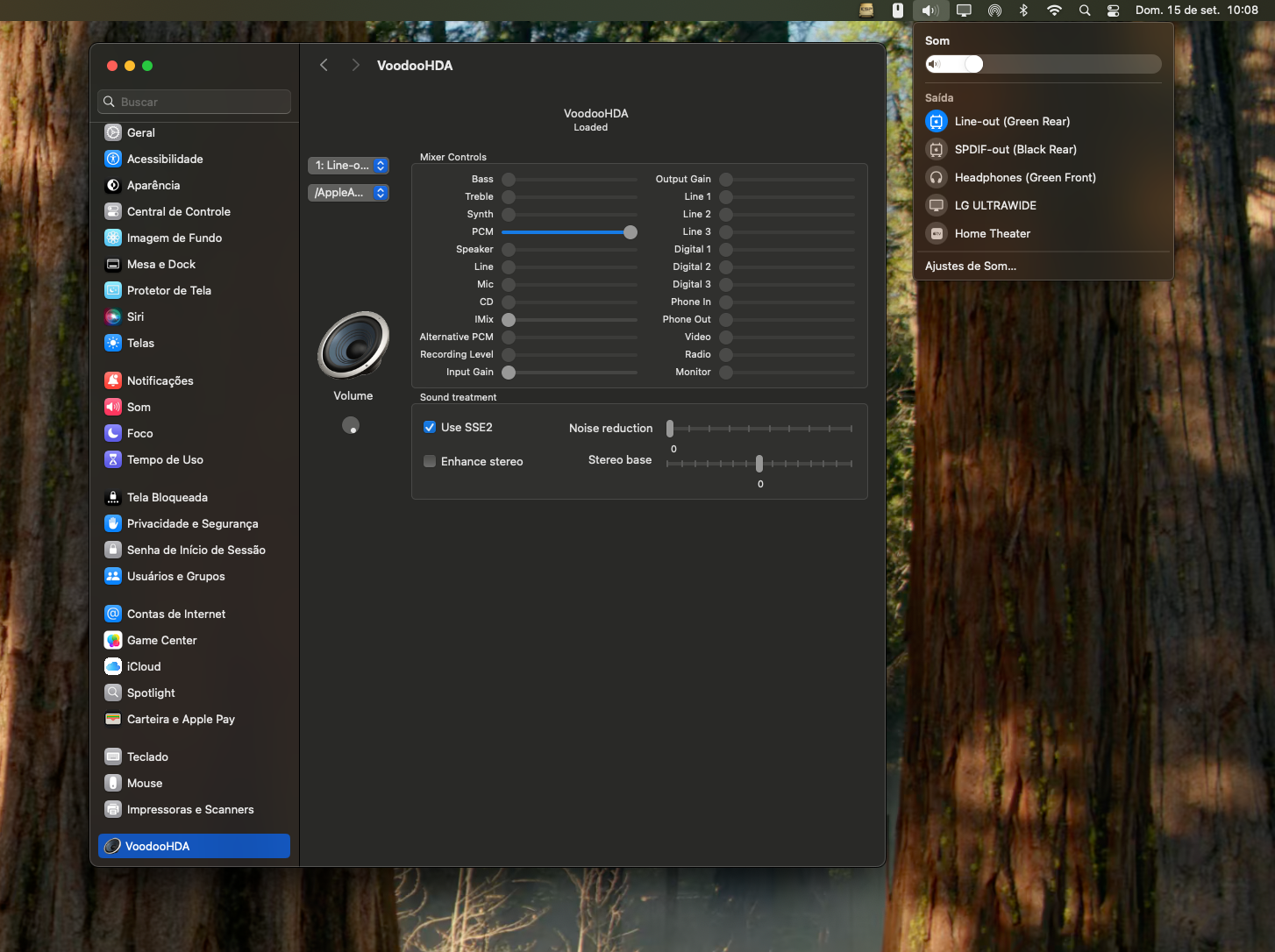

Are you try use VoodooHDA.kext ? Working like charm (compiled its better) on Desktops.
I have been use patch creates by Rodions, user from GitHub and AppleLife.ru. Just create your .pkg files to install VoodHDA and PrefPane ! It's butter and cake! If you want it, I sendo to you!

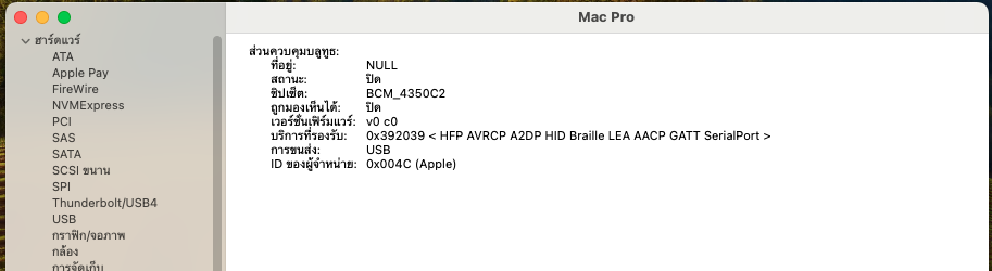

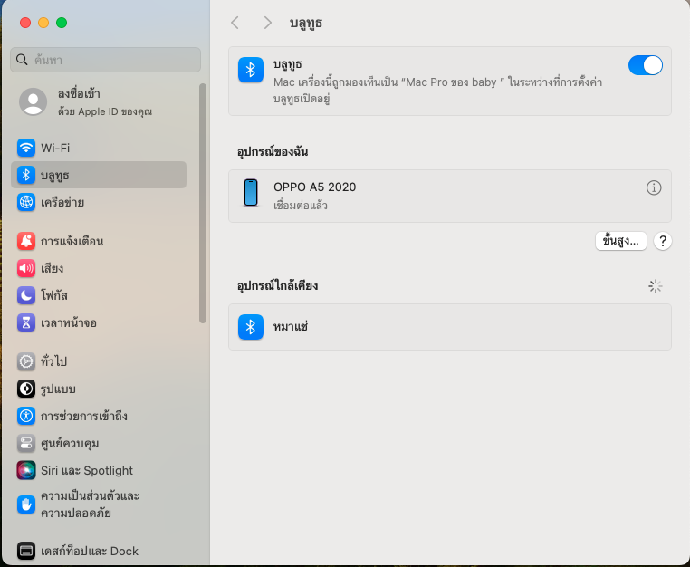

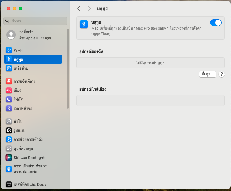

Hi friend, I have a problem that I can't boot into the system. But I use IntelBluetoothFirmware.kext IntelBTPatcher.kext IntelBluetoothInjector.kext and I have to remove this (IntelBluetoothInjector.kext) to boot into the system. But the problem is that I can't use bluetooth. What should I do to fix it?

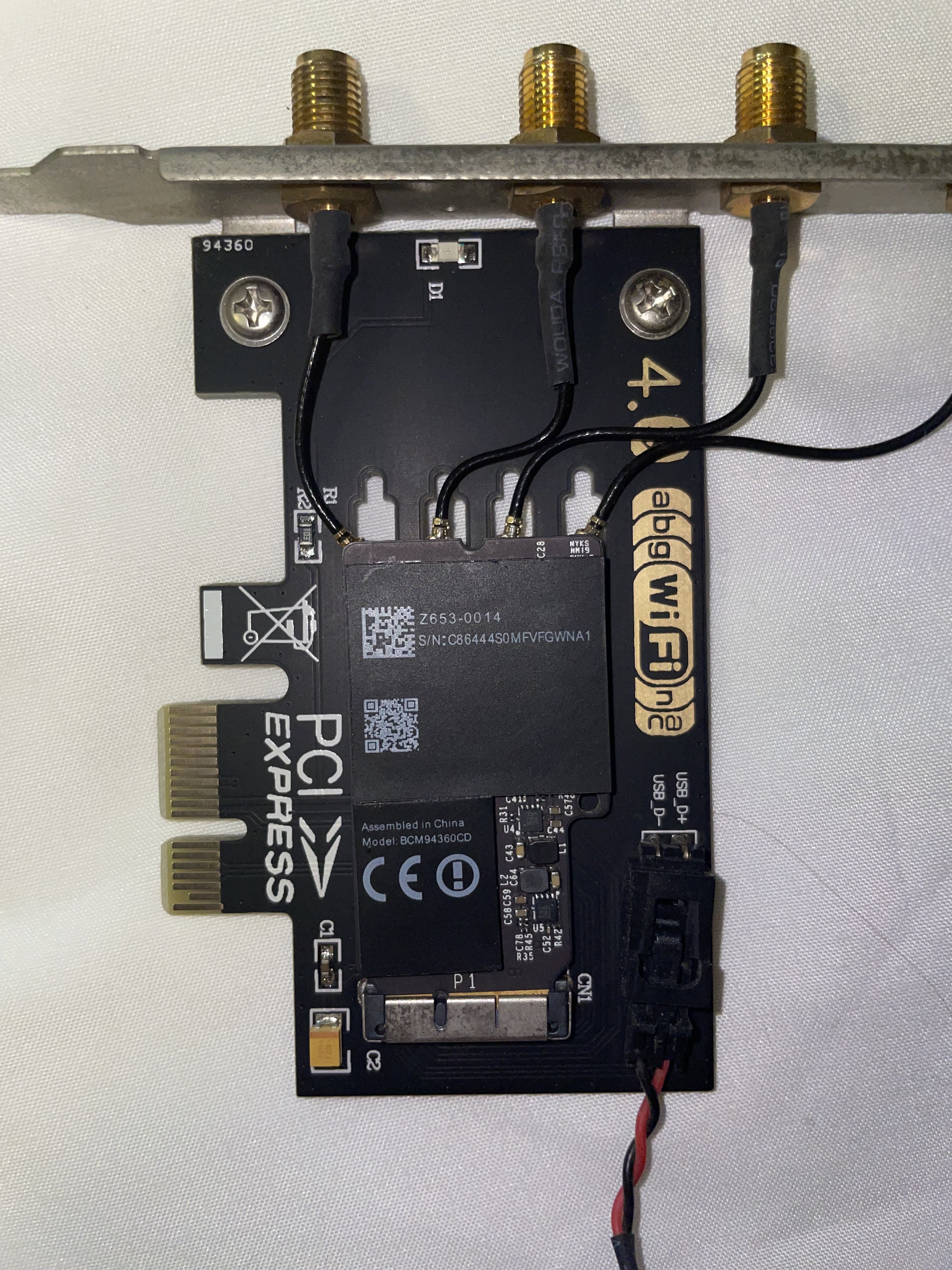

Hi @naiclub I need to know what is your Wi-Fi wireless card, dependent of your model you not need use any kext, like me. I use BCM9346CD (Native Mackintosh device)

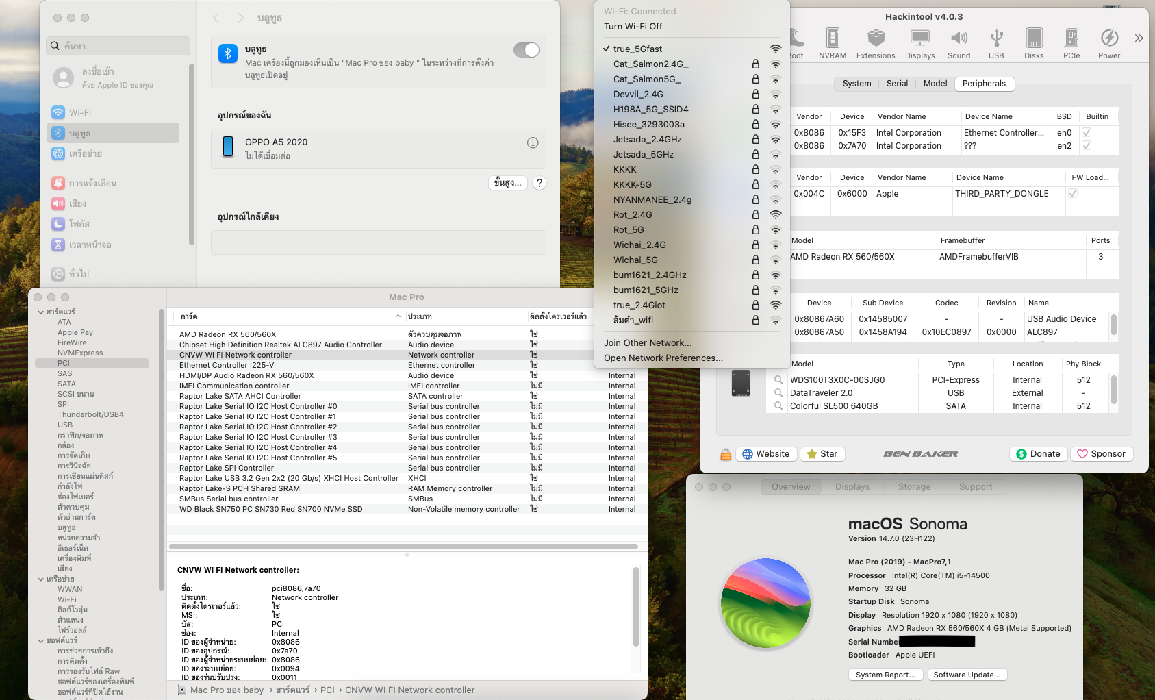

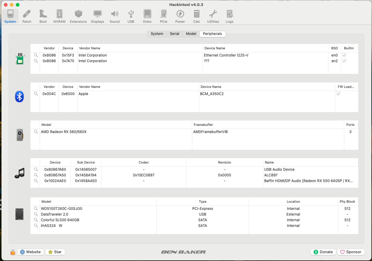

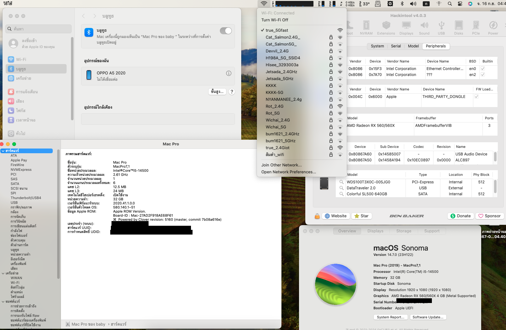

2567-09-1521_16_03.thumb.png.6e2f93e64ca63a30c01f4112ccb7ccef.png2567-09-1521_23_39.png.bde985fa78446cd8c48ec14e592d80a2.png
This model, my friends.
Spoiler
I looked at the details and it seems to match what the developer has stated.
Last month I tried it with Bigsur and it worked very well.
Edited by naiclub
  Reveal hidden contents
Hi @naiclub  You must use BlueToolFixup.kext instead of IntelBluetoothInjector.kext for your Intel Wifi/BT card. With IntelBluetoothFirmware.kext IntelBTPatcher.kext and BlueToolFixup.kext, my Intel 9560ac work fine on Sonoma. I'm waiting AirportItwlm update for Sequoia like others users. But Itwlm and Heliport are working.
  • Like 3
Hello friend, it works with Sonoma but not with Sequoia. Anyway, thank you very much.

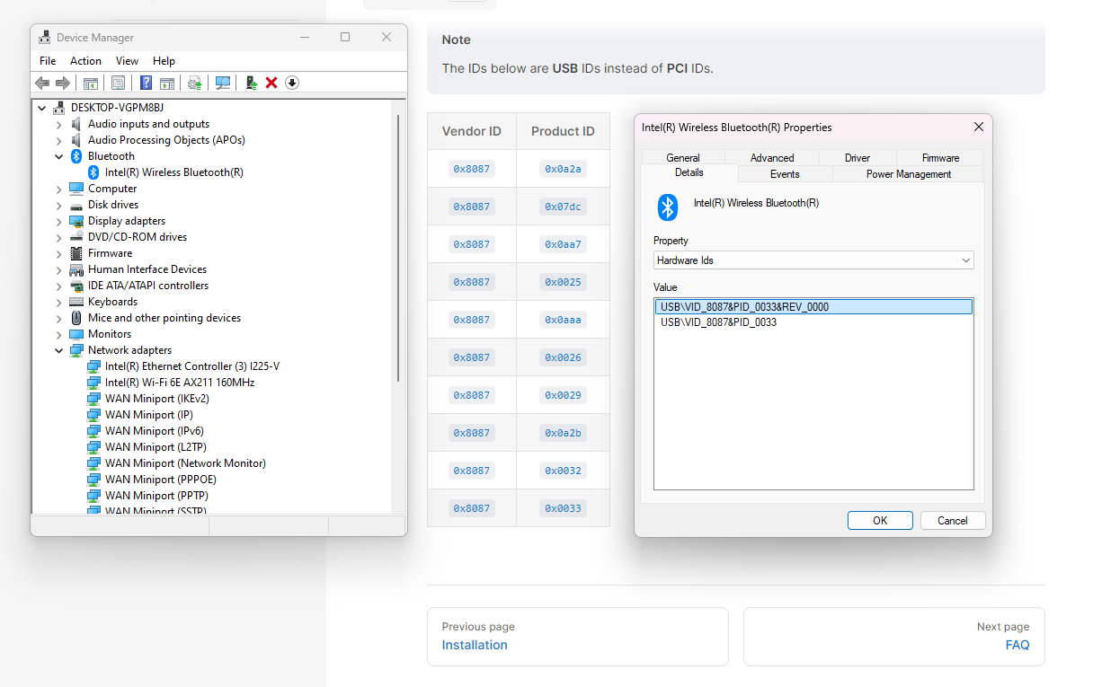

@naiclub
AX 211 160 MHz is supported by OpenIntelWireless. I don't know why it isn't working for you.
These are the instructions that work for me:
https://www.insanelymac.com/forum/topic/358024-sonoma-wi-fi-solutions-that-do-not-require-disabled-sip-eg-intel-ax210/

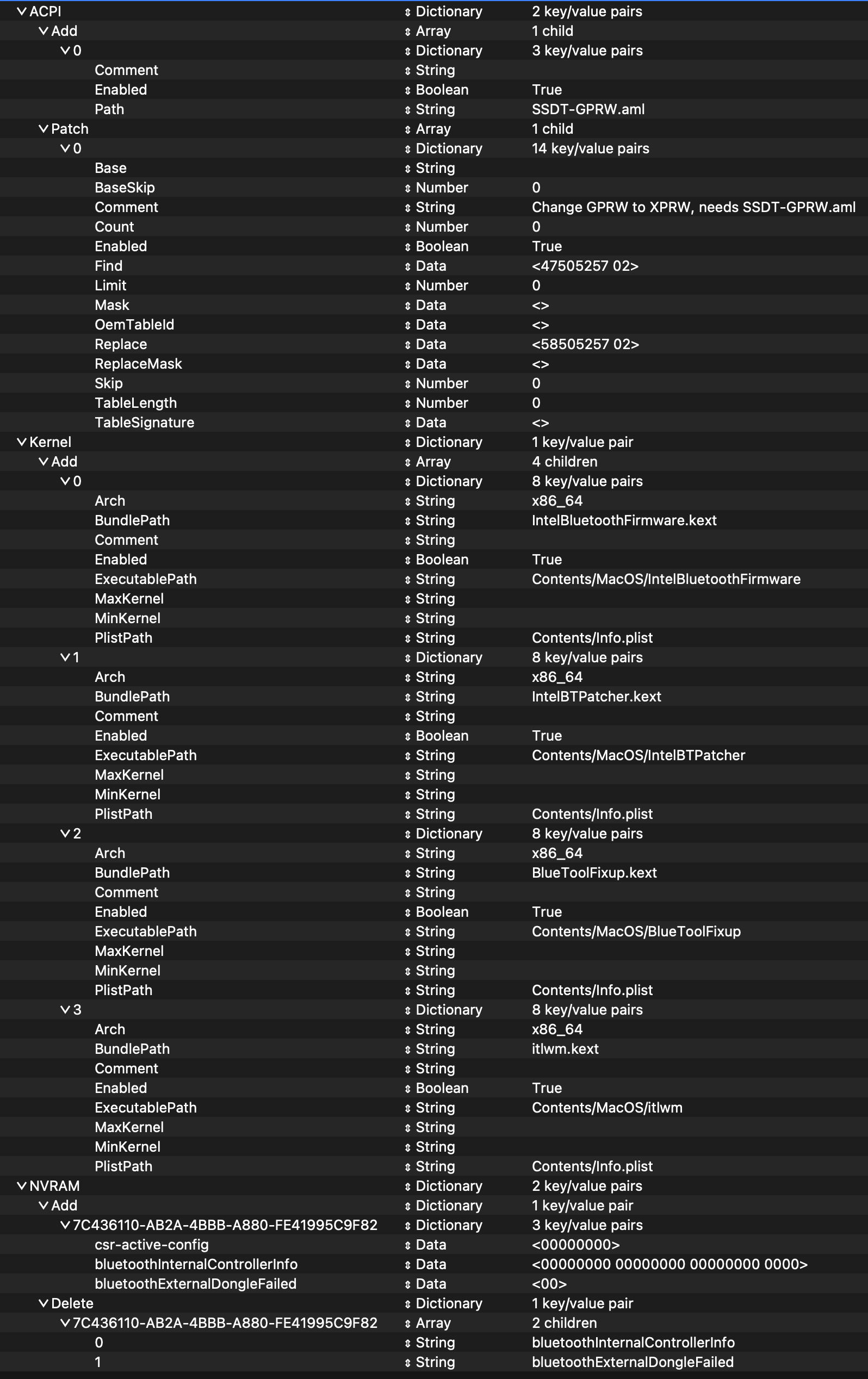

These are the settings added to config.plist (working too):
Spoiler
Notice that SSDT-GPRW.aml + ACPI >> Patch (Change GPRW to XPRW) are intended to fix instant wake on sleep issue, you can skip them to try to fix BlueTooh.
Edited by miliuco
  • Like 4
9 minutes ago, miliuco said:
@naiclub
https://github.com/perez987/Intel-AX210-wifi6-on-macOS-Sonoma

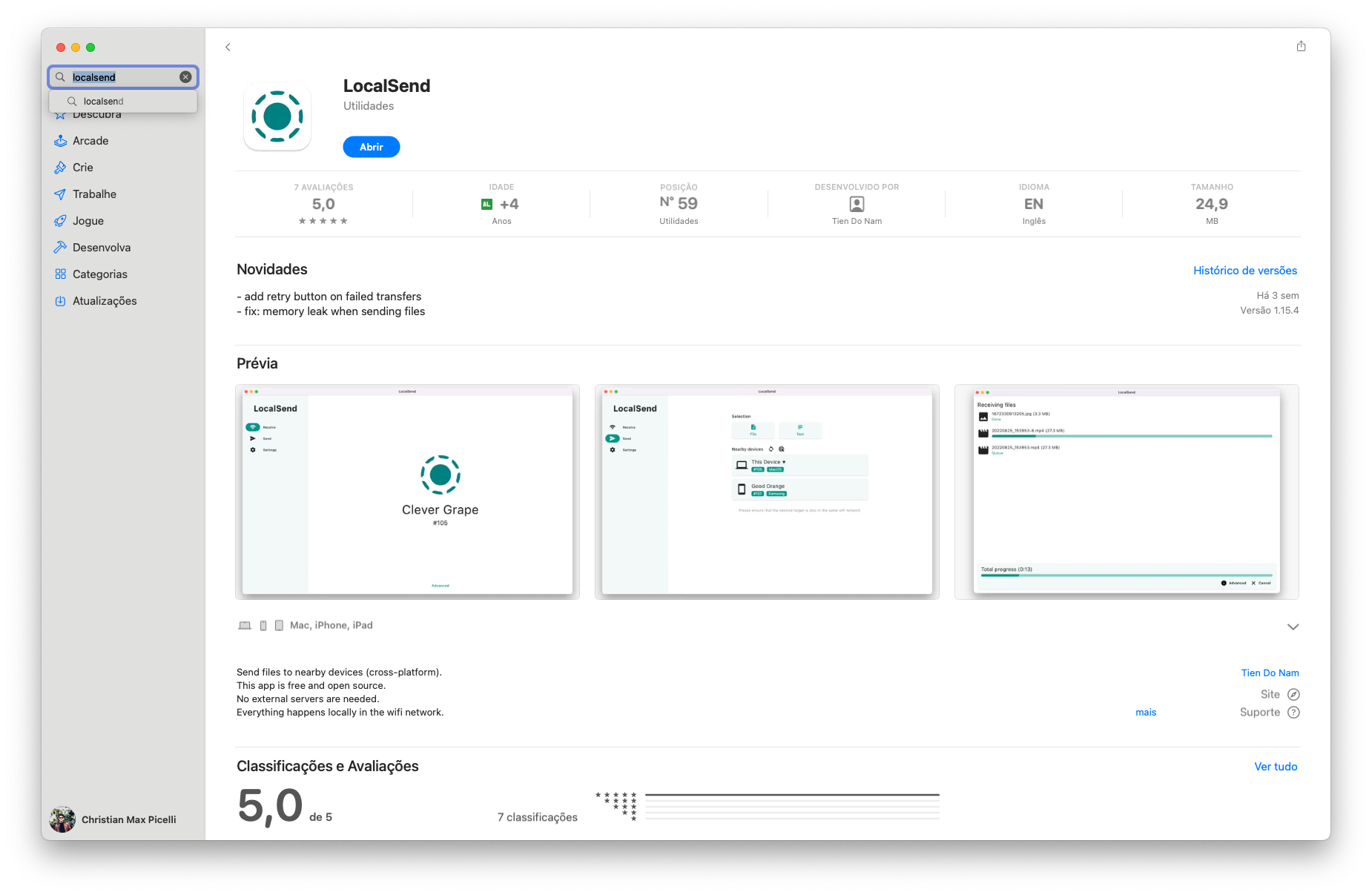

Hi @naiclub the great guys tell you that is possible, but a little complex to fix works on Sequoia. I have intel AX211 WI-FI 6E too on my Z790 GA MOBO. I have been using BCM934260CD together on my PCI Slot. Bluetooth from Broadcom is native and not needed patchers. I tested my dongles bluetooth too. With intel wireless no one of them (Broadcom) get AirDrop, but you can use LocaSend in iPhone and in your Desktop, check in AppleStore for both. And recommend you buy another Pcie Broadcom Card and use OCLP or use Heliport with Broadcom dongles. Hope this help you!
https://apps.apple.com/br/app/localsend/id1661733229
Spoiler

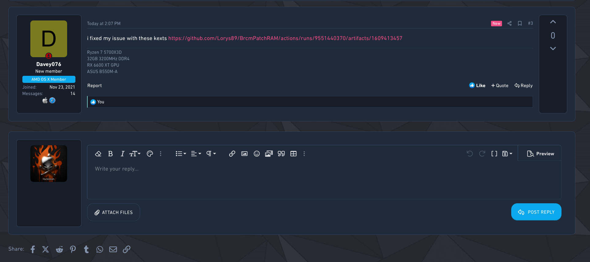

@naiclub maybe you should try use Lorys89 kexts, reported by another users in another forum that was fixed this issue
"i fixed my issue with these kexts https://github.com/Lorys89/BrcmPatchRAM/actions/runs/9551440370/artifacts/1609413457"
Spoiler
Source: Amd Osx forum
Edited by Max.1974

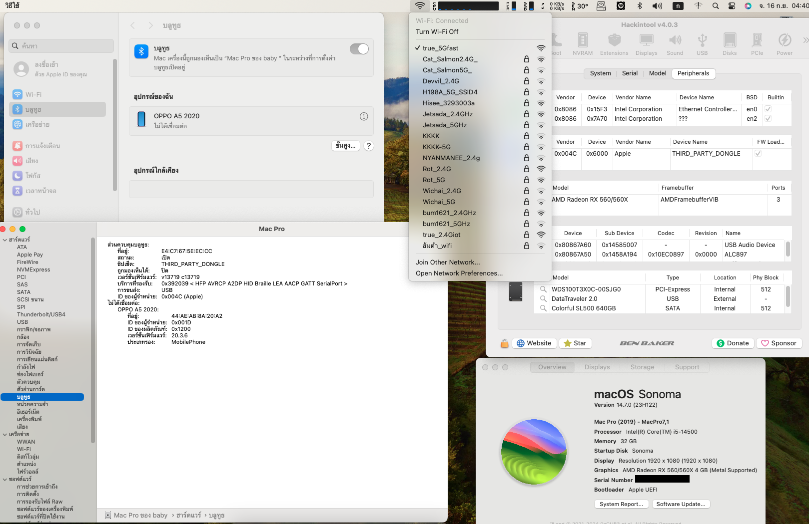

2567-09-1600_31_34.png.c04eee43d865c459403e6a043a32f2a5.png2567-09-1604_38_51.thumb.png.68164b7da11df1e039f56122af9eec4d.png2567-09-1604_40_52.thumb.png.db5b87c2b6cb84be069ab034fb3b7d3c.png2567-09-1604_42_28.thumb.png.f97e961e1bca68b4375539f86667b307.png
Hello friends as follows.
  • Like 3

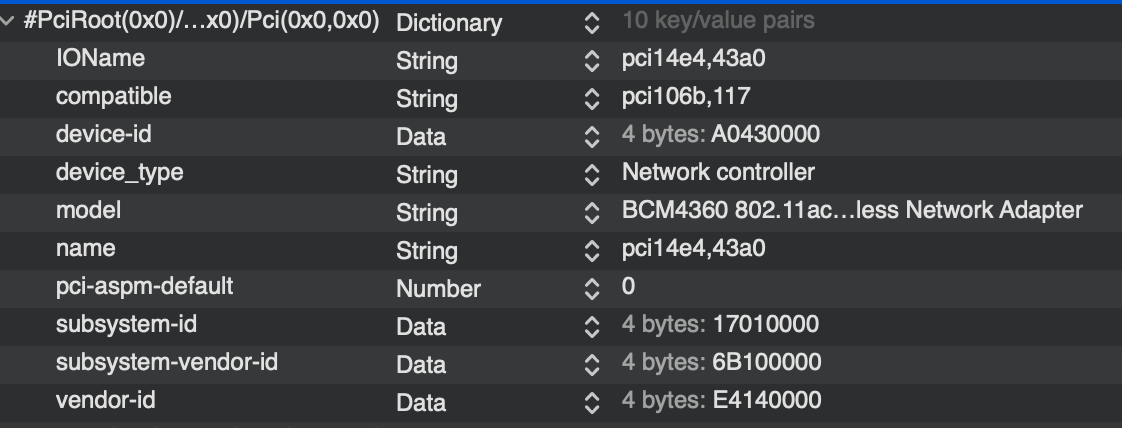

11 hours ago, Res said:
Is there any way to fake intel Wi-Fi card ID as Broadcom one? Then, I can apply OCLP root patch on my hackintosh notebook.
Applying OCLP Wi-Fi root patch can make ventura-AirportItlwm.kext working on sequoia.
I did it, with fake ID injection via opencore.
You need only compatible properties
Quote
            <key>PciRoot(0x0)/Pci(0x1c,0x1)/Pci(0x0,0x0)</key>
            <dict>
                <key>compatible</key>
                <string>pci14e4,43a0</string>
                <key>#pci-aspm-default</key>
                <integer>0</integer>
            </dict>
