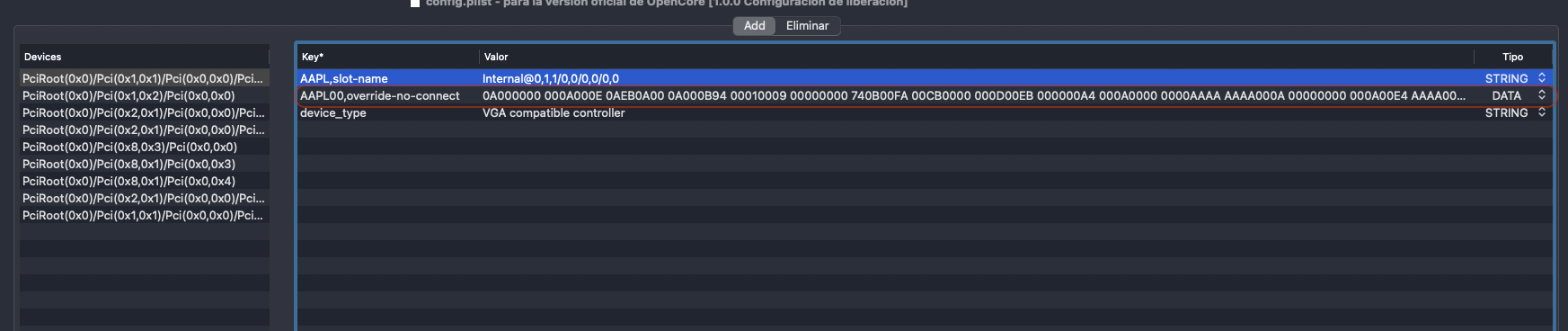

deeveedee Posted June 22, 2024 Share Posted June 22, 2024 @PoMpIs I'm not a graphics expert, but maybe you need to inject EDID. 3 1 Link to comment https://www.insanelymac.com/forum/topic/359530-pre-release-macos-sequoia/page/17/#findComment-2821621 Share on other sites More sharing options...

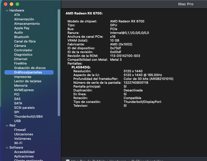

Shaneee Posted June 22, 2024 Share Posted June 22, 2024 4 hours ago, PoMpIs said: Guys... I bought a new monitor: https://iiyama.com/es_es/productos/prolite-xcb4594dqsn-b1/ And Sequoia does not recognize the monitor resolution (5120x1440p@165Hz) It stays at a very low resolution and looks like {censored}... (the same thing happens in Sonoma...) On Windows it works wonderfully I can adjust the resolution with SwitchRes, but I don't like that, should it work without doing anything, or does MacOS not support this screen format? From what I can tell it only supports that resolution either at 60Hz or with certain HDMI 2.1 cables. macOS seems to be fussy about it. SwitchResX or BetterDisplay are your best options, https://github.com/waydabber/BetterDisplay 3 1 Link to comment https://www.insanelymac.com/forum/topic/359530-pre-release-macos-sequoia/page/17/#findComment-2821624 Share on other sites More sharing options...
Stefanalmare Posted June 22, 2024 Share Posted June 22, 2024 3 hours ago, PoMpIs said: Well, it doesn't go with the 6650XT either... MacOS doesn't like this monitor... 😭 We rule out that it is a matter of the RX6700 and NootRX.kext.... In the end I will have to use SwitchResX.... very bad to have to do that at this point to use a monitor ☹️ I had same issue time ago with Samsung odyssey g9. A firmware upgrade of the monitor, resolved my problem. You should wait. 4 1 Link to comment https://www.insanelymac.com/forum/topic/359530-pre-release-macos-sequoia/page/17/#findComment-2821625 Share on other sites More sharing options...
PoMpIs Posted June 22, 2024 Share Posted June 22, 2024 (edited) 56 minutes ago, Shaneee said: From what I can tell it only supports that resolution either at 60Hz or with certain HDMI 2.1 cables. macOS seems to be fussy about it. SwitchResX or BetterDisplay are your best options, https://github.com/waydabber/BetterDisplay Well, I don't like having to use third-party applications for something that MacOS should detect without problems... Another monitor that I have at 3440x1440p@165Hz is recognized perfectly and with variable frequency by FreeSync.... This is also FreeSyn and it neither recognizes the variable frequency nor the maximum resolution... I have extracted the EDID and injected it into Opencore but it does nothing.... ----------------------------------------------------- ------------------- RAW DATA ------------------------ ----------------------------------------------------- 00 01 02 03 04 05 06 07 08 09 0A 0B 0C 0D 0E 0F ----------------------------------------------------- 0 | 00 FF FF FF FF FF FF 00 26 CD 01 09 01 01 01 01 1 | 08 22 01 04 B5 6D 1F 78 3B 2D 65 AD 4F 4A A6 24 2 | 0D 50 54 BF EF 80 71 4F 81 40 81 80 81 C0 95 00 3 | B3 00 D1 C0 01 01 1A 68 00 A0 F0 38 1F 40 30 20 4 | 3A 00 3F 32 41 00 00 1A 00 00 00 FF 00 31 32 32 5 | 32 37 34 30 38 30 30 31 31 38 00 00 00 FD 00 37 6 | A6 F7 F7 82 01 0A 20 20 20 20 20 20 00 00 00 FC 7 | 00 50 4C 34 35 39 34 44 51 0A 20 20 20 20 02 8D ----------------------------------------------------- 00 01 02 03 04 05 06 07 08 09 0A 0B 0C 0D 0E 0F ----------------------------------------------------- 0 | 02 03 34 F1 48 01 03 04 10 11 13 1F 3F 23 09 07 1 | 07 83 01 00 00 6D 1A 00 00 02 03 30 A5 00 04 64 2 | 2D 64 2D E2 00 EA E3 05 E0 00 E6 06 07 01 64 64 3 | 01 E2 0F 80 1C D2 00 B4 F0 38 23 40 30 20 3A 00 4 | 3F 32 41 00 00 1A 6F C2 00 A0 A0 A0 55 50 30 20 5 | 35 00 3F 32 41 00 00 1A 00 00 00 00 00 00 00 00 6 | 00 00 00 00 00 00 00 00 00 00 00 00 00 00 00 00 7 | 00 00 00 00 00 00 00 00 00 00 00 00 00 00 00 63 ----------------------------------------------------- 00 01 02 03 04 05 06 07 08 09 0A 0B 0C 0D 0E 0F ----------------------------------------------------- 0 | 70 12 79 06 00 03 01 64 BE FB 01 88 FF 13 9F 00 1 | 2F 80 3F 00 9F 05 33 00 05 00 07 00 8B 6E 01 08 2 | FF 13 9F 00 2F 80 1F 00 9F 05 28 00 02 00 09 00 3 | A2 03 01 08 FF 13 9F 00 2F 80 1F 00 9F 05 28 00 4 | 02 00 09 00 17 E5 00 08 FF 13 9F 00 2F 80 1F 00 5 | 9F 05 28 00 02 00 09 00 33 B7 00 08 FF 13 9F 00 6 | 2F 80 1F 00 9F 05 28 00 02 00 09 00 00 00 00 00 7 | 00 00 00 00 00 00 00 00 00 00 00 00 00 00 45 90 ----------------------------------------------------- < 00FFFFFF FFFFFF00 26CD0109 01010101 08220104 B56D1F78 3B2D65AD 4F4AA624 0D5054BF EF80714F 81408180 81C09500 B300D1C0 01011A68 00A0F038 1F403020 3A003F32 4100001A 000000FF 00313232 32373430 38303031 31380000 00FD0037 A6F7F782 010A2020 20202020 000000FC 00504C34 35393444 510A2020 2020028D 020334F1 48010304 1011131F 3F230907 07830100 006D1A00 00020330 A5000464 2D642DE2 00EAE305 E000E606 07016464 01E20F80 1CD200B4 F0382340 30203A00 3F324100 001A6FC2 00A0A0A0 55503020 35003F32 4100001A 00000000 00000000 00000000 00000000 00000000 00000000 00000000 00000000 00000000 00000063 70127906 00030164 BEFB0188 FF139F00 2F803F00 9F053300 05000700 8B6E0108 FF139F00 2F801F00 9F052800 02000900 A2030108 FF139F00 2F801F00 9F052800 02000900 17E50008 FF139F00 2F801F00 9F052800 02000900 33B70008 FF139F00 2F801F00 9F052800 02000900 00000000 00000000 00000000 00000000 00004590 > ----------------------------------------------------- { 0x00, 0xFF, 0xFF, 0xFF, 0xFF, 0xFF, 0xFF, 0x00, 0x26, 0xCD, 0x01, 0x09, 0x01, 0x01, 0x01, 0x01, 0x08, 0x22, 0x01, 0x04, 0xB5, 0x6D, 0x1F, 0x78, 0x3B, 0x2D, 0x65, 0xAD, 0x4F, 0x4A, 0xA6, 0x24, 0x0D, 0x50, 0x54, 0xBF, 0xEF, 0x80, 0x71, 0x4F, 0x81, 0x40, 0x81, 0x80, 0x81, 0xC0, 0x95, 0x00, 0xB3, 0x00, 0xD1, 0xC0, 0x01, 0x01, 0x1A, 0x68, 0x00, 0xA0, 0xF0, 0x38, 0x1F, 0x40, 0x30, 0x20, 0x3A, 0x00, 0x3F, 0x32, 0x41, 0x00, 0x00, 0x1A, 0x00, 0x00, 0x00, 0xFF, 0x00, 0x31, 0x32, 0x32, 0x32, 0x37, 0x34, 0x30, 0x38, 0x30, 0x30, 0x31, 0x31, 0x38, 0x00, 0x00, 0x00, 0xFD, 0x00, 0x37, 0xA6, 0xF7, 0xF7, 0x82, 0x01, 0x0A, 0x20, 0x20, 0x20, 0x20, 0x20, 0x20, 0x00, 0x00, 0x00, 0xFC, 0x00, 0x50, 0x4C, 0x34, 0x35, 0x39, 0x34, 0x44, 0x51, 0x0A, 0x20, 0x20, 0x20, 0x20, 0x02, 0x8D, 0x02, 0x03, 0x34, 0xF1, 0x48, 0x01, 0x03, 0x04, 0x10, 0x11, 0x13, 0x1F, 0x3F, 0x23, 0x09, 0x07, 0x07, 0x83, 0x01, 0x00, 0x00, 0x6D, 0x1A, 0x00, 0x00, 0x02, 0x03, 0x30, 0xA5, 0x00, 0x04, 0x64, 0x2D, 0x64, 0x2D, 0xE2, 0x00, 0xEA, 0xE3, 0x05, 0xE0, 0x00, 0xE6, 0x06, 0x07, 0x01, 0x64, 0x64, 0x01, 0xE2, 0x0F, 0x80, 0x1C, 0xD2, 0x00, 0xB4, 0xF0, 0x38, 0x23, 0x40, 0x30, 0x20, 0x3A, 0x00, 0x3F, 0x32, 0x41, 0x00, 0x00, 0x1A, 0x6F, 0xC2, 0x00, 0xA0, 0xA0, 0xA0, 0x55, 0x50, 0x30, 0x20, 0x35, 0x00, 0x3F, 0x32, 0x41, 0x00, 0x00, 0x1A, 0x00, 0x00, 0x00, 0x00, 0x00, 0x00, 0x00, 0x00, 0x00, 0x00, 0x00, 0x00, 0x00, 0x00, 0x00, 0x00, 0x00, 0x00, 0x00, 0x00, 0x00, 0x00, 0x00, 0x00, 0x00, 0x00, 0x00, 0x00, 0x00, 0x00, 0x00, 0x00, 0x00, 0x00, 0x00, 0x00, 0x00, 0x00, 0x00, 0x63, 0x70, 0x12, 0x79, 0x06, 0x00, 0x03, 0x01, 0x64, 0xBE, 0xFB, 0x01, 0x88, 0xFF, 0x13, 0x9F, 0x00, 0x2F, 0x80, 0x3F, 0x00, 0x9F, 0x05, 0x33, 0x00, 0x05, 0x00, 0x07, 0x00, 0x8B, 0x6E, 0x01, 0x08, 0xFF, 0x13, 0x9F, 0x00, 0x2F, 0x80, 0x1F, 0x00, 0x9F, 0x05, 0x28, 0x00, 0x02, 0x00, 0x09, 0x00, 0xA2, 0x03, 0x01, 0x08, 0xFF, 0x13, 0x9F, 0x00, 0x2F, 0x80, 0x1F, 0x00, 0x9F, 0x05, 0x28, 0x00, 0x02, 0x00, 0x09, 0x00, 0x17, 0xE5, 0x00, 0x08, 0xFF, 0x13, 0x9F, 0x00, 0x2F, 0x80, 0x1F, 0x00, 0x9F, 0x05, 0x28, 0x00, 0x02, 0x00, 0x09, 0x00, 0x33, 0xB7, 0x00, 0x08, 0xFF, 0x13, 0x9F, 0x00, 0x2F, 0x80, 0x1F, 0x00, 0x9F, 0x05, 0x28, 0x00, 0x02, 0x00, 0x09, 0x00, 0x00, 0x00, 0x00, 0x00, 0x00, 0x00, 0x00, 0x00, 0x00, 0x00, 0x00, 0x00, 0x00, 0x00, 0x00, 0x00, 0x00, 0x00, 0x45, 0x90 } ----------------------------------------------------- Valid EDID block #0: checksum ok Valid EDID block #1: checksum ok Valid EDID block #2: checksum ok ----------------------------------------------------- ------------------- MAIN EDID BLOCK ----------------- ----------------------------------------------------- EDID Version........1.4 Manufacturer........IVM (26CD) Product ID..........2305 (0901) Serial Number.......01010101 Manufactured........Week 8 of year 2024 Max H Size..........109 cm Max V Size..........31 cm Gamma...............2.20 Display Supported Features: --------------------------- Power Management: Active off Display type: ------------- RGB 4:4:4 & YCrCb 4:4:4 & YCrCb 4:2:2 Color Encoding Formats Display is continuous frequency Default color space is not sRGB standard First detailed Timing includes native Pixel Format and preferred Refresh Rate Input signal & sync: -------------------- Digital Input 10 Bits per Primary Color DisplayPort interface Color info: ----------- Red x = 0.676 Green x = 0.292 Blue x = 0.142 White x = 0.313 Red y = 0.311 Green y = 0.649 Blue y = 0.053 White y = 0.329 Established Timings supported: ------------------------------ # 0: 720 x 400 @ 70Hz # 1: 640 x 480 @ 60Hz # 2: 640 x 480 @ 67Hz # 3: 640 x 480 @ 72Hz # 4: 640 x 480 @ 75Hz # 5: 800 x 600 @ 56Hz # 6: 800 x 600 @ 60Hz # 7: 800 x 600 @ 72Hz # 8: 800 x 600 @ 75Hz # 9: 832 x 624 @ 75Hz #10: 1024 x 768 @ 60Hz #11: 1024 x 768 @ 70Hz #12: 1024 x 768 @ 75Hz #13: 1280 x 1024 @ 75Hz #14: 1152 x 870 @ 75Hz Standard Timing supported: -------------------------- # 0: 1152 x 864 @ 75Hz (714F) # 1: 1280 x 960 @ 60Hz (8140) # 2: 1280 x 1024 @ 60Hz (8180) # 3: 1280 x 720 @ 60Hz (81C0) # 4: 1440 x 900 @ 60Hz (9500) # 5: 1680 x 1050 @ 60Hz (B300) # 6: 1920 x 1080 @ 60Hz (D1C0) Monitor Description blocks: --------------------------- Descriptor #0 - Timing definition: Mode = 3840 x 1080 @ 59.968Hz Pixel Clock............. 266.50 MHz Not Interlaced Horizontal Vertical Active.................. 3840 pixels 1080 lines Front Porch............. 48 pixels 3 lines Sync Width.............. 32 pixels 10 lines Back Porch.............. 80 pixels 18 lines Blanking................ 160 pixels 31 lines Total................... 4000 pixels 1111 lines Scan Rate............... 66.625 kHz 59.968 Hz Image Size.............. 1087 mm 306 mm Border.................. 0 pixels 0 lines Sync: Digital separate with * Negative vertical polarity * Positive horizontal polarity Descriptor #1 - Serial number: 1222740800118 Descriptor #2 - Monitor range: Horizontal frequency range.......247-247 kHz Vertical frequency range.........55-166 Hz Maximum bandwidth range..........1300 MHz Range Limits Only Descriptor #3 - Monitor name: PL4594DQ ----------------------------------------------------- ------------ EXTENSION EDID BLOCK 1 --------------- ----------------------------------------------------- CTA-EXT: CTA 861 Series Extension: ---------------------------------- Revision:...........................3 First DTD block at offset...........48 Display Supports: Underscan on PC modes Basic audio YCbCr 4:4:4 YCbCr 4:2:2 Data Block #1 Video Type: standard CTA Timings VIC # 0: ( 1) 640 x 480 @ 60Hz - 4:3 VIC # 1: ( 3) 720 x 480 @ 60Hz - 16:9 VIC # 2: ( 4) 1280 x 720 @ 60Hz - 16:9 VIC # 3: ( 16) 1920 x 1080 @ 60Hz - 16:9 VIC # 4: ( 17) 720 x 576 @ 50Hz - 4:3 VIC # 5: ( 19) 1280 x 720 @ 50Hz - 16:9 VIC # 6: ( 31) 1920 x 1080 @ 50Hz - 16:9 VIC # 7: ( 63) 1920 x 1080 @ 120Hz - 16:9 Data Block #2 Audio Data Block Supported format: Linear PCM, on 2 channels Supported sample rates (kHz): 32kHz, 44.1kHz, 48kHz Supported sample sizes (bits): 16 bit, 20 bit, 24 bit Data Block #3 Speaker allocation data block Speaker map: FL/FR - Front Left/Right Data Block #4 Vendor specific Data Block - Vendor Identifier: 00:00:1A (AMD) Payload: 02 03 30 A5 00 04 64 2D 64 '..0...d-d' Data Block #5 Extended Data Block: Video Capability Data Block CE scan behaviour: Always Underscanned IT scan behaviour: Always Underscanned PT scan behaviour: Always Underscanned RGB quantization: Selectable (via AVI Q) YCbCr quantization: Selectable (via AVI Q) Data Block #6 Extended Data Block: Colorimetry Data Block BT2020cYCC BT2020YCC BT2020RGB Data Block #7 Extended Data Block: HDR static metadata data block Electro optical transfer functions: Traditional gamma - SDR luminance range Traditional gamma - HDR luminance range SMPTE ST2084 Supported static metadata descriptors: Static metadata type 1 Desired content max luminance: 100 (436.203 cd/m^2) Desired content max frame-average luminance: 100 (436.203 cd/m^2) Desired content min luminance: 1 (0.000 cd/m^2) Data Block #8 Extended Data Block: YCbCr 4:2:0 capability map data block VIC # 7: ( 63) 1920 x 1080 @ 120Hz - 16:9 Detailed Timing Blocks - 1 is native Detailed Timing Block #1 - Timing definition: Mode = 3840 x 1080 @ 120.001Hz Pixel Clock............. 537.88 MHz Not Interlaced Horizontal Vertical Active.................. 3840 pixels 1080 lines Front Porch............. 48 pixels 3 lines Sync Width.............. 32 pixels 10 lines Back Porch.............. 100 pixels 22 lines Blanking................ 180 pixels 35 lines Total................... 4020 pixels 1115 lines Scan Rate............... 133.801 kHz 120.001 Hz Image Size.............. 1087 mm 306 mm Border.................. 0 pixels 0 lines Sync: Digital separate with * Negative vertical polarity * Positive horizontal polarity Detailed Timing Block #2 - Timing definition: Mode = 2560 x 1440 @ 119.998Hz Pixel Clock............. 497.75 MHz Not Interlaced Horizontal Vertical Active.................. 2560 pixels 1440 lines Front Porch............. 48 pixels 3 lines Sync Width.............. 32 pixels 5 lines Back Porch.............. 80 pixels 77 lines Blanking................ 160 pixels 85 lines Total................... 2720 pixels 1525 lines Scan Rate............... 182.996 kHz 119.998 Hz Image Size.............. 1087 mm 306 mm Border.................. 0 pixels 0 lines Sync: Digital separate with * Negative vertical polarity * Positive horizontal polarity ----------------------------------------------------- ------------ EXTENSION EDID BLOCK 2 --------------- ----------------------------------------------------- DID-EXT: Display ID Extension: ------------------------------ DisplayID version........1.2 Display Product Type: DIRECT DRIVE monitor Detailed Timings Block type 1 Detailed Timing #1 in Block Mode = 5120 x 1440 @ 165.000Hz Pixel Clock............. 1299.83 MHz Not Interlaced Horizontal Vertical Active.................. 5120 pixels 1440 lines Front Porch............. 48 pixels 6 lines Sync Width.............. 64 pixels 8 lines Back Porch.............. 48 pixels 38 lines Blanking................ 160 pixels 52 lines Total................... 5280 pixels 1492 lines Scan Rate............... 246.180 kHz 165.000 Hz Is default Mode 3D stereo: no Sync: Digital separate with * Negative vertical polarity * Positive horizontal polarity Detailed Timing #2 in Block Mode = 5120 x 1440 @ 120.000Hz Pixel Clock............. 938.36 MHz Not Interlaced Horizontal Vertical Active.................. 5120 pixels 1440 lines Front Porch............. 48 pixels 3 lines Sync Width.............. 32 pixels 10 lines Back Porch.............. 80 pixels 28 lines Blanking................ 160 pixels 41 lines Total................... 5280 pixels 1481 lines Scan Rate............... 177.720 kHz 120.000 Hz Is not default Mode 3D stereo: no Sync: Digital separate with * Negative vertical polarity * Positive horizontal polarity Detailed Timing #3 in Block Mode = 5120 x 1440 @ 85.000Hz Pixel Clock............. 664.67 MHz Not Interlaced Horizontal Vertical Active.................. 5120 pixels 1440 lines Front Porch............. 48 pixels 3 lines Sync Width.............. 32 pixels 10 lines Back Porch.............. 80 pixels 28 lines Blanking................ 160 pixels 41 lines Total................... 5280 pixels 1481 lines Scan Rate............... 125.884 kHz 85.000 Hz Is not default Mode 3D stereo: no Sync: Digital separate with * Negative vertical polarity * Positive horizontal polarity Detailed Timing #4 in Block Mode = 5120 x 1440 @ 75.001Hz Pixel Clock............. 586.48 MHz Not Interlaced Horizontal Vertical Active.................. 5120 pixels 1440 lines Front Porch............. 48 pixels 3 lines Sync Width.............. 32 pixels 10 lines Back Porch.............. 80 pixels 28 lines Blanking................ 160 pixels 41 lines Total................... 5280 pixels 1481 lines Scan Rate............... 111.076 kHz 75.001 Hz Is not default Mode 3D stereo: no Sync: Digital separate with * Negative vertical polarity * Positive horizontal polarity Detailed Timing #5 in Block Mode = 5120 x 1440 @ 59.977Hz Pixel Clock............. 469.00 MHz Not Interlaced Horizontal Vertical Active.................. 5120 pixels 1440 lines Front Porch............. 48 pixels 3 lines Sync Width.............. 32 pixels 10 lines Back Porch.............. 80 pixels 28 lines Blanking................ 160 pixels 41 lines Total................... 5280 pixels 1481 lines Scan Rate............... 88.826 kHz 59.977 Hz Is not default Mode 3D stereo: no Sync: Digital separate with * Negative vertical polarity * Positive horizontal polarity[/CODE] With BetterDisplay it works at the correct resolution, but you shouldn't have to use that to be able to use the monitor on MacOS... I have already read more people with problems on real Mac computers with problems with these 32:9 monitors 😅 At least there is a solution, with BetterDisplay or SwitchResX it works fine, but it looks bad on the login screen because the native resolution is not activated until BetterDisplay or switchResX is loaded. Thank you so much!! 🤗 Edited June 22, 2024 by PoMpIs 5 Link to comment https://www.insanelymac.com/forum/topic/359530-pre-release-macos-sequoia/page/17/#findComment-2821626 Share on other sites More sharing options...
deeveedee Posted June 22, 2024 Share Posted June 22, 2024 @PoMpIs How did you inject EDID via OpenCore? (asking because I'd like to learn). Thanks. 1 Link to comment https://www.insanelymac.com/forum/topic/359530-pre-release-macos-sequoia/page/17/#findComment-2821627 Share on other sites More sharing options...
PoMpIs Posted June 22, 2024 Share Posted June 22, 2024 8 minutes ago, deeveedee said: @PoMpIs How did you inject EDID via OpenCore? (asking because I'd like to learn). Thanks. I have no idea about this either, it's the first time I've done it... following a tutorial I found on elitemac... But the problem here is the monitor that MacOS doesn't like, I have read that it happened to a lot with real Macs with the 49" Samsung G9 5120x1440@240Hz... I have now sent a mail to iiyama to see what they tell me, because I really like the monitor 😄 1 Link to comment https://www.insanelymac.com/forum/topic/359530-pre-release-macos-sequoia/page/17/#findComment-2821628 Share on other sites More sharing options...
Stefanalmare Posted June 22, 2024 Share Posted June 22, 2024 34 minutes ago, PoMpIs said: I have no idea about this either, it's the first time I've done it... following a tutorial I found on elitemac... But the problem here is the monitor that MacOS doesn't like, I have read that it happened to a lot with real Macs with the 49" Samsung G9 5120x1440@240Hz... I have now sent a mail to iiyama to see what they tell me, because I really like the monitor 😄 With firmware updated I have 49" Samsung G9 5120x1440@variable freq (60 to 240). Sonoma and sequoia. Some time ago, true, I had problems like you. 3 Link to comment https://www.insanelymac.com/forum/topic/359530-pre-release-macos-sequoia/page/17/#findComment-2821630 Share on other sites More sharing options...
PlutoDelic Posted June 22, 2024 Share Posted June 22, 2024 (edited) 7 hours ago, PoMpIs said: Guys... I bought a new monitor: https://iiyama.com/es_es/productos/prolite-xcb4594dqsn-b1/ And Sequoia does not recognize the monitor resolution (5120x1440p@165Hz) It stays at a very low resolution and looks like {censored}... (the same thing happens in Sonoma...) On Windows it works wonderfully I can adjust the resolution with SwitchRes, but I don't like that, should it work without doing anything, or does MacOS not support this screen format? Had a hard time with this myself Edited June 22, 2024 by PlutoDelic 2 Link to comment https://www.insanelymac.com/forum/topic/359530-pre-release-macos-sequoia/page/17/#findComment-2821631 Share on other sites More sharing options...

PoMpIs Posted June 22, 2024 Share Posted June 22, 2024 (edited) 2 hours ago, Stefanalmare said: With firmware updated I have 49" Samsung G9 5120x1440@variable freq (60 to 240). Sonoma and sequoia. Some time ago, true, I had problems like you. If the problem is the EDID, I would need the manufacturer to provide me with an update in which the EDID contains the resolution 5120x1440p@165Hz I have extracted the information from the monitor in Windows and it does not show 5120x1440p, it only shows 3840x1080p, which is what MacOS recognizes as maximum 😑 ; INF file generated by Monitor Asset Manager (2.91.0.1043), 22/06/2024 ; Copyright (c) 1995-2019, EnTech Taiwan. ; Internet: http://www.entechtaiwan.com [Version] Signature="$WINDOWS NT$" Class=Monitor ClassGUID={4d36e96e-e325-11ce-bfc1-08002be10318} Provider=%MFG% DriverVer=22/06/2024, 1.0.0.0 ;CatalogFile=YourSignedCatalogFile.cat [DestinationDirs] DefaultDestDir=23 [SourceDisksNames] 1=%DISC% [SourceDisksFiles] ;YourColorProfileFile.icm [Manufacturer] %VENDOR%=EDID_OVERRIDE,NTx86,NTamd64 [EDID_OVERRIDE.NTx86] %PRODUCTID%=OVERRIDDEN-EDID.Install, MONITOR\IVM0901 [EDID_OVERRIDE.NTamd64] %PRODUCTID%=OVERRIDDEN-EDID.Install.NTamd64, MONITOR\IVM0901 [OVERRIDDEN-EDID.Install.NTx86] DelReg=DEL_CURRENT_REG AddReg=OVERRIDDEN-EDID.AddReg, MODE1, DPMS CopyFiles=OVERRIDDEN-EDID.CopyFiles [OVERRIDDEN-EDID.Install.NTamd64] DelReg=DEL_CURRENT_REG AddReg=OVERRIDDEN-EDID.AddReg, MODE1, DPMS CopyFiles=OVERRIDDEN-EDID.CopyFiles [OVERRIDDEN-EDID.Install.NTx86.HW] AddReg=OVERRIDDEN-EDID_AddReg [OVERRIDDEN-EDID.Install.NTamd64.HW] AddReg=OVERRIDDEN-EDID_AddReg [OVERRIDDEN-EDID_AddReg] ;Base EDID HKR,EDID_OVERRIDE,"0",0x01,0x00,0xFF,0xFF,0xFF,0xFF,0xFF,0xFF,0x00,0x26,0xCD,0x01,0x09,0x01,0x01,0x01,0x01,0x08,0x22,0x01,0x04,0xB5,0x6D,0x1F,0x78,0x3B,0x2D,0x65,0xAD,0x4F,0x4A,0xA6,0x24,0x0D,0x50,0x54,0xBF,0xEF,0x80,0x71,0x4F,0x81,0x40,0x81,0x80,0x81,0xC0,0x95,0x00,0xB3,0x00,0xD1,0xC0,0x01,0x01,0x1A,0x68,0x00,0xA0,0xF0,0x38,0x1F,0x40,0x30,0x20,0x3A,0x00,0x3F,0x32,0x41,0x00,0x00,0x1A,0x00,0x00,0x00,0xFF,0x00,0x31,0x32,0x32,0x32,0x37,0x34,0x30,0x38,0x30,0x30,0x31,0x31,0x38,0x00,0x00,0x00,0xFD,0x00,0x37,0xA6,0xF7,0xF7,0x82,0x01,0x0A,0x20,0x20,0x20,0x20,0x20,0x20,0x00,0x00,0x00,0xFC,0x00,0x50,0x4C,0x34,0x35,0x39,0x34,0x44,0x51,0x0A,0x20,0x20,0x20,0x20,0x02,0x8D ;Extension bloc #1, e.g., CEA/CTA-EXT, DID-EXT, etc. HKR,EDID_OVERRIDE,"1",0x01,0x02,0x03,0x34,0xF1,0x48,0x01,0x03,0x04,0x10,0x11,0x13,0x1F,0x3F,0x23,0x09,0x07,0x07,0x83,0x01,0x00,0x00,0x6D,0x1A,0x00,0x00,0x02,0x03,0x30,0xA5,0x00,0x04,0x64,0x2D,0x64,0x2D,0xE2,0x00,0xEA,0xE3,0x05,0xE0,0x00,0xE6,0x06,0x07,0x01,0x64,0x64,0x01,0xE2,0x0F,0x80,0x1C,0xD2,0x00,0xB4,0xF0,0x38,0x23,0x40,0x30,0x20,0x3A,0x00,0x3F,0x32,0x41,0x00,0x00,0x1A,0x6F,0xC2,0x00,0xA0,0xA0,0xA0,0x55,0x50,0x30,0x20,0x35,0x00,0x3F,0x32,0x41,0x00,0x00,0x1A,0x00,0x00,0x00,0x00,0x00,0x00,0x00,0x00,0x00,0x00,0x00,0x00,0x00,0x00,0x00,0x00,0x00,0x00,0x00,0x00,0x00,0x00,0x00,0x00,0x00,0x00,0x00,0x00,0x00,0x00,0x00,0x00,0x00,0x00,0x00,0x00,0x00,0x00,0x00,0x63 [DEL_CURRENT_REG] HKR,MODES HKR,EDID_OVERRIDE HKR,,MaxResolution HKR,,PreferredMode HKR,,DPMS HKR,,ICMProfile [DPMS] HKR,,DPMS,,1 HKR,,PreferredMode,,"3840,1080,60" [MODE1] HKR,,MaxResolution,,"3840,1080,60" [OVERRIDDEN-EDID.AddReg] HKR,"MODES\3840,1080,60",Mode1,,"247.0-247.0,55.0-166.0,+,+" [OVERRIDDEN-EDID.CopyFiles] ;YourColorProfileFile.icm for non-sRGB displays [Strings] MFG="EnTech Taiwan" DISC="Monitor EDID Override Installation Disk" PRODUCTID="Iiyama PL4594DQ (IVM0901 EDID Override)" VENDOR="Iiyama"[/CODE] 38 minutes ago, cankiulascmnfye said: I've noticed issues with external displays myself, so just wait for the next update. This is beta software after all… It also happens in Sonoma, it is a problem with the EDID of the monitor 😔 Edited June 22, 2024 by PoMpIs Link to comment https://www.insanelymac.com/forum/topic/359530-pre-release-macos-sequoia/page/17/#findComment-2821633 Share on other sites More sharing options...
deeveedee Posted June 23, 2024 Share Posted June 23, 2024 3 hours ago, PoMpIs said: It also happens in Sonoma, it is a problem with the EDID of the monitor 😔 This looks interesting. 1 1 Link to comment https://www.insanelymac.com/forum/topic/359530-pre-release-macos-sequoia/page/17/#findComment-2821635 Share on other sites More sharing options...

deeveedee Posted June 23, 2024 Share Posted June 23, 2024 (edited) 20 minutes ago, Stefanalmare said: Done that time ago. Nothing spectacular. Not looking for spectacular - just that it works. Does FixEDID successfully add unspecified monitor resolutions to an existing EDID? I have no experience with it (or any EDID editing). EDIT: @PlutoDelic 's earlier post here and the linked thread suggest that OC-injected EDID don't affect macOS (only UEFI), so I'm not sure if EDID editing will help. Edited June 23, 2024 by deeveedee Link to comment https://www.insanelymac.com/forum/topic/359530-pre-release-macos-sequoia/page/17/#findComment-2821644 Share on other sites More sharing options...

Stefanalmare Posted June 23, 2024 Share Posted June 23, 2024 1 hour ago, deeveedee said: Not looking for spectacular - just that it works. Does FixEDID successfully add unspecified monitor resolutions to an existing EDID? I have no experience with it (or any EDID editing). EDIT: @PlutoDelic 's earlier post here and the linked thread suggest that OC-injected EDID don't affect macOS (only UEFI), so I'm not sure if EDID editing will help. Everytime I had problem with monitors resolution, I tried this method. No help, for me at least. 1 Link to comment https://www.insanelymac.com/forum/topic/359530-pre-release-macos-sequoia/page/17/#findComment-2821647 Share on other sites More sharing options...

PoMpIs Posted June 23, 2024 Share Posted June 23, 2024 14 hours ago, deeveedee said: This looks interesting. Yes, I have already tried all the options, including the one you recommend... nothing works, I can only reach the maximum resolution of the monitor with SitchresX or BetterDisplay 🤷♂️ Link to comment https://www.insanelymac.com/forum/topic/359530-pre-release-macos-sequoia/page/17/#findComment-2821651 Share on other sites More sharing options...
