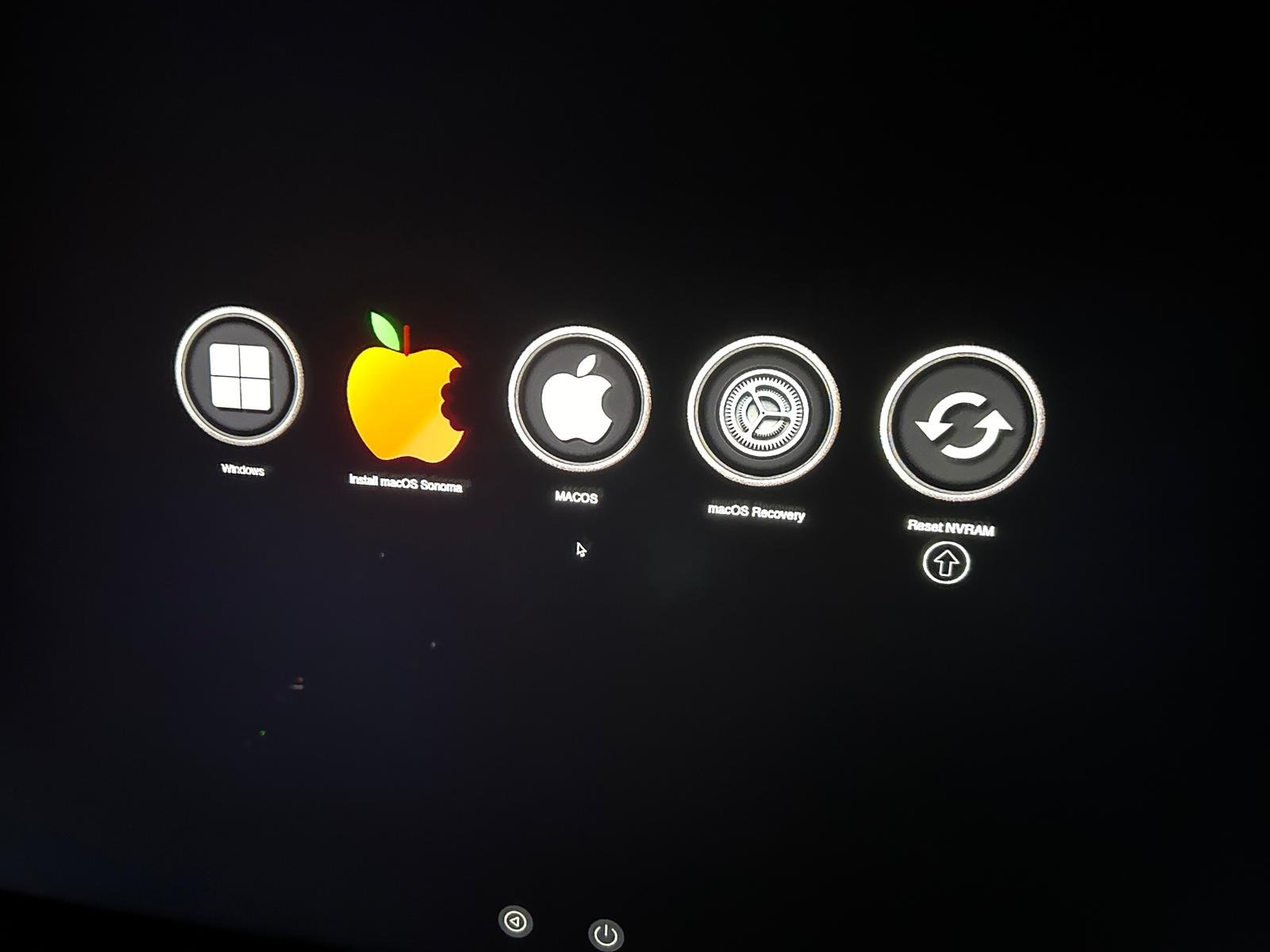

MaLd0n Posted June 2, 2024 Share Posted June 2, 2024 Here we go EFI kuzens.zip -Bios/UEFI in full default settings -Last Bios/UEFI Version -Delete old EFI folder and paste new. Don't use merge files -Don't use Drag and Drop into EFI partition. Use Copy/Paste instead -Reset NVRAM one time - with OpenCore use entry "Reset Nvram" / with Clover use F11 key on boot screen Quote Link to comment https://www.insanelymac.com/forum/topic/359480-how-to-install-hackintosh-on-14900ks-rx550-system/#findComment-2820654 Share on other sites More sharing options...

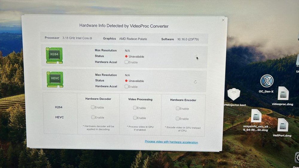

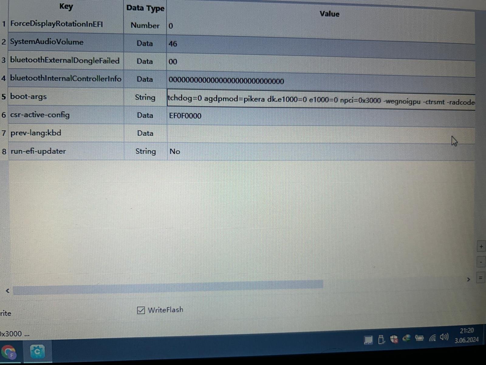

kuzens Posted June 3, 2024 Author Share Posted June 3, 2024 14 hours ago, MaLd0n said: İşte başlıyoruz EFI kuzens.zip -Bios/UEFI tam varsayılan ayarlarda -Son Bios/UEFI Sürümü -Eski EFI klasörünü silin ve yenisini yapıştırın. Birleştirme dosyalarını kullanmayın -EFI bölümüne Sürükle ve Bırak özelliğini kullanmayın. Bunun yerine Kopyala/Yapıştır'ı kullanın -NVRAM'i bir kez sıfırlayın - OpenCore ile "Nvram'ı Sıfırla" girişini kullanın / Clover ile önyükleme ekranında F11 tuşunu kullanın RX 550(Lexa) I think the hardware acceleration of this device is problematic. Thank you for your interest. Quote Link to comment https://www.insanelymac.com/forum/topic/359480-how-to-install-hackintosh-on-14900ks-rx550-system/#findComment-2820677 Share on other sites More sharing options...
MaLd0n Posted June 3, 2024 Share Posted June 3, 2024 Test this Quote Link to comment https://www.insanelymac.com/forum/topic/359480-how-to-install-hackintosh-on-14900ks-rx550-system/#findComment-2820678 Share on other sites More sharing options...
Cyberdevs Posted June 3, 2024 Share Posted June 3, 2024 4 hours ago, kuzens said: RX 550(Lexa) I think the hardware acceleration of this device is problematic. Thank you for your interest. To fix this, type in the terminal defaults write com.apple.AppleGVA gvaForceAMDAVCDecode -boolean yes This might resolve the DVA decoder issue. 1 Quote Link to comment https://www.insanelymac.com/forum/topic/359480-how-to-install-hackintosh-on-14900ks-rx550-system/#findComment-2820679 Share on other sites More sharing options...

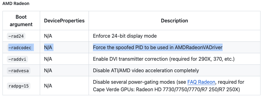

AslashA Posted June 3, 2024 Share Posted June 3, 2024 7 hours ago, kuzens said: RX 550(Lexa) I think the hardware acceleration of this device is problematic. Thank you for your interest. In bootargs -radcodec 1 Quote Link to comment https://www.insanelymac.com/forum/topic/359480-how-to-install-hackintosh-on-14900ks-rx550-system/#findComment-2820683 Share on other sites More sharing options...

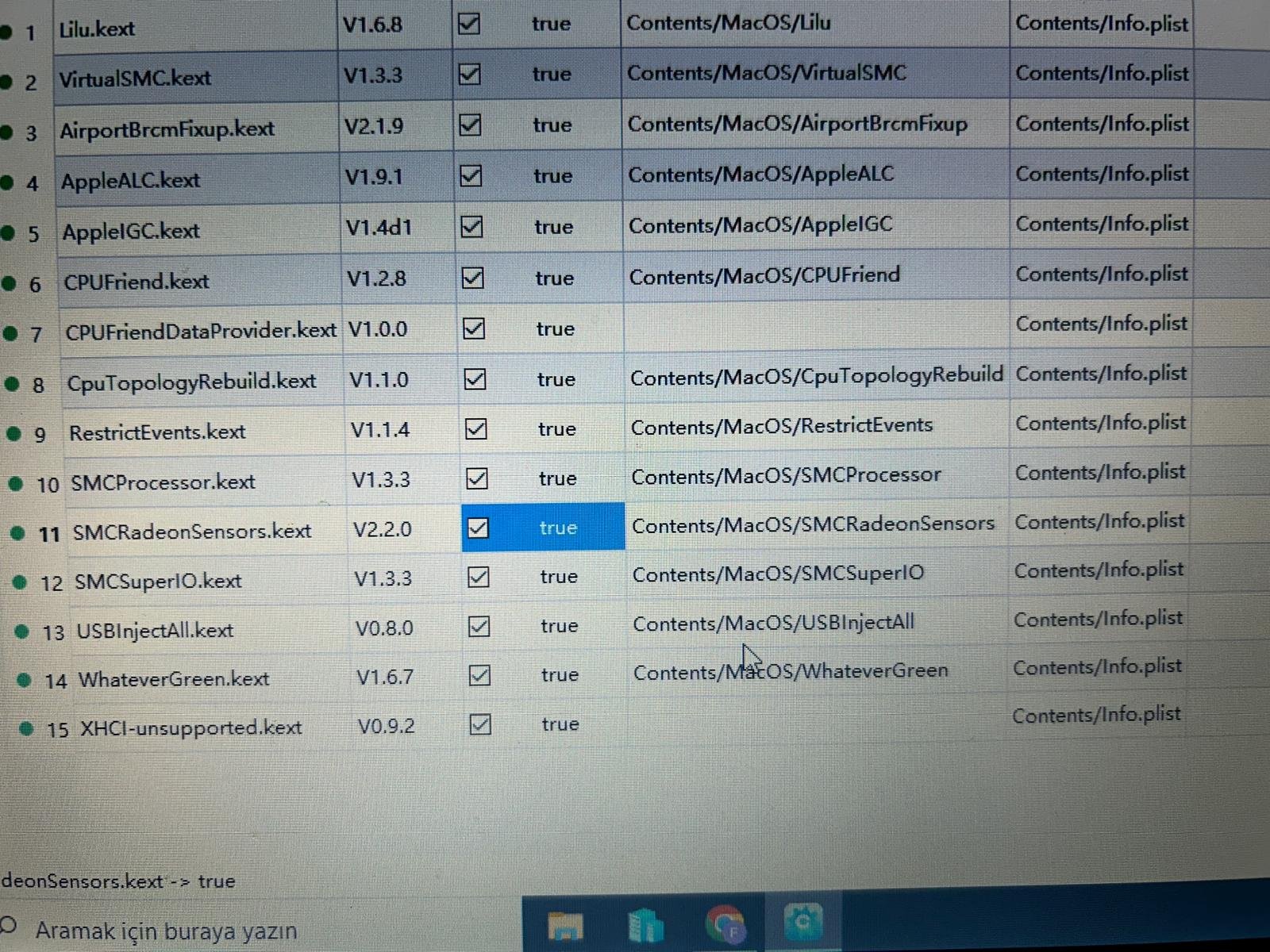

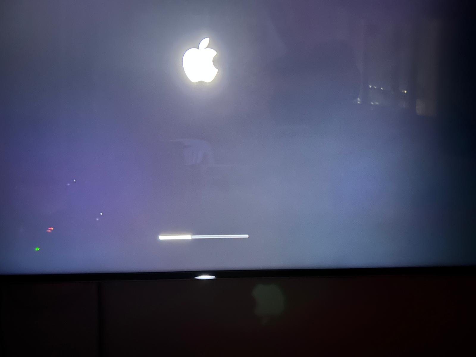

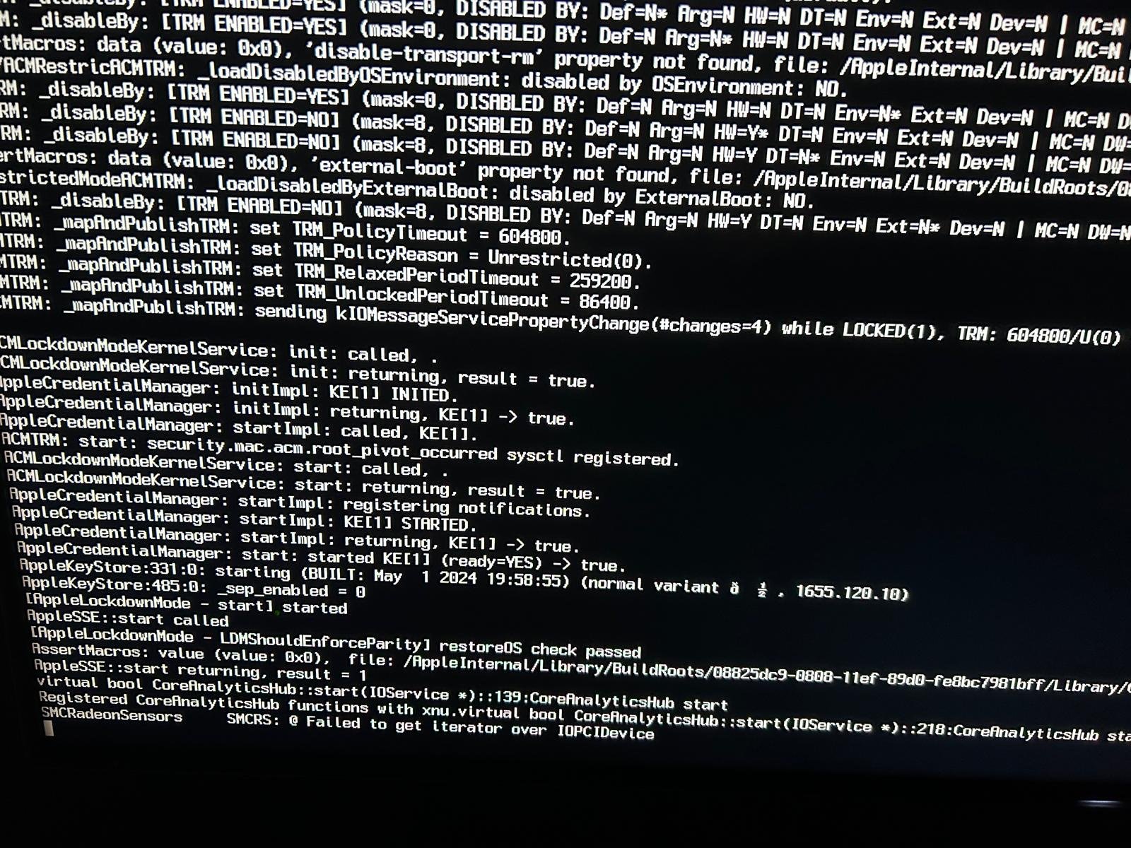

kuzens Posted June 3, 2024 Author Share Posted June 3, 2024 (edited) 9 saat önce MaLd0n şunları söyledi: Bunu test et EFI 02.zip adım adım yapıldı sistem açılmıyor Edited June 3, 2024 by kuzens Quote Link to comment https://www.insanelymac.com/forum/topic/359480-how-to-install-hackintosh-on-14900ks-rx550-system/#findComment-2820690 Share on other sites More sharing options...
