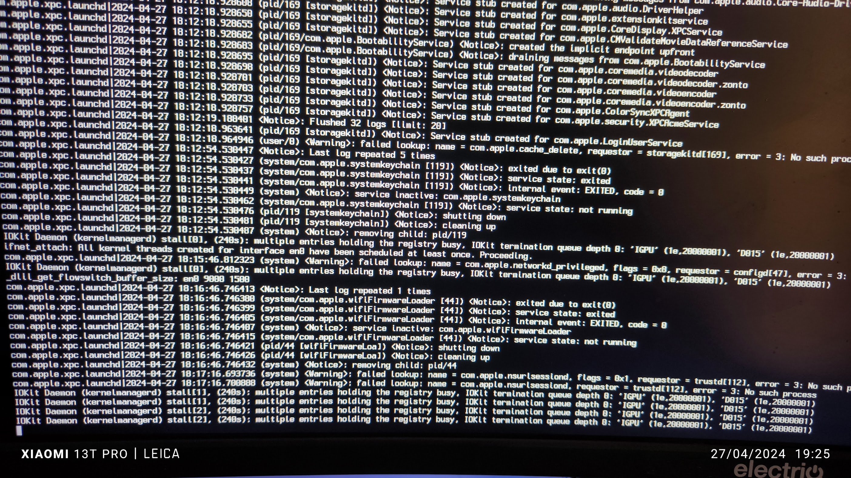

Hi all.
I successfully managed to install Mac OS on MSI PRO DP20Z 5M with Ryzen 7 5700G with integrated graphics.

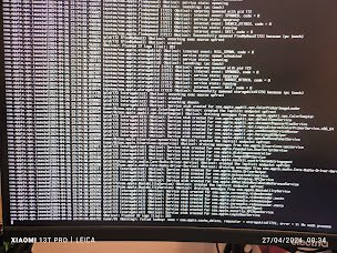

System installs properly ( both Ventura and Sonoma tried). I can boot to mac os recovery without any issues. But after installation when system should boot normally it stucks.

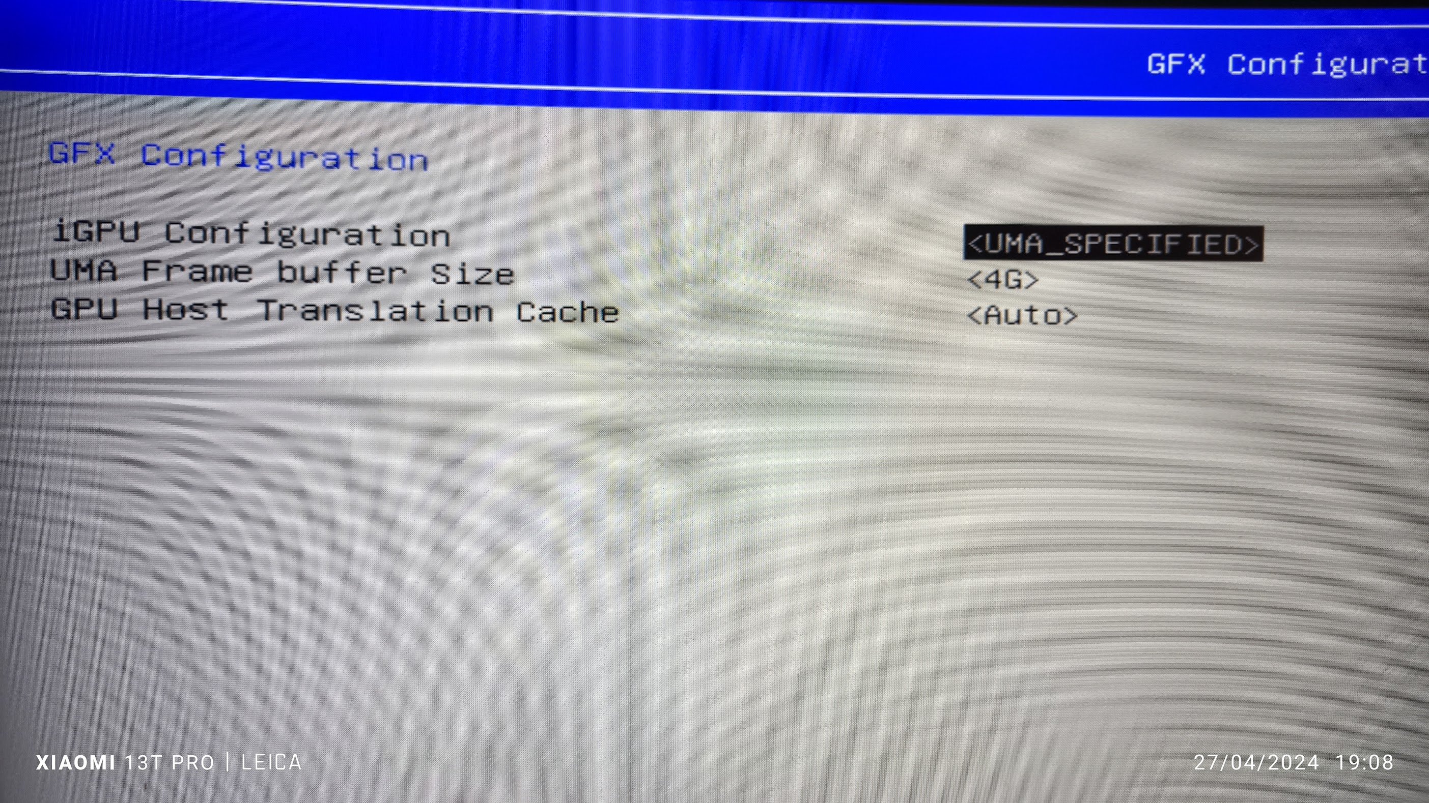

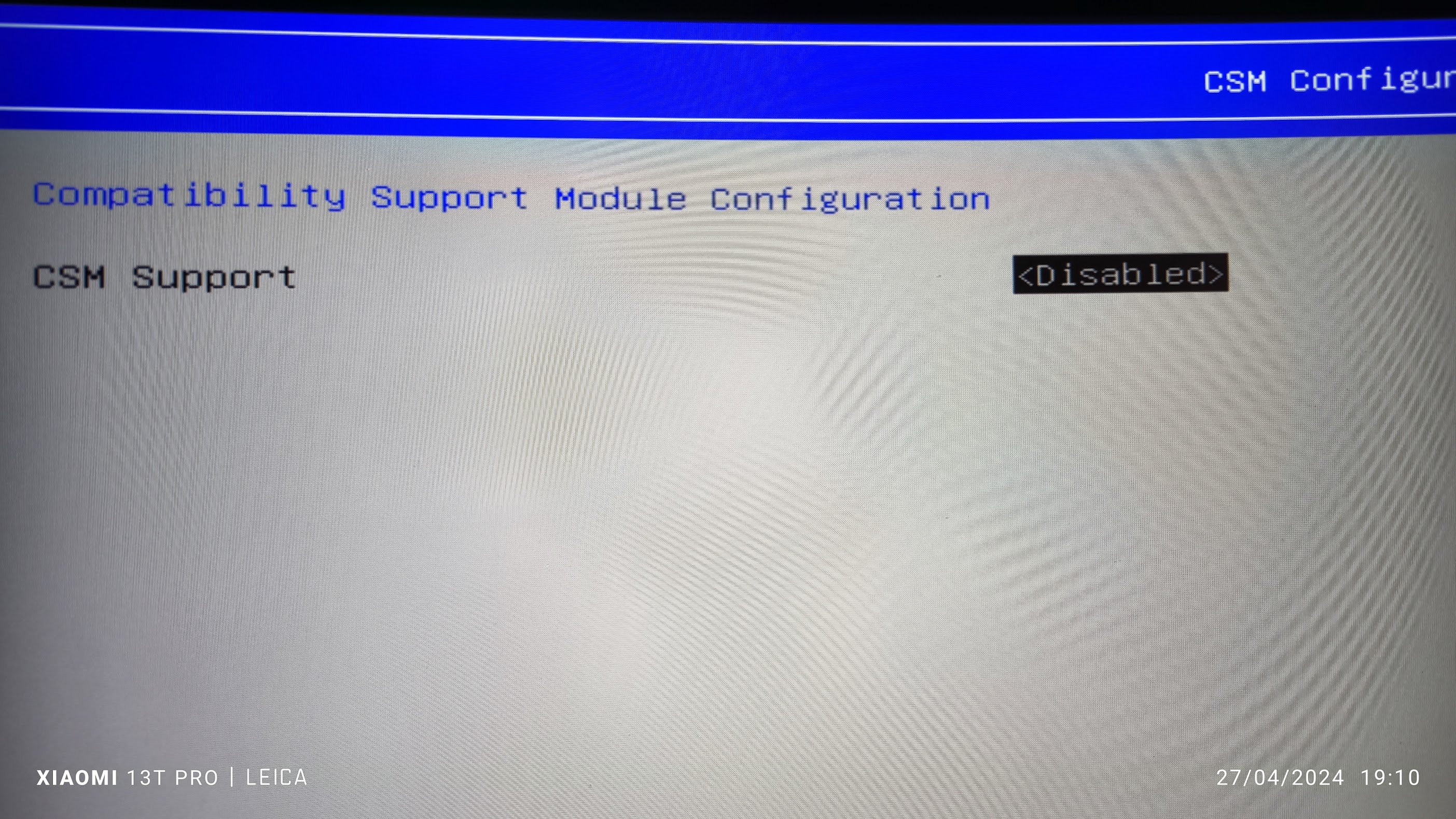

I did all required settings in BIOS ( disabled fastboot, secure boot, CSM and set VRAM to 4G). I put NootedRed into kexts and enabled it in config.plist.
What else am I doing wrong?
Any help and suggestions please?
Thank you
IMG_20240427_190726.jpgconfig.zip

Did you remove Whatevergreen? You can't have it enabled when using NootedRed. See the prerequisites here, https://chefkissinc.github.io/nred#prerequisites
@ShaneeeWhat nonsense did I write up there? Damn! So it does work after all, Shanee

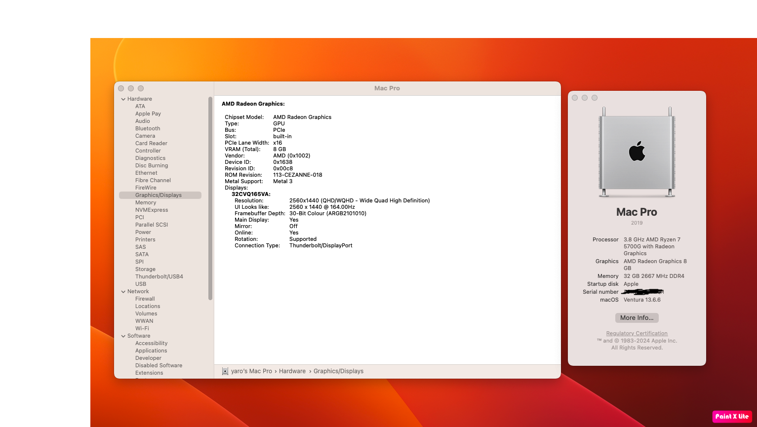

I never give up 😁
Finally did it.
Now trying to make Sonoma update but it resists hardUntitled.thumb.png.81db39449cbd2c4b8114247948ea2bad.png

13 hours ago, yarecco said:
I never give up 😁
Finally did it.
