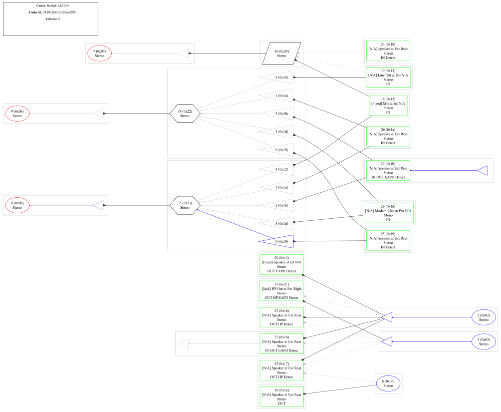

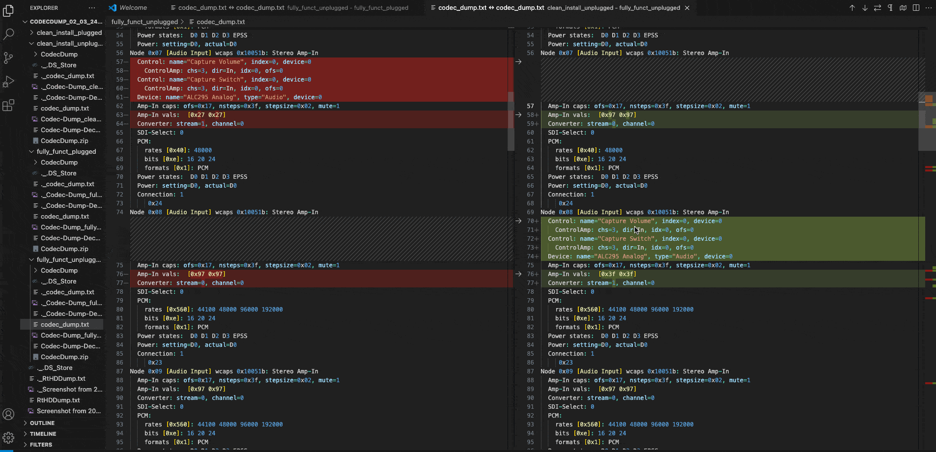

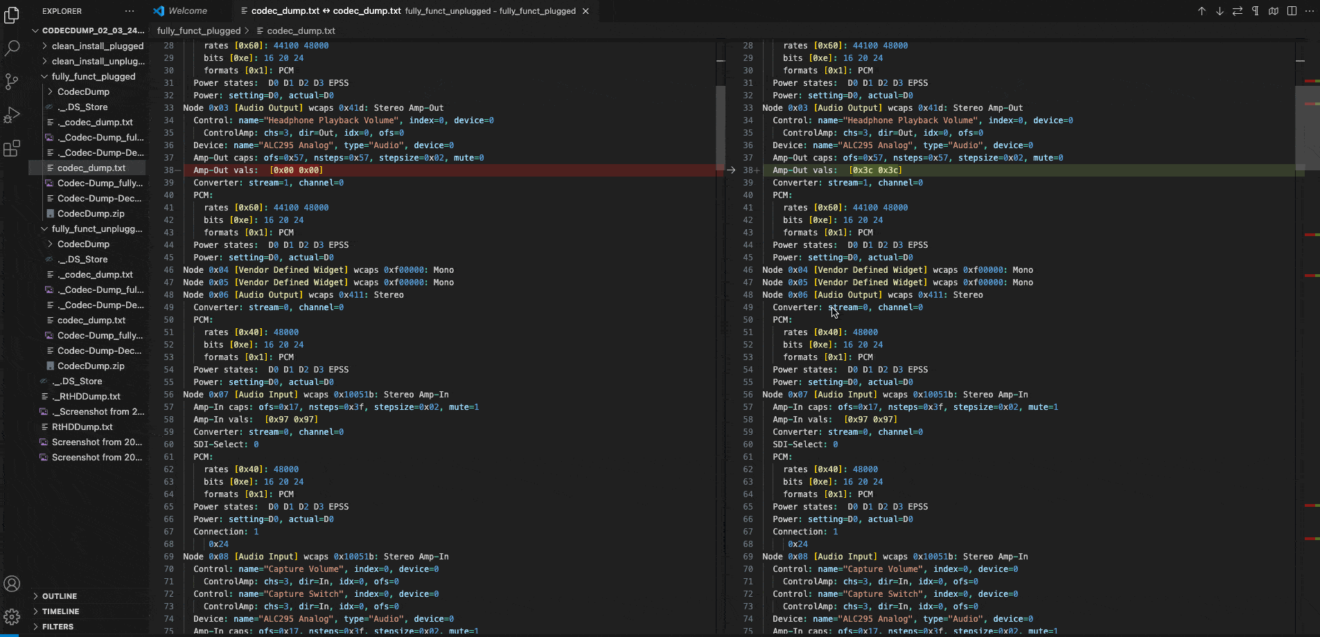

iwissem Posted April 3, 2024 Share Posted April 3, 2024 Hello! I am currently finishing to setup my first hackintosh on my Acer Nitro 5 AN515-55-51QY laptop and I am stuck on the last thing : configuring properly the audio. My codec is ALC295. For the setup I am using OpenCore 0.9.8 and macOS Sonoma 14.3.1, and the AppleALC kext V.1.8.9 . The issue is that, with the best working layout-ids (13 and 77) for my config, when I plug my HyperX Cloud II single jack headset to my laptop I get a continuous high-pitched hissing/static noise. When no audio is played I only hear that noise, otherwise I still can hear it in the background and it's giving me a headache. The headsets microphone is also not detected but the internal speakers and microphone are working perfectly. What boggles my mind is that contrarily to many hackintoshers, a sleep-wake cycle fixes part of the issue, I noticed that when I put my computer totally to sleep then wake it up, the hissing noise totally disappears (tried for hours). This gives me hope to find a solution! I tried to find a solution on my own but am not making any progress here anymore so I am seeking for your help. To give you more information to help me, here's what I have tried and noticed so far: On Ubuntu I had the exact same issue with my jack headset (hissing noise and non functional mic) on a clean install of the latest ubuntu bistro, but I found a way to fix it How? thanks to this discussion I solved the issue on ubuntu by only entering this command in the terminal : echo 'options snd-hda-intel model=dell-headset-multi' | sudo tee /etc/modprobe.d/alsa-base.conf I compared the codecdumps obtained on a clean install and after patching the audio with that command and I noticed that many of the fields have been modified. I also compared the fully functional codecdump when the headset is unplugged then plugged and I noticed that some coefficient have been modified. Here I found interesting that according to whether jack is plugged or not: the "Amp-out Vals" of the nodes 2(0x02) and 3(0x03) automatically switch antithetically between disabled state (0x00) and enabled (0x3c) (cf. line 25 and 38) . the "Amp-out Vals" of the nodes 20(0x14) & 33(0x21) automatically switch antithetically between disabled state (0x80) and enabled (0x00) (cf. line 135 & 265). the audio mixer 35(0x23) switches the "Amp-in Vals" of the connected nodes 25(0x19) and 18(0x12) automatically switch antithetically between disabled state (0x80) and enabled (0x00) (cf. line 284). I also followed the AppleALC Guides to produce my own layout: What worked best for me was the following pathmaps: Internal speakers: 20(0x14)-->2(0x02) Internal microphone: 8(0x08)-->35(0x23)-->18(0x12) headsets jack speakers: 33(0x21)-->3(0x03) headsets jack microphone: 8(0x08)-->35(0x23)-->25(0x19) I also tried multiple changes for the pinconfig that you can find in the attached file Using pinconfigurator Raw generated pinconfig from codecdump Patched generated pinconfig from codecdump Creating my own pinconfig manually using the codec dumps, and the verbs obtained on ubuntu after patching. I assumed that the audio problem I had was due to wrong pinconfigs and that init_pin_configs hasn't been modified by the command I entered contrarily to the driver_pin_configs file. patched driver pinconfig file linux Finally I noticed that with layout 13 and the combo jack kext from this repo the headsets microphone becomes perfectly functional but it doesn't fix the hissing noise. If you need more information on my configuration here is Github my repository. Link to comment https://www.insanelymac.com/forum/topic/359119-alc295-acer-nitro-5-continuous-hissing-noise-with-35-combojack-headphones/ Share on other sites More sharing options...
