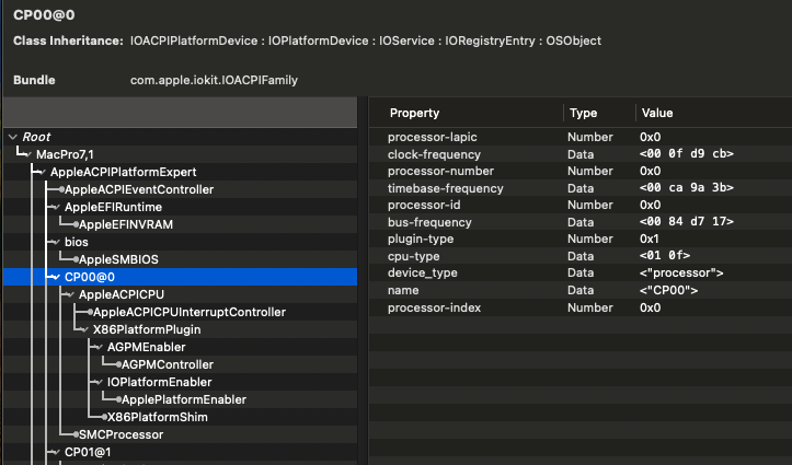

Yes, I can read Russian! Thanks! That’s an awesome resource! Frankly speaking I prefer to keep OpenCore but I’ll read the PDF in regards to FSB, maybe I’ll get an idea on how to solve it in OC.
@Slice could you briefly explain how you managed to see that my FSB frequency is 10% higher? I removed the CPUFriend / CPUFriendDataProvider and CpuTopologyRebuild kext files since I have the feeling that they are not needed any more (after Monterey 12.3 and onwards). And from what I see, X86PlatformPlugin is present in IORegistryExplorer:
Previously, (I guess before Monterey v12.3), X86PlatformPlugin wasn't visible without CPUFriend and CPUFriendDataProvider, so you had to have them if your system was wearing an unsupported CPU. By reading the PDF, as understand that Clover is taking a completely different approach, which is hard-seting FSB frequency (usually at 100MHz which for most CPUs is the norm, but, for my CPU, 13700K, the TDP is 125W), contrary, OC calculates it.

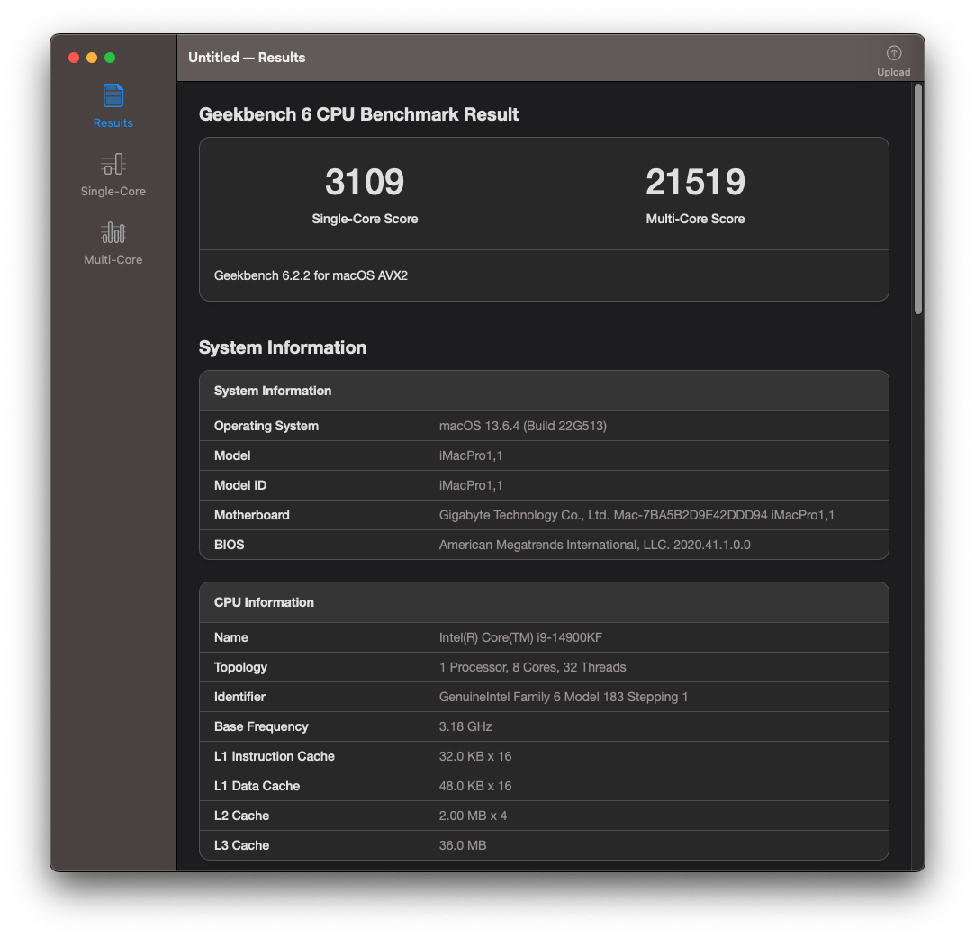

My CPU Geekbench scores are pretty much the same (within the accepted marginal error), so, basically, without having these kexts I'm not losing any performance. In terms of wattage (Power Management) and temps, I notice the same behaviour, which, I assume renders these kexts useless, no?
In "About This Mac" the processor is visible as "3,42 GHz 24-Core Intel Xeon W", which, I assume is cosmetic, therefore I'm fine with that. Sensei detects the CPU properly:
I'm gonna do some testing and see if that fixes the audio cuts (which I really hope it does because that issue has bothered me since I built this Hackintosh).
Edited by panosru
I encountered same audio behaviour when FSBFrequency calculated wrong. 100000 is not good value. By best result is 99720.
Let Clover automatically calculate it.
I have removed CPUFriend / CPUFriendDataProvider and CpuTopologyRebuild kexts, I have to admit it improved the audio stability very much, but I already encountered a few times that the audio was cut for a split second (a couple of times when opening a new tab in Safari and another couple of times when installing a pkg). I tried to find a way to adjust the FSB frequency in OpenCore, but I couldn't. It seems that on that matter Clover is easier to control, but, I'm not willing to switch over to Clover since I used to have many issues with Clover (especially when upgrading the OS), and OC was rock solid since I switched to it.
If anyone knows a way to regulate the FSB frequency in OpenCore somehow, please share. Also, I'm not 100% sure that FSB frequency is completely at fault here since I don't know how to check the FSB frequency value that is calculated, so, any additional ideas are more than welcome.
