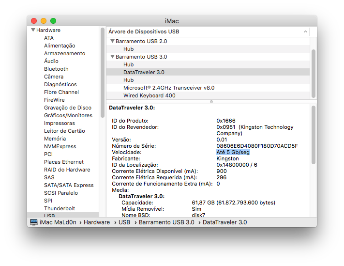

MaLd0n Posted January 24, 2018 Share Posted January 24, 2018 ur usb3 work in 5gb? Check here with one Device USB3 Link to comment https://www.insanelymac.com/forum/topic/331874-usb-sound-assertion-usb-audio-interface-briefly-stuttering-occasionally/#findComment-2575942 Share on other sites More sharing options...
ronniegold Posted January 24, 2018 Author Share Posted January 24, 2018 Some details from my System Information- https://imgur.com/a/d1POq All looks normal to me? USB 3 seems to work at full speed... 1 Link to comment https://www.insanelymac.com/forum/topic/331874-usb-sound-assertion-usb-audio-interface-briefly-stuttering-occasionally/#findComment-2576021 Share on other sites More sharing options...
MaLd0n Posted January 24, 2018 Share Posted January 24, 2018 Yes, work correct Link to comment https://www.insanelymac.com/forum/topic/331874-usb-sound-assertion-usb-audio-interface-briefly-stuttering-occasionally/#findComment-2576026 Share on other sites More sharing options...

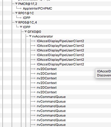

ronniegold Posted January 24, 2018 Author Share Posted January 24, 2018 Can no longer seem to reproduce the original error... even though i have plugged everything back into the mobo?! I had to move my GPU to another slot to install the USB pci card. I discovered that my GPU should have been in the new slot as its 16x, and the other is 4x - and to add to that, i have a wifi card in PCIE5, which would have meant my GPU was running at 2x (asrock z370 pro4 manual states this). Could this have been the problem all along?! Maybe my GPU was causing the problem? Or maybe it was causing a bottleneck? Does this sound likely? Link to comment https://www.insanelymac.com/forum/topic/331874-usb-sound-assertion-usb-audio-interface-briefly-stuttering-occasionally/#findComment-2576068 Share on other sites More sharing options...
MaLd0n Posted January 25, 2018 Share Posted January 25, 2018 u put GPU in x16 slot and solve? if u use GPU in other slot(x8, x4) u loose many performance check, ur GPU stay in RP05, is very rare in serie 100/200/300 the common device is PEG0/PEGP Link to comment https://www.insanelymac.com/forum/topic/331874-usb-sound-assertion-usb-audio-interface-briefly-stuttering-occasionally/#findComment-2576102 Share on other sites More sharing options...
ronniegold Posted January 25, 2018 Author Share Posted January 25, 2018 Wow i think this is solved. Now that i've moved the GFX card to the correct PCIE slot, its now in PEG0 in ioreg (i have no idea what this is, but its the correct way?). If this is fixed i will be so happy! How ridiculous that the $5 usb card fixed it by accident - because i had to move the GFX card to fit the new USB card in the case! This means my GFX card was running at 2x, not 16x which must have caused the errors! I have no idea why it affects the USB audio only. It didn't seem to have a problem with onboard audio... Also, I don't think a slow GFX card should affect audio? But If its fixed i won't complain! Thank you so much for your help Mald0n, I'll update this thread if i have any more problems, but i think it might be solved! I'll keep an eye on my console. EDIT - I get a USB Sound assertion if I plug an external HDD into the cases top USB 2.0 ports, but not the 3.0 (its a fractal r4 case). I don't get an assertion plugging into the any of the other USB ports (including the USB 2.0 PCI card at the back)... This doesn't feel rock solid... but as long as i don't get assertions randomly while using the machine i don't really mind about this.. I'll keep this updated with my findings if there are more problems. 1 Link to comment https://www.insanelymac.com/forum/topic/331874-usb-sound-assertion-usb-audio-interface-briefly-stuttering-occasionally/#findComment-2576125 Share on other sites More sharing options...
