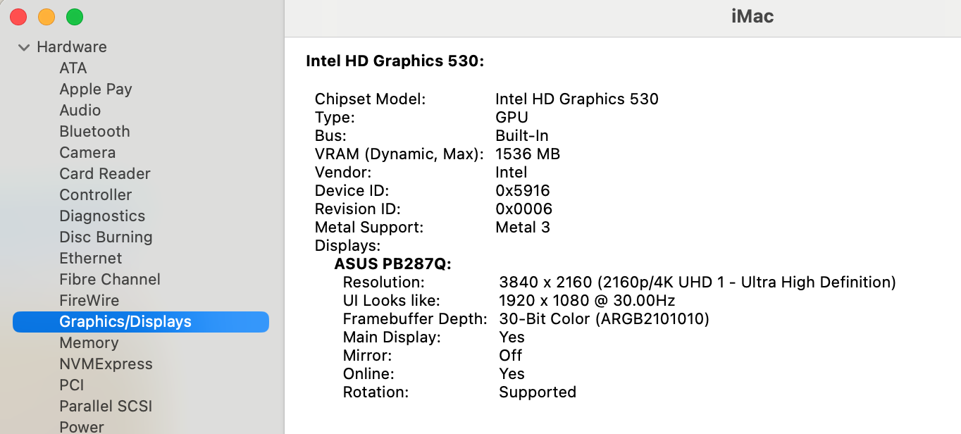

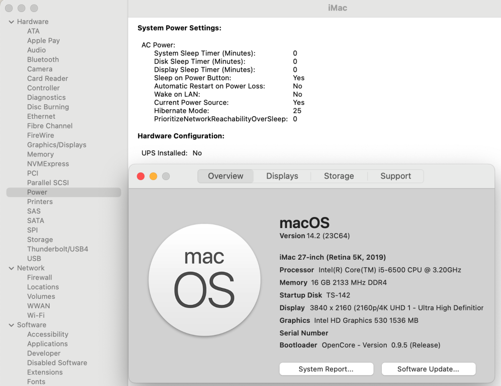

xenophon Posted December 25, 2023 Share Posted December 25, 2023 (edited) Hi, and Merry Christmas! Managed to run Sonoma on a Lenovo ThinkCentre M700 (Skylake, with HD 530 iGPU). The notable feat is that it sleeps and wakes properly, using the hibernatemode=25 workaround, originally described by shl628. Please refer to my repo for details. With greetings from Athens, Xen Addendum - I've seen 11 healthy (meaning video) sleep/wake cycles over the course of 4 days, which leads me to believe that the problem is not insurmountable. Still, there are occasional freezes during wake and perhaps someone can attack the HD530 issue with better success. Edited December 26, 2023 by xenophon 1 Link to comment https://www.insanelymac.com/forum/topic/358336-lenovo-thinkcentre-m700-skylakehd-530-running-sonoma-1421-with-proper-wake-from-sleep/ Share on other sites More sharing options...

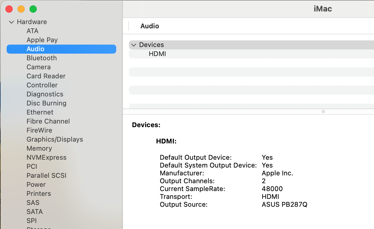

xenophon Posted January 6, 2024 Author Share Posted January 6, 2024 During my (ongoing) trials and tribulations with wake-from-sleep, I tried to connect via DP->HDMI. I believe that this DeviceProperty may get you there. Please note that my iGPU is indeed HD530, the "HD 630" string in config.plist is just cosmetic. HTH Xen config-HDMI-con1 anon.plist 1 Link to comment https://www.insanelymac.com/forum/topic/358336-lenovo-thinkcentre-m700-skylakehd-530-running-sonoma-1421-with-proper-wake-from-sleep/#findComment-2815265 Share on other sites More sharing options...
