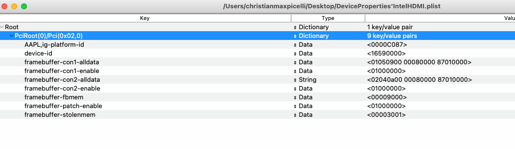

Max.1974 Posted December 9, 2023 Share Posted December 9, 2023 (edited) Hi @Francesco Guagnano Try add this args too: swd_panic=1 agdpmode=vit9696 Maybe you can try close your Laptop Monitor after or when you did the start boot And you maybe try mine DeviceProperties DeviceProperties'IntelHDMI.plist.zip Edited December 9, 2023 by Max.1974 Link to comment https://www.insanelymac.com/forum/topic/358031-hdmi-issue-on-skl-laptop-spoofed-as-kbl-with-macos-sonoma/page/4/#findComment-2814442 Share on other sites More sharing options...

Francesco Guagnano Posted December 10, 2023 Author Share Posted December 10, 2023 @Max.1974 With your configuration the situation got worse because both monitors go black. Also if I try to start the system with my configuration by closing the laptop monitor, the external monitor starts to flicker badly. 1 Link to comment https://www.insanelymac.com/forum/topic/358031-hdmi-issue-on-skl-laptop-spoofed-as-kbl-with-macos-sonoma/page/4/#findComment-2814450 Share on other sites More sharing options...

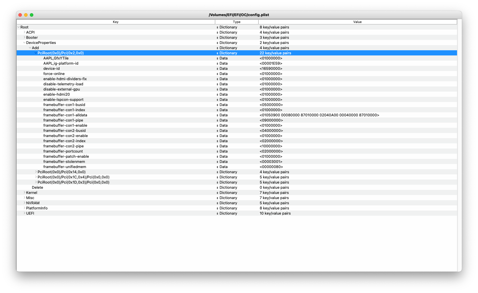

Max.1974 Posted December 10, 2023 Share Posted December 10, 2023 (edited) 13 hours ago, Francesco Guagnano said: @Max.1974 With your configuration the situation got worse because both monitors go black. Also if I try to start the system with my configuration by closing the laptop monitor, the external monitor starts to flicker badly. Here the link to the Manual to make working. https://github.com/acidanthera/WhateverGreen/blob/master/Manual/FAQ.IntelHD.en.md My laptop work with that config and another. Try if you wanted. DeviceProperties 2 Option.plist.zip Suggest you use AIDA64 to see exactly what is the specs of your Device intel video card. Report only Hardware. The boot-args is for test, so you not need use them if not work for you. The best fundamentals is here from Master of Masters RehabMan (because he help a thousands people) https://github.com/RehabMan/OS-X-Clover-Laptop-Config Edited December 10, 2023 by Max.1974 Link to comment https://www.insanelymac.com/forum/topic/358031-hdmi-issue-on-skl-laptop-spoofed-as-kbl-with-macos-sonoma/page/4/#findComment-2814462 Share on other sites More sharing options...
Francesco Guagnano Posted December 31, 2023 Author Share Posted December 31, 2023 @Max.1974 With your latest configuration the situation is the same as that for which I opened the post. 1 Link to comment https://www.insanelymac.com/forum/topic/358031-hdmi-issue-on-skl-laptop-spoofed-as-kbl-with-macos-sonoma/page/4/#findComment-2815020 Share on other sites More sharing options...

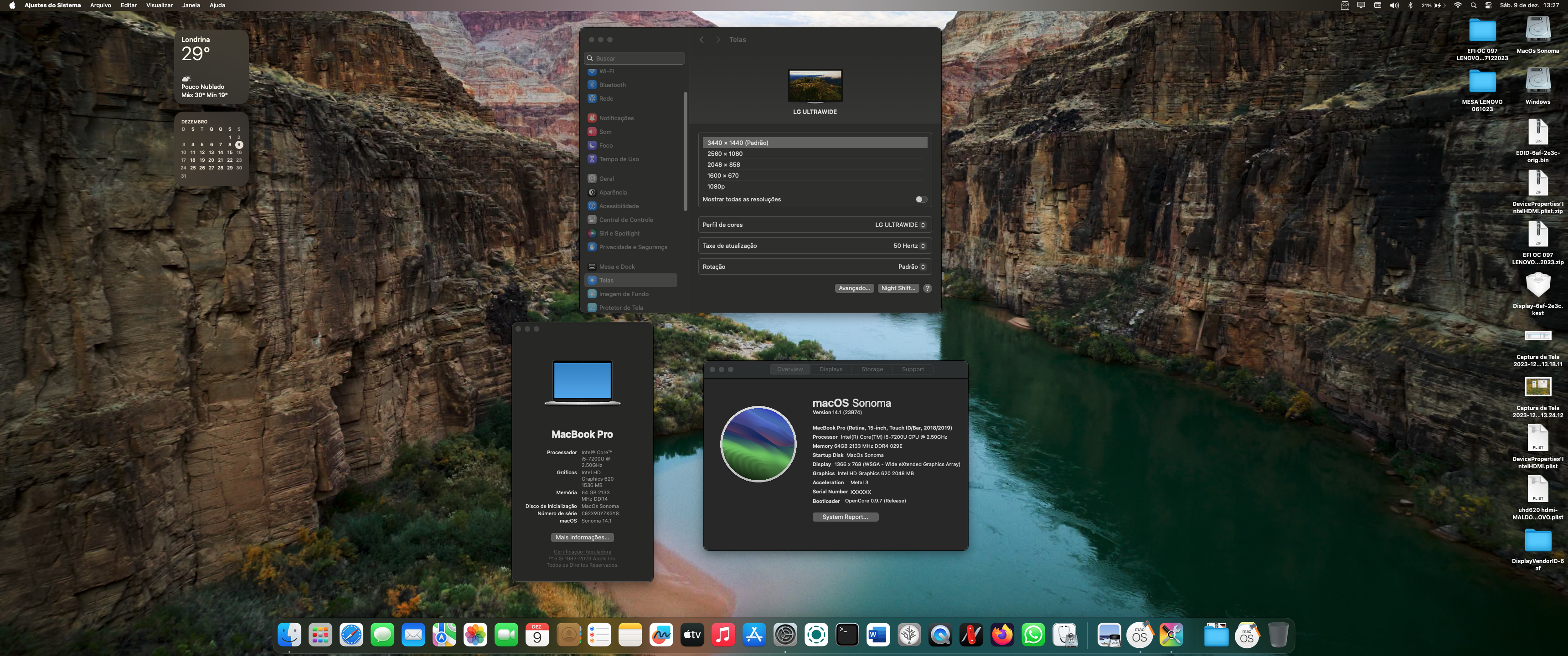

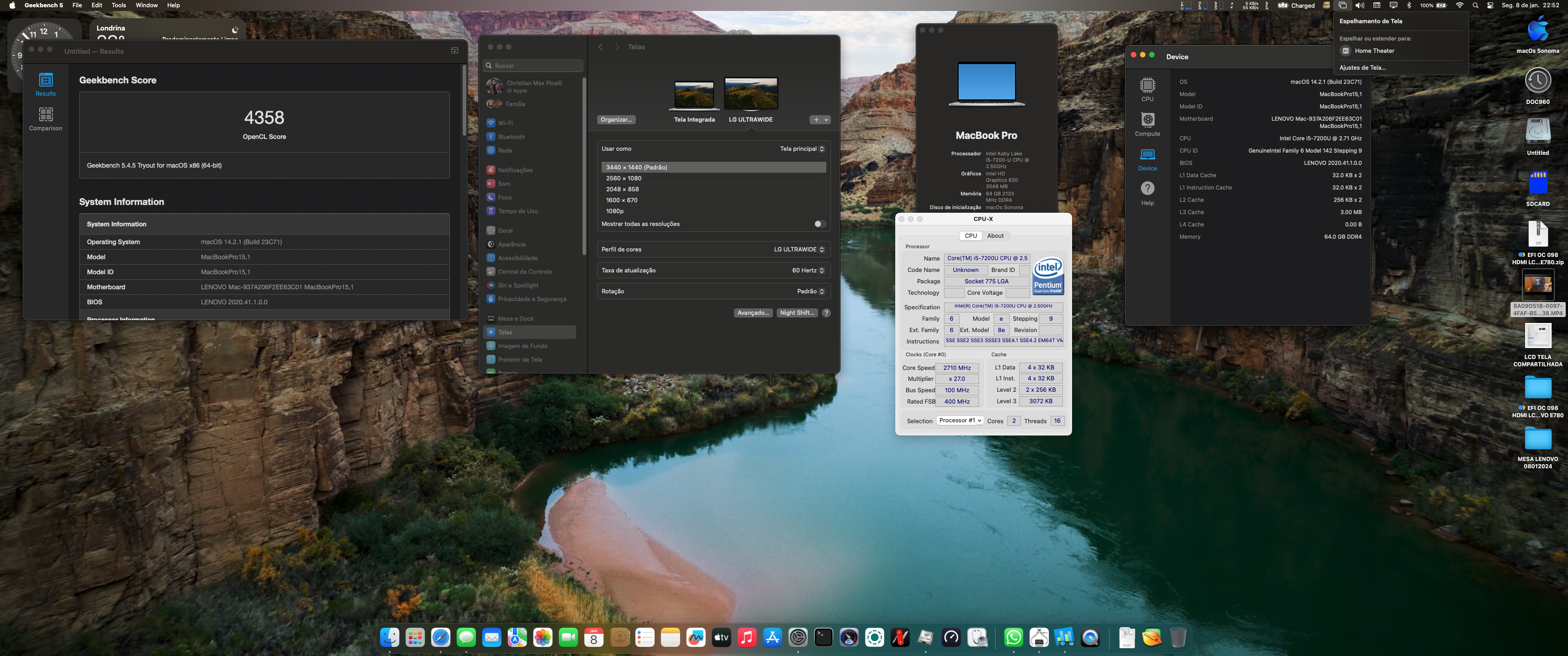

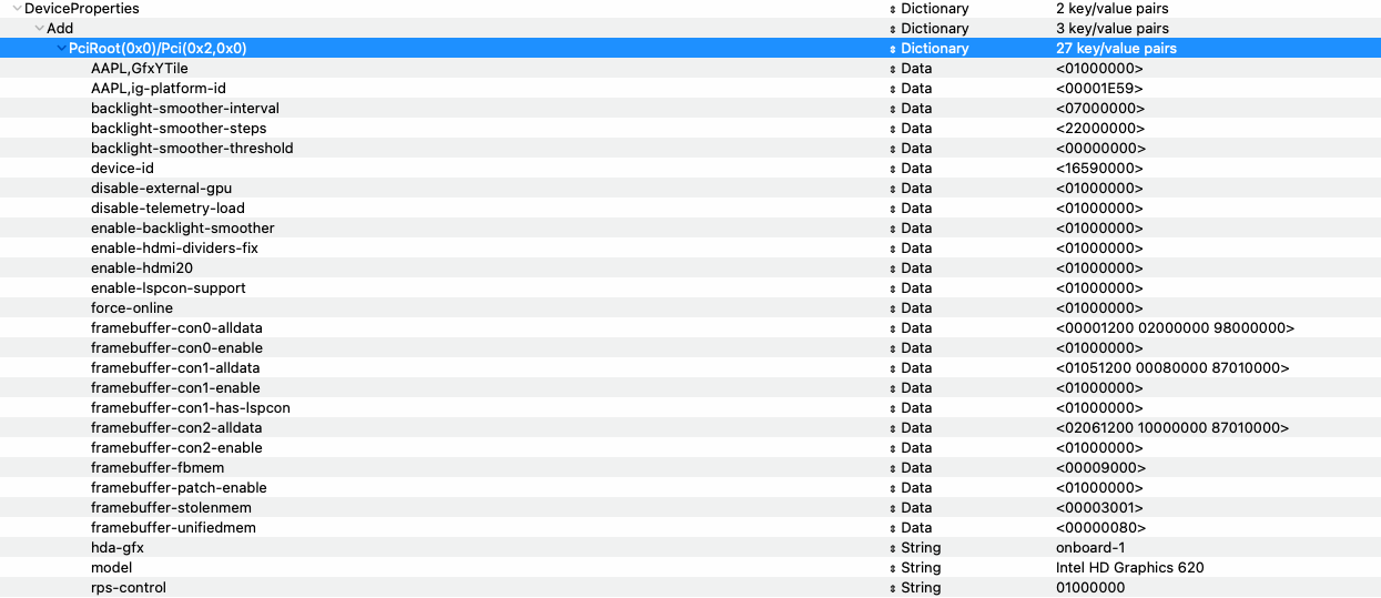

Max.1974 Posted January 9, 2024 Share Posted January 9, 2024 (edited) Here my config for UHD 620 i5-7200-U Kaby Lake Works nice with 4K 2160p60 on Youtube, not freezing or lagging. LCD (LVS) and HDMI working together You can extract your Framebuffers using WEG Debug with -igfxdump on boot args and change your parameters Don't give up Spoiler Spoiler Spoiler Edited January 9, 2024 by Max.1974 Link to comment https://www.insanelymac.com/forum/topic/358031-hdmi-issue-on-skl-laptop-spoofed-as-kbl-with-macos-sonoma/page/4/#findComment-2815331 Share on other sites More sharing options...
