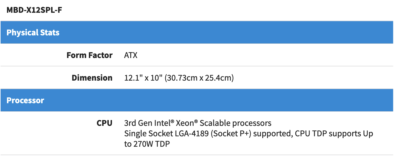

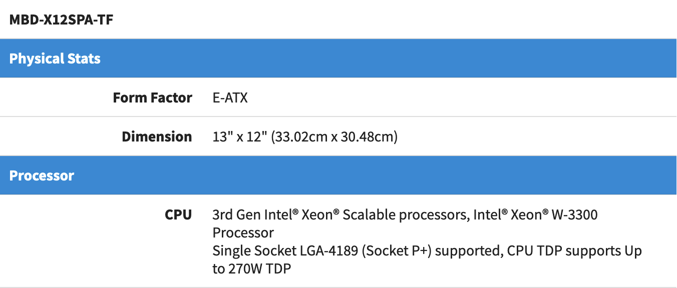

etorix Posted November 8, 2023 Share Posted November 8, 2023 The EFI folder could use a pruning of SSDTs and kexts which are not in use, and never will, or serve no purpose (SSDT-XOSI, SSDT-RTC0-RANGE for this board, and even SSDT-PLUG if you only target recent versions of macOS which no longer use "plugin-type" for power management). But I see no obvious issue. Maybe a different combination of quirks? It could be, however, that the X12SPL board is strictly intended for Xeon Scalable and has no BIOS support for Xeon W-3300. Compare All Skylake and Cascade Lake Xeon Scalable and Xeon-W CPUs share the same CPUID so there is no other value to try. 1 Quote Link to comment https://www.insanelymac.com/forum/topic/357986-help-with-xeon-w-3365-power_management_init/#findComment-2813265 Share on other sites More sharing options...
trulyspinach Posted November 8, 2023 Author Share Posted November 8, 2023 2 hours ago, etorix said: It could be, however, that the X12SPL board is strictly intended for Xeon Scalable and has no BIOS support for Xeon W-3300. Compare That's indeed interesting. I did remember I noticed that while I was purchasing the board. But I was convinced that W is a member of the 'Xeon Scalable' family.. Intel surely know how to confuse people with their naming. But Windows and Linux do works fine. And I suppose if the firmware decided to not support some model it wouldn't boot up in the first place. 2 hours ago, etorix said: All Skylake and Cascade Lake Xeon Scalable and Xeon-W CPUs share the same CPUID so there is no other value to try. Then I guess it's some other issues that's crashing xcpm.. Quote Link to comment https://www.insanelymac.com/forum/topic/357986-help-with-xeon-w-3365-power_management_init/#findComment-2813272 Share on other sites More sharing options...

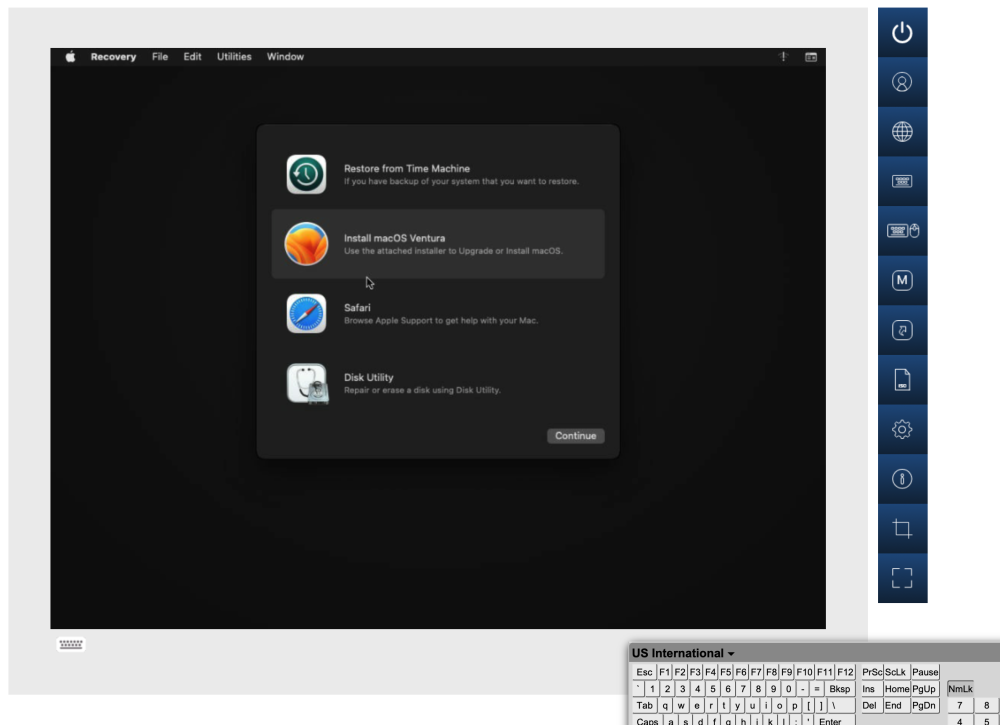

trulyspinach Posted November 8, 2023 Author Share Posted November 8, 2023 (edited) Update for today: With xcpm bypassed Ventura installer appear to boot just fine, all 64 lcpus correctly registered! That is, from the serial capture it passed libignition and launchd seems to run just fine. Although I don't have a GPU attached so unfortunately no graphic for today, will try to plug in some graphic card tomorrow. The IPI timeout thing seems to be related to KASAN kernel, maybe it was the debugger causing the timeout.. However, despite all the effort to stop xcpm, right before libignition kick in there's this "XCPM: registered". Well then, who printed this message when xcpm_init didn't even run... ... apfs_log_mount_unmount:2039: disk5s1 mounting volume macOS Base System, requested by: kernel_task (pid 0); parent: kernel_task (pid 0) handle_mount:765: disk5s1 vol-uuid: E1ED8A9F-020D-4A65-B710-B18AACF292E0 block size: 4096 block count: 285184 (unencrypted; flags: 0x1; features: 1.0.12) handle_mount:778: disk5s1 setting dev block size to 4096 from 512 nx_volume_group_update:7903: disk5s1 Volume macOS Base System is not in a volume group imageboot_setup_new: checking root image version imageboot_setup_new: root image version matches kernel XCPM: registered load_init_program: attempting to load /sbin/launchd ReadFileWrapper::open failed (errno 2) /System/Library/Security/OSLaunchPolicyData ReadFileWrapper::fileSize error, no file fetchPseudoTrustcacheData_locked: file not found shared_region: 0x25e5893cc40ad5f3 [1(launchd)] check_np(0x7ff7b689acc8) vm_shared_region_start_address() failed Darwin Ignition Sequence Version 1.0.0: Wed Jul 5 22:16:21 PDT 2023; root:libignition-51~1893/libignition_core/RELEASE_X86_64 libignition: 1: arguments : libignition: 1: ignition level : 0x5 libignition: 1: force dylib root : 0x0 ... Ventura Installer Boot.txt Edited November 8, 2023 by trulyspinach 2 Quote Link to comment https://www.insanelymac.com/forum/topic/357986-help-with-xeon-w-3365-power_management_init/#findComment-2813275 Share on other sites More sharing options...
etorix Posted November 8, 2023 Share Posted November 8, 2023 This looks much better! I'm amazed that you tried first without any GPU. Quote Link to comment https://www.insanelymac.com/forum/topic/357986-help-with-xeon-w-3365-power_management_init/#findComment-2813286 Share on other sites More sharing options...

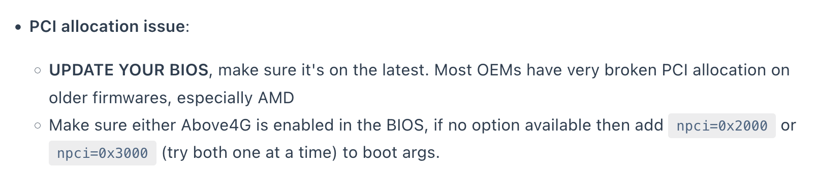

etorix Posted November 9, 2023 Share Posted November 9, 2023 No need to disable the BMC But set BIOS to output from the PCIe slot. npci=0x2000 enables "above 4G decoding" anyway. That's why it's traditionally advised to only have one of these but not both. But workstation hacks do not go by the traditional desktop playbook, and may well use both settings. Try and settle on whatever works for you… Quote Link to comment https://www.insanelymac.com/forum/topic/357986-help-with-xeon-w-3365-power_management_init/#findComment-2813327 Share on other sites More sharing options...
Slice Posted November 10, 2023 Share Posted November 10, 2023 10 hours ago, etorix said: No need to disable the BMC But set BIOS to output from the PCIe slot. npci=0x2000 enables "above 4G decoding" anyway. That's why it's traditionally advised to only have one of these but not both. But workstation hacks do not go by the traditional desktop playbook, and may well use both settings. Try and settle on whatever works for you… First time I hear about a relation between npci=0x2000 and "above 4G decoding". Success with my X79 Hack came with npci=0x3000. I installed Monterey and all was good... except audio. Neither VoodooHDA nor AppleALC produced sound. The solution is TO DISABLE ABOVE 4G DECODING. Very strange but confirmed by me and other users of such motherboards. Now the audio is working. Quote Link to comment https://www.insanelymac.com/forum/topic/357986-help-with-xeon-w-3365-power_management_init/#findComment-2813345 Share on other sites More sharing options...
etorix Posted November 10, 2023 Share Posted November 10, 2023 Maybe this is another instance where Dortania is not to be trusted? https://dortania.github.io/OpenCore-Install-Guide/troubleshooting/extended/kernel-issues.html#stuck-on-rtc-pci-configuration-begins-previous-shutdown-hpet-hid-legacy Quote Link to comment https://www.insanelymac.com/forum/topic/357986-help-with-xeon-w-3365-power_management_init/#findComment-2813358 Share on other sites More sharing options...
Slice Posted November 10, 2023 Share Posted November 10, 2023 Not true. 1. "Update your BIOS" is impossible as the motherboard is just from plant. No more recent BIOS exists. 2. "Make sure ... is enabled...". May be in some configuration it is good advice but this moment I said what I said. Quote Link to comment https://www.insanelymac.com/forum/topic/357986-help-with-xeon-w-3365-power_management_init/#findComment-2813361 Share on other sites More sharing options...
