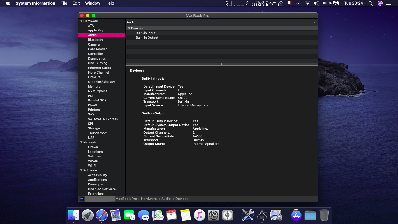

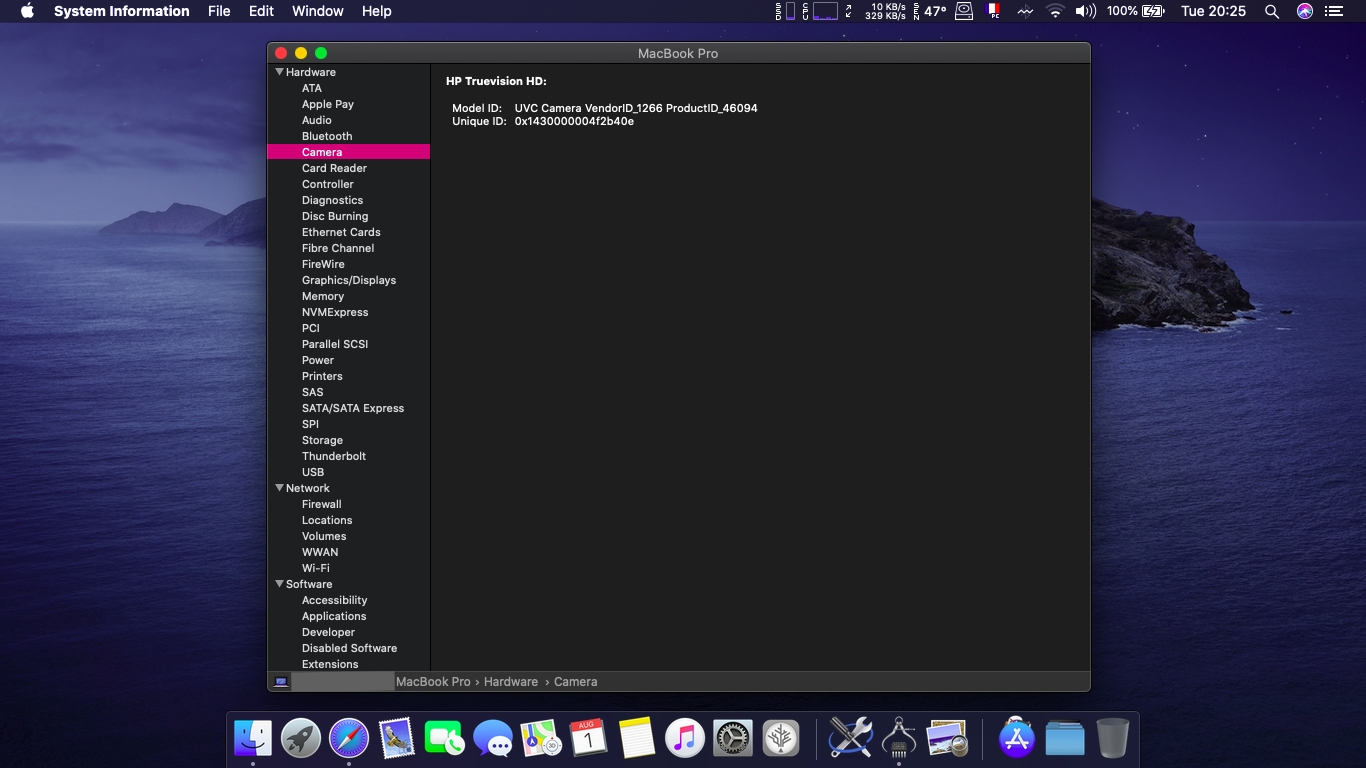

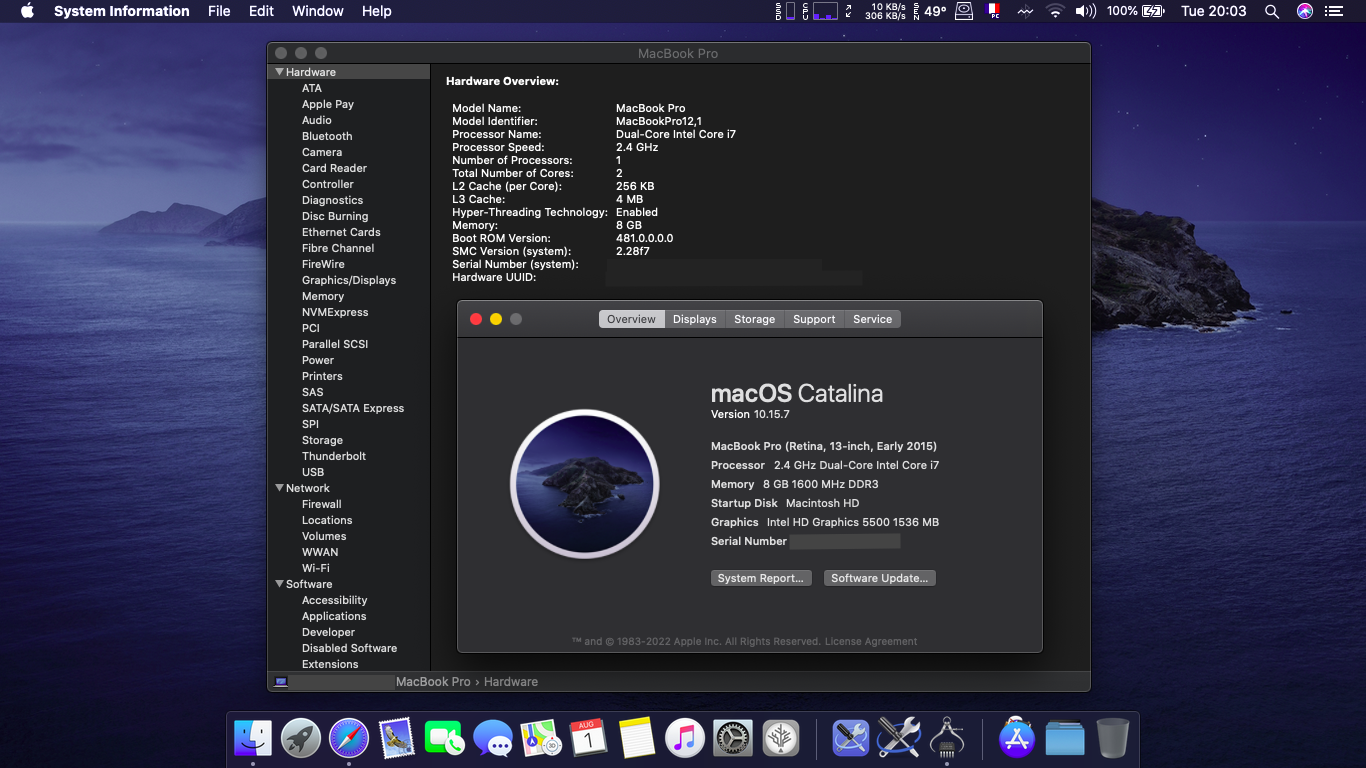

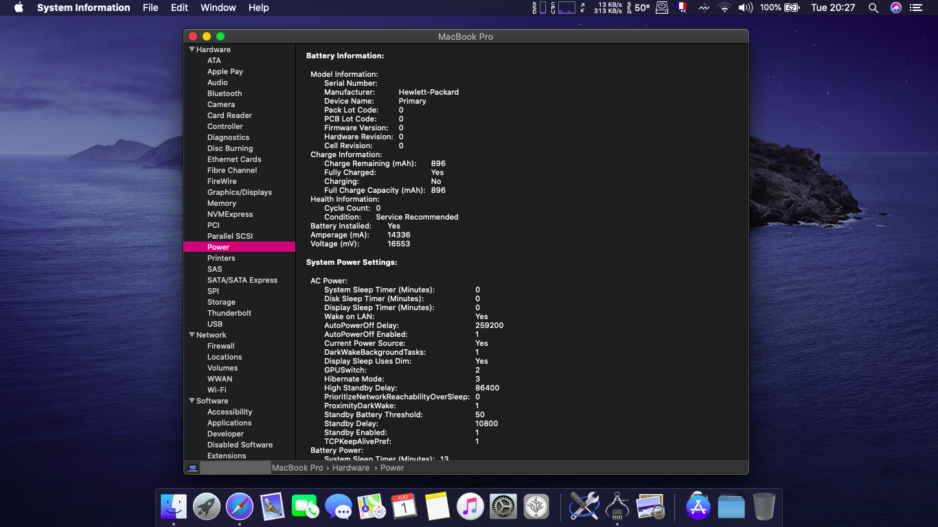

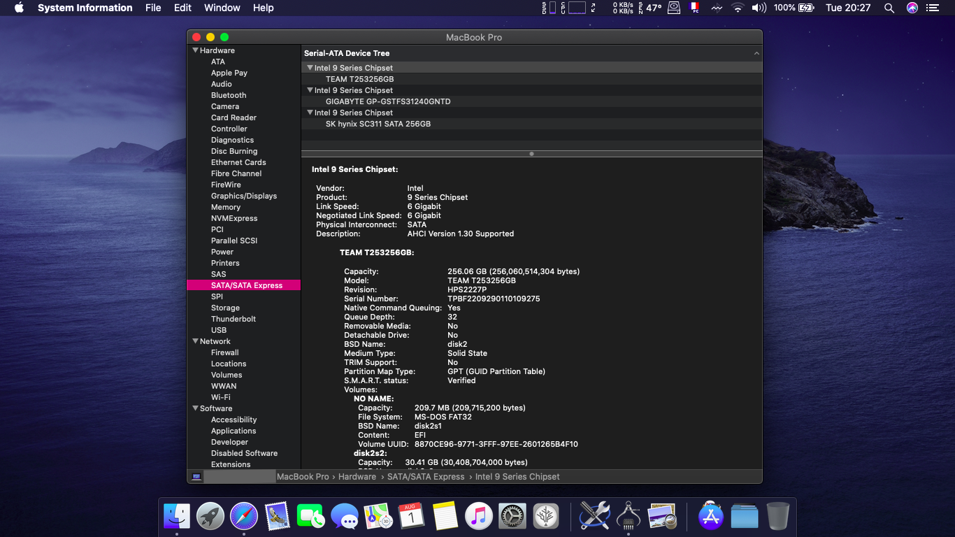

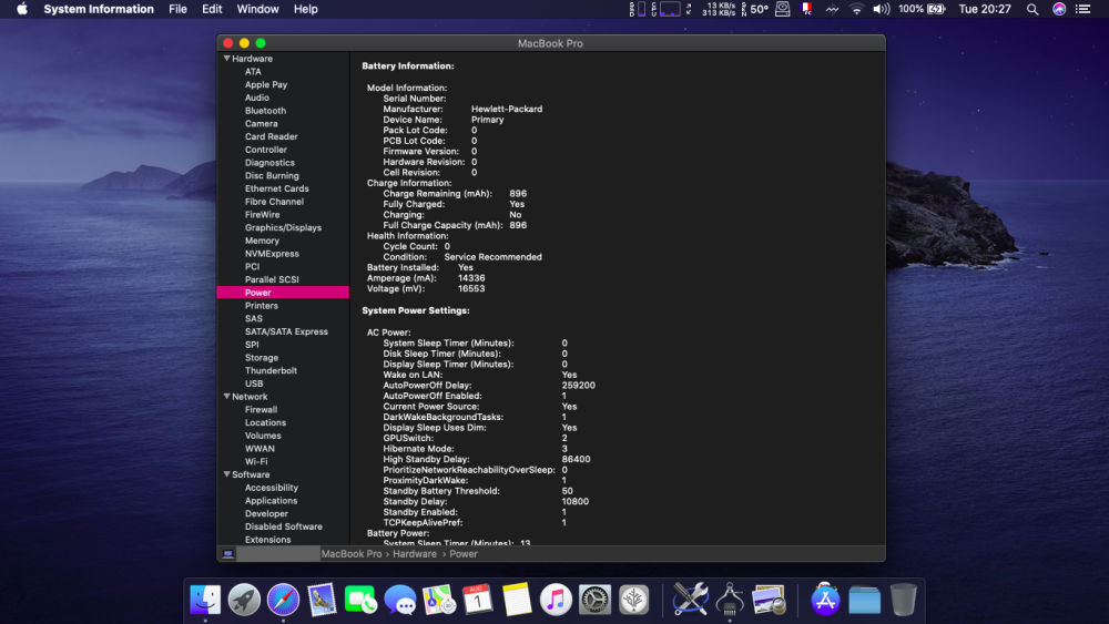

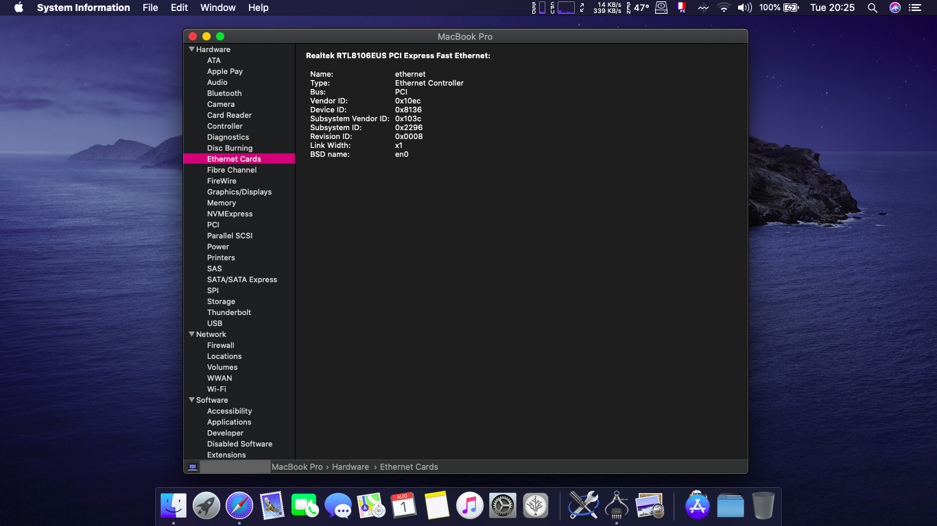

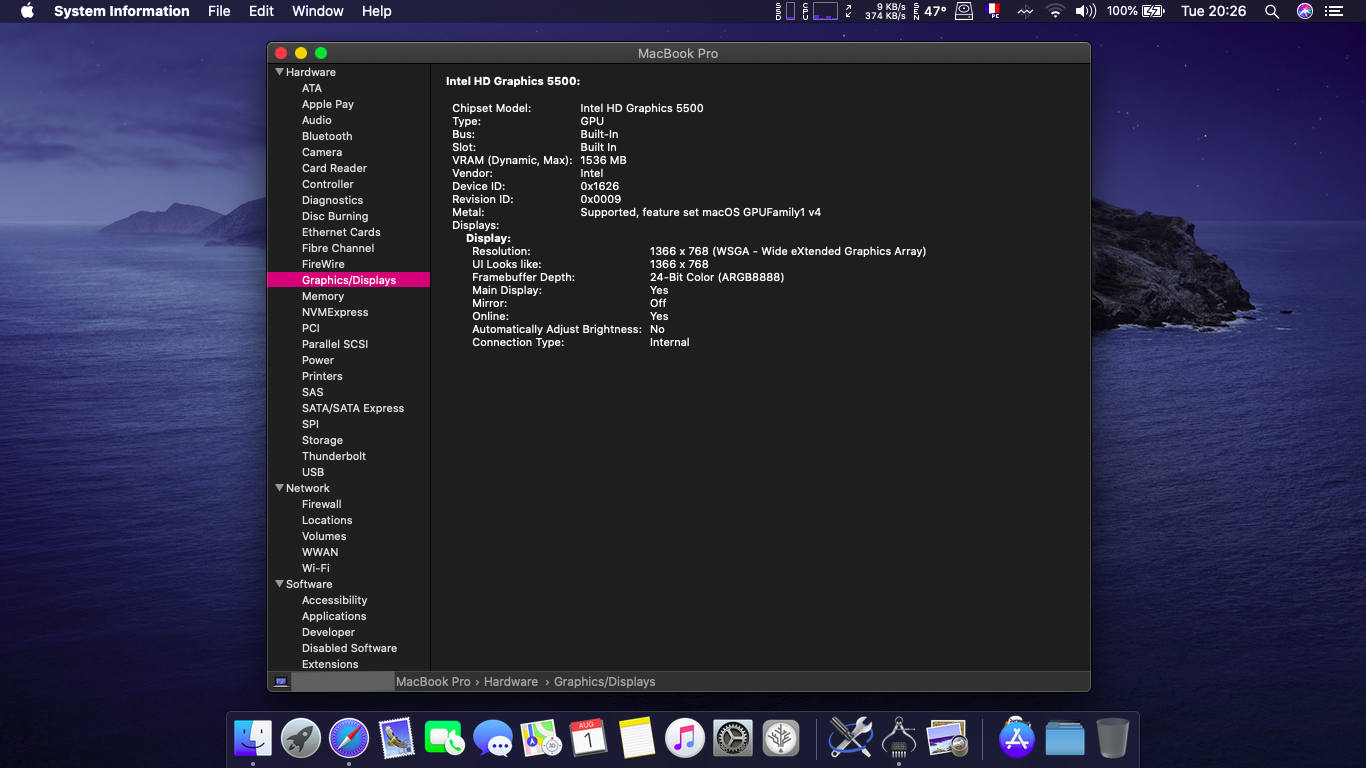

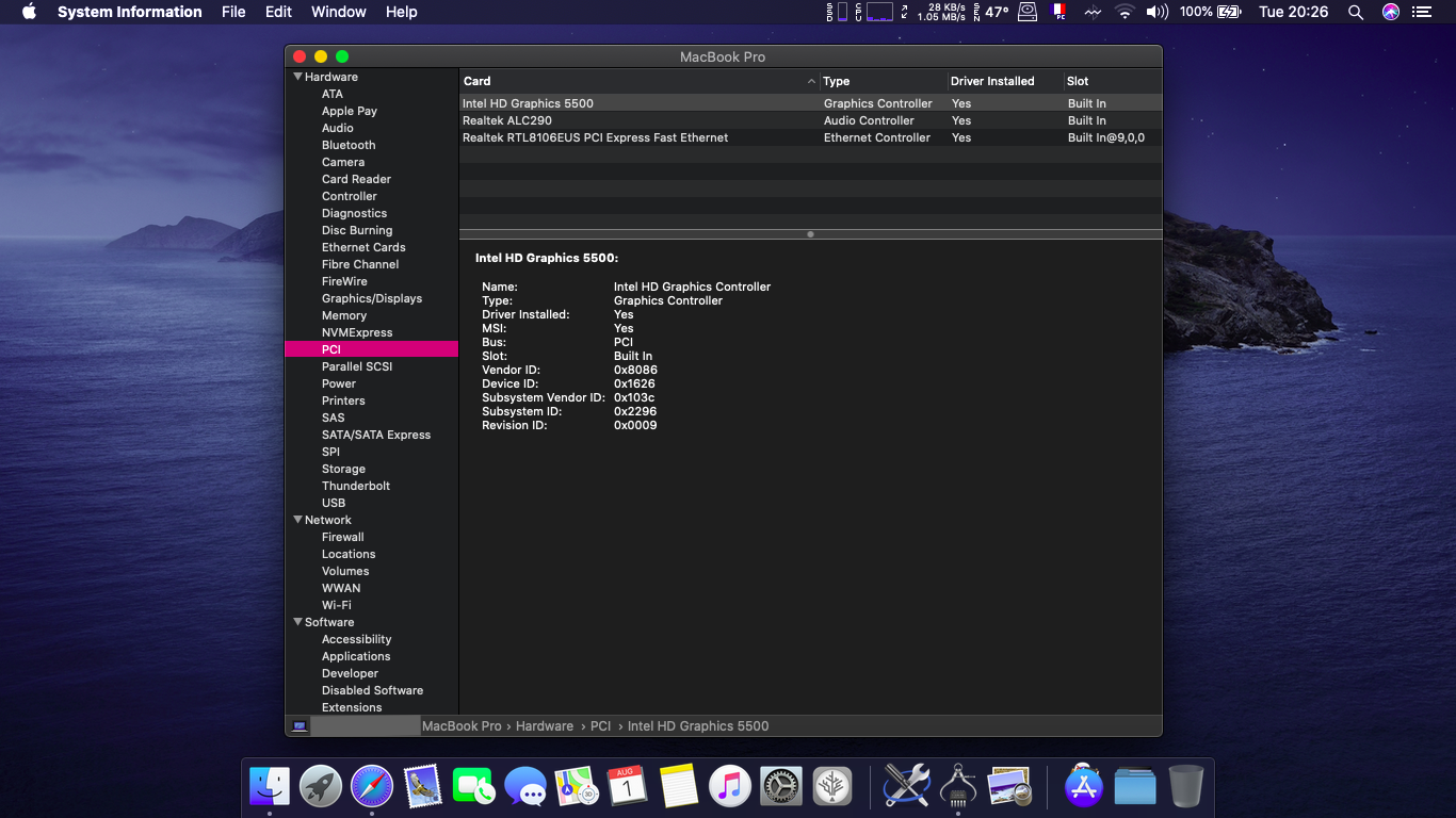

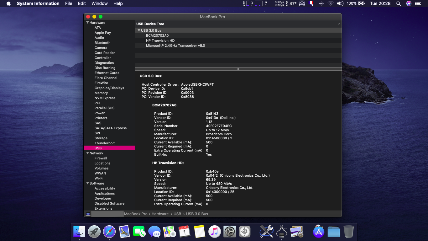

ammoune78 Posted August 2, 2023 Share Posted August 2, 2023 (edited) HP Pavilion 15" P208NK Since I've successfully installed macOS Catalina on this P208NK laptop, I decided to write this guide. This is a old laptop, but in case anyone wants to install macOS on it, this is the guide needed! Overview: Quote OpenCore is the Bootloader used for this config, and is the best choice for this particular laptop, which won't let the macOS drive, be the first from the UEFI Boot Menu. The Windows drive will always remain the first, and will never result in a corrupted EFI folder. Thus, you will have to select the macOS drive on each reboot or power on, this is due to the HP Inside BIOS {censored}. This laptop can let you install 3 drive in the same time: 1- The Original Drive 2- Swapping the Optical Drive with Caddy 3- M.2 Slot on the down side of the motherboard. LapTop Specifications: Quote - Intel core i7-5500u - Intel 5500 HD Graphics - nVIDIA GeForce 840m - 1366 x 768 LCD Panel - 8 GB SamSung RAM DDR3 1600MHz - 1 TB Toshiba Hard Drive Disk - Realtek ALC290 Audio Controller - Realtek RTL8106EUS Ethernet Controller - Broadcom Wireless Card (Not Compatible with macOS, and don't expect it to work! You need to buy a compatible one) - Realtek SD-Card - 2x USB 3.0 including one operating in backward compatibility & 1x USB 2.0 - Mouse & Trackpad fully working on macOS including gestures Screenshots Refence: Quote About: Audio: Camera: Ethernet: Graphics: PCI: Power: SATA: USB: What Works: Quote - Everything (*x 2) What doesn't works: Quote - nVIDIA GeForce 840m * - Original Wireless card needs to be replaced * Instructions: Quote The EFI, is purely minimalist in therms of config used options, this will keeps macOS in a more stable state. In addition, the ACPI battery code wasn't used, which needs much more ACPI renames & code deletes with a new battery table patch under EC Device that needs to be added. This is very careful for HP Inside Bios, that doesn't like does kind of tweakings, to prevent it from possible corruption: the Battery is the best exemple as of possible corruption under windows & other OS's is expected. But, a kext is now used to manage Battery Level & Charging, including the AC Power Adapter. The conclusion: "Clean and Stable until the time i'm writing this guide". The OpenCore version used is the 0.9.3, and you'll find the releases, in every opencore version that ive added to this guide. You'll have to generate your own credible serials, add your proper Wireless Kexts as far as you swap your original WiFi card with another one. Keep in mind, that if you're using this build for another similar HP laptop, with the same Intel CPU generation (Broadwell), you'll have to generate your own CPUFriendData kernel extension to lower the CPU frequency, otherwise the frequency will remain over the 1,20 GHz. Last and not least, for better display comfort, i'll recomand you changing the LCD panel with FHD 1920 * 1080. This will let you enjoy your laptop more on every OS, not only APPLE's one. Here Comes the EFI config part section: Note that you can easily copy the code inside the specified quote section and paste it to a plist file, for modification if needed "You only have to copy the needed Dictionary section and paste it over your config.plist", as it's written in XML. ACPI: I used SSDT-HPET and an all in one SSDT containing different patches needed, and a DSL file is included in the EFI/OC/ACPI/Decompiled folder, for later modification. Accompanied are config patches on the fly, for IRQS, _CRS, RTC and Brightness keyboard keys! Quote <?xml version="1.0" encoding="UTF-8"?> <!DOCTYPE plist PUBLIC "-//Apple//DTD PLIST 1.0//EN" "http://www.apple.com/DTDs/PropertyList-1.0.dtd"> <plist version="1.0"> <dict> <key>ACPI</key> <dict> <key>Add</key> <array> <dict> <key>Comment</key> <string>SSDT-HPET.aml</string> <key>Enabled</key> <true/> <key>Path</key> <string>SSDT-HPET.aml</string> </dict> <dict> <key>Comment</key> <string>SSDT-PATCH.aml</string> <key>Enabled</key> <true/> <key>Path</key> <string>SSDT-PATCH.aml</string> </dict> </array> <key>Delete</key> <array/> <key>Patch</key> <array> <dict> <key>Base</key> <string></string> <key>BaseSkip</key> <integer>0</integer> <key>Comment</key> <string>HPET _CRS to XCRS Rename</string> <key>Count</key> <integer>1</integer> <key>Enabled</key> <true/> <key>Find</key> <data> BV9DUlM= </data> <key>Limit</key> <integer>0</integer> <key>Mask</key> <data> </data> <key>OemTableId</key> <data> </data> <key>Replace</key> <data> BVhDUlM= </data> <key>ReplaceMask</key> <data> </data> <key>Skip</key> <integer>0</integer> <key>TableLength</key> <integer>0</integer> <key>TableSignature</key> <data> </data> </dict> <dict> <key>Base</key> <string></string> <key>BaseSkip</key> <integer>0</integer> <key>Comment</key> <string>RTC IRQ 8 Patch</string> <key>Count</key> <integer>1</integer> <key>Enabled</key> <true/> <key>Find</key> <data> IgABeQA= </data> <key>Limit</key> <integer>0</integer> <key>Mask</key> <data> </data> <key>OemTableId</key> <data> </data> <key>Replace</key> <data> IgAAeQA= </data> <key>ReplaceMask</key> <data> </data> <key>Skip</key> <integer>0</integer> <key>TableLength</key> <integer>0</integer> <key>TableSignature</key> <data> </data> </dict> <dict> <key>Base</key> <string></string> <key>BaseSkip</key> <integer>0</integer> <key>Comment</key> <string>RTC Patch for CMOS Reset (502)</string> <key>Count</key> <integer>0</integer> <key>Enabled</key> <true/> <key>Find</key> <data> RwFwAHAAAQg= </data> <key>Limit</key> <integer>0</integer> <key>Mask</key> <data> </data> <key>OemTableId</key> <data> </data> <key>Replace</key> <data> RwFwAHAAAQI= </data> <key>ReplaceMask</key> <data> </data> <key>Skip</key> <integer>0</integer> <key>TableLength</key> <integer>0</integer> <key>TableSignature</key> <data> </data> </dict> <dict> <key>Base</key> <string></string> <key>BaseSkip</key> <integer>0</integer> <key>Comment</key> <string>TIMR IRQ 0 Patch</string> <key>Count</key> <integer>1</integer> <key>Enabled</key> <true/> <key>Find</key> <data> IgEAeQA= </data> <key>Limit</key> <integer>0</integer> <key>Mask</key> <data> </data> <key>OemTableId</key> <data> </data> <key>Replace</key> <data> IgAAeQA= </data> <key>ReplaceMask</key> <data> </data> <key>Skip</key> <integer>0</integer> <key>TableLength</key> <integer>0</integer> <key>TableSignature</key> <data> </data> </dict> <dict> <key>Comment</key> <string>keyboard _Q10->XQ10, pair with SSDT-PATCH.aml</string> <key>Count</key> <integer>0</integer> <key>Enabled</key> <true/> <key>Find</key> <data> FV9RMTAA </data> <key>Limit</key> <integer>0</integer> <key>Mask</key> <data> </data> <key>OemTableId</key> <data> </data> <key>Replace</key> <data> FVhRMTAA </data> <key>ReplaceMask</key> <data> </data> <key>Skip</key> <integer>0</integer> <key>TableLength</key> <integer>0</integer> <key>TableSignature</key> <data> </data> </dict> <dict> <key>Comment</key> <string>keyboard _Q11->XQ11, pair with SSDT-PATCH.aml</string> <key>Count</key> <integer>0</integer> <key>Enabled</key> <true/> <key>Find</key> <data> FV9RMTEA </data> <key>Limit</key> <integer>0</integer> <key>Mask</key> <data> </data> <key>OemTableId</key> <data> </data> <key>Replace</key> <data> FVhRMTEA </data> <key>ReplaceMask</key> <data> </data> <key>Skip</key> <integer>0</integer> <key>TableLength</key> <integer>0</integer> <key>TableSignature</key> <data> </data> </dict> </array> <key>Quirks</key> <dict> <key>FadtEnableReset</key> <false/> <key>NormalizeHeaders</key> <false/> <key>RebaseRegions</key> <false/> <key>ResetHwSig</key> <false/> <key>ResetLogoStatus</key> <true/> <key>SyncTableIds</key> <false/> </dict> </dict> </dict> </plist> Booter: Nothing special here, following Dortania guide for "Broadwell Laptops" will result in same thing. Quote <?xml version="1.0" encoding="UTF-8"?> <!DOCTYPE plist PUBLIC "-//Apple//DTD PLIST 1.0//EN" "http://www.apple.com/DTDs/PropertyList-1.0.dtd"> <plist version="1.0"> <dict> <key>Booter</key> <dict> <key>MmioWhitelist</key> <array/> <key>Patch</key> <array/> <key>Quirks</key> <dict> <key>AllowRelocationBlock</key> <false/> <key>AvoidRuntimeDefrag</key> <true/> <key>DevirtualiseMmio</key> <false/> <key>DisableSingleUser</key> <false/> <key>DisableVariableWrite</key> <false/> <key>DiscardHibernateMap</key> <false/> <key>EnableSafeModeSlide</key> <true/> <key>EnableWriteUnprotector</key> <true/> <key>ForceBooterSignature</key> <false/> <key>ForceExitBootServices</key> <false/> <key>ProtectMemoryRegions</key> <false/> <key>ProtectSecureBoot</key> <false/> <key>ProtectUefiServices</key> <false/> <key>ProvideCustomSlide</key> <true/> <key>ProvideMaxSlide</key> <integer>0</integer> <key>RebuildAppleMemoryMap</key> <false/> <key>ResizeAppleGpuBars</key> <integer>-1</integer> <key>SetupVirtualMap</key> <true/> <key>SignalAppleOS</key> <false/> <key>SyncRuntimePermissions</key> <false/> </dict> </dict> </dict> </plist> DeviceProperties: Here we need to inject audio, Ethernet and iGPU properties, and especially to disable our Geforce 840M Discrete Mobile Graphic Card. Note: Ethernet can be ignored Quote <?xml version="1.0" encoding="UTF-8"?> <!DOCTYPE plist PUBLIC "-//Apple//DTD PLIST 1.0//EN" "http://www.apple.com/DTDs/PropertyList-1.0.dtd"> <plist version="1.0"> <dict> <key>DeviceProperties</key> <dict> <key>Add</key> <dict> <key>PciRoot(0x0)/Pci(0x1B,0x0)</key> <dict> <key>AAPL,slot-name</key> <string>Built In</string> <key>device-id</key> <data> oJwAAA== </data> <key>device_type</key> <string>Audio Controller</string> <key>layout-id</key> <data> HAAAAA== </data> <key>model</key> <string>Realtek ALC290</string> </dict> <key>PciRoot(0x0)/Pci(0x1C,0x3)</key> <dict> <key>AAPL,slot-name</key> <string>Built In</string> <key>device_type</key> <string>Ethernet controller</string> <key>model</key> <string>Realtek RTL810xE Ethernet controller</string> </dict> <key>PciRoot(0x0)/Pci(0x2,0x0)</key> <dict> <key>AAPL,ig-platform-id</key> <data> BgAmFg== </data> <key>AAPL,slot-name</key> <string>Built In</string> <key>device-id</key> <data> JhYAAA== </data> <key>device_type</key> <string>Graphics Controller</string> <key>disable-external-gpu</key> <data> AQAAAA== </data> <key>framebuffer-con1-enable</key> <data> AQAAAA== </data> <key>framebuffer-con1-type</key> <data> AAgAAA== </data> <key>framebuffer-con2-busid</key> <data> AAAAAA== </data> <key>framebuffer-con2-enable</key> <data> AQAAAA== </data> <key>framebuffer-con2-index</key> <data> /////w== </data> <key>framebuffer-con2-type</key> <data> AQAAAA== </data> <key>framebuffer-fbmem</key> <data> AACQAA== </data> <key>framebuffer-patch-enable</key> <data> AQAAAA== </data> <key>framebuffer-portcount</key> <data> AgAAAA== </data> <key>framebuffer-stolenmem</key> <data> AAAwAQ== </data> <key>model</key> <string>Intel HD Graphics 5500</string> <key>name</key> <string>Intel HD Graphics Controller</string> </dict> </dict> <key>Delete</key> <dict/> </dict> </dict> </plist> Kernel: Here we need to add our Kernel Extensions and specify the needed "Quirks" which allows us booting without KernelPanic because of the HP LAPIC bug. And in addition, you need to add your Wireless Card Kexts, because the Original Card isn't expected to work on macOS, so you will need to buy one that is. Quote <?xml version="1.0" encoding="UTF-8"?> <!DOCTYPE plist PUBLIC "-//Apple//DTD PLIST 1.0//EN" "http://www.apple.com/DTDs/PropertyList-1.0.dtd"> <plist version="1.0"> <dict> <key>Kernel</key> <dict> <key>Add</key> <array> <dict> <key>Arch</key> <string>Any</string> <key>BundlePath</key> <string>CPUFriendDataProvider.kext</string> <key>Comment</key> <string>CPUFriendDataProvider.kext</string> <key>Enabled</key> <true/> <key>ExecutablePath</key> <string></string> <key>MaxKernel</key> <string></string> <key>MinKernel</key> <string></string> <key>PlistPath</key> <string>Contents/Info.plist</string> </dict> <dict> <key>Arch</key> <string>Any</string> <key>BundlePath</key> <string>Lilu.kext</string> <key>Comment</key> <string>Lilu.kext</string> <key>Enabled</key> <true/> <key>ExecutablePath</key> <string>Contents/MacOS/Lilu</string> <key>MaxKernel</key> <string></string> <key>MinKernel</key> <string></string> <key>PlistPath</key> <string>Contents/Info.plist</string> </dict> <dict> <key>Arch</key> <string>Any</string> <key>BundlePath</key> <string>RealtekRTL8100.kext</string> <key>Comment</key> <string>RealtekRTL8100.kext</string> <key>Enabled</key> <true/> <key>ExecutablePath</key> <string>Contents/MacOS/RealtekRTL8100</string> <key>MaxKernel</key> <string></string> <key>MinKernel</key> <string></string> <key>PlistPath</key> <string>Contents/Info.plist</string> </dict> <dict> <key>Arch</key> <string>Any</string> <key>BundlePath</key> <string>Sinetek-rtsx.kext</string> <key>Comment</key> <string>Sinetek-rtsx.kext</string> <key>Enabled</key> <true/> <key>ExecutablePath</key> <string>Contents/MacOS/Sinetek-rtsx</string> <key>MaxKernel</key> <string></string> <key>MinKernel</key> <string></string> <key>PlistPath</key> <string>Contents/Info.plist</string> </dict> <dict> <key>Arch</key> <string>Any</string> <key>BundlePath</key> <string>USBPorts.kext</string> <key>Comment</key> <string>USBPorts.kext</string> <key>Enabled</key> <true/> <key>ExecutablePath</key> <string></string> <key>MaxKernel</key> <string></string> <key>MinKernel</key> <string></string> <key>PlistPath</key> <string>Contents/Info.plist</string> </dict> <dict> <key>Arch</key> <string>Any</string> <key>BundlePath</key> <string>VirtualSMC.kext</string> <key>Comment</key> <string>VirtualSMC.kext</string> <key>Enabled</key> <true/> <key>ExecutablePath</key> <string>Contents/MacOS/VirtualSMC</string> <key>MaxKernel</key> <string></string> <key>MinKernel</key> <string></string> <key>PlistPath</key> <string>Contents/Info.plist</string> </dict> <dict> <key>Arch</key> <string>Any</string> <key>BundlePath</key> <string>VoodooPS2Controller.kext</string> <key>Comment</key> <string>VoodooPS2Controller.kext</string> <key>Enabled</key> <true/> <key>ExecutablePath</key> <string>Contents/MacOS/VoodooPS2Controller</string> <key>MaxKernel</key> <string></string> <key>MinKernel</key> <string></string> <key>PlistPath</key> <string>Contents/Info.plist</string> </dict> <dict> <key>Arch</key> <string>Any</string> <key>BundlePath</key> <string>WhateverGreen.kext</string> <key>Comment</key> <string>WhateverGreen.kext</string> <key>Enabled</key> <true/> <key>ExecutablePath</key> <string>Contents/MacOS/WhateverGreen</string> <key>MaxKernel</key> <string></string> <key>MinKernel</key> <string></string> <key>PlistPath</key> <string>Contents/Info.plist</string> </dict> <dict> <key>Arch</key> <string>Any</string> <key>BundlePath</key> <string>VoodooPS2Controller.kext/Contents/PlugIns/VoodooInput.kext</string> <key>Comment</key> <string>VoodooInput.kext</string> <key>Enabled</key> <true/> <key>ExecutablePath</key> <string>Contents/MacOS/VoodooInput</string> <key>MaxKernel</key> <string></string> <key>MinKernel</key> <string></string> <key>PlistPath</key> <string>Contents/Info.plist</string> </dict> <dict> <key>Arch</key> <string>Any</string> <key>BundlePath</key> <string>VoodooPS2Controller.kext/Contents/PlugIns/VoodooPS2Keyboard.kext</string> <key>Comment</key> <string>VoodooPS2Keyboard.kext</string> <key>Enabled</key> <true/> <key>ExecutablePath</key> <string>Contents/MacOS/VoodooPS2Keyboard</string> <key>MaxKernel</key> <string></string> <key>MinKernel</key> <string></string> <key>PlistPath</key> <string>Contents/Info.plist</string> </dict> <dict> <key>Arch</key> <string>Any</string> <key>BundlePath</key> <string>VoodooPS2Controller.kext/Contents/PlugIns/VoodooPS2Trackpad.kext</string> <key>Comment</key> <string>VoodooPS2Trackpad.kext</string> <key>Enabled</key> <true/> <key>ExecutablePath</key> <string>Contents/MacOS/VoodooPS2Trackpad</string> <key>MaxKernel</key> <string></string> <key>MinKernel</key> <string></string> <key>PlistPath</key> <string>Contents/Info.plist</string> </dict> <dict> <key>Arch</key> <string>Any</string> <key>BundlePath</key> <string>AppleALC.kext</string> <key>Comment</key> <string>AppleALC.kext</string> <key>Enabled</key> <true/> <key>ExecutablePath</key> <string>Contents/MacOS/AppleALC</string> <key>MaxKernel</key> <string></string> <key>MinKernel</key> <string></string> <key>PlistPath</key> <string>Contents/Info.plist</string> </dict> <dict> <key>Arch</key> <string>Any</string> <key>BundlePath</key> <string>CPUFriend.kext</string> <key>Comment</key> <string>CPUFriend.kext</string> <key>Enabled</key> <true/> <key>ExecutablePath</key> <string>Contents/MacOS/CPUFriend</string> <key>MaxKernel</key> <string></string> <key>MinKernel</key> <string></string> <key>PlistPath</key> <string>Contents/Info.plist</string> </dict> <dict> <key>Arch</key> <string>Any</string> <key>BundlePath</key> <string>ECEnabler.kext</string> <key>Comment</key> <string>ECEnabler.kext</string> <key>Enabled</key> <true/> <key>ExecutablePath</key> <string>Contents/MacOS/ECEnabler</string> <key>MaxKernel</key> <string></string> <key>MinKernel</key> <string></string> <key>PlistPath</key> <string>Contents/Info.plist</string> </dict> <dict> <key>Arch</key> <string>Any</string> <key>BundlePath</key> <string>SMCBatteryManager.kext</string> <key>Comment</key> <string>SMCBatteryManager.kext</string> <key>Enabled</key> <true/> <key>ExecutablePath</key> <string>Contents/MacOS/SMCBatteryManager</string> <key>MaxKernel</key> <string></string> <key>MinKernel</key> <string></string> <key>PlistPath</key> <string>Contents/Info.plist</string> </dict> <dict> <key>Arch</key> <string>Any</string> <key>BundlePath</key> <string>SMCProcessor.kext</string> <key>Comment</key> <string>SMCProcessor.kext</string> <key>Enabled</key> <true/> <key>ExecutablePath</key> <string>Contents/MacOS/SMCProcessor</string> <key>MaxKernel</key> <string></string> <key>MinKernel</key> <string></string> <key>PlistPath</key> <string>Contents/Info.plist</string> </dict> <dict> <key>Arch</key> <string>Any</string> <key>BundlePath</key> <string>SMCSuperIO.kext</string> <key>Comment</key> <string>SMCSuperIO.kext</string> <key>Enabled</key> <true/> <key>ExecutablePath</key> <string>Contents/MacOS/SMCSuperIO</string> <key>MaxKernel</key> <string></string> <key>MinKernel</key> <string></string> <key>PlistPath</key> <string>Contents/Info.plist</string> </dict> </array> <key>Block</key> <array/> <key>Emulate</key> <dict> <key>Cpuid1Data</key> <data> </data> <key>Cpuid1Mask</key> <data> </data> <key>DummyPowerManagement</key> <false/> <key>MaxKernel</key> <string></string> <key>MinKernel</key> <string></string> </dict> <key>Force</key> <array/> <key>Patch</key> <array/> <key>Quirks</key> <dict> <key>AppleCpuPmCfgLock</key> <false/> <key>AppleXcpmCfgLock</key> <true/> <key>AppleXcpmExtraMsrs</key> <false/> <key>AppleXcpmForceBoost</key> <false/> <key>CustomPciSerialDevice</key> <false/> <key>CustomSMBIOSGuid</key> <false/> <key>DisableIoMapper</key> <true/> <key>DisableIoMapperMapping</key> <false/> <key>DisableLinkeditJettison</key> <true/> <key>DisableRtcChecksum</key> <false/> <key>ExtendBTFeatureFlags</key> <false/> <key>ExternalDiskIcons</key> <false/> <key>ForceAquantiaEthernet</key> <false/> <key>ForceSecureBootScheme</key> <false/> <key>IncreasePciBarSize</key> <false/> <key>LapicKernelPanic</key> <true/> <key>LegacyCommpage</key> <false/> <key>PanicNoKextDump</key> <true/> <key>PowerTimeoutKernelPanic</key> <true/> <key>ProvideCurrentCpuInfo</key> <false/> <key>SetApfsTrimTimeout</key> <integer>-1</integer> <key>ThirdPartyDrives</key> <false/> <key>XhciPortLimit</key> <false/> </dict> <key>Scheme</key> <dict> <key>CustomKernel</key> <false/> <key>FuzzyMatch</key> <true/> <key>KernelArch</key> <string>Auto</string> <key>KernelCache</key> <string>Auto</string> </dict> </dict> </dict> </plist> Misc: Nothing special here except the security section, that nether SecureBootModel to be Disabled. Idid't succeed booting the laptop when this option is set to enabled, for unknown reason. (If anyone have a solution, it is welcome) Quote <?xml version="1.0" encoding="UTF-8"?> <!DOCTYPE plist PUBLIC "-//Apple//DTD PLIST 1.0//EN" "http://www.apple.com/DTDs/PropertyList-1.0.dtd"> <plist version="1.0"> <dict> <key>Misc</key> <dict> <key>BlessOverride</key> <array/> <key>Boot</key> <dict> <key>ConsoleAttributes</key> <integer>0</integer> <key>HibernateMode</key> <string>None</string> <key>HibernateSkipsPicker</key> <false/> <key>HideAuxiliary</key> <true/> <key>LauncherOption</key> <string>Enabled</string> <key>LauncherPath</key> <string>Default</string> <key>PickerAttributes</key> <integer>17</integer> <key>PickerAudioAssist</key> <false/> <key>PickerMode</key> <string>External</string> <key>PickerVariant</key> <string>Auto</string> <key>PollAppleHotKeys</key> <true/> <key>ShowPicker</key> <true/> <key>TakeoffDelay</key> <integer>0</integer> <key>Timeout</key> <integer>10</integer> </dict> <key>Debug</key> <dict> <key>AppleDebug</key> <false/> <key>ApplePanic</key> <false/> <key>DisableWatchDog</key> <true/> <key>DisplayDelay</key> <integer>0</integer> <key>DisplayLevel</key> <integer>2147483650</integer> <key>LogModules</key> <string>*</string> <key>SysReport</key> <false/> <key>Target</key> <integer>0</integer> </dict> <key>Entries</key> <array> <dict> <key>Arguments</key> <string></string> <key>Auxiliary</key> <false/> <key>Comment</key> <string>Not signed for security reasons</string> <key>Enabled</key> <false/> <key>Flavour</key> <string>Auto</string> <key>Name</key> <string>CustomOS</string> <key>Path</key> <string>PciRoot(0x0)/Pci(0x1,0x1)/Pci(0x0,0x0)/NVMe(0x1,11-22-33-44-55-66-77-88)/HD(1,GPT,00000000-0000-0000-0000-000000000000,0x800,0x64000)/\EFI\BOOT\BOOTX64.EFI</string> <key>TextMode</key> <false/> </dict> </array> <key>Security</key> <dict> <key>AllowSetDefault</key> <false/> <key>ApECID</key> <integer>0</integer> <key>AuthRestart</key> <false/> <key>BlacklistAppleUpdate</key> <true/> <key>DmgLoading</key> <string>Signed</string> <key>EnablePassword</key> <false/> <key>ExposeSensitiveData</key> <integer>6</integer> <key>HaltLevel</key> <integer>2147483648</integer> <key>PasswordHash</key> <data> </data> <key>PasswordSalt</key> <data> </data> <key>ScanPolicy</key> <integer>0</integer> <key>SecureBootModel</key> <string>Disabled</string> <key>Vault</key> <string>Optional</string> </dict> <key>Serial</key> <dict> <key>Init</key> <false/> <key>Override</key> <false/> </dict> <key>Tools</key> <array> <dict> <key>Arguments</key> <string></string> <key>Auxiliary</key> <true/> <key>Comment</key> <string>CleanNvram.efi</string> <key>Enabled</key> <true/> <key>Flavour</key> <string>Auto</string> <key>FullNvramAccess</key> <false/> <key>Name</key> <string>CleanNvram.efi</string> <key>Path</key> <string>CleanNvram.efi</string> <key>RealPath</key> <false/> <key>TextMode</key> <false/> </dict> <dict> <key>Arguments</key> <string></string> <key>Auxiliary</key> <true/> <key>Comment</key> <string>OpenShell.efi</string> <key>Enabled</key> <true/> <key>Flavour</key> <string>Auto</string> <key>FullNvramAccess</key> <false/> <key>Name</key> <string>OpenShell.efi</string> <key>Path</key> <string>OpenShell.efi</string> <key>RealPath</key> <false/> <key>TextMode</key> <false/> </dict> </array> </dict> </dict> </plist> NVRAM: No special thing here, again except the keyboard layout that needs to be changed suiting your needs. Quote <?xml version="1.0" encoding="UTF-8"?> <!DOCTYPE plist PUBLIC "-//Apple//DTD PLIST 1.0//EN" "http://www.apple.com/DTDs/PropertyList-1.0.dtd"> <plist version="1.0"> <dict> <key>NVRAM</key> <dict> <key>Add</key> <dict> <key>4D1EDE05-38C7-4A6A-9CC6-4BCCA8B38C14</key> <dict> <key>DefaultBackgroundColor</key> <data> AAAAAA== </data> </dict> <key>4D1FDA02-38C7-4A6A-9CC6-4BCCA8B30102</key> <dict> <key>rtc-blacklist</key> <data> </data> </dict> <key>7C436110-AB2A-4BBB-A880-FE41995C9F82</key> <dict> <key>#INFO (prev-lang:kbd)</key> <string>fr:60 (French-PC), set 66723A36 30</string> <key>ForceDisplayRotationInEFI</key> <integer>0</integer> <key>SystemAudioVolume</key> <data> Rg== </data> <key>boot-args</key> <string></string> <key>csr-active-config</key> <data> 5wMAAA== </data> <key>prev-lang:kbd</key> <string>fr:60</string> <key>run-efi-updater</key> <string>No</string> </dict> </dict> <key>Delete</key> <dict> <key>4D1EDE05-38C7-4A6A-9CC6-4BCCA8B38C14</key> <array> <string>DefaultBackgroundColor</string> </array> <key>4D1FDA02-38C7-4A6A-9CC6-4BCCA8B30102</key> <array> <string>rtc-blacklist</string> </array> <key>7C436110-AB2A-4BBB-A880-FE41995C9F82</key> <array> <string>boot-args</string> <string>ForceDisplayRotationInEFI</string> </array> </dict> <key>LegacyOverwrite</key> <false/> <key>LegacySchema</key> <dict> <key>7C436110-AB2A-4BBB-A880-FE41995C9F82</key> <array> <string>EFILoginHiDPI</string> <string>EFIBluetoothDelay</string> <string>LocationServicesEnabled</string> <string>SystemAudioVolume</string> <string>SystemAudioVolumeDB</string> <string>SystemAudioVolumeSaved</string> <string>bluetoothActiveControllerInfo</string> <string>bluetoothInternalControllerInfo</string> <string>flagstate</string> <string>fmm-computer-name</string> <string>fmm-mobileme-token-FMM</string> <string>fmm-mobileme-token-FMM-BridgeHasAccount</string> <string>nvda_drv</string> <string>prev-lang:kbd</string> </array> <key>8BE4DF61-93CA-11D2-AA0D-00E098032B8C</key> <array> <string>Boot0080</string> <string>Boot0081</string> <string>Boot0082</string> <string>BootNext</string> <string>BootOrder</string> </array> </dict> <key>WriteFlash</key> <true/> </dict> </dict> </plist> PlatformInfo: Again, here you only need to put your trusted serials info. Quote <?xml version="1.0" encoding="UTF-8"?> <!DOCTYPE plist PUBLIC "-//Apple//DTD PLIST 1.0//EN" "http://www.apple.com/DTDs/PropertyList-1.0.dtd"> <plist version="1.0"> <dict> <key>PlatformInfo</key> <dict> <key>Automatic</key> <true/> <key>CustomMemory</key> <false/> <key>Generic</key> <dict> <key>AdviseFeatures</key> <false/> <key>MLB</key> <string></string> <key>MaxBIOSVersion</key> <false/> <key>ProcessorType</key> <integer>0</integer> <key>ROM</key> <data> </data> <key>SpoofVendor</key> <true/> <key>SystemMemoryStatus</key> <string>Auto</string> <key>SystemProductName</key> <string>MacBookPro12,1</string> <key>SystemSerialNumber</key> <string></string> <key>SystemUUID</key> <string></string> </dict> <key>UpdateDataHub</key> <true/> <key>UpdateNVRAM</key> <true/> <key>UpdateSMBIOS</key> <true/> <key>UpdateSMBIOSMode</key> <string>Create</string> <key>UseRawUuidEncoding</key> <false/> </dict> </dict> </plist> UEFI: As expected, here the same thing, except for booting Catalina that requires (Min-Date & Min-Version to be sets to -1), and the UEFI drivers for linux are disabled already in case you don't use a distro! Quote <?xml version="1.0" encoding="UTF-8"?> <!DOCTYPE plist PUBLIC "-//Apple//DTD PLIST 1.0//EN" "http://www.apple.com/DTDs/PropertyList-1.0.dtd"> <plist version="1.0"> <dict> <key>UEFI</key> <dict> <key>APFS</key> <dict> <key>EnableJumpstart</key> <true/> <key>GlobalConnect</key> <false/> <key>HideVerbose</key> <true/> <key>JumpstartHotPlug</key> <false/> <key>MinDate</key> <integer>-1</integer> <key>MinVersion</key> <integer>-1</integer> </dict> <key>AppleInput</key> <dict> <key>AppleEvent</key> <string>Builtin</string> <key>CustomDelays</key> <false/> <key>GraphicsInputMirroring</key> <true/> <key>KeyInitialDelay</key> <integer>50</integer> <key>KeySubsequentDelay</key> <integer>5</integer> <key>PointerDwellClickTimeout</key> <integer>0</integer> <key>PointerDwellDoubleClickTimeout</key> <integer>0</integer> <key>PointerDwellRadius</key> <integer>0</integer> <key>PointerPollMask</key> <integer>-1</integer> <key>PointerPollMax</key> <integer>80</integer> <key>PointerPollMin</key> <integer>10</integer> <key>PointerSpeedDiv</key> <integer>1</integer> <key>PointerSpeedMul</key> <integer>1</integer> </dict> <key>Audio</key> <dict> <key>AudioCodec</key> <integer>0</integer> <key>AudioDevice</key> <string>PciRoot(0x0)/Pci(0x1b,0x0)</string> <key>AudioOutMask</key> <integer>1</integer> <key>AudioSupport</key> <false/> <key>DisconnectHda</key> <false/> <key>MaximumGain</key> <integer>-15</integer> <key>MinimumAssistGain</key> <integer>-30</integer> <key>MinimumAudibleGain</key> <integer>-55</integer> <key>PlayChime</key> <string>Auto</string> <key>ResetTrafficClass</key> <false/> <key>SetupDelay</key> <integer>0</integer> </dict> <key>ConnectDrivers</key> <true/> <key>Drivers</key> <array> <dict> <key>Arguments</key> <string></string> <key>Comment</key> <string>OpenCanopy.efi</string> <key>Enabled</key> <true/> <key>LoadEarly</key> <false/> <key>Path</key> <string>OpenCanopy.efi</string> </dict> <dict> <key>Arguments</key> <string></string> <key>Comment</key> <string>OpenHfsPlus.efi</string> <key>Enabled</key> <true/> <key>LoadEarly</key> <false/> <key>Path</key> <string>OpenHfsPlus.efi</string> </dict> <dict> <key>Arguments</key> <string></string> <key>Comment</key> <string></string> <key>Enabled</key> <false/> <key>LoadEarly</key> <false/> <key>Path</key> <string>Ext4Dxe.efi</string> </dict> <dict> <key>Arguments</key> <string></string> <key>Comment</key> <string></string> <key>Enabled</key> <false/> <key>LoadEarly</key> <false/> <key>Path</key> <string>OpenLinuxBoot.efi</string> </dict> <dict> <key>Arguments</key> <string></string> <key>Comment</key> <string>OpenRuntime.efi</string> <key>Enabled</key> <true/> <key>LoadEarly</key> <false/> <key>Path</key> <string>OpenRuntime.efi</string> </dict> </array> <key>Input</key> <dict> <key>KeyFiltering</key> <false/> <key>KeyForgetThreshold</key> <integer>5</integer> <key>KeySupport</key> <true/> <key>KeySupportMode</key> <string>Auto</string> <key>KeySwap</key> <false/> <key>PointerSupport</key> <false/> <key>PointerSupportMode</key> <string>ASUS</string> <key>TimerResolution</key> <integer>50000</integer> </dict> <key>Output</key> <dict> <key>ClearScreenOnModeSwitch</key> <false/> <key>ConsoleFont</key> <string></string> <key>ConsoleMode</key> <string></string> <key>DirectGopRendering</key> <false/> <key>ForceResolution</key> <false/> <key>GopBurstMode</key> <false/> <key>GopPassThrough</key> <string>Disabled</string> <key>IgnoreTextInGraphics</key> <false/> <key>InitialMode</key> <string>Auto</string> <key>ProvideConsoleGop</key> <true/> <key>ReconnectGraphicsOnConnect</key> <false/> <key>ReconnectOnResChange</key> <false/> <key>ReplaceTabWithSpace</key> <false/> <key>Resolution</key> <string>Max</string> <key>SanitiseClearScreen</key> <false/> <key>TextRenderer</key> <string>BuiltinGraphics</string> <key>UIScale</key> <integer>0</integer> <key>UgaPassThrough</key> <false/> </dict> <key>ProtocolOverrides</key> <dict> <key>AppleAudio</key> <false/> <key>AppleBootPolicy</key> <false/> <key>AppleDebugLog</key> <false/> <key>AppleEg2Info</key> <false/> <key>AppleFramebufferInfo</key> <false/> <key>AppleImageConversion</key> <false/> <key>AppleImg4Verification</key> <false/> <key>AppleKeyMap</key> <false/> <key>AppleRtcRam</key> <false/> <key>AppleSecureBoot</key> <false/> <key>AppleSmcIo</key> <false/> <key>AppleUserInterfaceTheme</key> <false/> <key>DataHub</key> <false/> <key>DeviceProperties</key> <false/> <key>FirmwareVolume</key> <true/> <key>HashServices</key> <false/> <key>OSInfo</key> <false/> <key>PciIo</key> <false/> <key>UnicodeCollation</key> <false/> </dict> <key>Quirks</key> <dict> <key>ActivateHpetSupport</key> <false/> <key>DisableSecurityPolicy</key> <false/> <key>EnableVectorAcceleration</key> <true/> <key>EnableVmx</key> <false/> <key>ExitBootServicesDelay</key> <integer>0</integer> <key>ForceOcWriteFlash</key> <false/> <key>ForgeUefiSupport</key> <false/> <key>IgnoreInvalidFlexRatio</key> <true/> <key>ReleaseUsbOwnership</key> <true/> <key>ReloadOptionRoms</key> <false/> <key>RequestBootVarRouting</key> <true/> <key>ResizeGpuBars</key> <integer>-1</integer> <key>ResizeUsePciRbIo</key> <false/> <key>TscSyncTimeout</key> <integer>0</integer> <key>UnblockFsConnect</key> <true/> </dict> <key>ReservedMemory</key> <array> <dict> <key>Address</key> <integer>268435456</integer> <key>Comment</key> <string>HD3000: IGPU memory corruption errata</string> <key>Enabled</key> <false/> <key>Size</key> <integer>268435456</integer> <key>Type</key> <string>Reserved</string> </dict> <dict> <key>Address</key> <integer>569344</integer> <key>Comment</key> <string>Fix black screen on wake from hibernation for Lenovo Thinkpad T490</string> <key>Enabled</key> <false/> <key>Size</key> <integer>4096</integer> <key>Type</key> <string>RuntimeCode</string> </dict> </array> </dict> </dict> </plist> Things that you may need: Quote - Acidanthera's Life's Easier for us: Here - OpenCore: Here - Python: Here - CorpNewt's Life's Easier for us: Here - ProperTree: Here - GenSMBIOS: Here - gibMacOS: Here - One-Key-CPUFriend: Here - ECEnabler Kext (Battery Infos): Here Special Thanks: For Moderators, please warn me if mentioning the user from TM is prohibited, so i can delete the related content please! Quote - Every Hackintosh Community: Specially InsanelyMac, Olarila, AppleLife.ru, Hackintosh-Montreal.com, Hervé's osxlatitude.com, Hackintosh-Forum.de, Hackintosh-Inc.de and many! - vit9696 and The HermitCrabs Lab. - CorpNewt - Laura Müller (Mieze) - FormerUser-435514: for his guid, who helped me a lot in thinking that my laptop is able to receive macOS installation. - dkoluris for using a simple and clean EFI folder without ACPI altering, and only using ECEnabler for battery management & infos Releases: This is the first one, that works up to "Monterey is buggy & slower ", but i recommend Catalina which is the most stable. - Catalina Support, everything is working. - Don't forget to change your CPUFriend kext dependencie if not the same CPU as described in the Readme section. This CPUFriend Kernels Extension are for i7-5500u only. - Don't forget to add your Wireless card kexts dependencies. - Make then the changes to the SSDT-Patch.dsl file inside EFI/OC/ACPI/Decompile/folder and generate an AML file, that include your WiFi card device-id and name, for AirPort Extreme. In case you use an Intel Card, remove the section RP03 from the DSL and generate a new AML one. P208NK_OpenCore-0.9.3.zip Edited August 2, 2023 by ammoune78 1 Link to comment Share on other sites More sharing options...
