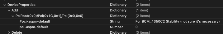

Tried the ASPM but in DeviceProperties no luck.   The Nvram flags that you posted a while back I have most of them except instead of vsmcbeta I have vsmcgen=1 nieither one make any difference.  What is smcgen=1 which I tried didn't have any luck, nor did any of the NCPI flags 2000 or 3000.  Even tried Darkwake no difference.
Thanks for the help.

12 hours ago, Middleman said:
I believe as well as the kext you have to enable ASPM in the BIOS as well as use the following boot-args:
-v brcmfx-aspm=259
or
-v brcmfx-aspm=258
The -v is mandatory (otherwise it won’t work)
The plug-ins are not needed (ie.kext only required) if your card is Apple native as they are for non Apple-native cards.
I don’t have that setting in Legacy Bios.  I loaded the Bios in Aptio tools and a very interesting feature I can actually enable UEFI but will make a rom backup of the Bios before I change that setting. I don’t see how it can just magically become UEFI Bios without all the modules drivers and as complex as it is it can’t be that simple.
Edited by oSxFr33k

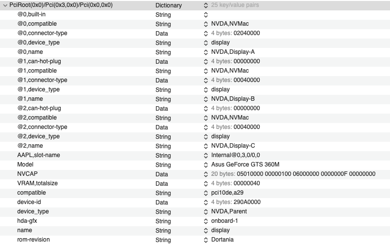

@oSxFr33k I see that you are defining 3 graphics ports (@0, @1 and @2).  You'll see in my SSDT-GFX0 that I define only 2 ports (@0, @1).  I only use my built-in LCD and external VGA port on a regular basis (I don't use my DP port), so this works for me and means that I only need to adjust 2 displays in my display settings.  Just curious - are you using all 3 displays?
EDIT: I added a 3rd graphics port (@2) to my SSDT so that I'm running with a configuration similar to yours.  The only settings change I needed to make was to Arrange displays (the addition of the 3rd port changed my graphics display arrangement).
Edited by deeveedee

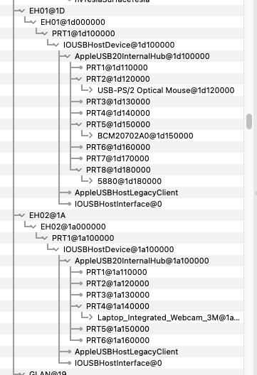

@oSxFr33k You should be using IORegistry Explorer dump from your real MBP6,2 as your reference.  Your DSDT should work with Open Core and allow you to boot Big Sur (and Monterey and Ventura). I wonder if you have to drop the original DSDT in OC?  I'm not sure.   I'll review your last posted EFI when I get more time.
Depending on your original unpatched ACPI, renaming both EH01 and EH02 may be required.  It can't hurt to have both renamed and the renames should work.
Here are IORegistry screenshots from my hack
CPU
Spoiler
EC
Spoiler
LPCB / MCHC (Note that my LPCB is equivalent to your SBRG)
Spoiler
EH01 / EH02
Spoiler
Edited by deeveedee
@oSxFr33k I reviewed your config.plist and have the following comments:
  • Why are you still injecting SSDT-PMC?
  • I don't define @x,connector-type and @x,can-hot-plug in my NVidia patches.  Did you find that you need these?
  • If your NVidia patches are correct, you shouldn't need WhateverGreen.kext
  • Depending on your Brcm card, you may need BluetoothSpoof.kext enabled in your config.plist in order to have working Bluetooth
  • Depending on your Brcm card, you may need BluetoolFixup.kext enabled for working Bluetooth
  • Depending on your Brcm card, you may need BrcmPatchRAM3 and BrcmFirmwareData kexts enabled for working Bluetooth
  • You have Kernel patches in your config.plist that I don't recognize
There are a lot of things that I can't help with because I don't have your laptop.  I still think that your best approach is to boot High Sierra with Open Core and to confirm that everything is working properly in High Sierra (with Open Core) before attempting Big Sur.

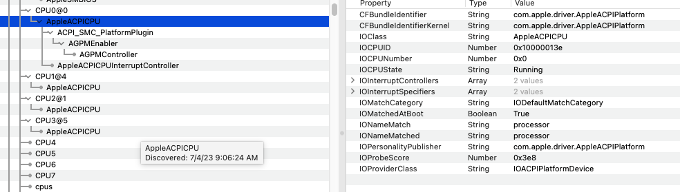

-The AGPMenabler is how you know your GPU was spoofed, if not where in ioreg tells you?
The presence of AGPM in your IORegistry tells you that macOS has recognized your CPU and GPU
My GPU
Spoiler
My CPU
Spoiler

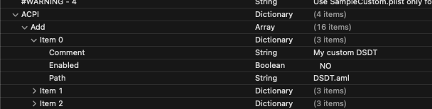

DSDT does not boot BigSur/Monterey nor Ventura only Catalina.  I will have a look at yours.  I used SSDTTime to generate the SSDTs and the USB reset partially works.
35 minutes ago, deeveedee said:
@oSxFr33k Just to clarify, you are booting Catalina with Open Core and your DSDT?
Yes, when I get home let me boot one more time just to verify.
Edited by oSxFr33k
19 hours ago, deeveedee said:
@oSxFr33k Please post your Open Core EFI that boots Catalina with your DSDT.  Also post the IORegistryExplorer captured after you boot Catalina with your Open Core / DSDT EFI.
-Apologies I spoke to soon, I have made all necessary changes as was discussed to boot Opencore config with DSDT boot, in Catalina unfortunately I get waiting for root device FD8884C1-A5C6-4B2F-A117-E23A453708C5 just assuming the root device is SATA rather than the USB, working on a fix, if I can get past this point I think she will boot.
