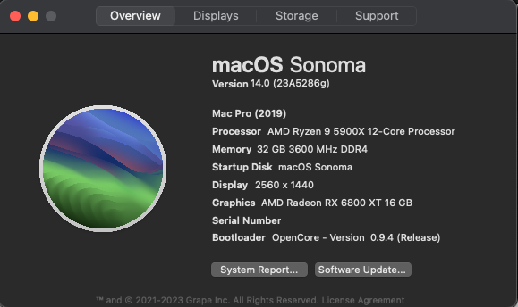

7 hours ago, cankiulascmnfye said:
@D3v1L My hack uses a T2 Bios and does receive incremental updates! That's what the different entries in SecureBootModel are for.
Is the first thing that i try....i use disabled, default, x86legacy, j160, j137 etc ,.. neither work...but is not a big issue...

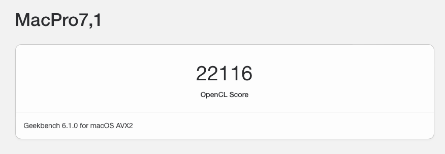

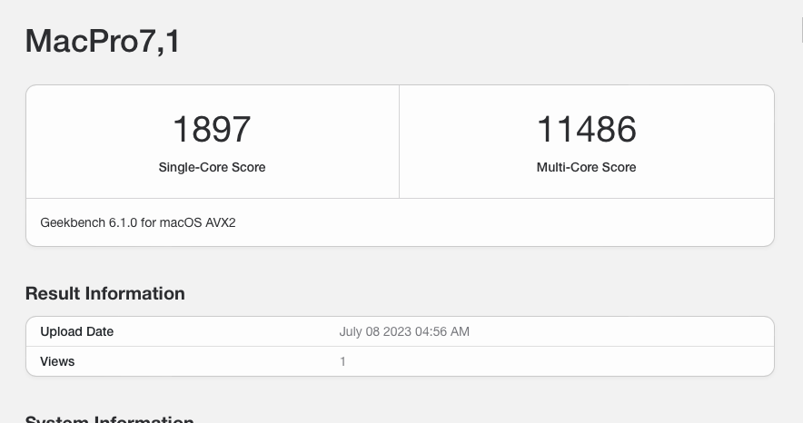

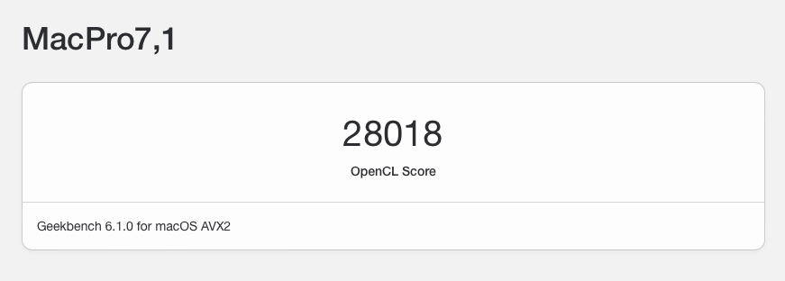

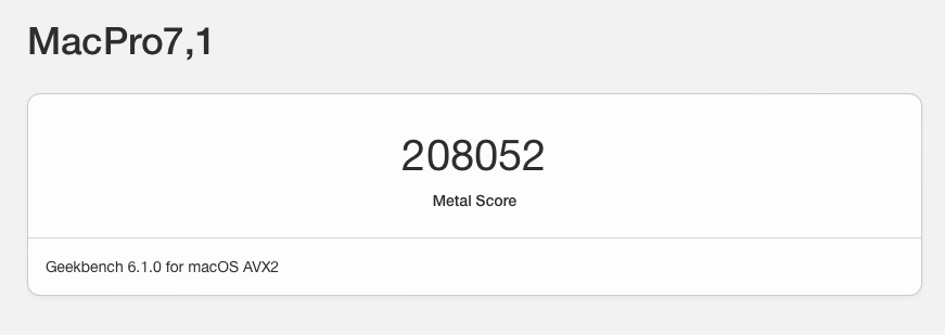

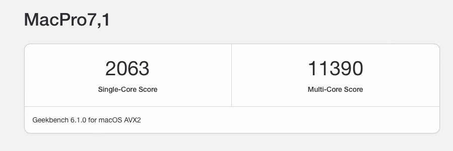

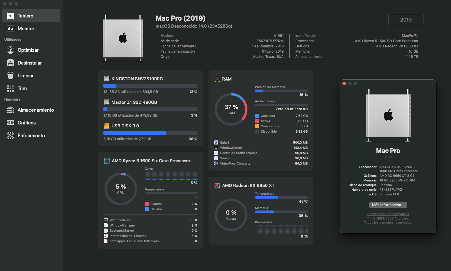

1 hour ago, SavageAUS said:
Update all good on AMD. Had to use full installer.
  Hide contents
Beta 2
Beta 3
so good AMD rock! LoL btw...ahah Geekbench...if you try 10 time , you get 11 different result ahaha LoL :-P
I normally don’t do synthetic benchmarks but for the sake of comparison between the 2 updates I thought I would test just to see how my results compare to others. Even though I think my system performs great with actual use it’s still nice to get real feedback. If you can suggest other benchmarks I’ll be happy to test them. I’m just concerned about CPU temps at idle being around 55 degrees in Sonoma.
Sent from my iPhone using Tapatalk
LoL i use geekbench too...Is only for kidding their "everytime too much different score" lol ...btw i prefer novabench for CPU and luxmark for gpu

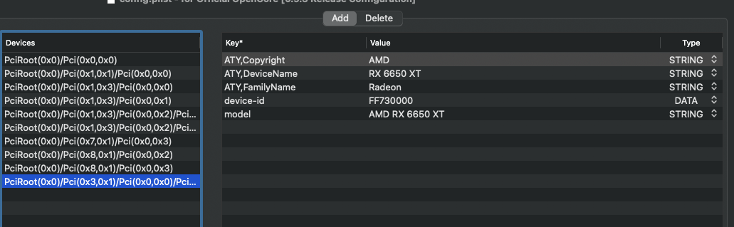

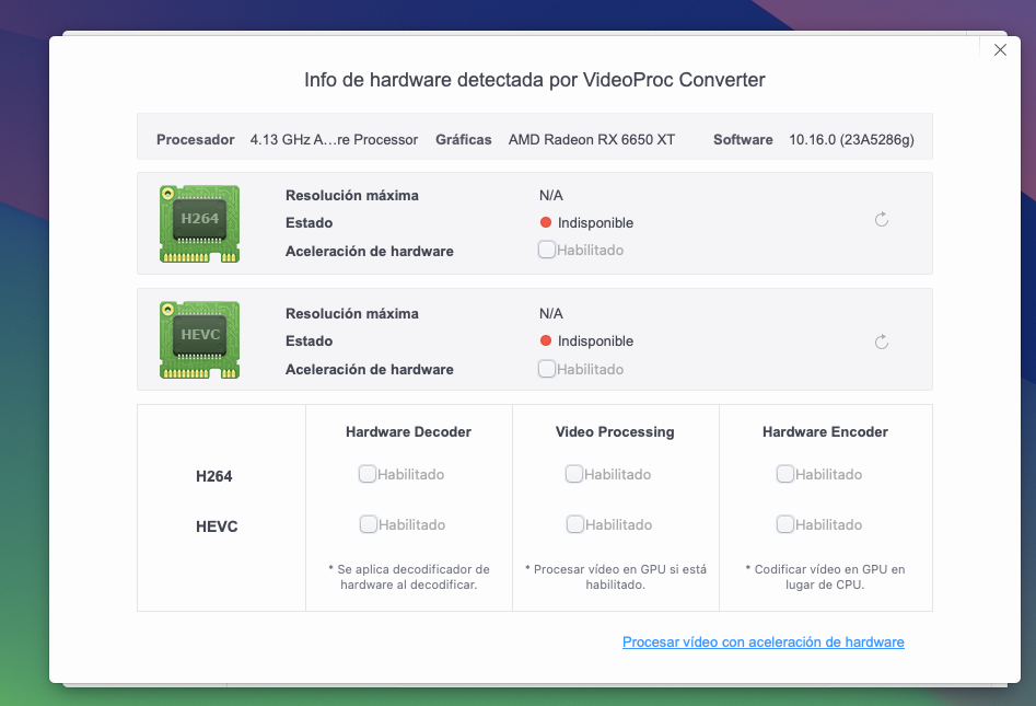

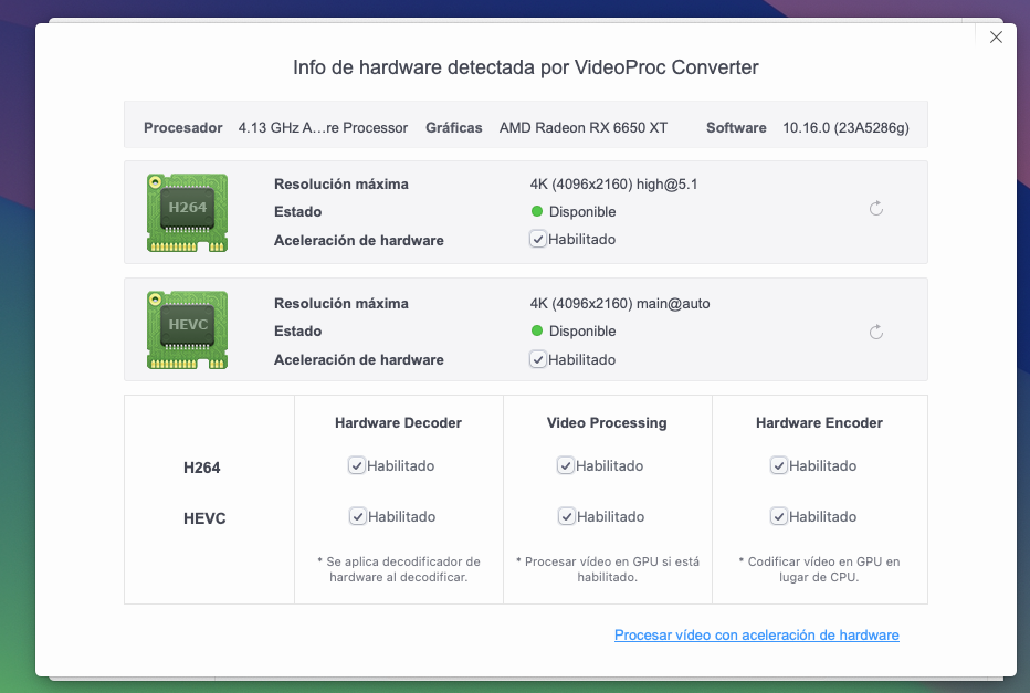

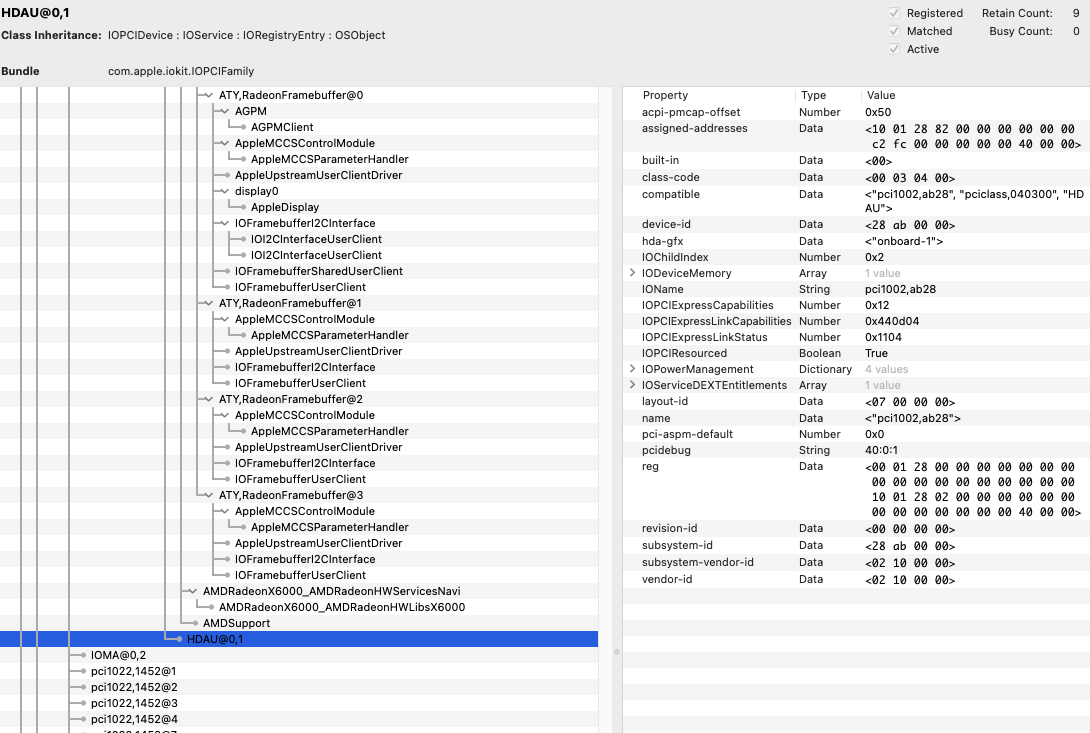

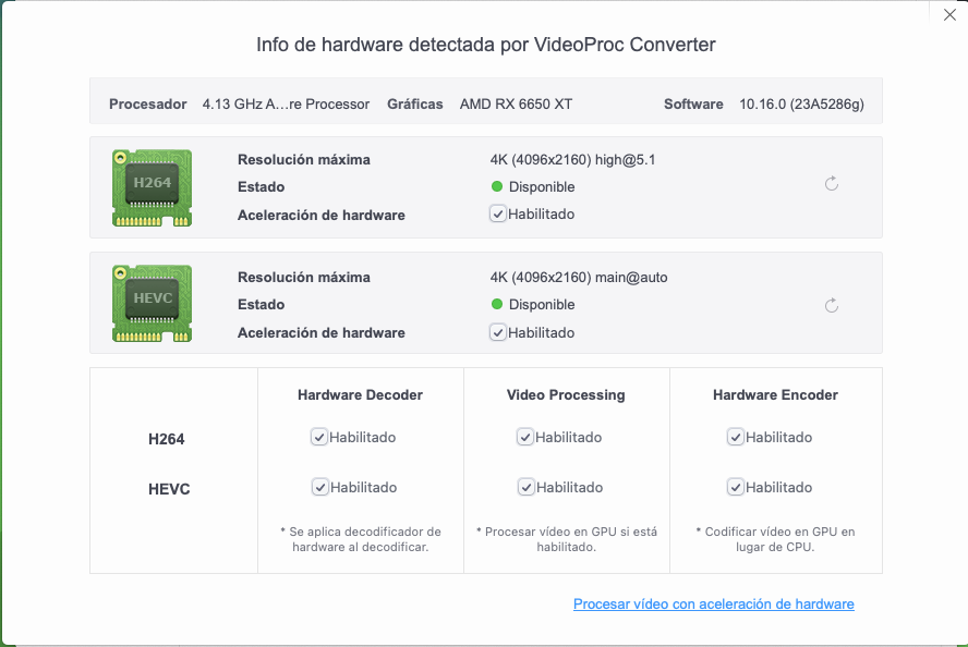

Hi guys.... 🙋‍♂️
I'm testing Sonoma on a Ryzen, which works fine, but the RX6650XT is giving me a bit of trouble... it's weird...
I have smbios of MacPro7,1, and the 6650xt works perfectly without WEG or agdpmod=pikera.... But I don't have DRM :(
And if I use WEG + agdpmod=pikera, I have DRM but lose sound over HDMI/DP ?¿?¿. very rare...
- Without WEG:
Spoiler
441617973_Capturadepantalla2023-07-08alas12_05_13.thumb.png.7e6baf88b41e197c8332be418c208e93.png
1255663830_Capturadepantalla2023-07-08alas12_08_38.png.aa74d9eb474d1a48a7e69728a1fca8ac.png
- With WEG:
Spoiler
766830554_Capturadepantalla2023-07-08alas12_08_15.thumb.png.97a1219ca8abbf3d61e2ac6e89bd7c87.png
410169908_Capturadepantalla2023-07-08alas12_10_03.png.053560ea648c387ab6e55e08e37de76f.png
Can you think of why this can happen?
>My EFI:
OC.zip
Thank you so much
I took a look in the morning. And I forgot that I am using RestrictEvents and sbvmm because I have disables SIP (set to 03080000 since I am working with pro audio stuff and all these pop-ups, notifications and access request just annoy the eff out of me). I am using SecureBootModel j185 for iMac20,2. Once the next beta drops I can disable RE and test if it works without it.
Edited by cankiulascmnfye

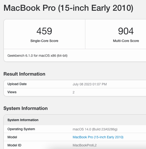

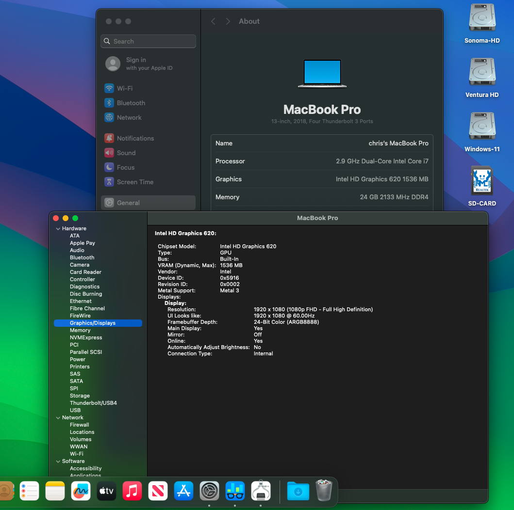

I don't mean to brag, but check out this impressive GB6 result for my HackBookPro6,2.  It only took 15 minutes to complete in Sonoma Beta 3. 😂
GB6 CPU Benchmark (MBP6,2 / Sonoma 14.0 Beta3 / OC 0.9.3)
Spoiler
Edited by deeveedee
  • Like 5

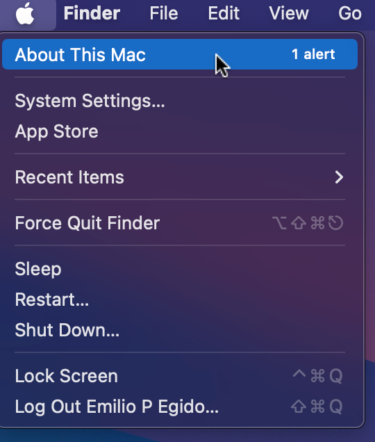

On 7/7/2023 at 5:31 PM, PMheart said:
For those using MacPro7,1 SMBios, what kind of issue do you get when using RestrictEvents pciui, memtab, and sbvmm patches?
Good afternoon, I already updated to beta 3 changing SMBIOS to iMac19,1 so I can't tell you anything about these 3 patches and OTA updates until next beta.
But I do tell you about my experience with the settings that interest you in a normal use:
  • pciui and memtab patches remove warnings and configuration tabs (memory is shown with real slots and pci tab disappears)*
  • pciui, memtab and sbvmm patches all together do, afaik, the same, taking into account that I have already updated to beta 3 and I cannot check sbvmm and OTA updates process, outside of this scope I see no difference with or without the sbvmm patch.
* Badge "About This Mac 1 alert" remains even with latest RestrictEvents and following "Removing badges" instructions (defaults delete com.apple.SlotNotificationsPref memoryBadgeCount / defaults delete com.apple.SlotNotificationsPref expansionBadgeCount). I see this alert using custom memory without RestrictEvents or RestrictEvents without custom memory. But this is another issue 🙂
Spoiler

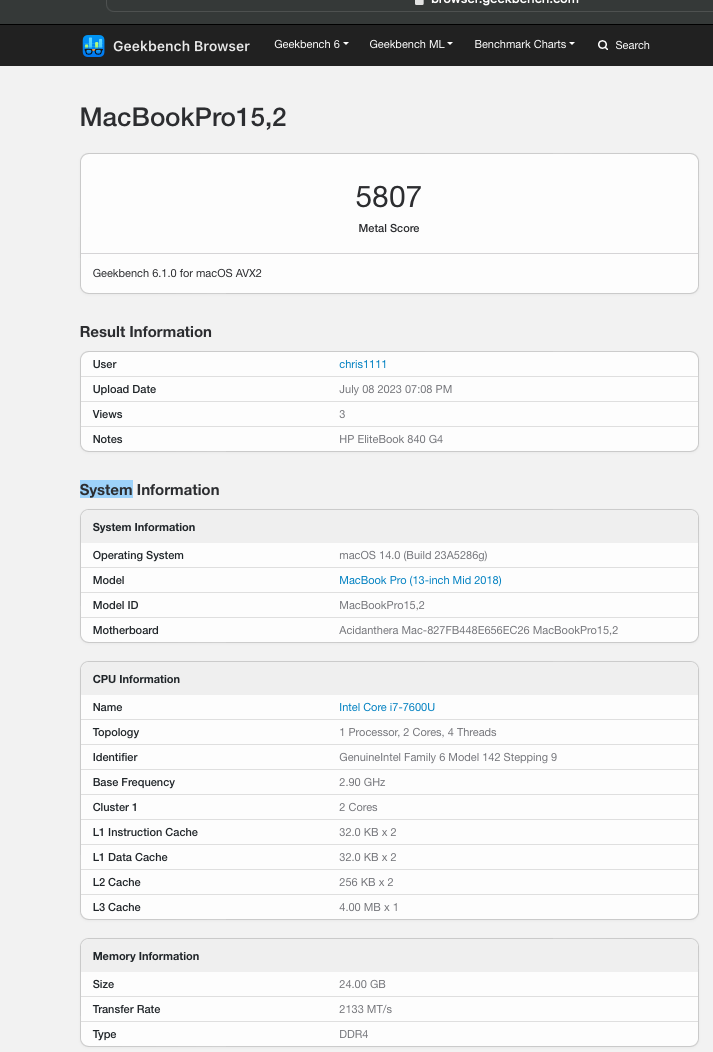

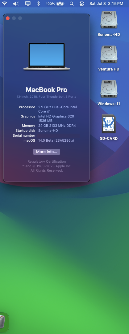

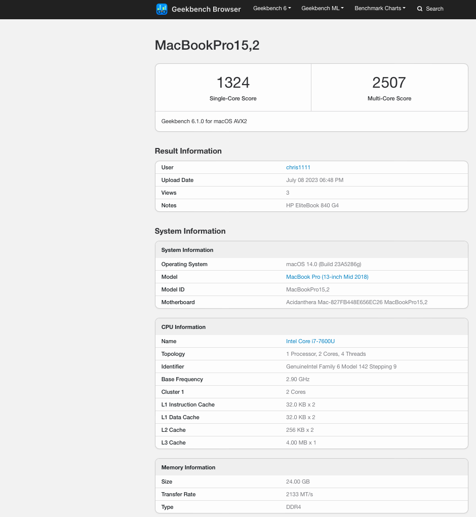

 Everything's good here HP-EliteBook-840-G4
year-old laptop that outperforms MacBook Pros 15.2 :hysterical:
macOS Sonoma 14.0 Beta (23A5286g)
Spoiler
  • Like 6

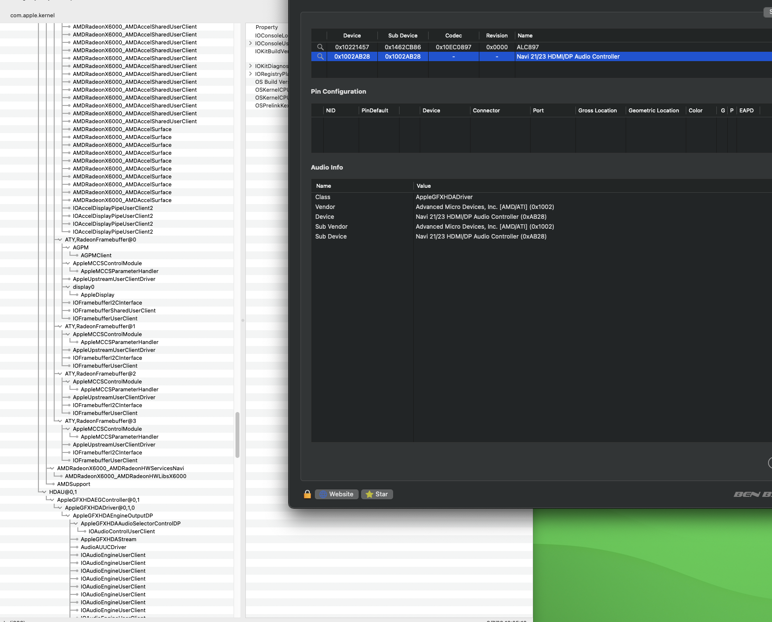

7 hours ago, PoMpIs said:
Hi guys.... 🙋‍♂️
- Without WEG:
  Reveal hidden contents
- With WEG:
>My EFI:
Thank you so much
I use the below SSDT or Kext for my 6950XT and both work. The SSDT tends to output better graphics than the kext but the kext names it as 6950XT whereas the SSDT just names it Navi 23 or something AMDRadeonNavi2xExt.kext.zipSSDT-6950XT-73A5-GPU-SPOOF.aml Maybe it will work with 6650XT
Edited by surenmunoo
  • Like 3
  • Thanks 2
@PoMpIs
Try this SSDT and config.plist instead of yours. Check the device path in both files, I've tried to write the right paths but check them. Try without and with WEG. And comment.
Suerte!!!

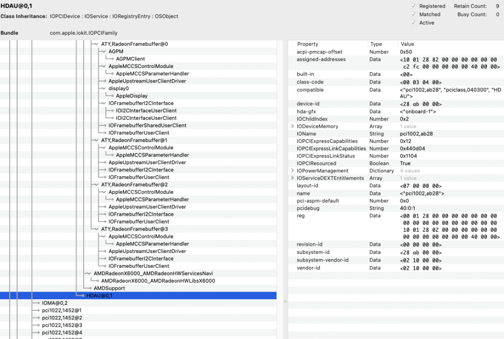

@surenmunoo  @miliuco
Thank you so much guys...🙇‍♂️
The problem continues... and it's in WhateverGreen, I activate it and I lose the audio via HDMI/DP... and the DRM is activated (appleTV, Prime Video, Netflix in Safari)
Spoiler
1687329830_Capturadepantalla2023-07-08alas15_31_05.thumb.png.10324428c5b92b6da59fd4c5e93b6363.png
575173988_Capturadepantalla2023-07-08alas15_33_07.png.0d8fdd915d4ea12b375b4c67d63be043.png
My first SSDT for the 6650XT works fine... and if I don't activate WEG, everything works perfect, including HDMI/DP audio, but when I put WEG I lose it...
The miliuco SSDT does not work because the PCI Bridges do not match..
But I really liked the injection of @miliuco in OpenCore, so I simplified the SSDT and used the injection that you have provided me, and it works great, better than before that it only showed the name of the GPU in about this mac, in the other programs showed (AMD prototype unknown)... now even Sensei.app shows it as it is in OC...
With that injection on OC and this SSDT it's going great and everywhere the GPU comes out by its correct name

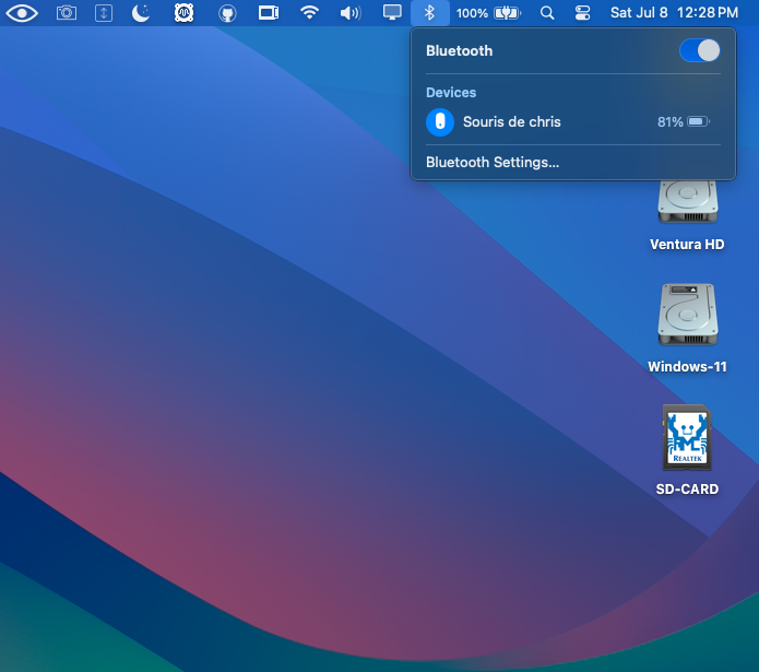

  Hide contents

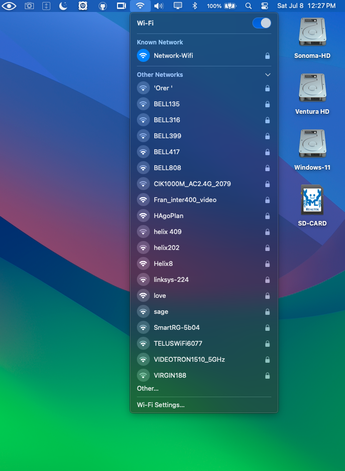

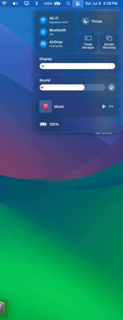

Hi @chris1111 awesome job my friend, I saw your GitHub references, are you using BCM94360NG Wi-Fi and Bluetooth Card ?  Works for you in Sonoma?
If yes, how are your config for that?
Thanks!!
  • Haha 2
Thanks!!
No its an Intel AX200NGW WiFi 6 / Bluetooth 5.0
The only thing difficult is Airdrop, it work on Ventura but Sonoma not really
  • Thanks 1
Thanks for reply my friend, and mail too.
God bless you!!

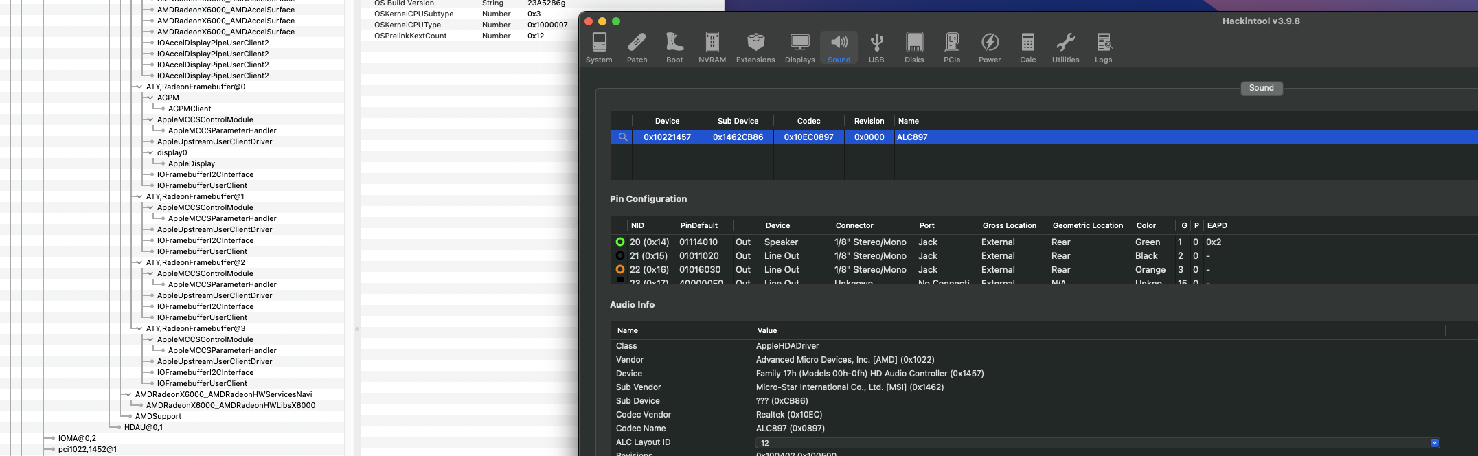

@PoMpIs
For DRM:
For Audio over HDMI/DP:
  • Add property hda-gfx to your AMD GPU Device Properties. Type: String, Value: onboard-2 (if your system also has an iGPU) or onboard-1 (if you don't have an iGPU)
