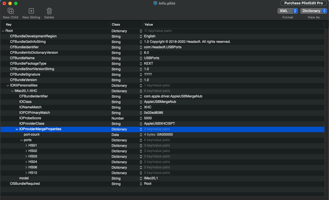

Hello I opened your EFI , if you like you can improve your configuration. The problems you have depend on an inappropriate SMBios. Uses IMac 20.1 is for PC Desktop ,MacbookPro 15.4 is the most correct. Start Ioreg and save\mail the log and let's improve your configuration.
USB port mapping is done badly, I leave you 1 EFI to test and in case we try to work on this EFI

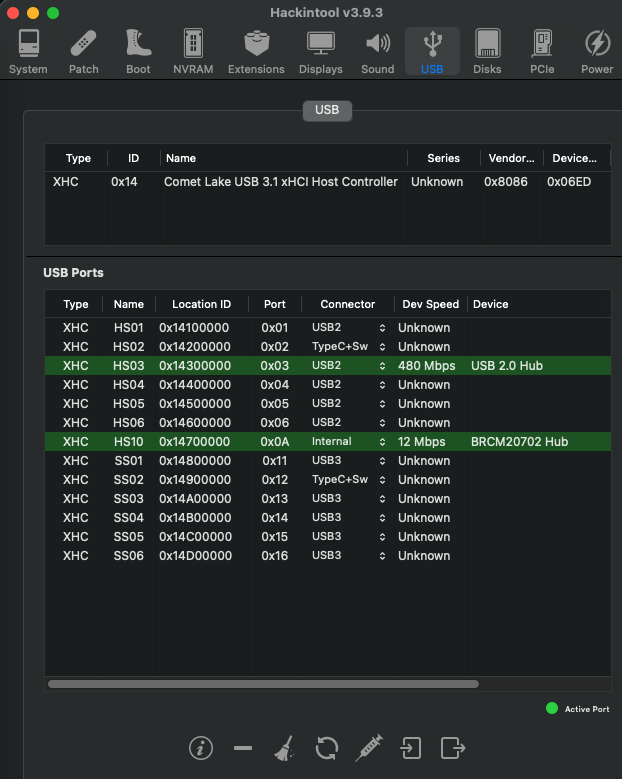

Correct port mapping must include HSxx = USB 2.0 and SSxx = USB 3.0 ports look down
https://drive.google.com/drive/folders/1OIzcMH7yxTVOP2rzEKAXWplTI1Psw-D_?usp=sharing test this if start ioreg
