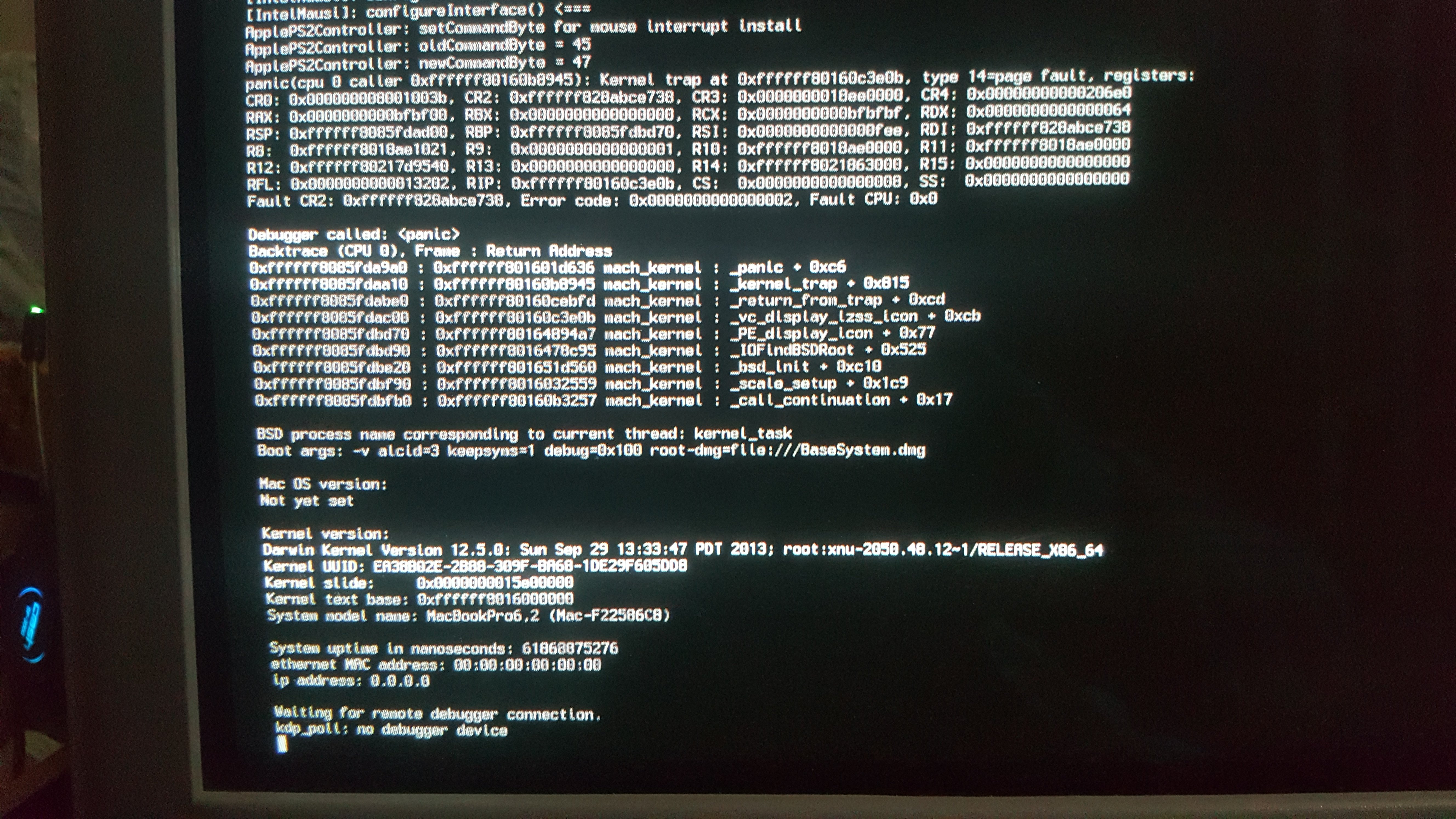

After I setup EFI folder for the installation (with OpenCore v0.8.6) and boot it, it has a panic or problem as in the image
I don't know why this problem or what is the wrong in my setup
I tried to disable the secondary kexts (such as BrcmBluetooth, itlwm, and even VoodooPS2) but nothing changed
I even tried another version of macOS (which is HS 10.13.6) but with the same result

1. I think Telemetrap.kext is unnecessary.
Intel 1st Gen Arrandale CPU supports all up to SSE4.1 & SSE4.2.
Telemetrap.kext is used when the CPU only supports instruction set up to SSE4.1 and does not support SSE4.2.
2. When I searched mXHCD.kext, it says that it only works from OS X Mavericks 10.9 to macOS Catalina 10.15.
Disable or specify a MinKernel value so that OS X Mountain Lion 10.8.x does not load when booting.
3. Rearrange the Kext loading order in Kenel - Add as follows:
- Lilu
- VirtualSMC
- WhateverGreen
- AppleALC
- SMC Plugins
- Wi-Fi/Bluetooth
- Other Kexts
