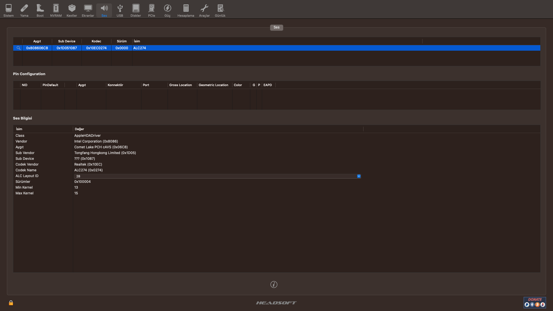

ALİ SADIK ŞANLI Posted November 9, 2022 Author Share Posted November 9, 2022 (edited) @PG7 I tried all of the layout ids, only 28 and 39 have sound, they don't work even though they have a headphone connection, I tried hpet, it didn't work.Also, my pin configuration is not showing in hackintool. Edited November 9, 2022 by ALİ SADIK ŞANLI Quote Link to comment https://www.insanelymac.com/forum/topic/354723-can-you-help-me-create-my-pin-config-file-from-codec-dump/#findComment-2796982 Share on other sites More sharing options...

ALİ SADIK ŞANLI Posted November 10, 2022 Author Share Posted November 10, 2022 I think there is no solution to the problem. I tried to do the hpet, alc plug fix, alc patching, pin configuration processes myself without any help, but I will not look for solutions for hackintosh anymore, I give up. Maybe I can buy a real macbook, at least a chance to get to know the mac system with hackintosh I found it, it was a nice adventure, we came to the end. Quote Link to comment https://www.insanelymac.com/forum/topic/354723-can-you-help-me-create-my-pin-config-file-from-codec-dump/#findComment-2797036 Share on other sites More sharing options...

ALİ SADIK ŞANLI Posted November 10, 2022 Author Share Posted November 10, 2022 @slice yes i see you signature,I checked the VoodooHDA ventura guide and installed it that way, it still didn't work. @spakk I tried your kext, this time I can't get any sound from any of the layout ids and my device doesn't even show up. Quote Link to comment https://www.insanelymac.com/forum/topic/354723-can-you-help-me-create-my-pin-config-file-from-codec-dump/#findComment-2797069 Share on other sites More sharing options...
ALİ SADIK ŞANLI Posted November 10, 2022 Author Share Posted November 10, 2022 I think I have such a problem because my alc 274 manufacturer id is different, the manufacturer appears as schenker technologies and the pin configuration of this device does not match the pin configurations in apple alc, correct me if I am wrong. 1 Quote Link to comment https://www.insanelymac.com/forum/topic/354723-can-you-help-me-create-my-pin-config-file-from-codec-dump/#findComment-2797070 Share on other sites More sharing options...
