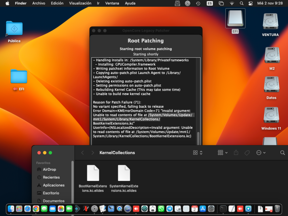

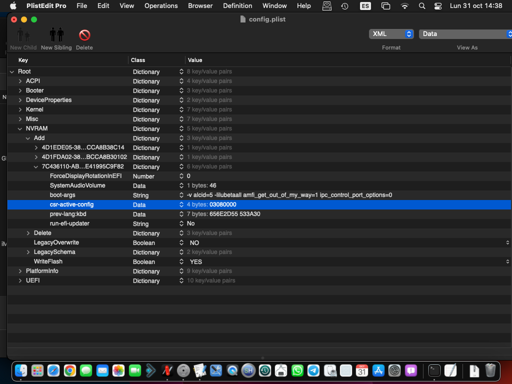

kaoskinkae Posted October 31, 2022 Share Posted October 31, 2022 (edited) I have installed on a Gigabyte Z77X-D3H i5 2310 with an Asus Geforce Gt 640 2Gb macOS Ventura on this computer with Sandy Bridge without problems when updating from macOS Monterey as a clean installation I have an ImacPro1.1 as Boot system. But now the important thing I have tried to activate the indicated Kepler graph without apparent results, I leave photos of the initial configuration. The process is to apply the corresponding patch I have tried both without result. Once the patch with CSR 03080000 has been applied, and the confi.plist nv_disable=1 is removed, the system starts, I select the disk where macOS 13 Ventura is installed, the loading of the loading lines ends and when a second logo should appear, black background and icon from apple blank, the system goes to stanbyte I don't know if there is to remove any boot from the start Edited November 2, 2022 by kaoskinkae 1 Link to comment https://www.insanelymac.com/forum/topic/354629-sandy-bridge-macos-ventura-asus-geforce-gt-640-2gb/ Share on other sites More sharing options...

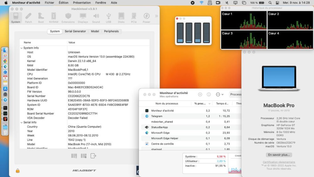

cyrhex Posted November 9, 2022 Share Posted November 9, 2022 try to patch your gt 640in safemode i got working gt 730 kepler in ventura using oclp 5.0 Link to comment https://www.insanelymac.com/forum/topic/354629-sandy-bridge-macos-ventura-asus-geforce-gt-640-2gb/#findComment-2796961 Share on other sites More sharing options...

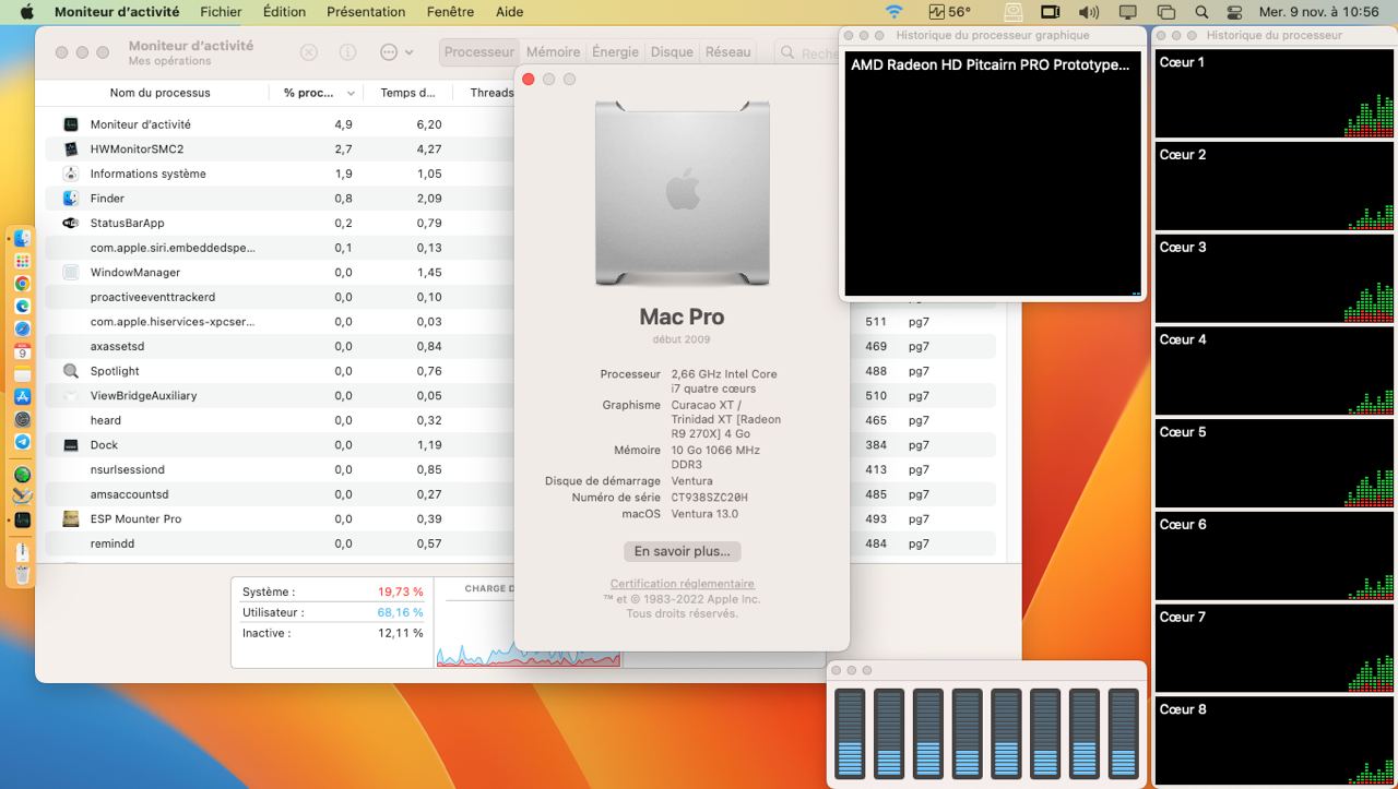

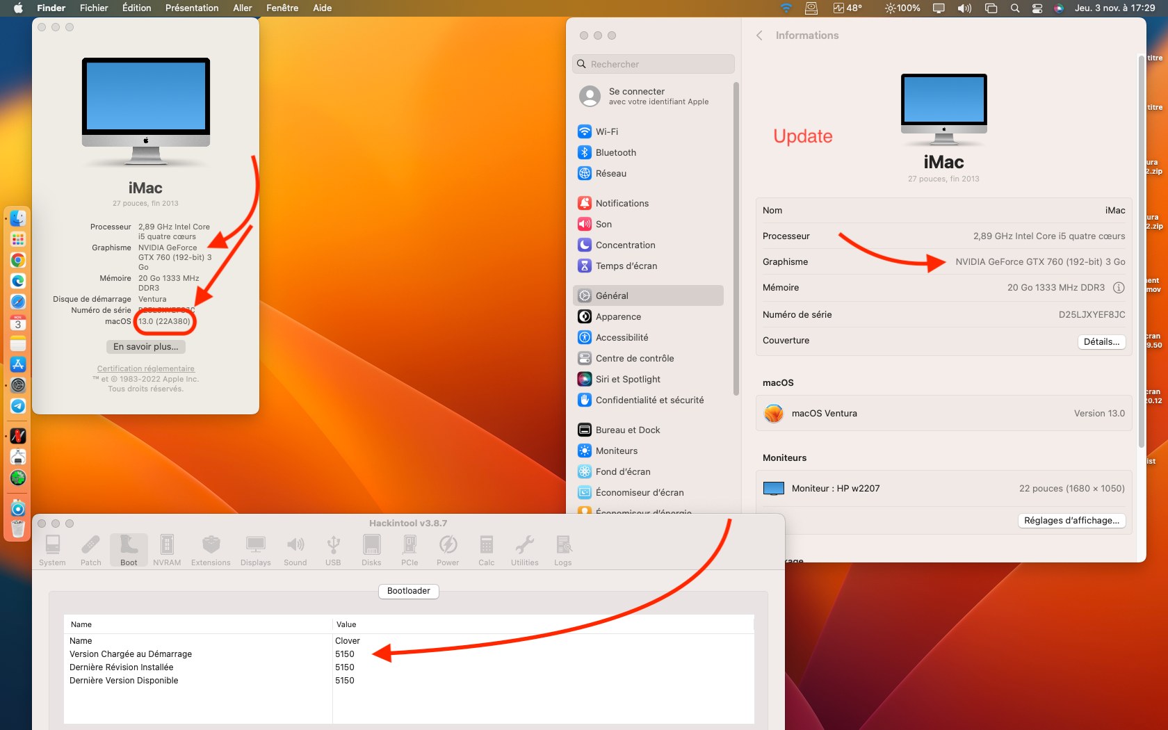

PG7 Posted November 9, 2022 Share Posted November 9, 2022 @kaoskinkae here always works even the injection of kext tesla is already inserted but not 100% functional, Send your EFI OC and Clover with the version of each to analyze (the EFI that work in the previous version) Spoiler Link to comment https://www.insanelymac.com/forum/topic/354629-sandy-bridge-macos-ventura-asus-geforce-gt-640-2gb/#findComment-2796979 Share on other sites More sharing options...
