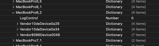

deeveedee Posted May 6, 2025 Author Share Posted May 6, 2025 I was looking at AppleGraphicsPowerManagement.kext in Sonoma for another hack and noticed this: AGPM never dropped MBP6,2 (and even older) Link to comment https://www.insanelymac.com/forum/topic/354497-guide-dell-latitude-e6410-nvidia-hackintosh-big-sur-monterey-ventura-sonoma-sequoia-tahoe-installations-with-open-core-legacy-patching/page/14/#findComment-2832099 Share on other sites More sharing options...

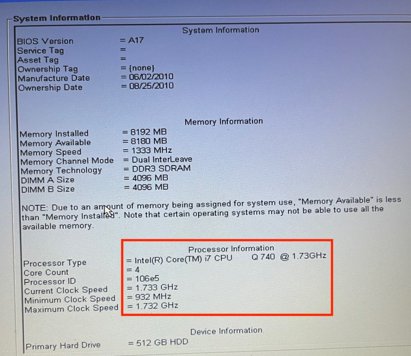

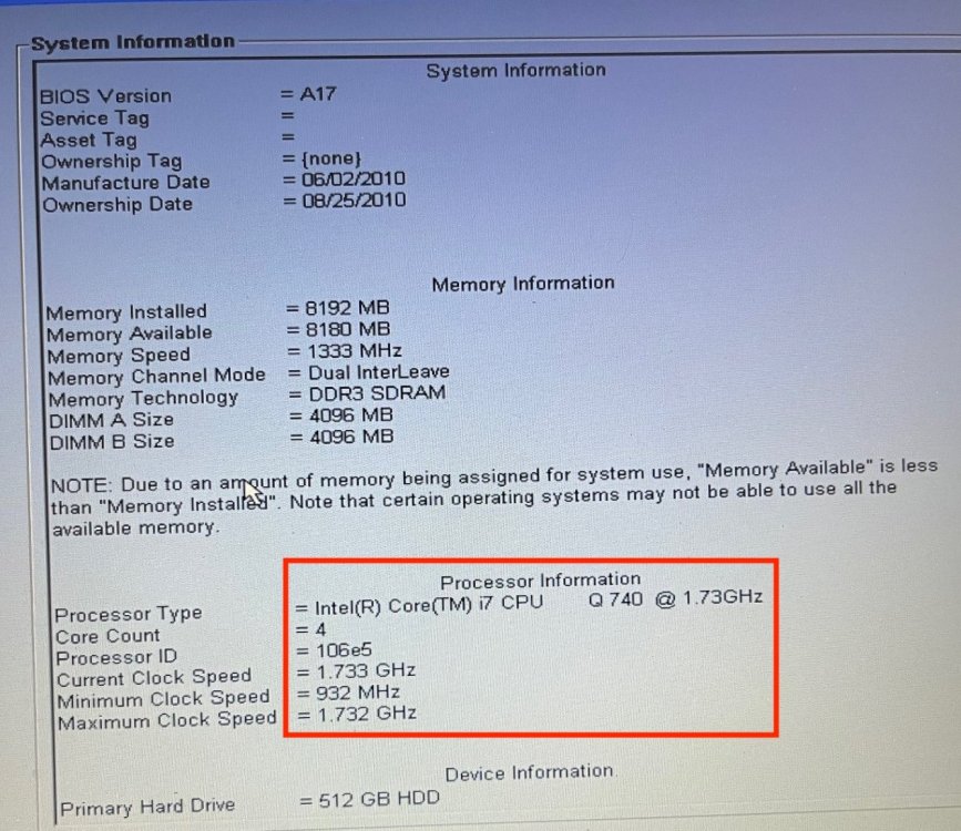

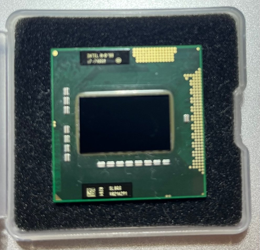

deeveedee Posted May 14, 2025 Author Share Posted May 14, 2025 (edited) I recently tried something that I've wanted to try on this laptop for a while... I installed an i7-740qm quad-core CPU to replace the i7-620m dual-core CPU. I was hoping that the laptop would just boot macOS without much work, but that was not the case. I didn't spend any time to diagnose/debug and immediately re-installed the i7-620m after this failed experiment. No damage done during this harmless experiment and it gave me a chance to clean out the dust and replace thermal compound. After re-installing the i7-620m, the laptop booted Sequoia 15.5 (which I'm using to post this). Details After replacing the i7-620m with i7-740qm, the laptop POSTed, but would not boot Sequoia (screen went black when progress bar reached 50%). With the i7-740qm, the touchpad did not work in BIOS and the laptop was noticeably hotter. I use copper shims to enhance CPU and dGPU thermal conductivity with the heat pipe, so the laptop did not experience a thermal shutdown. Spoiler This CPU has a HUGE 23mm x 15mm die. After replacing the originally installed i7-620m (dual-core Arrandale) with the i7-740qm (quad-core Clarksfield), the laptop booted without issues into BIOS. Spoiler Edited May 14, 2025 by deeveedee 1 Link to comment https://www.insanelymac.com/forum/topic/354497-guide-dell-latitude-e6410-nvidia-hackintosh-big-sur-monterey-ventura-sonoma-sequoia-tahoe-installations-with-open-core-legacy-patching/page/14/#findComment-2832308 Share on other sites More sharing options...

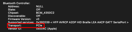

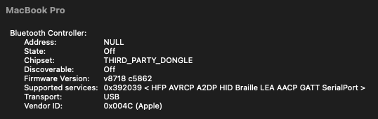

deeveedee Posted August 19, 2025 Author Share Posted August 19, 2025 (edited) EDIT: I fixed the problem reported below by adding BluetoolFixup boot-arg -btlfxboardid. The problem was caused by a change in BluetoolFixup.kext introduced in version 2.7.0, not a change in macOS. I haven't been testing as thoroughly as I do on my "production" hacks, so I missed the fact that Bluetooth stopped working at some point in Sonoma. I'm currently testing with Sonoma 14.7.7. If someone wants/needs working Bluetooth on this old hack, maybe you can review my EFI and see if there is a problem with USBPorts.kext. I'm using BrcmPatchRam (and associated kexts) version 2.7.1. EDIT: The internal USB webcam works, so I don't think the problem is USB mapping. This might be a problem with BluetoolFixup.kext (not the first time that BluetoolFixup has stopped working with a macOS upgrade). Bluetooth Transport incorrectly identified as PCIe. EDIT: I fixed this problem by adding BluetoolFixup boot-arg -btlfxboardid EDIT2: The addition of BluetoolFixup boot-arg -btlfxboardid does not affect Bluetooth operation in Ventura (in fact, it might work better), so boot-arg -btlfxboardid will become a permanent addition to my EFI. boot-args: -btlfxboardid EDIT3: With the -btlfxboardid boot-arg, Bluetooth Transport is properly detected as USB in Sonoma 14.7.7 and newer macOS. Spoiler EDIT4: @Stefanalmare I tested Sleep/Wake in macOS Sonoma and Sequoia after adding boot-arg -btlfxboardid. Bluetooth works perfectly through sleep/wake cycles with this boot-arg (I was already using BluetoolFixup boot-arg -btlfxallowanyaddr). Thank you for offering your custom build of BluetoolFixup.kext here, but when faced with the choice of a custom build and Acidanthera's official release, I always prefer to use Acidanthera's official release. Since the official release works perfectly simply by adding boot-args, I'll stay with Acidanthera's version. Thank you. EDIT5: I checked the commits to BluetoolFixup.kext after version 2.6.9 and see that the automatic BoardID patch was removed AFTER BluetoolFixup.kext version 2.6.9. The -btlfxboardid boot-arg is relevant only to EFIs that use BluetoolFixup.kext version 2.7.0 and later. This problem was caused by a change in BluetoolFixup.kext introduced in version 2.7.0, not a change in macOS. See BluetoolFixup.kext 2.7.0 Change Log Edited August 22, 2025 by deeveedee Link to comment https://www.insanelymac.com/forum/topic/354497-guide-dell-latitude-e6410-nvidia-hackintosh-big-sur-monterey-ventura-sonoma-sequoia-tahoe-installations-with-open-core-legacy-patching/page/14/#findComment-2839480 Share on other sites More sharing options...

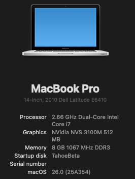

deeveedee Posted September 10, 2025 Author Share Posted September 10, 2025 Here's a little teaser for things to come ... About This Hack: Tahoe RC1 2 1 Link to comment https://www.insanelymac.com/forum/topic/354497-guide-dell-latitude-e6410-nvidia-hackintosh-big-sur-monterey-ventura-sonoma-sequoia-tahoe-installations-with-open-core-legacy-patching/page/14/#findComment-2840466 Share on other sites More sharing options...

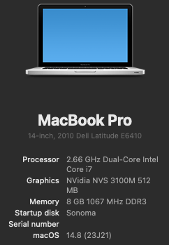

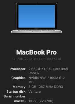

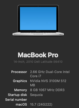

deeveedee Posted September 17, 2025 Author Share Posted September 17, 2025 (edited) This HackBookPro6,2 is now running release versions of Ventura 13.7.8, Sonoma 14.8, Sequoia 15.7 and Tahoe 26.0. Patiently waiting for OCLP 3.0.0 so that I can apply post-install patches to Tahoe. About This Hack: Ventura 13.7.8 Spoiler About This Hack: Sonoma 14.8 Spoiler About This Hack: Sequoia 15.7 Spoiler EDIT: Now running Sequoia 15.7.1 and Sonoma 14.8.1. Patching with OCLP 2.4.1. Edited October 2, 2025 by deeveedee Added About This Hack screenshots 4 Link to comment https://www.insanelymac.com/forum/topic/354497-guide-dell-latitude-e6410-nvidia-hackintosh-big-sur-monterey-ventura-sonoma-sequoia-tahoe-installations-with-open-core-legacy-patching/page/14/#findComment-2840770 Share on other sites More sharing options...

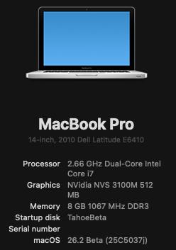

deeveedee Posted November 14, 2025 Author Share Posted November 14, 2025 Easy upgrade from Tahoe 26.2 Beta 1 -> Beta 2. Still patiently waiting for OCLP post-install patches, but I did test a few Apple Apps just to see if they opened. FaceTime opens (and camera works), Terminal opens and is fully functional, Activity Monitor opens and works... Better than I would expect without post-install patches. Link to comment https://www.insanelymac.com/forum/topic/354497-guide-dell-latitude-e6410-nvidia-hackintosh-big-sur-monterey-ventura-sonoma-sequoia-tahoe-installations-with-open-core-legacy-patching/page/14/#findComment-2843676 Share on other sites More sharing options...
