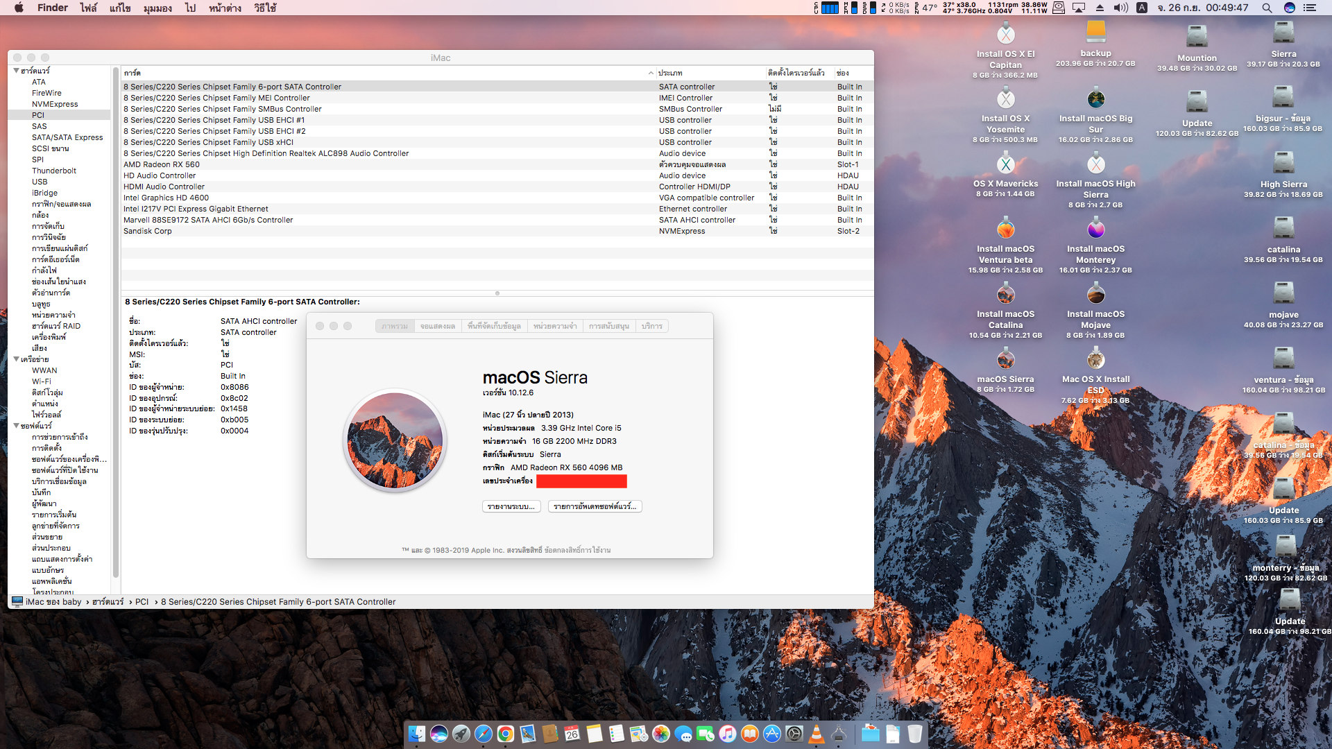

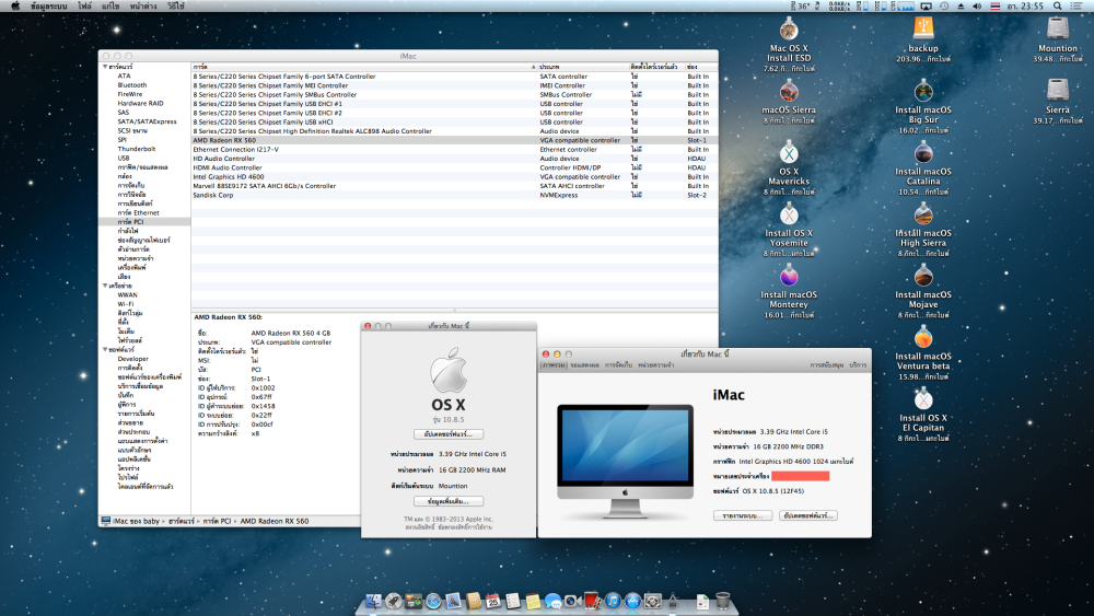

naiclub Posted September 25, 2022 Share Posted September 25, 2022 (edited) 1 hour ago, STLVNUB said: Thanks for your input, Snow Leopard is nearly done, will try the latest OC I can go as far as this. Spoiler And it's unbelievable that Sierra There is also support for RX560 graphics cards. I think Apple will include the driver as the final release. Normally, it only starts at the high Sierra. Spoiler Edited September 25, 2022 by naiclub works Link to comment https://www.insanelymac.com/forum/topic/353975-older-osx-versions-on-newer-harware-and-latest-cloveropencore/#findComment-2793973 Share on other sites More sharing options...
