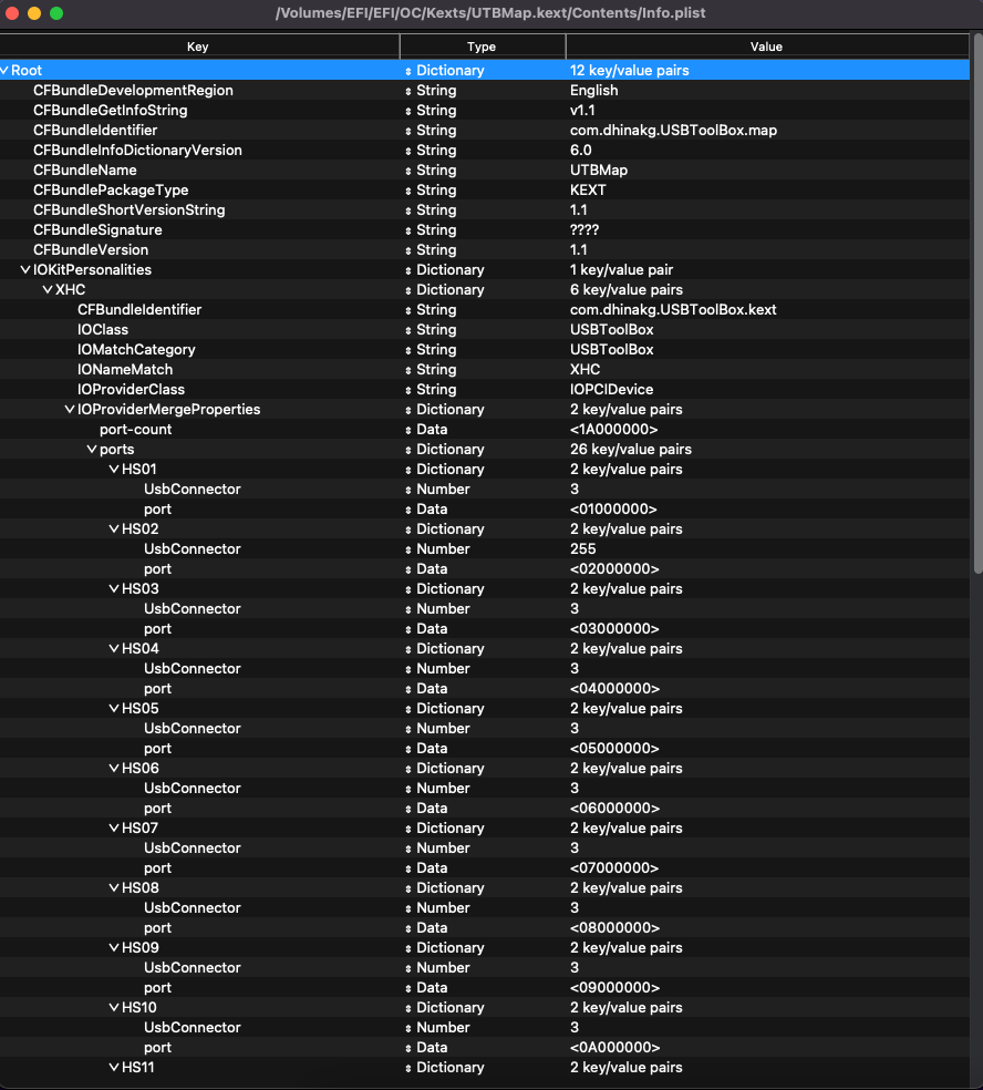

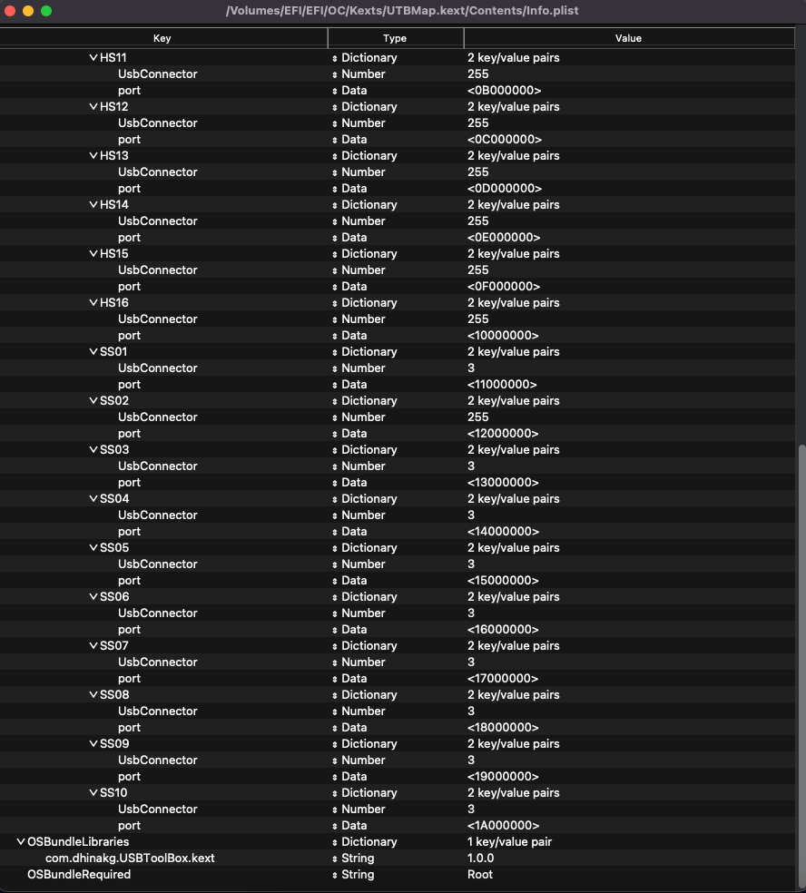

MrPaulfpv Posted September 11, 2022 Author Share Posted September 11, 2022 3 hours ago, Cyberdevs said: @MrPaulfpv Hi, I've almost had a similar issue with Monterey and the issue was the built-in bluetooth so I disabled it in the UTBMap.kext by removing the entry corresponding to the Bluetooth. About the WiFi you might be able to activate it using https://github.com/OpenIntelWireless/itlwm you can also try https://github.com/OpenIntelWireless/IntelBluetoothFirmware for the Bluetooth module but i'm not sure if it's gonna work. You're also gonna need BluetoolFixup.kext that can be found inside the https://github.com/acidanthera/BrcmPatchRAM/releases/tag/2.6.3 package. Hi @CyberDevs, im gonna try out those kext for the wifi, i will keep an update here for more people to be aware of that. When you say disable the entry for bluetooth in UTPMap.kext, thats on info.plist but where, i´ve been searching for like a while now and im wasnt been able to locate it. I will post the info.plist and a screenshoot so its easier. Thanks a lot. Its been a while since my first Hachintosh and im a little bit roasted. Info.plist Link to comment https://www.insanelymac.com/forum/topic/353513-monterrey-post-install-issues/#findComment-2793029 Share on other sites More sharing options...
Slice Posted September 12, 2022 Share Posted September 12, 2022 10 hours ago, MrPaulfpv said: Hi @CyberDevs, im gonna try out those kext for the wifi, i will keep an update here for more people to be aware of that. When you say disable the entry for bluetooth in UTPMap.kext, thats on info.plist but where, i´ve been searching for like a while now and im wasnt been able to locate it. I will post the info.plist and a screenshoot so its easier. Thanks a lot. Its been a while since my first Hachintosh and im a little bit roasted. Info.plist 5.66 kB · 0 downloads You should do the map so that HS** + SS** ports will be 15. Total number of HS and SS ports must not exceed 15. Link to comment https://www.insanelymac.com/forum/topic/353513-monterrey-post-install-issues/#findComment-2793039 Share on other sites More sharing options...

Slice Posted September 13, 2022 Share Posted September 13, 2022 11 hours ago, MrPaulfpv said: @Slice Ok i will try to do only max 15 ports, in mu UTBMAP.kext ive got 24 more or less. I will disable front ports and internal motherboardports that i dont use, lets hope it will be fine. @Cyberdevs Here is the full comand of IOREG. Lets hope i can disable it. Otherwise i can remap with only usbports i need to do research on that. Here is the FIle IOREG IOREG.txt 77.48 kB · 1 download As I see last port is HS15 as expected. No SSxx ports because of that. Link to comment https://www.insanelymac.com/forum/topic/353513-monterrey-post-install-issues/#findComment-2793131 Share on other sites More sharing options...
