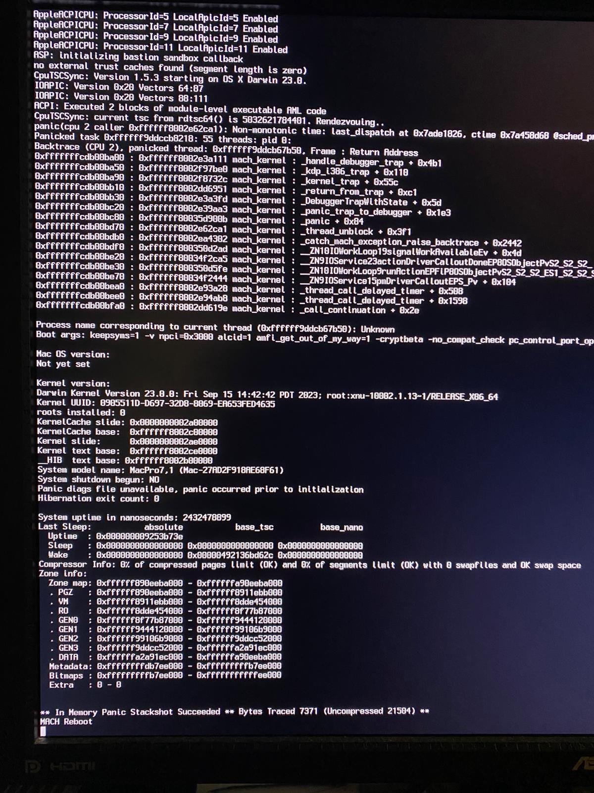

rubah ganteng Posted October 23, 2023 Share Posted October 23, 2023 33 minutes ago, RoberT_XeS said: First Use this as it is. SABERTOOTH_EFI.zip 7.21 MB · 2 downloads If you need you can apply AMD Graphics patch later I got kernel panic show the pictur, by the way thanks u for help Quote Link to comment https://www.insanelymac.com/forum/topic/352224-macos-ventura-on-x79/#findComment-2812707 Share on other sites More sharing options...
Slice Posted October 23, 2023 Share Posted October 23, 2023 CpuTscSync is not working. Consider to use VoodooTSCSync. 1 Quote Link to comment https://www.insanelymac.com/forum/topic/352224-macos-ventura-on-x79/#findComment-2812708 Share on other sites More sharing options...

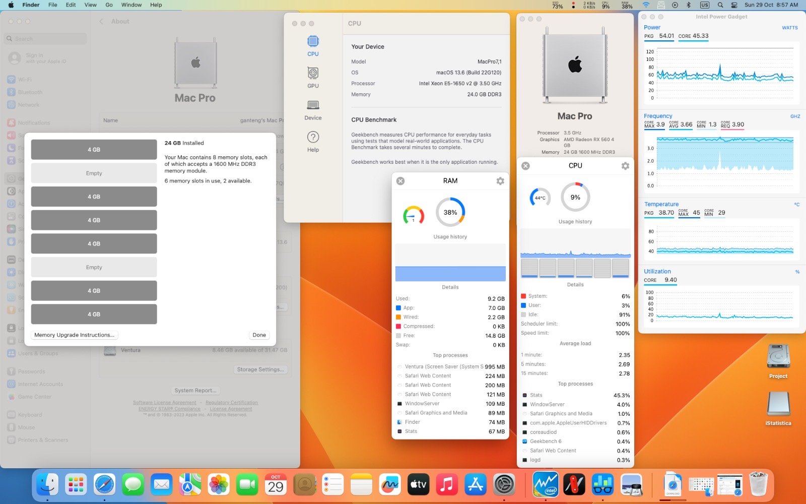

rubah ganteng Posted October 30, 2023 Share Posted October 30, 2023 (edited) @RoberT_XeS thanks for help via Telegram 🙏 • USB remap very important • just add 2 kext patch for Polaris GPU NoAVXFSCompressionTypeZlib-AVXpel.kext and • CryptexFixup.kext • Add boot arg -amd_no_dgpu_accel for installation macOS then remove -amd_no_dgpu_accel Post Install after patching with OpenCore Legacy replace agdpmod=pikara. • Disable SIP code 030E0000 🙏🙏🙏🙏🙏 Edited October 30, 2023 by rubah ganteng 1 Quote Link to comment https://www.insanelymac.com/forum/topic/352224-macos-ventura-on-x79/#findComment-2812964 Share on other sites More sharing options...
