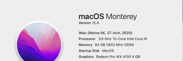

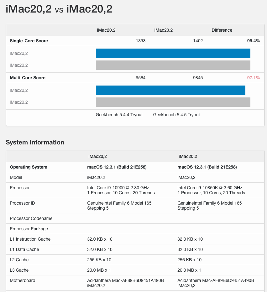

rafale77 Posted April 21, 2022 Share Posted April 21, 2022 (edited) Background: After using "a perfect MacMini Hackintosh" for the past 2 years going from the HP Powerdesk/Elitedesk Mini G4 to G5 inspired by @deeveedee, I have decided to build a very similar system leveraging some the knowledge accumulated over the years. It has been a great machine but there were some limitations/quirks I was looking to overcome: 1. PCIe Expansion capability using cheaper non proprietary cards 2. CPU power limitation as I discovered recently that my 65W core i9 was underperforming due to its PL2 limit. 3. The elusive CPU MSRx02/CFGLock forcing an additional patch on the HP. 4. The one thing which doesn't function on the hack is DRM support. (I am still working on that one) 5. The reactivity of the BIOS command of the CPU fan in response to temperature hikes was lacking causing more thermal throttling than necessary. For sake of learning about it and in the hopes of addressing the DRM issues, I settled on the one AMD GPU I could get my hands on which would fit the box: The Radeon Pro WX4100. It is single slot half height. These machines are normally sold with nVidia P620/P1000/T600/T1000 which can't be hacked... but are even smaller. The Lenovo is a much more upgradable unit allowing for a greater realization of higher end CPUs potential. The Dell micro appear to be very similar to the HP Mini in terms of power supplies and for most configurations are limiting the CPU’s performance by decreasing its PL2. Details on the power limitations on the CPU for those who prefer data in a table format comparing the HP Mini to the Lenovo Tiny for Q370/Q470/Q570 chipset units: Model and configuration 35W Core i3/i5 PL2 (65W PL2) 35W Core i7/i9 (90W PL2) 65W Core i3/i5 (135W PL2) 65W Core i7/i9 (235W PL2) Power/dGPU Upgradable HP 35W G4/5/6/8 65W PSU. PL2=50W Limited. dGPU very limited Very Limited N/A N/A No. Limited by motherboard HP 65W G4/5/6/8 90W PSU. PL2=65W Ok *CPU downgrade Limited Very Limited Very Very Limited No. Limited by motherboard HP 35W G4/5/6/8 with dGPU 150W PSU. PL2=90W Ok Ok Limited Very Limited No. Nothing to upgrade to. Lenovo M920Q/M920X with 90W PSU. PL2=65W Ok Limited N/A N/A Yes Lenovo M920X/ M90Q G1/G2. 135W PSU. PL2= 90W Ok even with dGPU Ok even with dGPU Ok. Limited with dGPU Very Limited. no dGPU Yes Lenovo P330/P340/P350 170/230W PSU. PL2=135W Ok with dGPU Ok with dGPU Ok with dGPU Limited. Yes Side benefit: the NVMe SSDs are tool-less. SSD and DRAM are on the bottom side of the unit which frees up space to the top side. Dimension wise the units are very similar and are part of the mini/micro/tiny 1L class. The Lenovo is 1mm thinner, about the same width but deeper by 5mm. The rear external wifi antenna design is definitely nicer on the HP. My System Specs: Lenovo P340 (Core i9 10900 / UHD 630 / Q470 / 64GB DDR4 3200) AMD Radeon Pro WX4100 (In order to fit it, I had to remove the front wifi antenna panel and tape the antenna to the back of the GPU) 1 x DP port, 1x HDMi port for the iGPU 1 x USB type-C 3.2 Gen1, 2x USB 3.2 Gen1, 3x USB 3.2 Gen2 2x NVMe SSD (Hynix P31 2TB) 1x SATA6 (space occupied by the dGPU) 1x intel i219 Gigabit RJ45 Realtek ALC235 Apple BCM94360CS2 BCM943602CS with an M.2 adapter (upgraded to BT 4.1 and 3rd antenna with shielding stuck into the front panel with shielding.) 230W Power Adapter (CPU runs up to 135W in burst, dGPU takes up to 50W so the lower 170W would be a limiter as the system could need up to around 200W) A few more details: Audio ALC235 layout is 11 due to having only one headphone jack upfront. I am initially providing 2 EFIs (dGPU and iGPU) but will only be maintaining the dGPU one eventually. The only difference will be in the WEG framebuffer where the dGPU version is using a headless Comet Lake Framebuffer (9BC80003), the iGPU version uses the Coffee Lake desktop (3E9B0007) with port patching. Working: Everything as it was on my HP Mini: Continuity, watch unlock, sidecar Ethernet HDMI and DP Audio Boot Chime from the onboard speaker iGPU video decoding dGPU processing all the videos. Without dGPU, both DP and HDMi work with the framebuffer patching in the enclosed EFI. All USB ports mapped Sleep/Wakeup iServices Some comparisons with the HP below: While the HP was limiting the PL2 to 65W, assuming that it had a 90W Power brick, the Lenovo uses 135/170/230W power supplies depending on the model. With 230W version and I can see from the CPU power go up above 135W under stress. The performance beats out more powerful 95W/125W TDP CPUs like the 10700K or my much older and bigger 9900K machine. What is not working: As on the HP Mini, DRM remains a challenge as the shikigva patch doesn't appear to work on Monterey with the IMac20,1 or iMac20,2 SMBIOS. One solution using the AMD GPU could be to move to an iMacPro SMBIOS and disable the iGPU altogether but there are other potential issues with Sidecar and additional need to patch the CPU power management with CPUFriend which I will stay away from for now. The workaround for me has been to permanently force Apple streaming sources to use the dGPU by executing: defaults write com.apple.AppleGVA gvaForceAMDKE -boolean yes and then use a chromium based browser like Brave for other source, thereby relying on software decoding. The summary below shows the problem: Can't have the cake and eat it too on this one. The P350/M90Q Gen2 using a Rocket Lake Gen11 CPU would force the use of the iMP/MP SMBIOS... Update on DRM: I have come to an acceptable solution by using unfairgva=5 in boot-arg which allows for Sidecar and Apple DRM without having to input a Terminal command. See this separate thread dedicated to the subject. BIOS configuration: (version M2WKT54A M2WKT55A) Set the Video output to Auto Disable all the secure boot features Enable all the Power Management States Use the CFGLock.efi tool to unlock the MSRx02 bit and reboot before attempting a MacOS install/boot MacOS. I have attached the iGPU version of the EFI. Moving to the dGPU requires simply changing the framebuffer patching of the dGPU to 9BC80003 which removes all the ports. There are certainly better ways to patch the ACPI so any input is welcome... After Playing around with the BIOS logo, I was able to replace it with an Apple one so now it really boots like a Mac. The tool is embedded in the UEFI version of the BIOS update packages.1. I created a USB boot drive for firmware updates of my P340.2. Created a jpg logo file which needs to be relatively small, <20kb in my case, and put it on the USB drive.3. Upon booting the firmware update USB drive, I rejected the firmware upgrade to access the UEFI shell.4. The following commands then need to be executed:Compress.efi logo.jpgChgLogo.efi compress.binIf the file is small enough post compression, the logo will be loaded into the BIOS. iGPU 0.8.0 Rev2.zip iGPU 0.8.2.zip Edited August 4, 2022 by rafale77 6 Link to comment Share on other sites More sharing options...

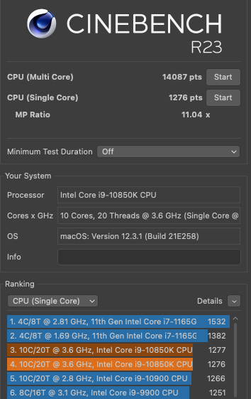

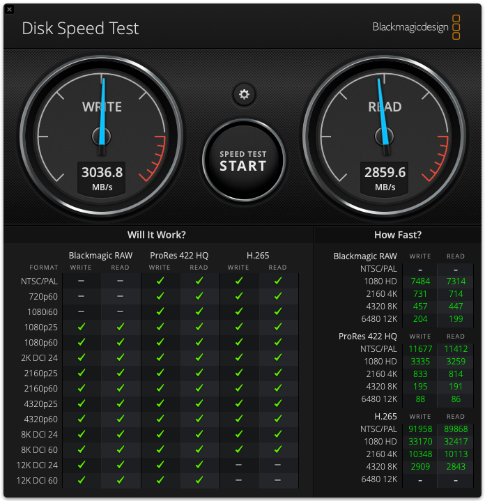

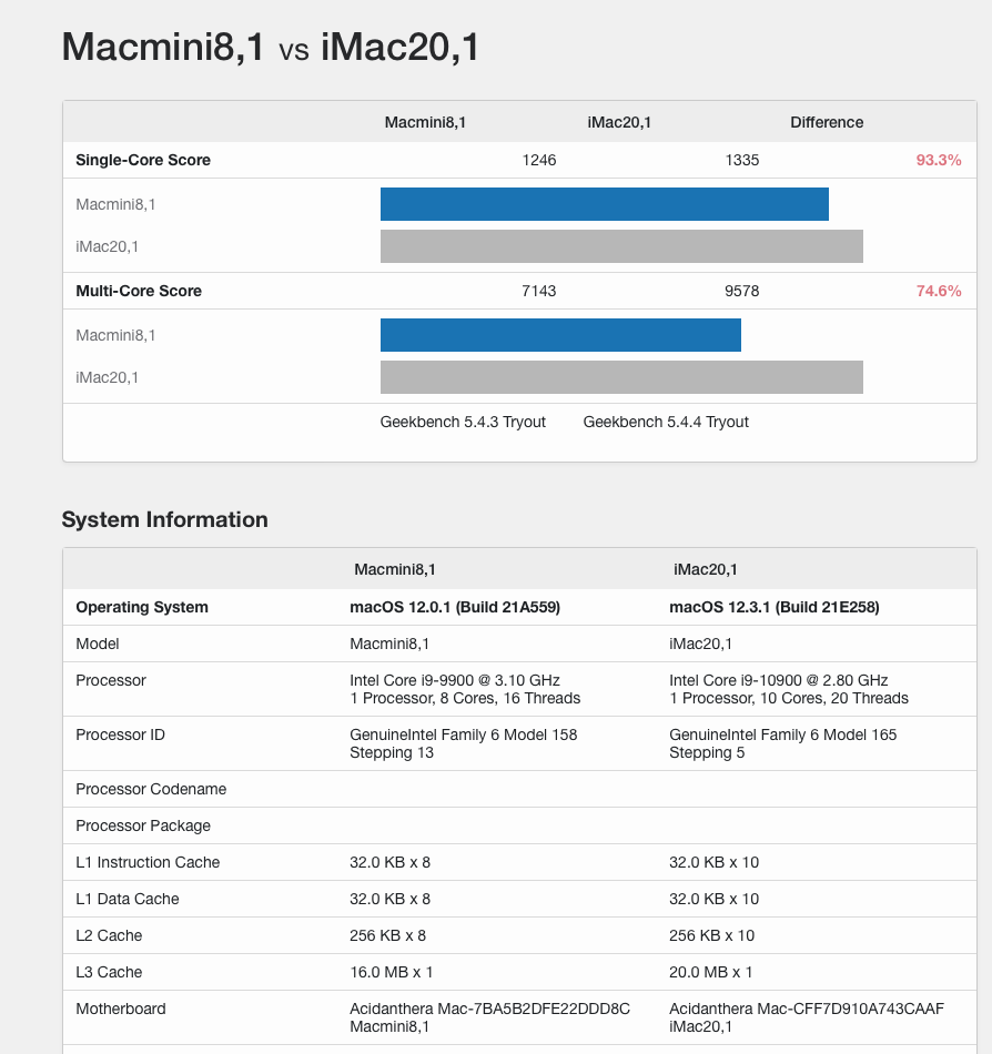

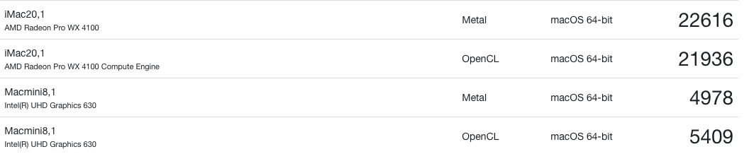

rafale77 Posted April 25, 2022 Author Share Posted April 25, 2022 I was browsing the GB5 scores and this little machine as configured with the iGPU is very competitive with the M1 MacMini: My P340 Vs. MacMini Single-Core: 1,350 Vs 1,700 Multi-Core: 9,600 Vs 7,200 Compute Metal: 22,600 Vs. 21,400 Compute OpenCL: 22,000 Vs 19,800 Going with a P350 or M90Q Gen2 with a cheaper 11700 CPU would beat beat M1 in the Single-Core. 1 Link to comment Share on other sites More sharing options...

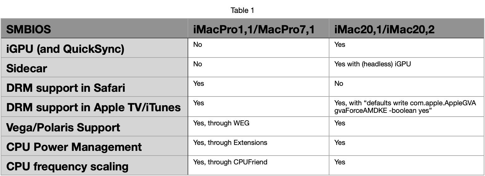

rafale77 Posted April 26, 2022 Author Share Posted April 26, 2022 (edited) DRM is definitely a pain on these machines... I finally ran into a problem with the command: defaults write com.apple.AppleGVA gvaForceAMDKE -boolean yes It forces sidecar to try to decode using the dGPU and makes it very flaky. It works and connects but breaks very easily and flickers occasionally. I initially thought I had an RF antenna issue but disabling the command above fixes the problem... I guess I will be using it only when I need itunes/AppleTV then... I am practically done tinkering with OC so I disabled the picker and all debug/logging. The machine now almost boots like a Mac: Apple Logo(from BIOS)-Boot Chine-Apple Logo with Progress bar. Boot time is 5s longer than with the HP 800 G5 Mini. 26s Vs 21s from chime to login screen. It appears to be due to loading of the AMD drivers... Edited April 26, 2022 by rafale77 1 Link to comment Share on other sites More sharing options...

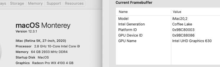

rafale77 Posted April 26, 2022 Author Share Posted April 26, 2022 (edited) Posted 0.8.0 Rev3 which likely will be the final one until 0.8.1. Made some progress on making it behave like a real mac at boot and getting Apple DRM to work on the GPU while maintaining the iGPU for Sidecar. I discovered that on a real my MBp that both also cannot run simultaneously so I was on a goose chase. I think I am now as close as I can be from being fully functional with the exception of the notorious Amazon/Netflix DRM on Safari which can be overcome through using SW decode on a different browser. Edited April 27, 2022 by rafale77 1 Link to comment Share on other sites More sharing options...

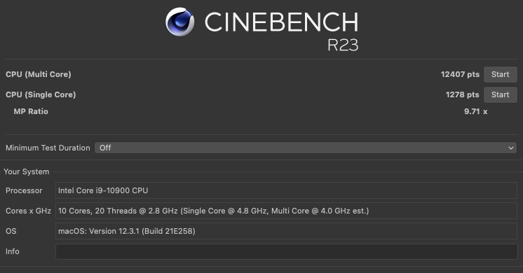

rafale77 Posted May 16, 2022 Author Share Posted May 16, 2022 (edited) Upgrade: Uneventful Upgrade to Monterey 12.4 Note: For universal control to work, the iOS device also needs to be updated to 15.5. I ran into the problem. Performance: Most of my current activities on the hack since I have come back have been around trying to "overclock" it by undervolting it and then seeking to increase the Power Limits in the BIOS. These findings and discussions are in this other thread. The gist of it is that this lenovo machine has hidden BIOS options which can be uncovered using the ControlMsrE2 tool. This tool oddly cannot write these bits, on this Lenovo machine even the CFGLock bit can't be changed by ControlMsrE2 but CFGLock.efi works. I had to use the RU.efi tool to edit the addresses I found from ControlMsrE2. The process is as follows: Launch ControlMsrE2.efi from the opencore openshell tool with the interactive argument. Change the search string. Write down the found offset ControlMsrE2 outputs. Launch RU.efi and follow the process in the link to find the CPUSetup section Go to the address offset previously written down and edit Save the change by inputing CTRL-W. I have disabled the OC Lock that way and enabled the Overclocking Features flag (which so far doesn't appear to do anything) Then using VoltageShift, I have been able to find out that by default, with the 230W power brick, both PL1 and PL2 appear to be already set at 150W and I was able to undervolt the CPU. These PL values reported do not match with my observations of the CPU volt under load or the performance of the machine which appear to be PL1=65W and PL2=120W One oddity I discovered is that the i9 10900 performance actually degrades due to lower power limits once the OCLock flag is disabled. I switched to an i9 10850K which does not exhibit this behavior and was able to improve the performance of this tiny... The 10850K however is powered with the same power limits as the 10900 running it essentially at 65W TDP CPU. The performance is on par with a real iMac20,2 but with 65W actual TDP instead of 125W. It is interesting that the scores seem to have less variability with undervolting than before as I am seeing 3-8% improvement in benchmarks. Comparing 10900 to 10850K undervolted (left) and 10850K before and after undervolting (right). Edited May 17, 2022 by rafale77 Link to comment Share on other sites More sharing options...

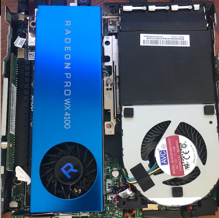

rafale77 Posted May 20, 2022 Author Share Posted May 20, 2022 Just wanted to show how the Radeon Pro fits in such a tiny chassis. Note that the fan position for this GPU is ideally located under the case vent opening. Upon further optimizations of both the GPU which I will share in the next EFI and further undervolting to -130mV on Vcore, -30mV on iGPU and -120mV on VCache, temperatures dropped lower. CPU Package Volt/CPU Min Temp/CPU Max Temp/CPU ave. Freq/VCore/dGPU Freq/dGPU Temp/dGPU Freq/dGPU fan speed/CPU fan speed/SSD1 Temp/SSD2 Temp Ambient is 20C 2 Link to comment Share on other sites More sharing options...

rafale77 Posted June 4, 2022 Author Share Posted June 4, 2022 Uploaded rev5. Still not perfect on the Sidecar/DRM side but this setup allows for a much smoother Sidecar experience when run on AMD (eliminated the freeze and drop issues) When AppleGVA runs on intel iGPU: Sidecar is perfect No DRM When AppleGVA runs on the AMD dGPU: Sidecar runs with very few graphical artifacts Apple TV DRM works. I have attached below a little script I wrote to switch gva between dGPU and iGPU so that one doesn't need to go into terminal and submit a command. gvaswitch Link to comment Share on other sites More sharing options...

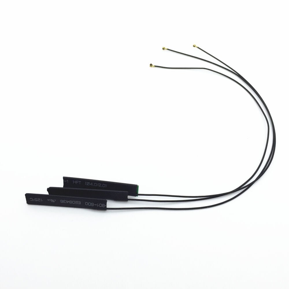

rafale77 Posted June 25, 2022 Author Share Posted June 25, 2022 So after much experimenting, I have finally found a working setup for my three antenna to get my bcm94602CS working: connector J1 is connected to the external antenna in the back of the unit with a cheap 3dBi standard antenna. connector J2 is connected to a Dell 0DJ3VC antenna from an XPS 7760 AIO desktop. I lodged it in the front top left of the unit, taped to the front bezel. connector J3 is connected to one of the tiny antenna which as I found it is good for 5GHz but not so great for 2.4GHz based on the RSSI of my 2.4GHz network. Using two of these antenna, made SideCar unreliable. This antenna is also lodged in the bezel, in the front top right where it fits perfectly between clipping tabs of the bezel. Very happy with the final result as I have now SideCar has become rock solid. Link to comment Share on other sites More sharing options...

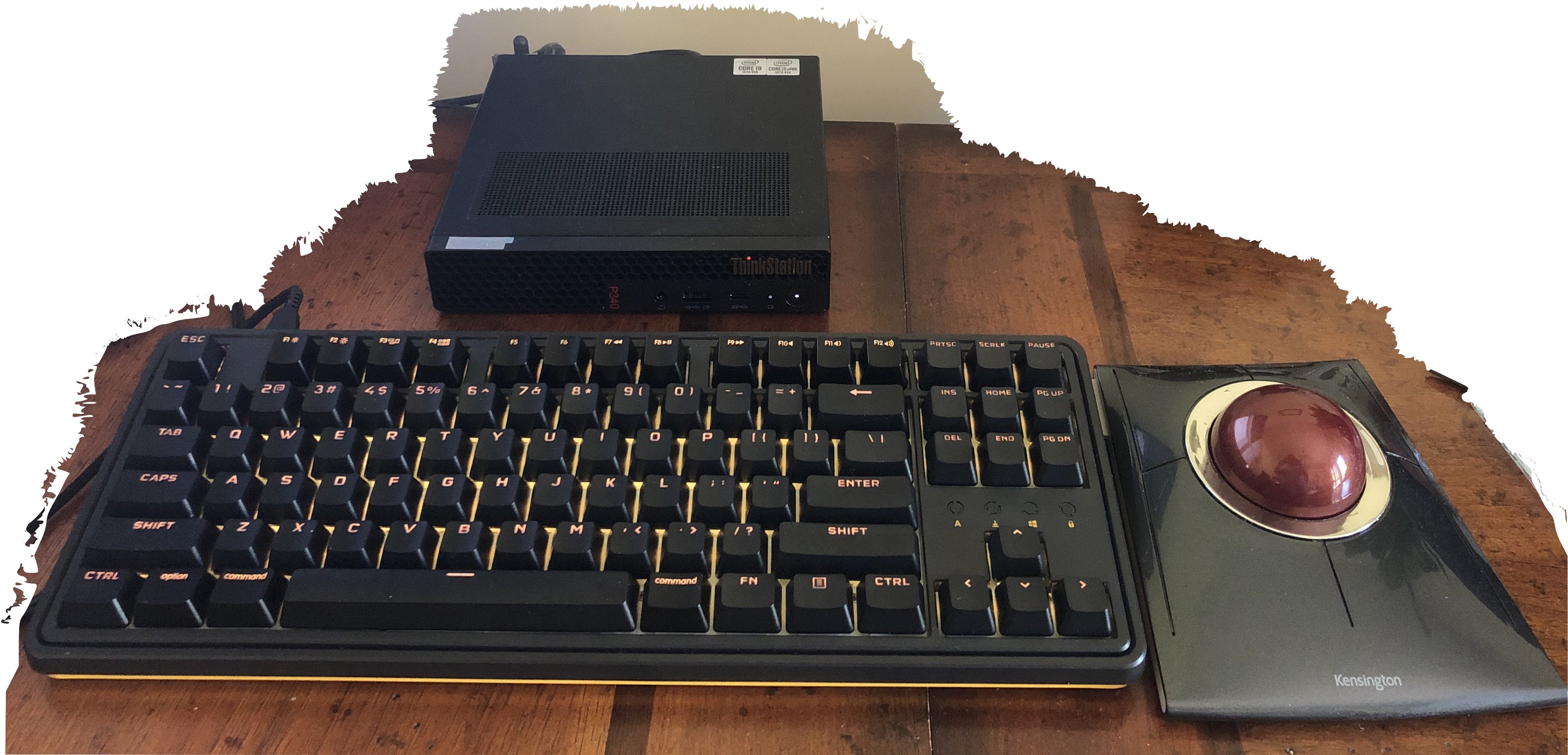

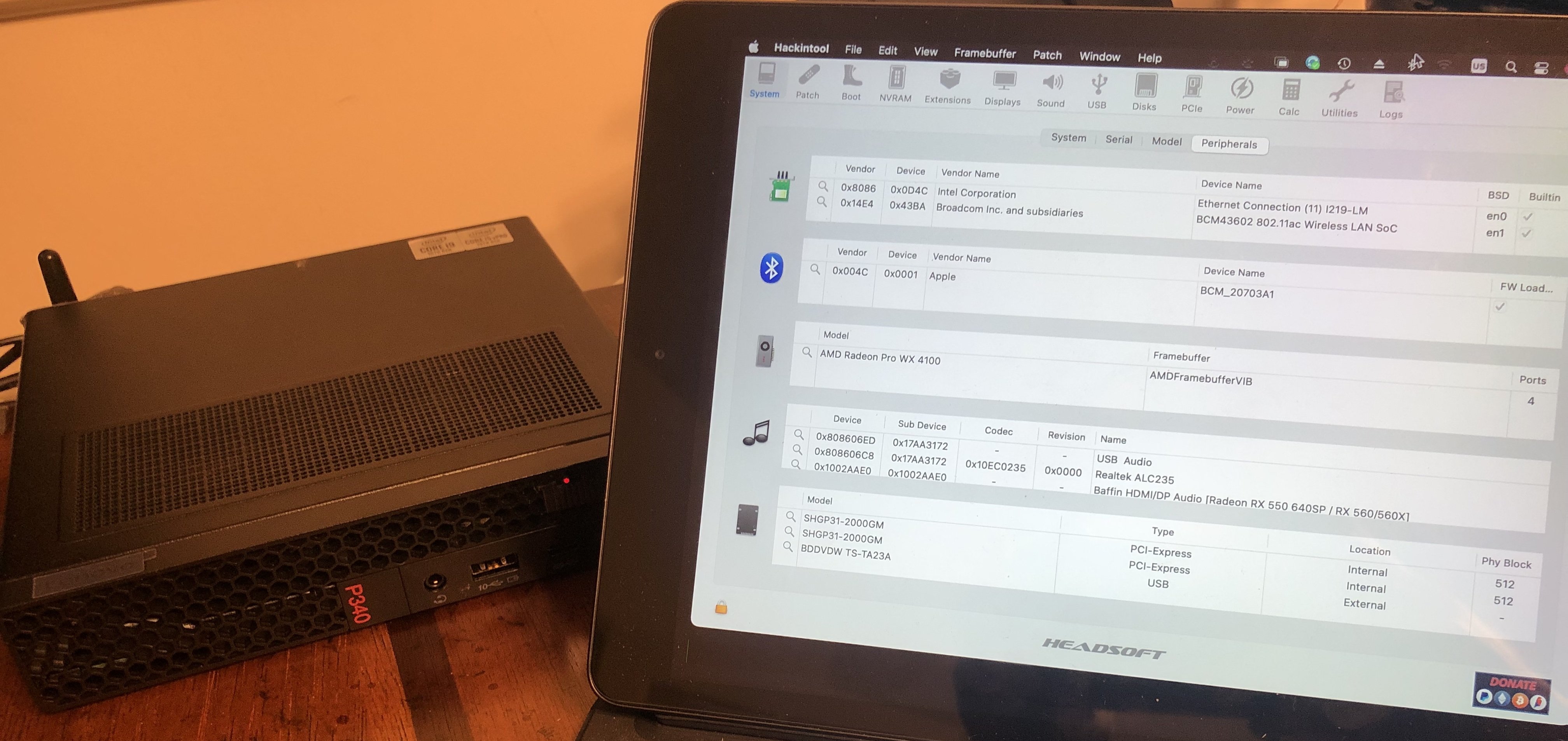

rafale77 Posted July 9, 2022 Author Share Posted July 9, 2022 To give a look at what my hack setup look like on my desk... the tiny's footprint is barely larger than my trackball and about half of my mechanical keyboard... I am also now using a tiny rear antenna. 1 Link to comment Share on other sites More sharing options...
