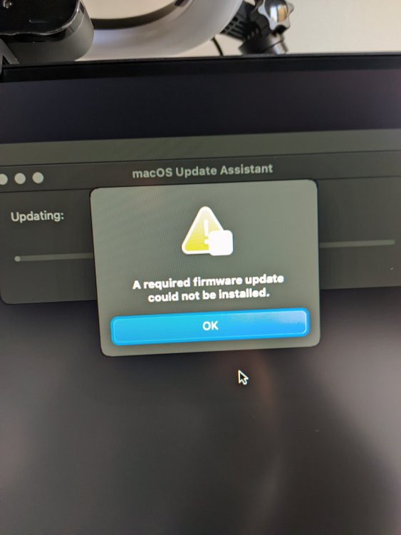

ciggar Posted April 15, 2022 Share Posted April 15, 2022 y get this eror before y instal an the first restart show apple logo with 29 minute remain and instant show this mesage a required firmware update could not be installed y change smbios but nothing Link to comment https://www.insanelymac.com/forum/topic/351461-a-required-firmware-update-could-not-be-installed-oc-079/ Share on other sites More sharing options...
ciggar Posted April 15, 2022 Author Share Posted April 15, 2022 MOTHERBOARD:Asus WS C621E SAGE 2XCPU XEON 4210 Silver GPU-MSI Radeon 6800XT 96 GB RAM SAMSUNG 1 Link to comment https://www.insanelymac.com/forum/topic/351461-a-required-firmware-update-could-not-be-installed-oc-079/#findComment-2780282 Share on other sites More sharing options...

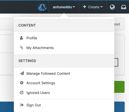

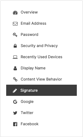

ciggar Posted April 15, 2022 Author Share Posted April 15, 2022 (edited) but how to put??? Edited April 15, 2022 by ciggar Link to comment https://www.insanelymac.com/forum/topic/351461-a-required-firmware-update-could-not-be-installed-oc-079/#findComment-2780290 Share on other sites More sharing options...
Anto65 Posted April 15, 2022 Share Posted April 15, 2022 Account Settings > Signature 3 Link to comment https://www.insanelymac.com/forum/topic/351461-a-required-firmware-update-could-not-be-installed-oc-079/#findComment-2780291 Share on other sites More sharing options...
Bmju Posted April 15, 2022 Share Posted April 15, 2022 Should be AdviseFeatures=true/ON in config. Link to comment https://www.insanelymac.com/forum/topic/351461-a-required-firmware-update-could-not-be-installed-oc-079/#findComment-2780293 Share on other sites More sharing options...
ciggar Posted April 15, 2022 Author Share Posted April 15, 2022 y have AdviseFeatures=true on my plist but the same required firmware update could not be installed Link to comment https://www.insanelymac.com/forum/topic/351461-a-required-firmware-update-could-not-be-installed-oc-079/#findComment-2780304 Share on other sites More sharing options...

ciggar Posted April 15, 2022 Author Share Posted April 15, 2022 na the problem is Apple because y googleit and the original mac have the same isue monterey need a original apple ssd to instal because they have a firmware update for ssd damn y go try to instal big sur!!!!! Link to comment https://www.insanelymac.com/forum/topic/351461-a-required-firmware-update-could-not-be-installed-oc-079/#findComment-2780320 Share on other sites More sharing options...

etorix Posted April 18, 2022 Share Posted April 18, 2022 (edited) 3 hours ago, ciggar said: any know how to downgrade OPENCORE 0.7.9 to 0.7.8???? Same as for upgrading: Replace BOOT/BOOTx86.efi, OC/Drivers/OpenRuntime.efi (+OpenCanopy.efi) and OC/OpenCore.efi by the new (or, here, old) versions. Then, adapt the config.plist to the appropriate syntax or copy and paste settings from config.plist to the appropriate Sample.plist. The question is: Why would you want to downgrade? At which point are you now, and which which settings? @metacollin, who gave the first explanation on CPU wrapping, had a X11DAi working with two Xeon Scalable, so dual processor is possible. But we have to find out how… Edited April 18, 2022 by etorix Link to comment https://www.insanelymac.com/forum/topic/351461-a-required-firmware-update-could-not-be-installed-oc-079/#findComment-2780546 Share on other sites More sharing options...
ciggar Posted April 18, 2022 Author Share Posted April 18, 2022 (edited) man with this efi y boot with OPENCORE 0.7.9 on monterey and before 1st restart y get apple logo and y get a required firmware update could not be installed ssd isconected to sata and formated as mac jurnaled if y format on apfs whent go to select the ssd to instal cant select because say the same a firmware update need to instal or change format to mac jurnaled all this on monterey. On bigsur boot all fine but at 12 minute remaining stuck no progres!!!! y try many times the same... EFI.7z Edited April 18, 2022 by ciggar Link to comment https://www.insanelymac.com/forum/topic/351461-a-required-firmware-update-could-not-be-installed-oc-079/#findComment-2780565 Share on other sites More sharing options...
etorix Posted April 18, 2022 Share Posted April 18, 2022 Good work! Have you tried PlatformInfo>UpdateSmbios:True to solve the firmware update issue? The issue with earlier OSes is more puzzling… We may not have found the right combination of quirks. Or some device could be unsupported—the i210 NICs being prime suspects. Link to comment https://www.insanelymac.com/forum/topic/351461-a-required-firmware-update-could-not-be-installed-oc-079/#findComment-2780575 Share on other sites More sharing options...
ciggar Posted April 22, 2022 Author Share Posted April 22, 2022 @etorix the same error required firmware update could not be installed with PlatformInfo>UpdateSmbios:True !!!!! what is the next step????? Link to comment https://www.insanelymac.com/forum/topic/351461-a-required-firmware-update-could-not-be-installed-oc-079/#findComment-2780853 Share on other sites More sharing options...
etorix Posted April 23, 2022 Share Posted April 23, 2022 12 hours ago, ciggar said: what is the next step????? I wish I knew… It seems you'll need a lot of patience, perseverance, and possibly some luck. As next step, you may try to disable non-essential devices in BIOS (NIC, CPU 2) and see if it helps. Try different OS, with the most verbose settings to find out where the issue is. A seller on eBay US offers this motherboard "for Hackintosh" with an EFI of his making. So it must be possible. Link to comment https://www.insanelymac.com/forum/topic/351461-a-required-firmware-update-could-not-be-installed-oc-079/#findComment-2780875 Share on other sites More sharing options...

Guest 5T33Z0 Posted April 29, 2022 Share Posted April 29, 2022 @ciggarMove VIrtualSMC up to the 2nd position right after lilu since other kexts rely on it and try again Link to comment https://www.insanelymac.com/forum/topic/351461-a-required-firmware-update-could-not-be-installed-oc-079/#findComment-2781322 Share on other sites More sharing options...
