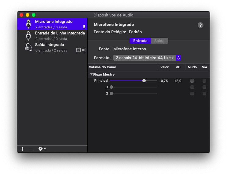

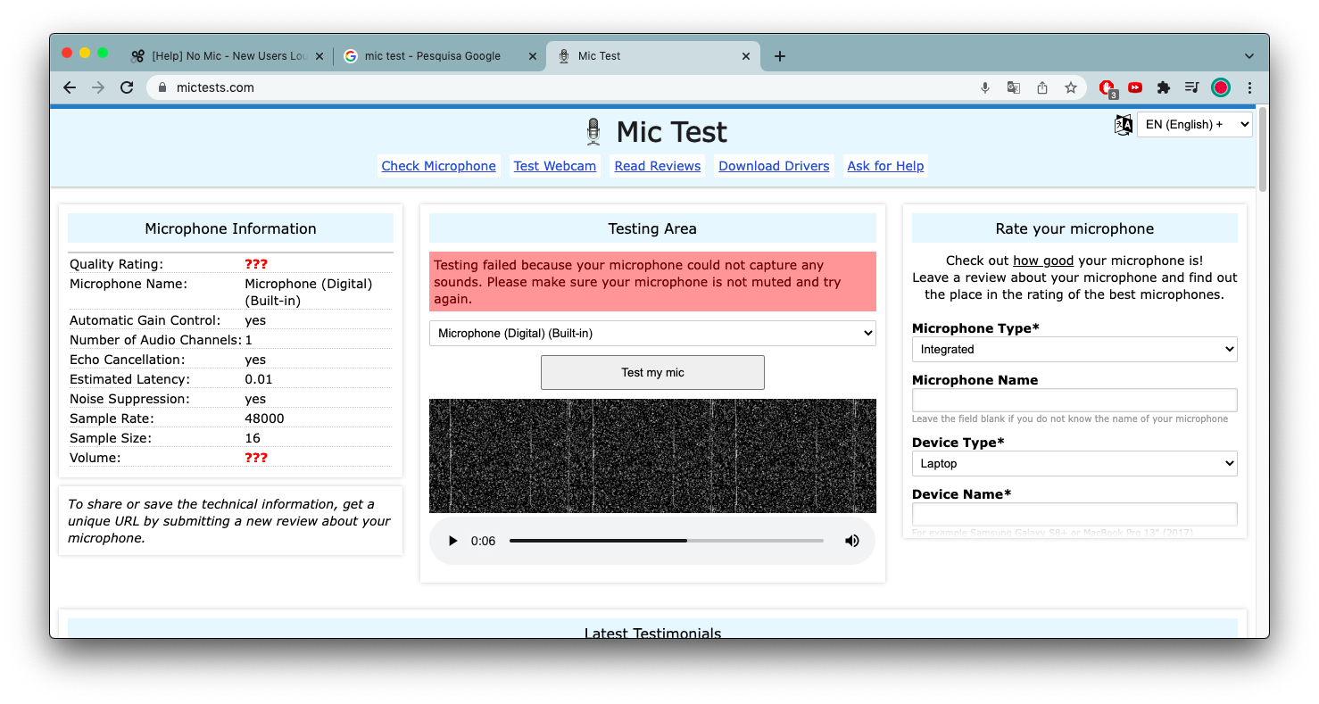

MaffSi Posted March 7, 2022 Share Posted March 7, 2022 Hi, My Hackintosh is almost fully functional.Except the mic doesn't work properly. When i call siri, she can hear and understand me, same with audio recorder. But when i try to use any apps like: Chrome, Firefox ... i just get this white noise. Like the old TVs. I were workaround this disabling one channel in MIDI but now i don't have this option anymore (is grayed). I want to know if anyone can help me to disable this ghost channel, from the mono mic, or anything that could help. I think because my mic is mono, an additional "ghost" channel is being created with static and messing up the audio. Thanks anyway. Here is my EFI And the MIDI grayed option Quote Link to comment https://www.insanelymac.com/forum/topic/351006-help-no-mic/ Share on other sites More sharing options...

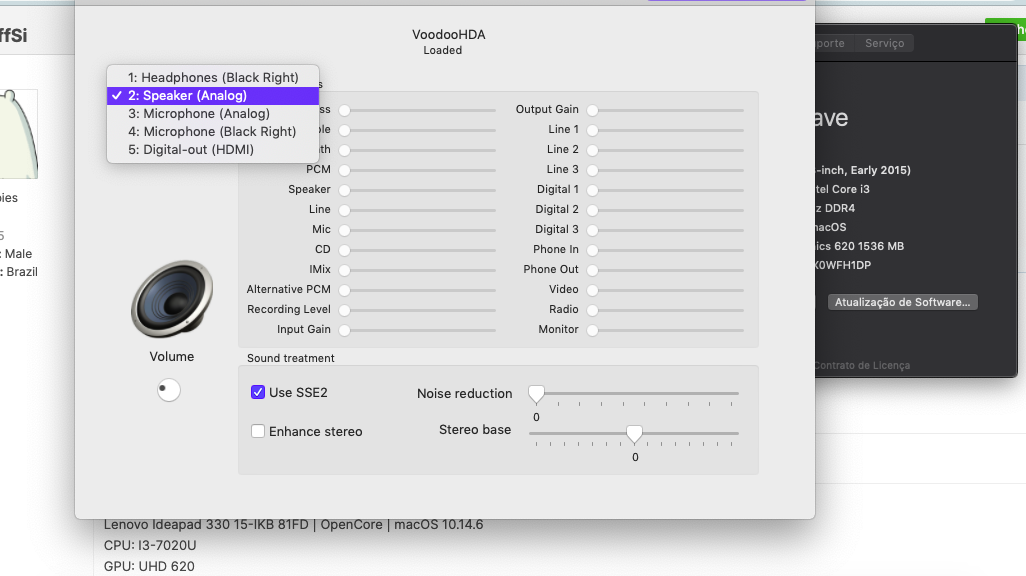

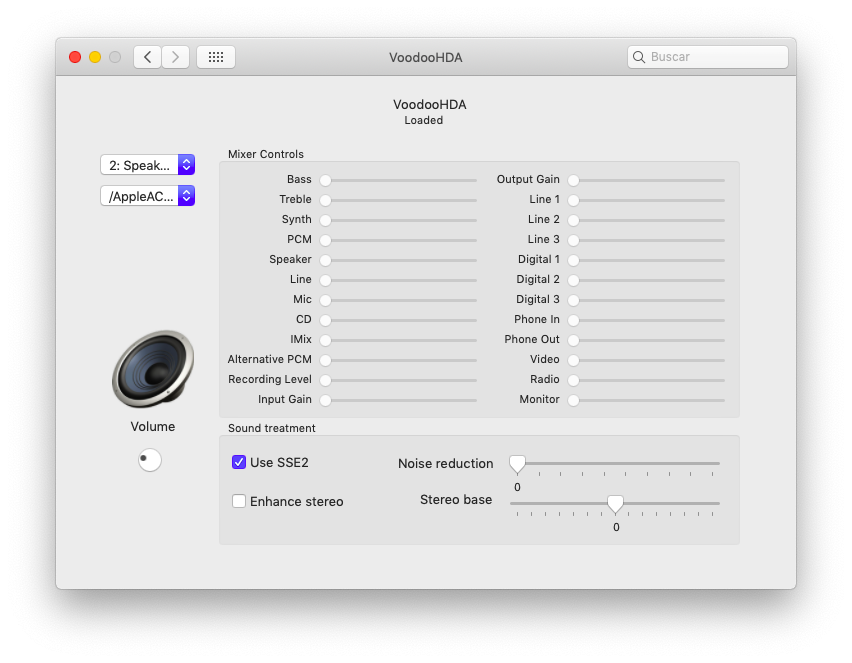

MaffSi Posted March 8, 2022 Author Share Posted March 8, 2022 3 hours ago, Slice said: I can advise you to try VoodooHDA which have some options for this case (SwitchCh). Hi! Thanks for answer. I tried the VoodooHDA but the mic still the same, works on mac apps but not in Chrome or Firefox and the Speaker isn't working anymore. But the Speaker option appear in VoodooHDA panel with all the options grayed. And when i test, with headphones to be able to hear something. Quote Link to comment https://www.insanelymac.com/forum/topic/351006-help-no-mic/#findComment-2777794 Share on other sites More sharing options...

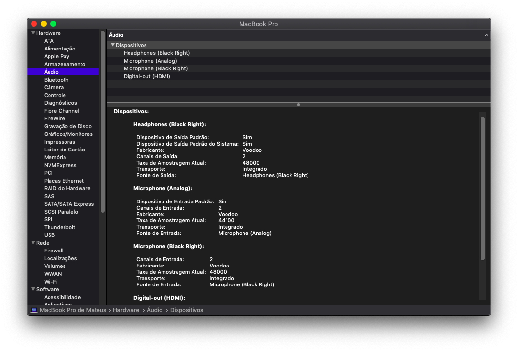

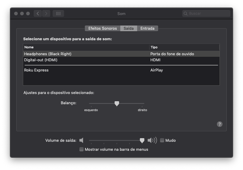

MaffSi Posted March 8, 2022 Author Share Posted March 8, 2022 (edited) 11 hours ago, Slice said: Try to edit VoodooHDA.kext/Contents/Info.plist as follow <key>NodesToPatch</key> <array> <dict> <key>Codec</key> <integer>0</integer> <key>Comment</key> <string>Change type of internal Mic</string> <key>Config</key> <string>0x90a70130</string> <key>Enable</key> <string>1</string> <key>Node</key> <integer>18</integer> <key>SwitchCh</key> <string>0</string> </dict> Look at the key SwitchCh. You have to test as 0 or as 1. It may be a key for your problem. Config 0x90a70130 is also essential thing. Hi! Worked, the mic is working with the chrome, firefox... And what i need to change to make my speaker work again? In the panel, the speakers appear with everything grayed. But in the system preferences -> Audio and in the system info, the speakers aren't recognized. I'm only being able to hear audio through headphones. Thanks, you already helped a lot, i was not able to have the mic working before. Sorry to bother you so much Edited March 9, 2022 by MaffSi Incomplete info, adding more information about the issue. Quote Link to comment https://www.insanelymac.com/forum/topic/351006-help-no-mic/#findComment-2777826 Share on other sites More sharing options...

Slice Posted March 9, 2022 Share Posted March 9, 2022 OK, Speakers disabled because they shared same DAC with Headphones being in different group. Let join them <dict> <key>Codec</key> <integer>0</integer> <key>Comment</key> <string>Change Speaker to be the first fixed output</string> <key>Config</key> <string>0x90170110</string> <key>Enable</key> <string>1</string> <key>Node</key> <integer>20</integer> </dict> <dict> <key>Codec</key> <integer>0</integer> <key>Comment</key> <string>Change Headphone to be switchable by jack</string> <key>Config</key> <string>0x0421101F</string> <key>Enable</key> <string>1</string> <key>Node</key> <integer>33</integer> </dict> Use this. 1 Quote Link to comment https://www.insanelymac.com/forum/topic/351006-help-no-mic/#findComment-2777886 Share on other sites More sharing options...
MaffSi Posted March 9, 2022 Author Share Posted March 9, 2022 29 minutes ago, Slice said: OK, Speakers disabled because they shared same DAC with Headphones being in different group. Let join them <dict> <key>Codec</key> <integer>0</integer> <key>Comment</key> <string>Change Speaker to be the first fixed output</string> <key>Config</key> <string>0x90170110</string> <key>Enable</key> <string>1</string> <key>Node</key> <integer>20</integer> </dict> <dict> <key>Codec</key> <integer>0</integer> <key>Comment</key> <string>Change Headphone to be switchable by jack</string> <key>Config</key> <string>0x0421101F</string> <key>Enable</key> <string>1</string> <key>Node</key> <integer>33</integer> </dict> Use this. Hi, it's working now. Thank you so much! Quote Link to comment https://www.insanelymac.com/forum/topic/351006-help-no-mic/#findComment-2777888 Share on other sites More sharing options...
