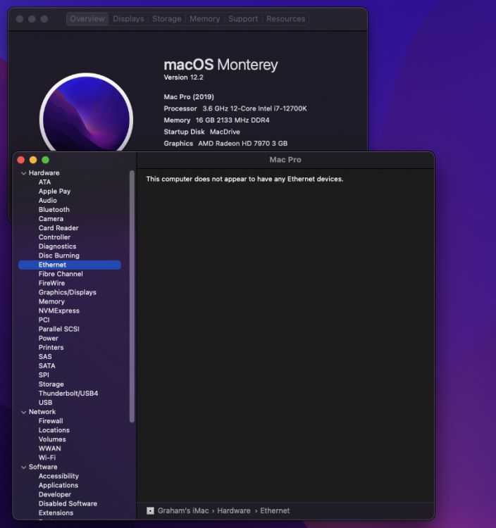

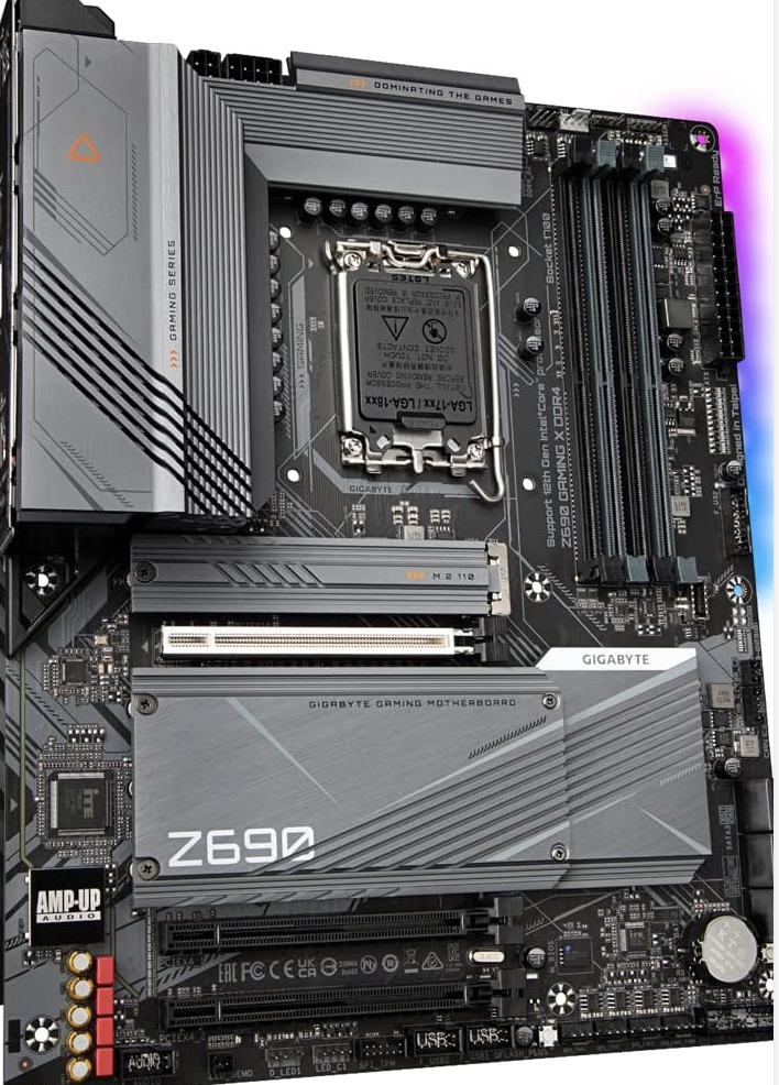

BALDY_MAN Posted February 4, 2022 Share Posted February 4, 2022 (edited) Could someone tell me What The RealTek Lan chip ID is on the Z690 Gigabyte Gaming X and if the is a kext that could be used with a Monterey Install? in the EFI Folder I have tried to find it but I just find RealTek 2.5 gig lan. Edited February 11, 2022 by BALDY_MAN 1 Link to comment https://www.insanelymac.com/forum/topic/350701-z690-gigabyte-gaming-x-motherboard-help-is-now-a-hackintosh/ Share on other sites More sharing options...
Rocky12 Posted February 5, 2022 Share Posted February 5, 2022 "Realtek Gaming 2.5GbE Family Controller" Hardware IDs: PCI\VEN_10EC&DEV_8125&SUBSYS_E0001458&REV_05 PCI\VEN_10EC&DEV_8125&SUBSYS_E0001458 PCI\VEN_10EC&DEV_8125&CC_020000 PCI\VEN_10EC&DEV_8125&CC_0200 Link to comment https://www.insanelymac.com/forum/topic/350701-z690-gigabyte-gaming-x-motherboard-help-is-now-a-hackintosh/#findComment-2776271 Share on other sites More sharing options...
BALDY_MAN Posted February 5, 2022 Author Share Posted February 5, 2022 (edited) I THINK The GIGABYTE Z690 UD Will have a easy lan fIX With Lucy kext. and sound ALC897 @Rocky12 thanks for your help PCI\VEN_10EC&DEV_8125&SUBSYS_E0001458&REV_05 = RTL8125B So I believe I could use the Lucy kext to fix LAN And sound ALC1220-VB on the Gigabyte Z690 Gaming X @eSaFyour comments cool Bro Edited February 5, 2022 by BALDY_MAN UPdated 1 Link to comment https://www.insanelymac.com/forum/topic/350701-z690-gigabyte-gaming-x-motherboard-help-is-now-a-hackintosh/#findComment-2776287 Share on other sites More sharing options...

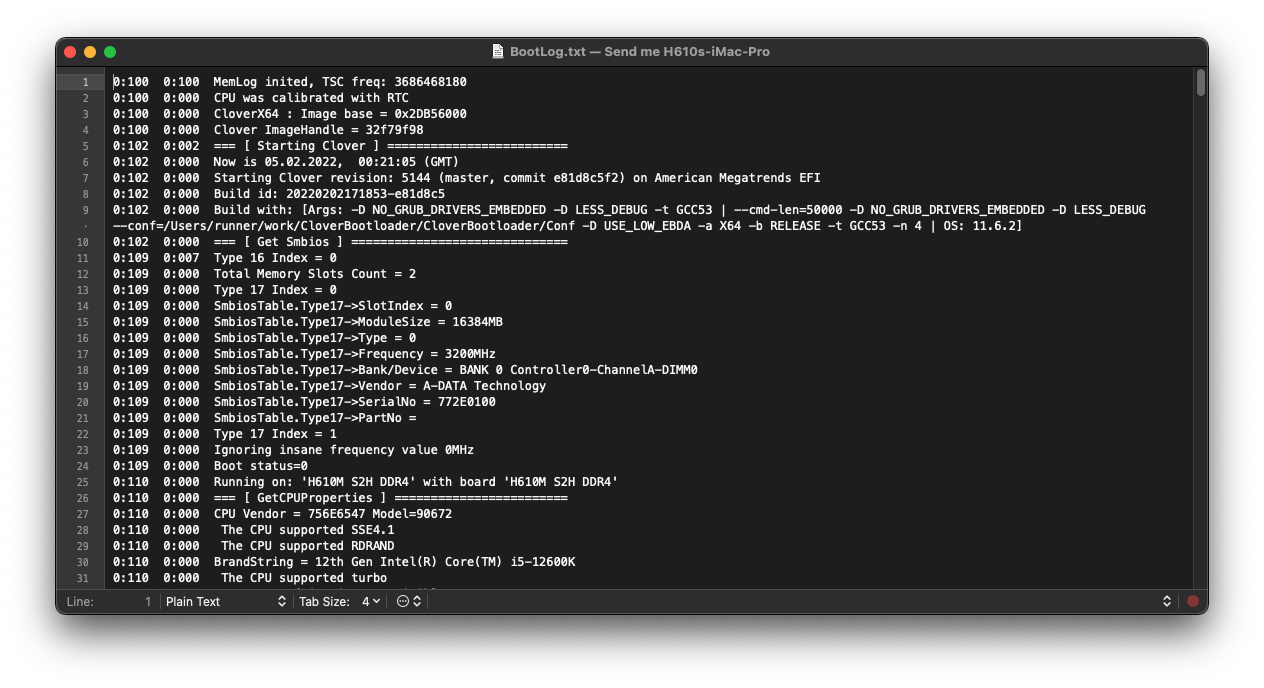

MaLd0n Posted February 5, 2022 Share Posted February 5, 2022 9 minutes ago, etorix said: (still waiting for someone to test and report). Just work very fine. Mobo H610M S2H. All Folders is updated here https://www.olarila.com/topic/5676-hackintosh-efi-folders-for-all-chipsets-clover-and-opencore/ @BALDY_MAN or RealtekRTL8111.kext or LucyRTL8125Ethernet.kext two kexts work for all Realtek lan cards after Skylake family 1 2 Link to comment https://www.insanelymac.com/forum/topic/350701-z690-gigabyte-gaming-x-motherboard-help-is-now-a-hackintosh/#findComment-2776301 Share on other sites More sharing options...
BALDY_MAN Posted February 5, 2022 Author Share Posted February 5, 2022 35 minutes ago, MaLd0n said: Just work very fine. Mobo H610M S2H. All Folders is updated here https://www.olarila.com/topic/5676-hackintosh-efi-folders-for-all-chipsets-clover-and-opencore/ @BALDY_MAN or RealtekRTL8111.kext or LucyRTL8125Ethernet.kext two kexts work for all Realtek lan cards after Skylake family @MaLd0n thank you for sharing your knowledge 2 Link to comment https://www.insanelymac.com/forum/topic/350701-z690-gigabyte-gaming-x-motherboard-help-is-now-a-hackintosh/#findComment-2776302 Share on other sites More sharing options...
BALDY_MAN Posted February 5, 2022 Author Share Posted February 5, 2022 @MaLd0n Thinking about getting the Z690 Gigabyte Gaming X. with a 12700k /12600k. I could use the hardware from my Z490 Hackintosh. I May leave it till next month. thanks again for your input 1 Link to comment https://www.insanelymac.com/forum/topic/350701-z690-gigabyte-gaming-x-motherboard-help-is-now-a-hackintosh/#findComment-2776304 Share on other sites More sharing options...
etorix Posted February 5, 2022 Share Posted February 5, 2022 @MaLd0n Thanks indeed! It is also the first success report I've seen with H610 chipset. 1 Link to comment https://www.insanelymac.com/forum/topic/350701-z690-gigabyte-gaming-x-motherboard-help-is-now-a-hackintosh/#findComment-2776305 Share on other sites More sharing options...

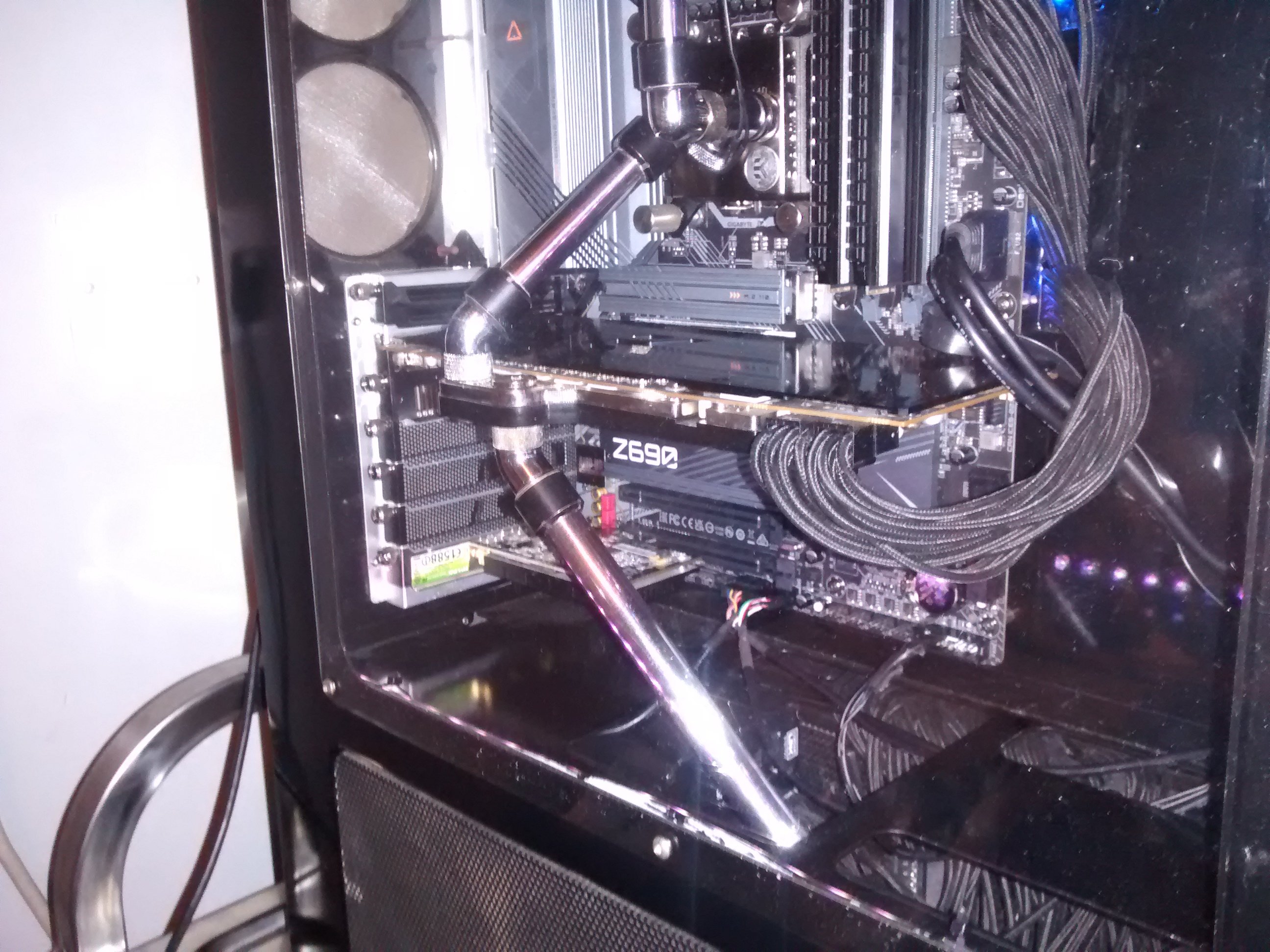

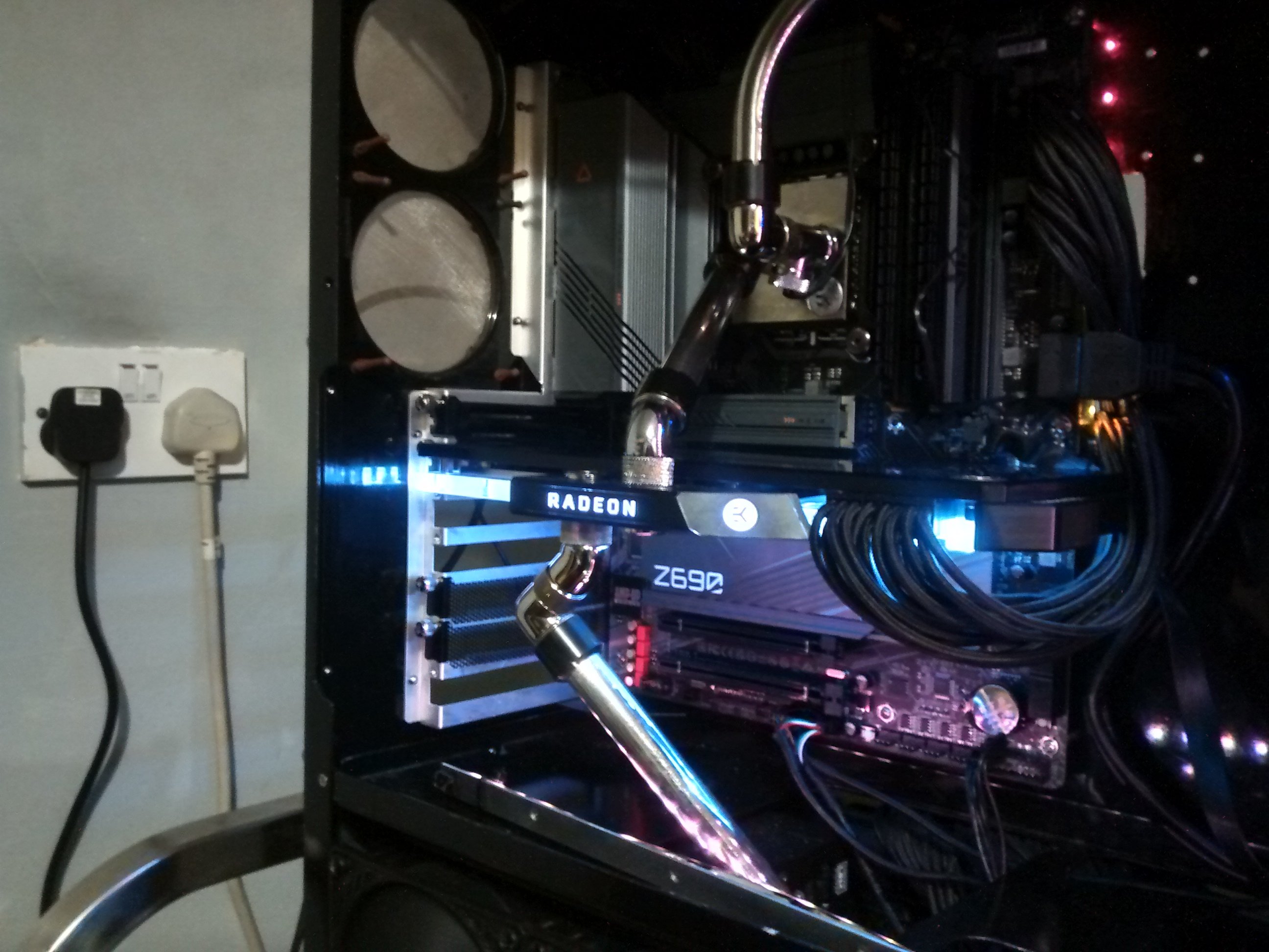

BALDY_MAN Posted February 10, 2022 Author Share Posted February 10, 2022 up date just build the new Gigabyte Z690 gaming X. pc hope to get it hackintosh soon. i had to mess about and Mod a waterblock back plate.so the block fitted the new LGA1700 socket. but when it went well with great Temps. room temps 24C CPU Package 26 C . so a good start 4 Link to comment https://www.insanelymac.com/forum/topic/350701-z690-gigabyte-gaming-x-motherboard-help-is-now-a-hackintosh/#findComment-2776626 Share on other sites More sharing options...

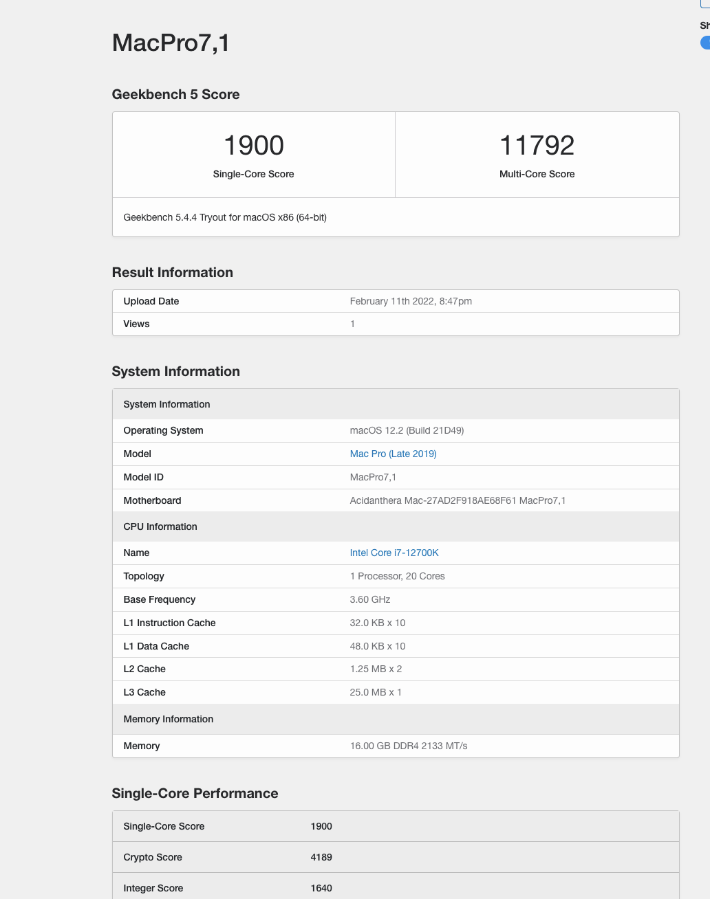

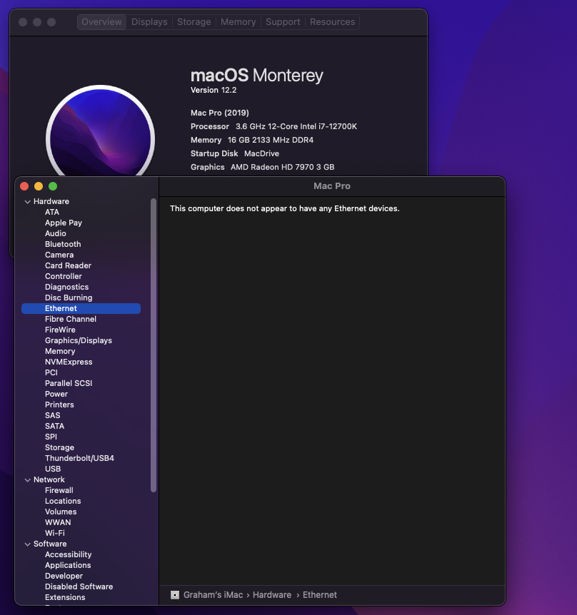

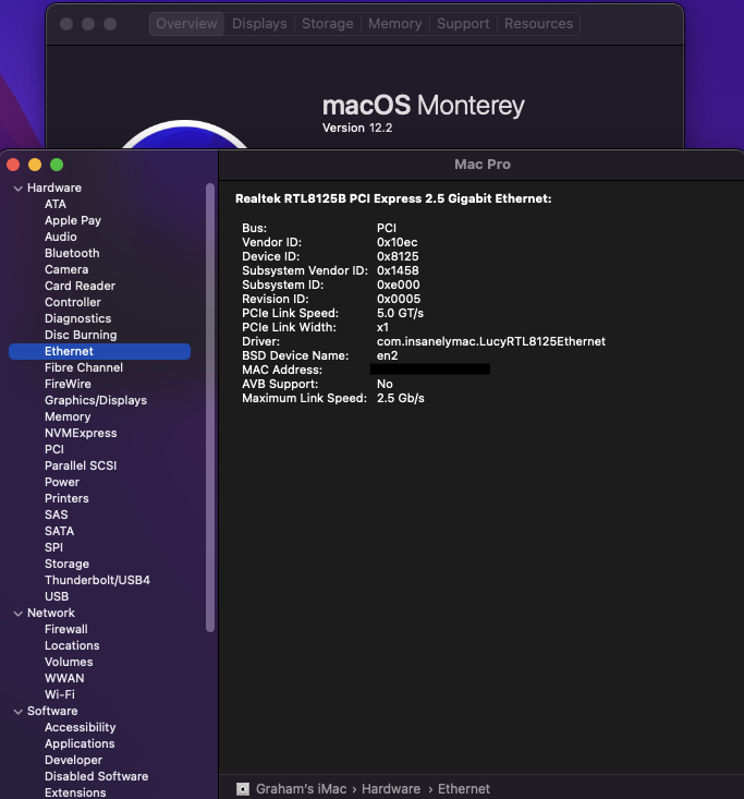

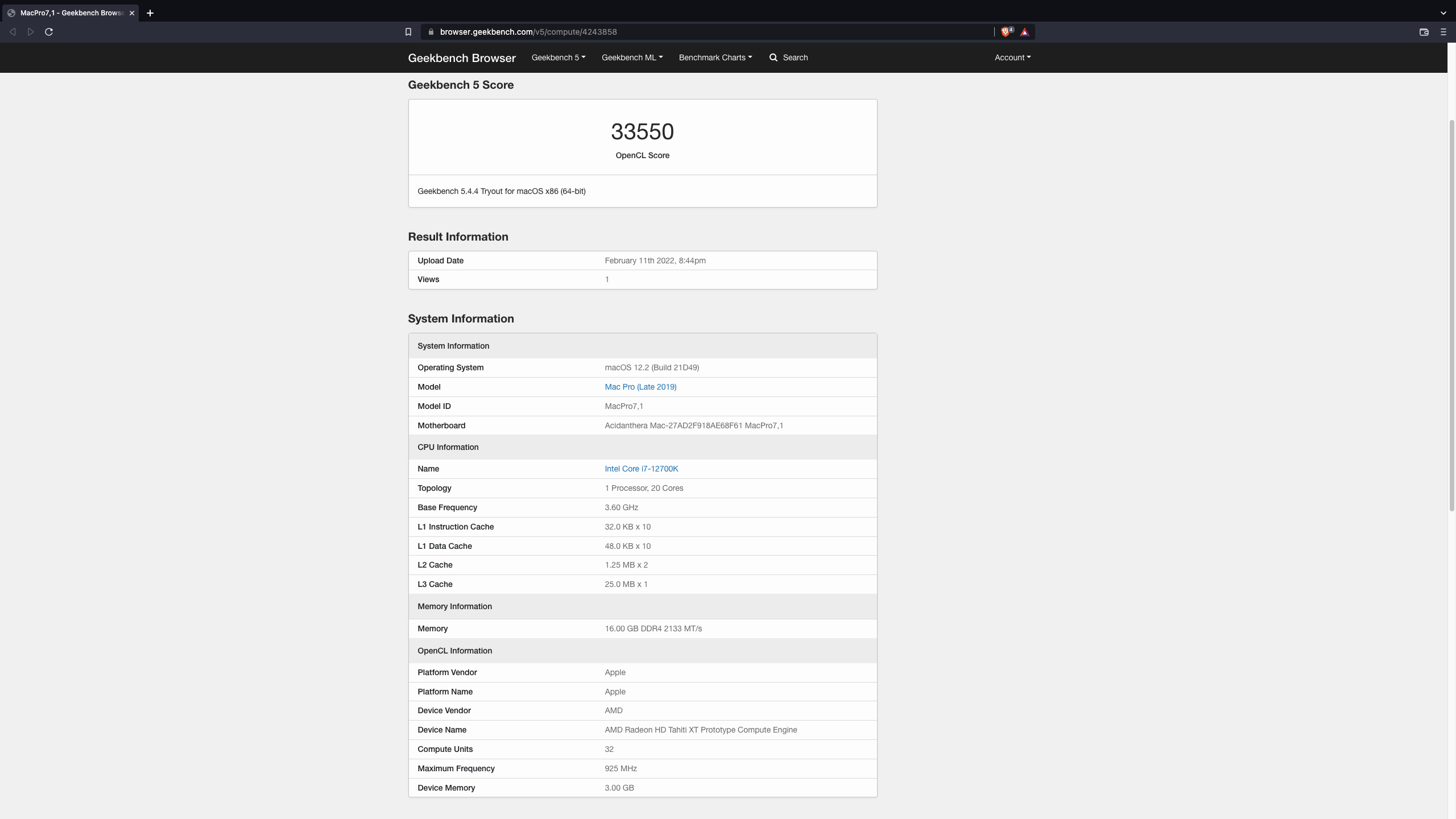

BALDY_MAN Posted February 11, 2022 Author Share Posted February 11, 2022 (edited) it is now up and running I just need help with DSDT and Wired Ethernet (now fixed) Edited February 11, 2022 by BALDY_MAN added screen shots 1 Link to comment https://www.insanelymac.com/forum/topic/350701-z690-gigabyte-gaming-x-motherboard-help-is-now-a-hackintosh/#findComment-2776697 Share on other sites More sharing options...
MaLd0n Posted February 11, 2022 Share Posted February 11, 2022 post one sendme with this efi folder https://tinyurl.com/3n66vypa Link to comment https://www.insanelymac.com/forum/topic/350701-z690-gigabyte-gaming-x-motherboard-help-is-now-a-hackintosh/#findComment-2776702 Share on other sites More sharing options...
BALDY_MAN Posted February 13, 2022 Author Share Posted February 13, 2022 A very big Shout out and thanks to MaLd0n. for making EFI/DSDT File.for my Gigabyte Z690 Gaming X Hackintosh 1 Link to comment https://www.insanelymac.com/forum/topic/350701-z690-gigabyte-gaming-x-motherboard-help-is-now-a-hackintosh/#findComment-2776795 Share on other sites More sharing options...
BALDY_MAN Posted March 18, 2022 Author Share Posted March 18, 2022 I Have just updated the Gpu to RX6800XT. EK waterblock 2 Link to comment https://www.insanelymac.com/forum/topic/350701-z690-gigabyte-gaming-x-motherboard-help-is-now-a-hackintosh/#findComment-2778520 Share on other sites More sharing options...
