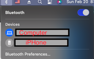

makk Posted February 16, 2022 Share Posted February 16, 2022 Turns out that the culprit on my machine for Monterey 12.2 is AirportIltwm.kext ( Monterey version 2.1.0 and 2.2.0 ) it seems like from the kernel log a authentication issue. As for what type of authentication I am inclined to not knowing which one. Bluetooth is up and running. Link to comment Share on other sites More sharing options...

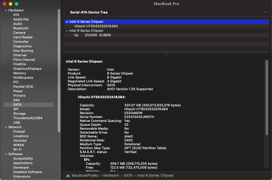

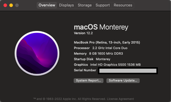

makk Posted February 21, 2022 Share Posted February 21, 2022 (edited) Well didn't last long, after rebooting, the data hash mismatch came back. So reinstalled Big Sur and updated to 11.6.4. ( security patches otherwise I would stick with 11.6.0 due to it being faster ) Monterey runs faster I think than Big Sur at least 12.2 does on my machine. No Monterey on SSD Drive. Causing issues which is being looked into on my end. What I did find interesting is I upgraded my Mojave to Monterey, on an old Hitachi 320gb spin drive a few weeks ago just for kicks and grins. I never had single issue of data hash mismatch. Never even heard of if. So I am running that right now and after overnight still no data hash mismatch. For wifi have running at the moment iltwm.kext instead of AirportIltwm.kext. I initially had an Atheros wifi 9240 that had no bluetooth. I seen Intel W/BT's successes on multiple Hacks. So I swapped out the Atheros and put in the original Intel AC 3160 W/BT in and tested on the Mojave drive. Then I upgraded to Monterey to test out the Wifi. The Monterey on Hitachi: 1 OC 7.7 2 FeatureUnlock.kext 3 itlwm.kext 4. BlueTool.kext 5. IntelBluetoothFirmware.kext 6. USBPorts.kext (hackintool) I'm running that right now with Bluetooth up and running. Just cannot connect to my iPhone which is weird. All devices paired with initial connect. Previously the data hash mismatch appeared right after updating a kext, a configuration. NOTE: So the issue with this data hash mismatch, could be a combination of things. Starting with an SSD drive that is not compatible. It seems the Samsung EVO 750 is not compatible due to the trim approach Samsung takes. turning this feature off might solve the problem. and runs a little bit slower. But faster than a spin drive. NOTE: USB Ports, since Bluetooth uses is allocated USB ports, must have to know which USB ports the bluetooth uses. This can be a rough one. I was using Hackintool to discover the ports. I used USBMap to discover the ports. It can be the fact that I'm on a spin drive and no trim enabled. Will keep testing to find if it is a few things other than a Bluetooth and wifi. These are hypothetical of course until the real problem is found. configuration for this is below in the kexts Edited February 22, 2022 by makk EDITED 1 Link to comment Share on other sites More sharing options...
makk Posted February 22, 2022 Share Posted February 22, 2022 (edited) Lockdown, gujiangjiang #1 New Find as of 2/18 With this find no Data Hash Mismatch. I'm wondering if OC 0.7.7 has anything to do with it? is anyone else running 0.7.7 or below? not 0.7.8 or 0.7.9 Running Monterey 12.2 on Hitachi Spin Drive 5400RPM laptop series. [ transferred this EFI to SSD Drive running Monterey and made some config changes to accommodate ] Below are the specs: Opencore 0.7.7 Kexts: 1 itlwm.kext 2.2.0 <> AirportItlwm.kext on SSD Drive 2 BlueTool.kext 2.6.1 3 IntelBluetoothFirmware.kext 2.1.0 4 FeatureUnlock.kext <> works AirPlay Receiver in Share, Screen Mirroring shows the Roku Express. 5 CPUFriend with CPUFriendDataProvider.kext with ssd_data.aml in place of SSDT-PLUG.aml. SSDT's: 1 USB-reset.aml 2 ssd_data.aml 3 SSDT-EC-LAPTOP.aml 4 SSDT-HPET.aml and local ones Config.plist: 1 Advise Features enabled in NVRAM Generic 2 took out the Extended Features and Features in Platform NVRAM did not help one bit in OC on 0.7.8. 3 ActivateHPETsupport enabled in Quirks UEFI. Installed are all the necessary Lilu.kext and plugins. USBPorts.kext from Hackintool <> although not sure if taken enough steps. USBMap.kext on SSD Drive NOTE: On SSD Drive have trim enabled. Debugging off in config.plist and debugging off for Lilu and plugins. With Monterey this is a new animal and Apple has made significant changes internally. From reading up on the Net it seems Apple is geared to Apple approved Wifi Bluetooth, and other significant Internet accessing devices. Thus said, probably until OC crew and kext patch makers get up to this new standard, may have to turn off some features as well as use less devices. So, what I suggest is using older version of OC and possibly that may have a temporary bandage. Try older versions of Opencore if you are using Opencore. If Clover, possibly older versions that ran Big Sur and Catalina that do not have the new additions in the manicure of the app. To be precise, have to block and mute certain aspects but allow what is necessary to run your devices. #2 With the Bluetooth enabled, the log messages on boot up flash tons of 1442000 IOUSB port which is Bluetooth on this machine. With the Bluetooth disabled, no log messages flash and grace the screen with millions of messages. Alerts of it timing out from waking or attaching? So the remedy is to have this sleep and not try to attach while booting up. Keep it's wheels in check so it can go out the gate. Says gated timeout 500 ms, then 1000ms, then back to 500ms. --logging and debugging are turned off or disabled. Not running Debug versions of kexts or Opencore-- What variable in config.plist would turn off these messages that are annoying? it fills the kernel log. Edited February 22, 2022 by makk 1 Link to comment Share on other sites More sharing options...
