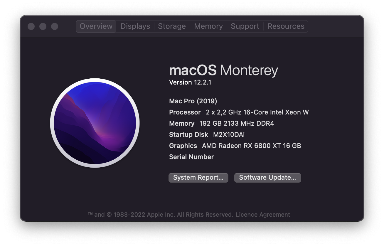

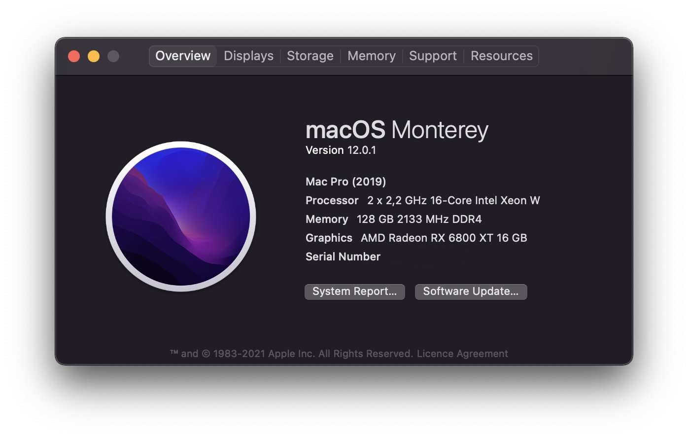

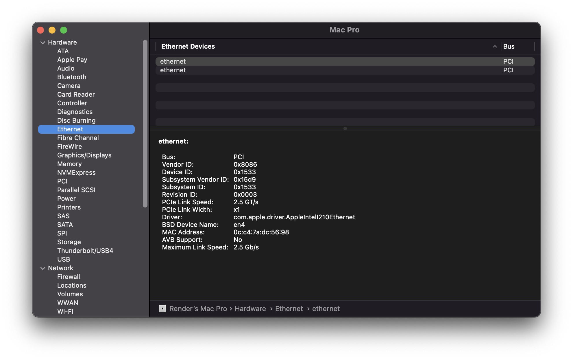

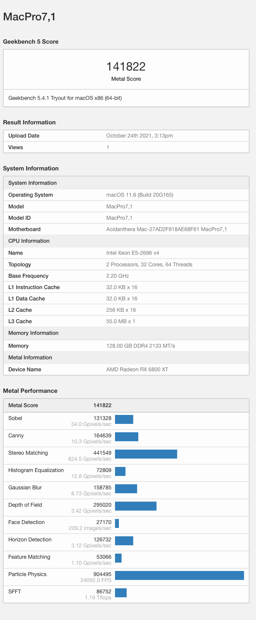

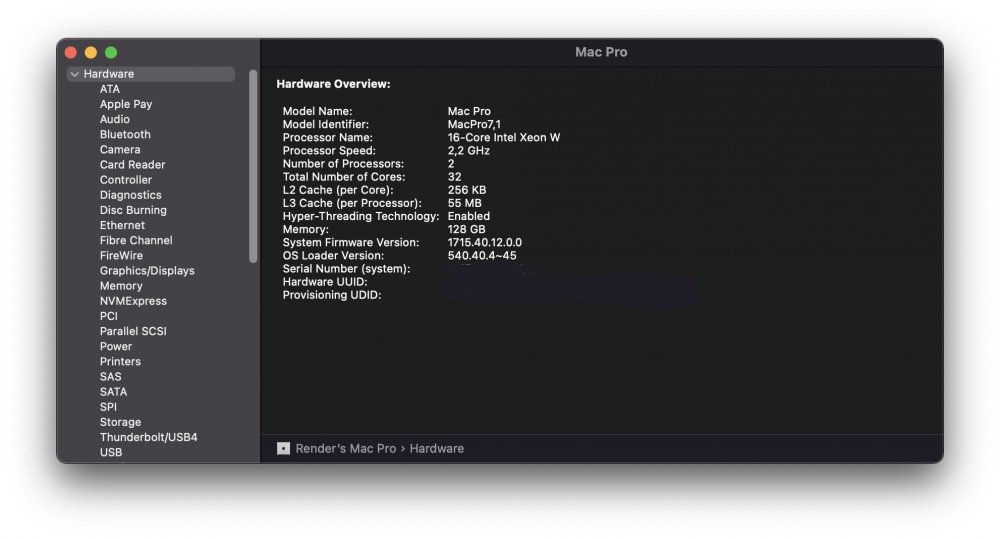

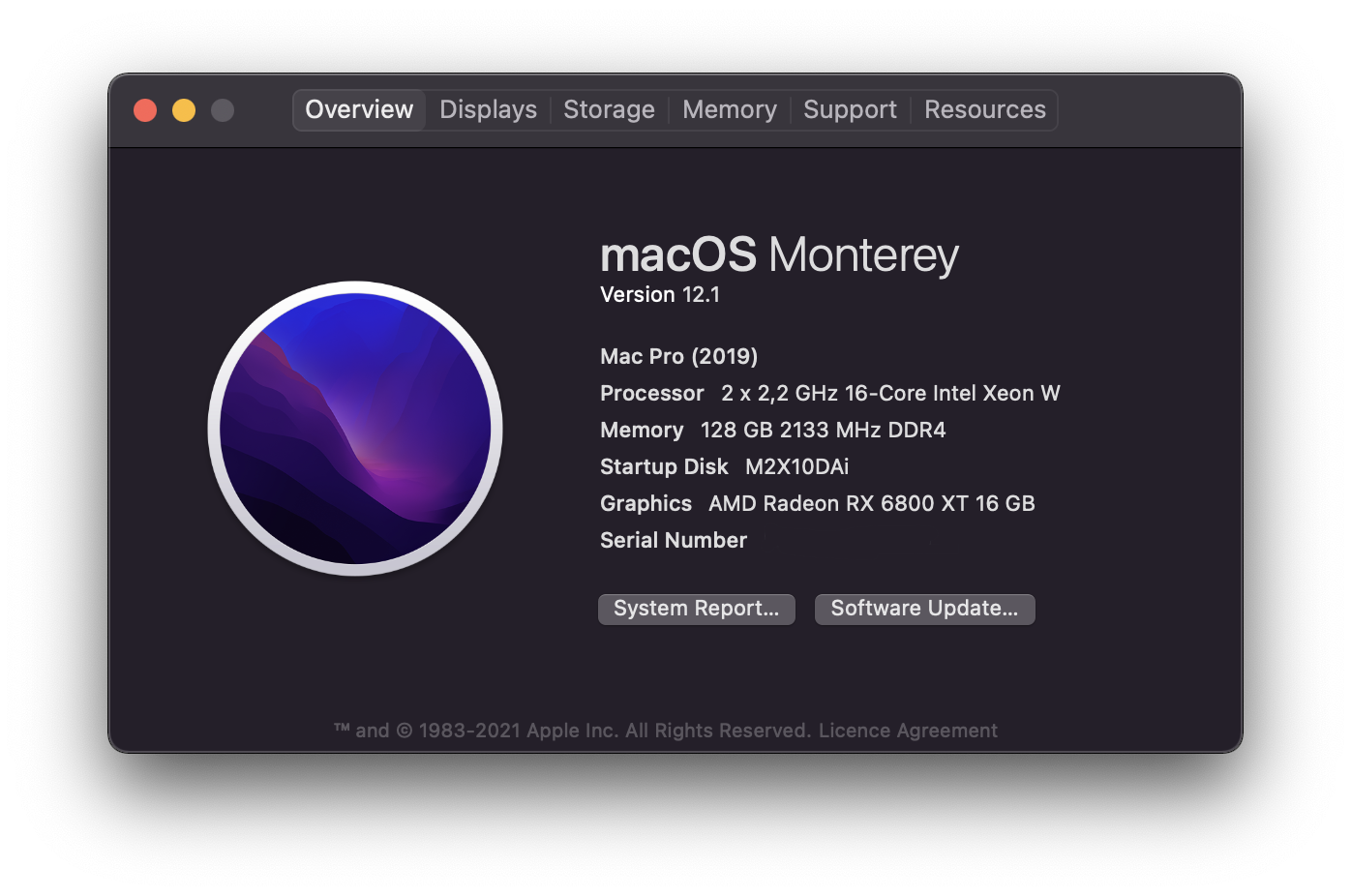

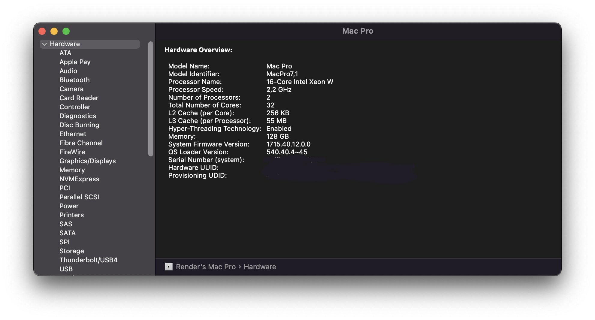

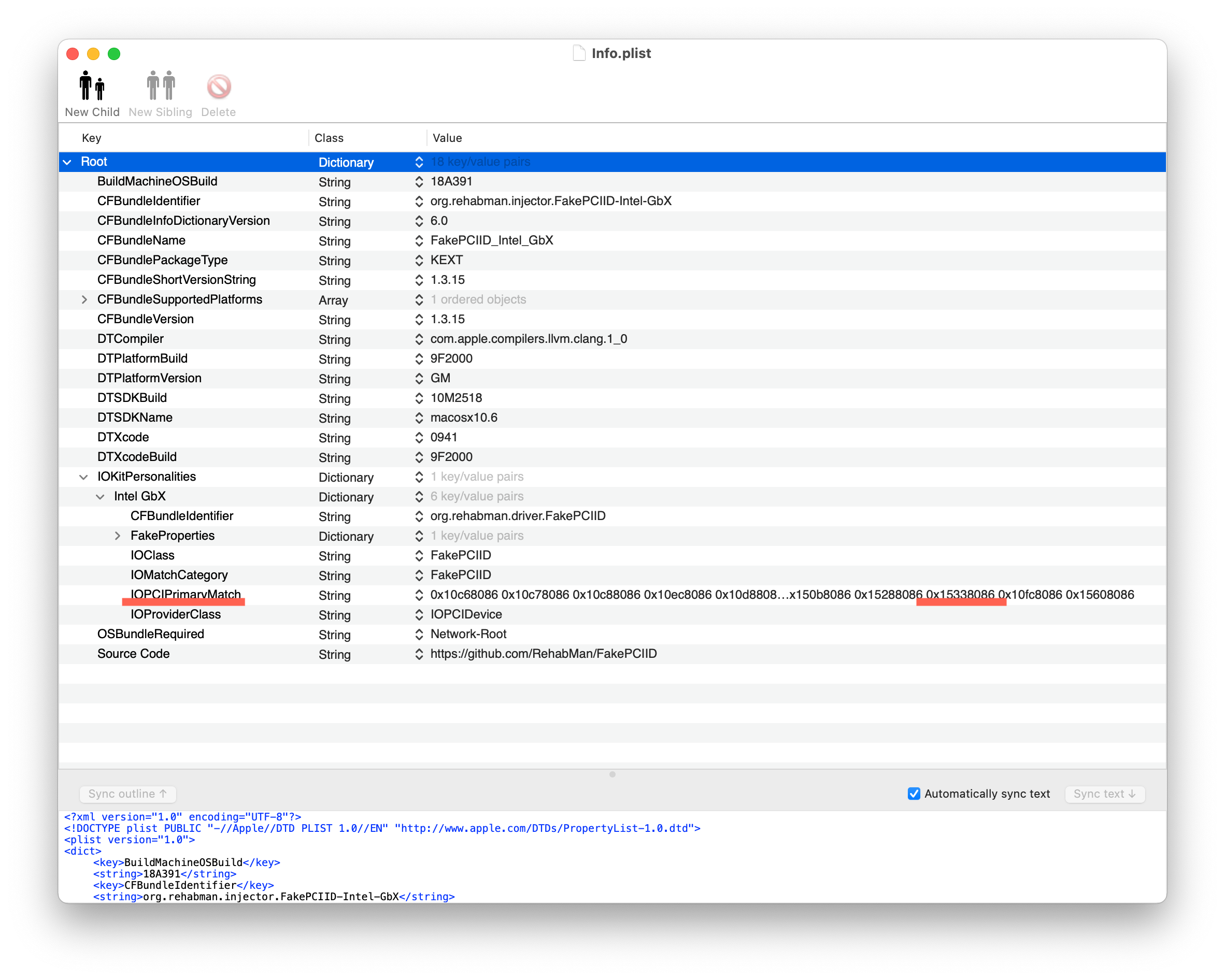

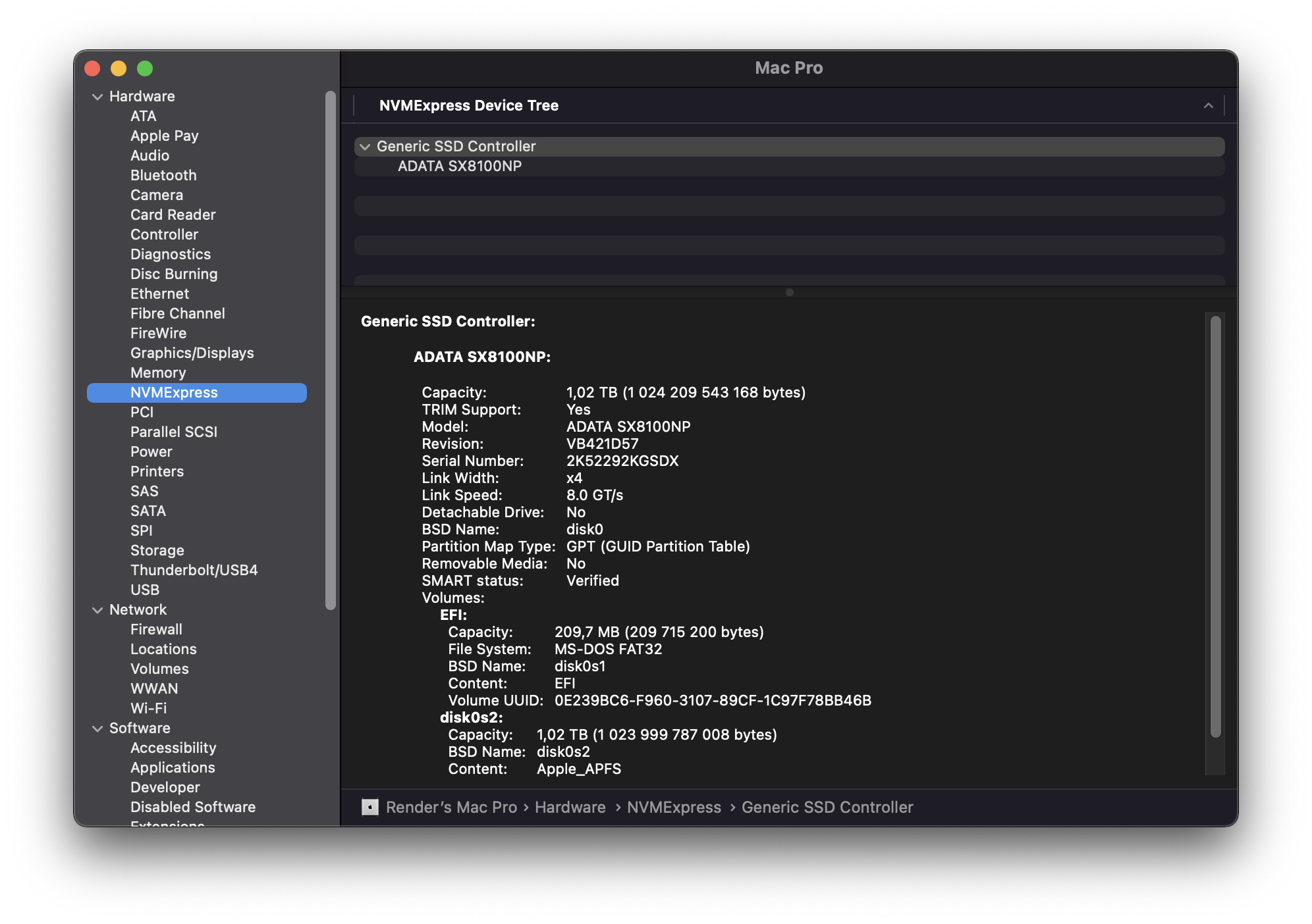

OldyCat Posted December 4, 2021 Share Posted December 4, 2021 (edited) Completely secondhand. Bought on AliExpress or Ukrainian OLX.ua I decided to try myself in Hackintosh before the topic’s "sunset", any comments and improvements are welcome Insane: Too many cores - you should cut CPU to 16 in BIOS settings For fixing lan adapter PCI’s name here I’ve used (see below) Quote FakePCIID_Intel_GbX.kext FakePCIID.kext Fix en0 lan adapter for Apple Services to work Fix NVMe SSD Controller with «built-in»=01000000 type=data property in DeviceProperties Remove AppStore dirs (if it’s necessary) sudo rm ~/Library/Preferences/com.apple.appstore.plist sudo rm ~/Library/Preferences/com.apple.storeagent.plist Important: I pay your attention to onboard lan adapters renaming in the IOregistry. If you do not do this, your system will randomly crush (for example, while any broadcast network message, etc.). If something goes wrong, you can remove the cable from the adapter’s connector and try to install OSX offline. If NOTHING works at all, and you want to be online, then use a compatible PCI or external USB adapters, for example, Belkin lan adapter. I found this problem on Supermicro X10 and X11 boards, «evil’s tongues» say that X12 has the same issue. My way is to download the two specified above kexts(FakePCIID_Intel_GbX.kext FakePCIID.kext). In the file /EFI/OC/Kexts/FakePCIID_Intel_GbX.kext/Contents/Info.plist Change «Root/IOKitPersonalities/Intel GbX/IOPCIPrimaryMatch» property: add string «0x15338086» (model/vendor ID) After this fix, the built-in motherboard cards work perfectly on native OSX drivers. If you find another way easier, let me know. Used parts problems CPU from AliExptess have one memory channel broken Computer case has one fan stuck Hardware MB: Supermicro X10DAi CPU: Intel® Xeon E5-2696v4, 1.2-2.2-3.7 GHz Chipset: C612 Memory: 4x32 Gb ECC/REG DDR4, 2133 MHz Video: Saphire Radeon RX 560, than ASUS RX 6800 XT Monitor: LG SSD + HDD: NVMe M.2 WiFi: Fenvi FV-T919 BCM94360CD (work out of the box) Mac model: MacPro7,1 MacOS version tested: install Big Sur 11.4 -> update -> 11.6 -> Monterey 12.0.1 What works? - Video: 5K x 60Hz on LG DisplayPort - Sound: audio jack(not checked) + HDMI audio - Wi-Fi (out of the box) - USB2 / USB3 ports - LAN 2 ports - Bluetooth (out of the box) - Display off/blank - iMessage/AppStore/iCloud/iTunes/Music Not Tested: - Sleep mode: not tested / I don't need - FileVault What does not work: - SideCar (needs iGPU for MacPro7,1@Monterey) BIOS Configuration, what's important: Legacy USB Support: [Enabled] XHCI Hand-off: [Enabled] EHCI Hand-off: [Disabled] USB 3:[Enabled] USB Mass Storage Driver Support: [Enabled] Above 4G Decoding: [Enabled] Hyper-threading: [Enabled] Active Processor Cores: [16x2] Serial Port: [Enabled] lol Intel(R) VT-d : [Enabled] CSM: [Disabled] Boot option filter: [UEFI only] Launch Storage/LAN/PCI OpROM policy : [UEFI only] OC configuration: OpenCore 0.7.5 How to use Make a bootable flash drive, you can use config.plist (link at the end of the message). Note: you must insert your own SeralNumber && MLB && ROM && SmUUID in the config.plist file. EFI.zip Edited December 7, 2021 by OldyCat included EFI Update / lan problem details 4 1 Link to comment https://www.insanelymac.com/forum/topic/349836-success-monterey-1201-supermicro-x10dai-dual-xeon-e5-2696v4/ Share on other sites More sharing options...

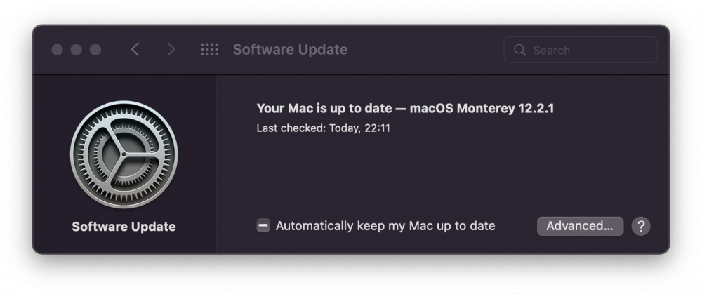

OldyCat Posted February 10, 2022 Author Share Posted February 10, 2022 Monterey 12.2 -> 12.2.1 Opencore 0.7.6 -> 0.7.7 Still OK config.plist 2 Link to comment https://www.insanelymac.com/forum/topic/349836-success-monterey-1201-supermicro-x10dai-dual-xeon-e5-2696v4/#findComment-2776624 Share on other sites More sharing options...

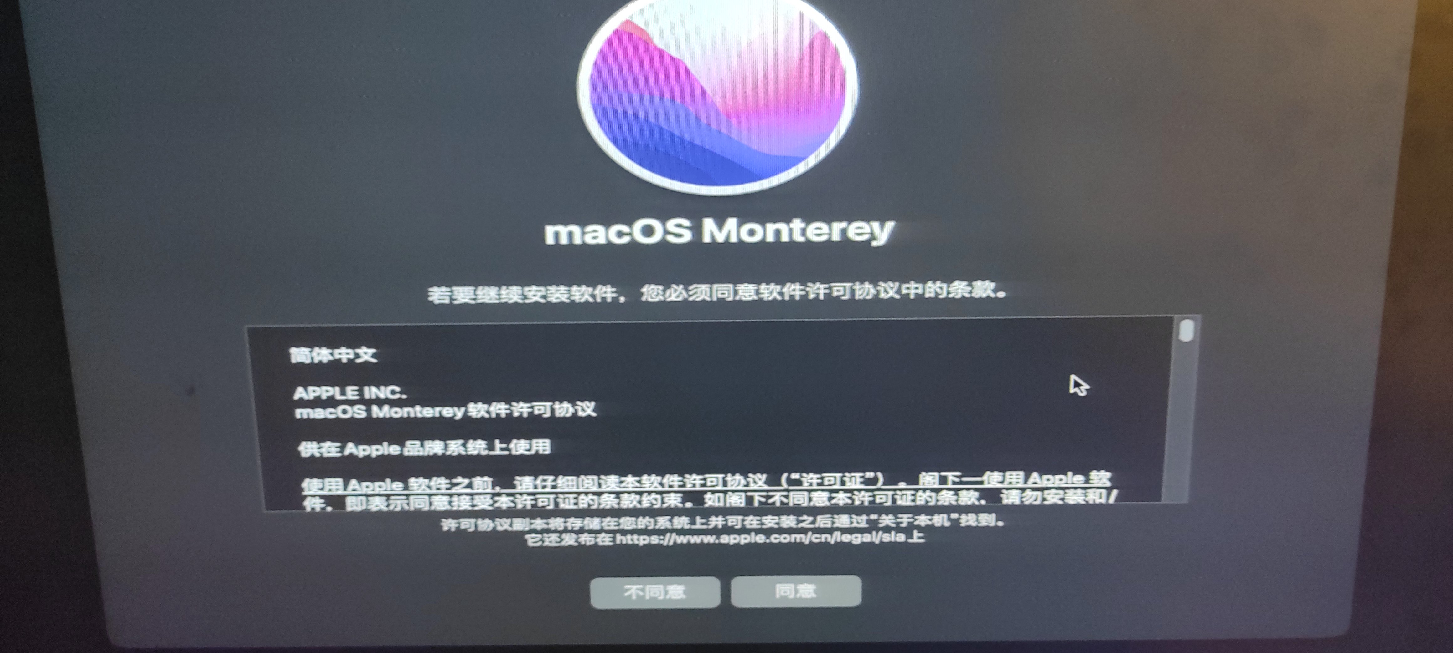

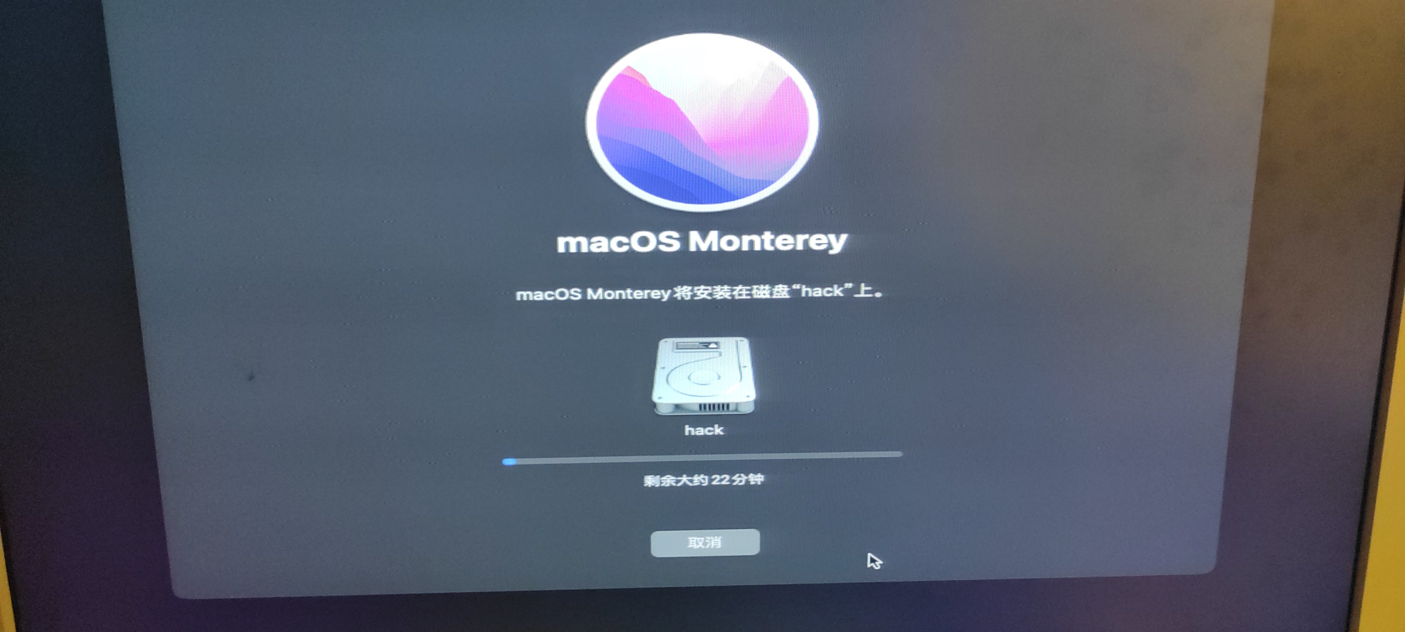

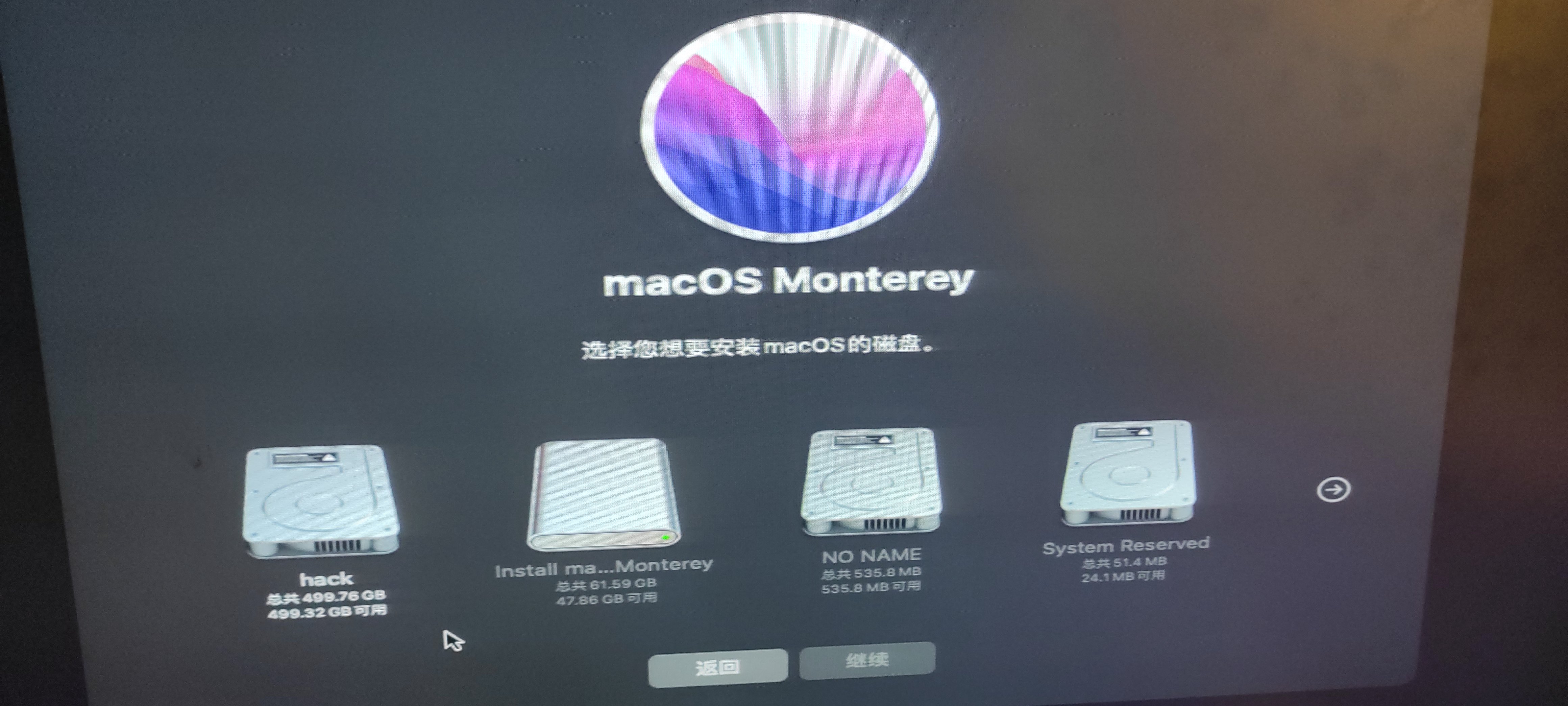

paok1926 Posted June 16, 2022 Share Posted June 16, 2022 hello, i have a lenovo thinkstation p700, with the same chipset as yours, i started the installation, with your files, but i suppose i have to learn Chinese first anyway, my instinct is guiding me :) i will keep you informed on how the installation goes.. its the first time i go so far.. Link to comment https://www.insanelymac.com/forum/topic/349836-success-monterey-1201-supermicro-x10dai-dual-xeon-e5-2696v4/#findComment-2785920 Share on other sites More sharing options...
