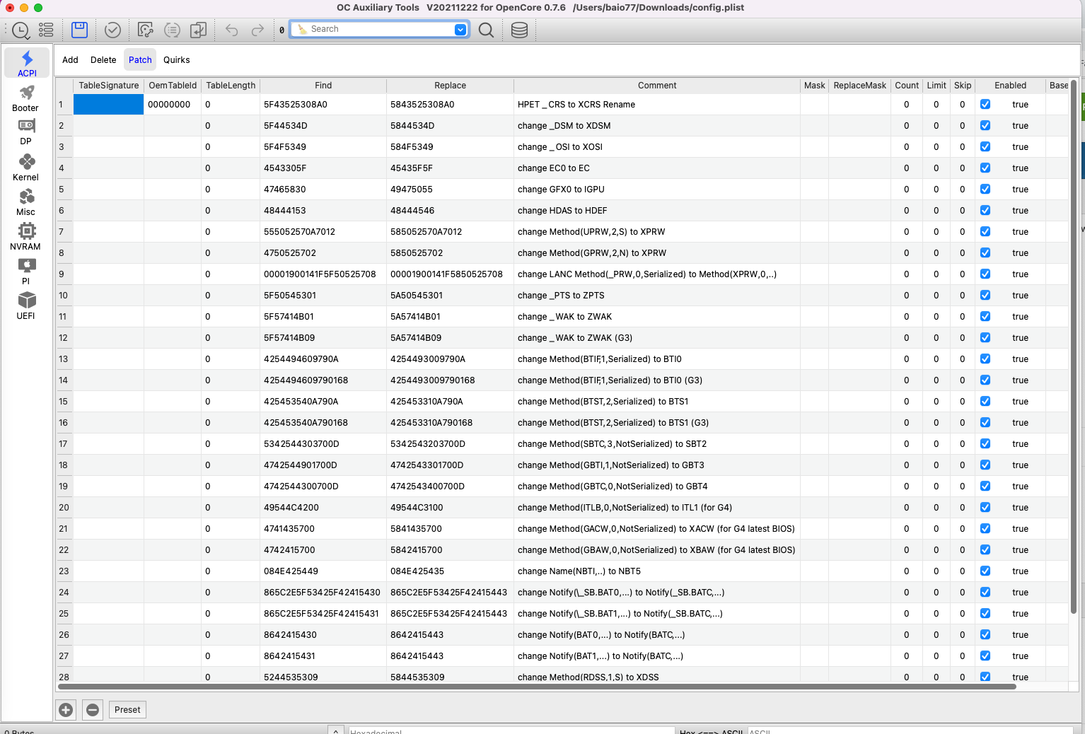

Baio77 Posted November 27, 2021 Share Posted November 27, 2021 (edited) https://github.com/5T33Z0/OC-Little-Translated Here is everything you need to be able to manage OC in the best possible way. Obviously it is not a guide for beginners, also given the complexity of the IASL world. EFI.zipTest this in USB if start ioreg . This EFI is old it should be improved further by inserting ECEnable.Kext and removing the ACPI and config patches. Try this in case we improve it further Edited November 27, 2021 by Baio77 Link to comment https://www.insanelymac.com/forum/topic/349734-why-cant-oc-boot-windows-10/#findComment-2772524 Share on other sites More sharing options...
Guest 5T33Z0 Posted November 27, 2021 Share Posted November 27, 2021 In OpenCore, if you use renames which change method and device names or values used within these devices or methods, they need to be paired with additional SSDTs that pick up on these changes and limit them to macOS. Combine renames with "count" and "base" parameters to limit the reach of a rename to only specific devices or methods inside of a device. Additional SSDTs need to scope into this device and/or method and define which parameters should be changed for macOS and what else to do if you are not using macOS by and if _OSI switch, as mentioned before. In other words you need to correct all SSDTs which do not contain the "If (_OSI ("Darwin"))", ELSE construct. Otherwise you need to use Clover, since it injects ACPI changes into macOS only. Link to comment https://www.insanelymac.com/forum/topic/349734-why-cant-oc-boot-windows-10/#findComment-2772527 Share on other sites More sharing options...
