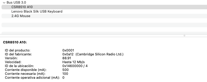

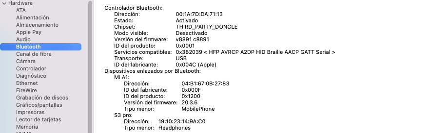

pepitillo Posted December 5, 2021 Author Share Posted December 5, 2021 For your information, I have buy a Trust 4.0 bluetooth dongle --> Trust 18187 Manga. It has a Cambridge Silicon Radio Ltd. chip. For running with Monterey, I have had to use BlueToolFixup.kext. The dongle works well on USB 3.0 and USB 2.0 from my experience. Link to comment Share on other sites More sharing options...
