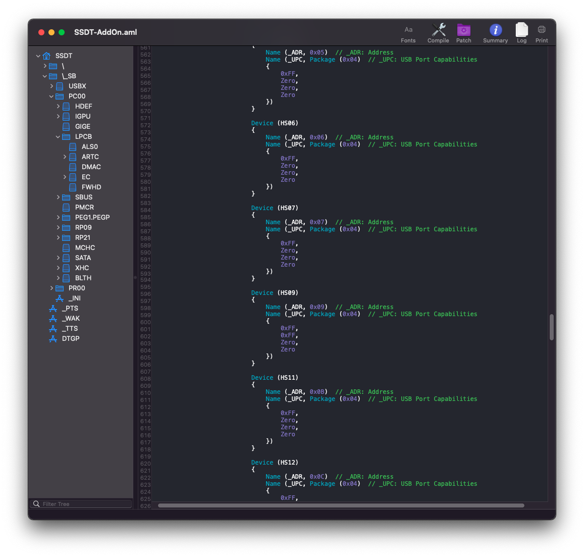

Aryamaulana Wibisono Posted December 26, 2021 Author Share Posted December 26, 2021 On 12/24/2021 at 7:46 PM, MaLd0n said: is impossible do it compare both files(original and patched) with DiffMerge app and check. ssdt is generic solution for one easy boot, just it. this dsdt above have all u need for one perfect hack but boot into windows for example with opencore don't work good, this bootloader inject things in other system too😄. in this case the best is used this way https://www.olarila.com/topic/13019-hackintosh-dual-boot-with-opencore-with-full-acpi-and-real-vanilla-solution/ I actually don't mind if OpenCore inject things in another system as long if my hack is look like the real mac 😅 also, i've already tried putting back the whole _PRW back into the DSDT that you patched it causing KP while booting. so I decided to use the SSDT instead of the DSDT because i'm not to familiar doing a full patch using DSDT roflmao besides that i'm addicted on a clean acpi code, make it looks close to the real mac as possible and the DSDT is not really the right place to do it because of how really mess the DSDT Code itself🤣 btw once again thank you very much for the work @MaLd0n, you're rock🤘 Quote Link to comment https://www.insanelymac.com/forum/topic/349606-debugging-sleepwake-issues/page/2/#findComment-2774180 Share on other sites More sharing options...
MaLd0n Posted December 26, 2021 Share Posted December 26, 2021 11 hours ago, Fortitude said: Hi @MaLd0n test EFI 02.zip 7 minutes ago, Aryamaulana Wibisono said: I actually don't mind if OpenCore inject things in another system as long if my hack is look like the real mac 😅 ssdt is not way for that 50%+ from our acpi is device for windows, etc. macos don't use it. One file, all solution, inject devices, removed unused devices, etc, etc. dsdt is a principal table present in our mobos, ssdts just inject into that but with limits. with _prw DSDT.aml.zip Just Enjoy! Quote Link to comment https://www.insanelymac.com/forum/topic/349606-debugging-sleepwake-issues/page/2/#findComment-2774181 Share on other sites More sharing options...
Aryamaulana Wibisono Posted December 26, 2021 Author Share Posted December 26, 2021 14 minutes ago, MaLd0n said: ssdt is not way for that 50%+ from our acpi is device for windows, etc. macos don't use it. One file, all solution, inject devices, removed unused devices, etc, etc. dsdt is a principal table present in our mobos, ssdts just inject into that but with limits. with _prw DSDT.aml.zip Just Enjoy! Well, I actually succeeded to remove unused device, and applying patch without have to worry about it applies to another system such as Windows, or other OS by using this If (_OSI("Darwin")) for an unused device that doesn't have the _STA method i usually wrap it inside the If Condition so it won't affect on another OS If (_OSI("Darwin")) { Name (DeviceName._STA, Zero) } or if the device itself already has an _STA method i simply create an _INI Method to override the _STA value itself for example: Method (_INI, 0, NotSerialized) { ^DeviceName._STA = Zero } Well Of course there's a limit like the current _PTS and _WAK patch that I recently implemented require a rename through the config.plist But heck yeah, thanks anyway! i'll definitely gonna learn more to patch using the DSDT 👍 Have a nice weekend! Quote Link to comment https://www.insanelymac.com/forum/topic/349606-debugging-sleepwake-issues/page/2/#findComment-2774184 Share on other sites More sharing options...
