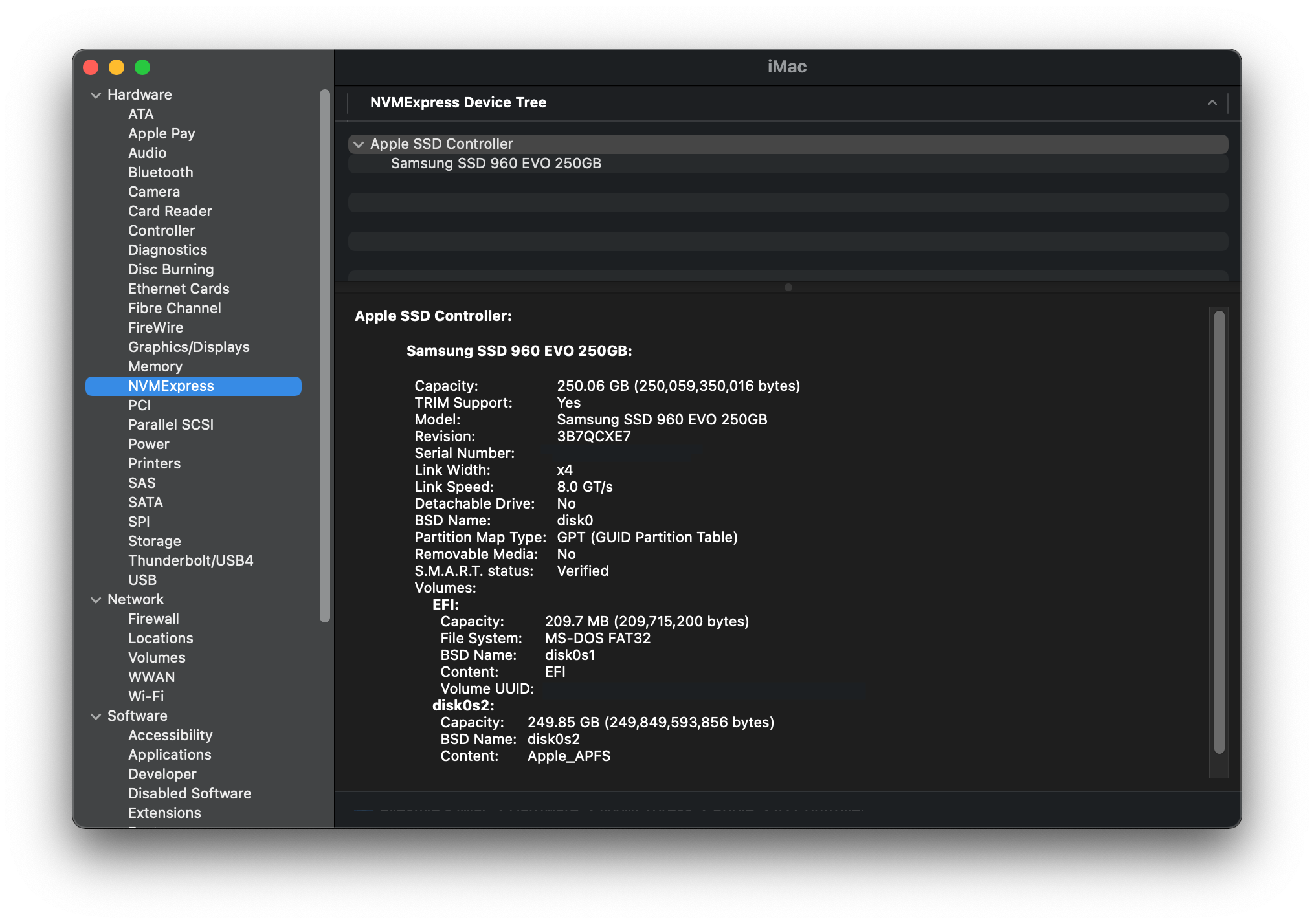

The article you posted pints to an issue on 960 Pro series not the EVO Series and on that note my EVO 960 256GB NVME drive has the latest firmware and I have been using it for macOS for years without any issues (I never installed any versions of Windows on it though) but if you don't feel like to update the firmware that's ok.
