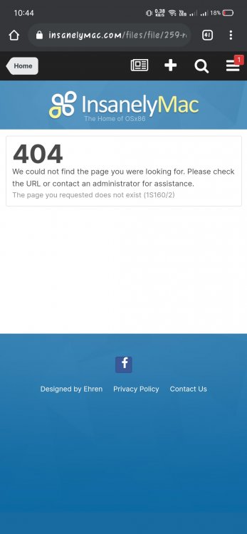

sahib1517 Posted June 10, 2021 Author Share Posted June 10, 2021 It says Error 404 file not found Quote Link to comment Share on other sites More sharing options...

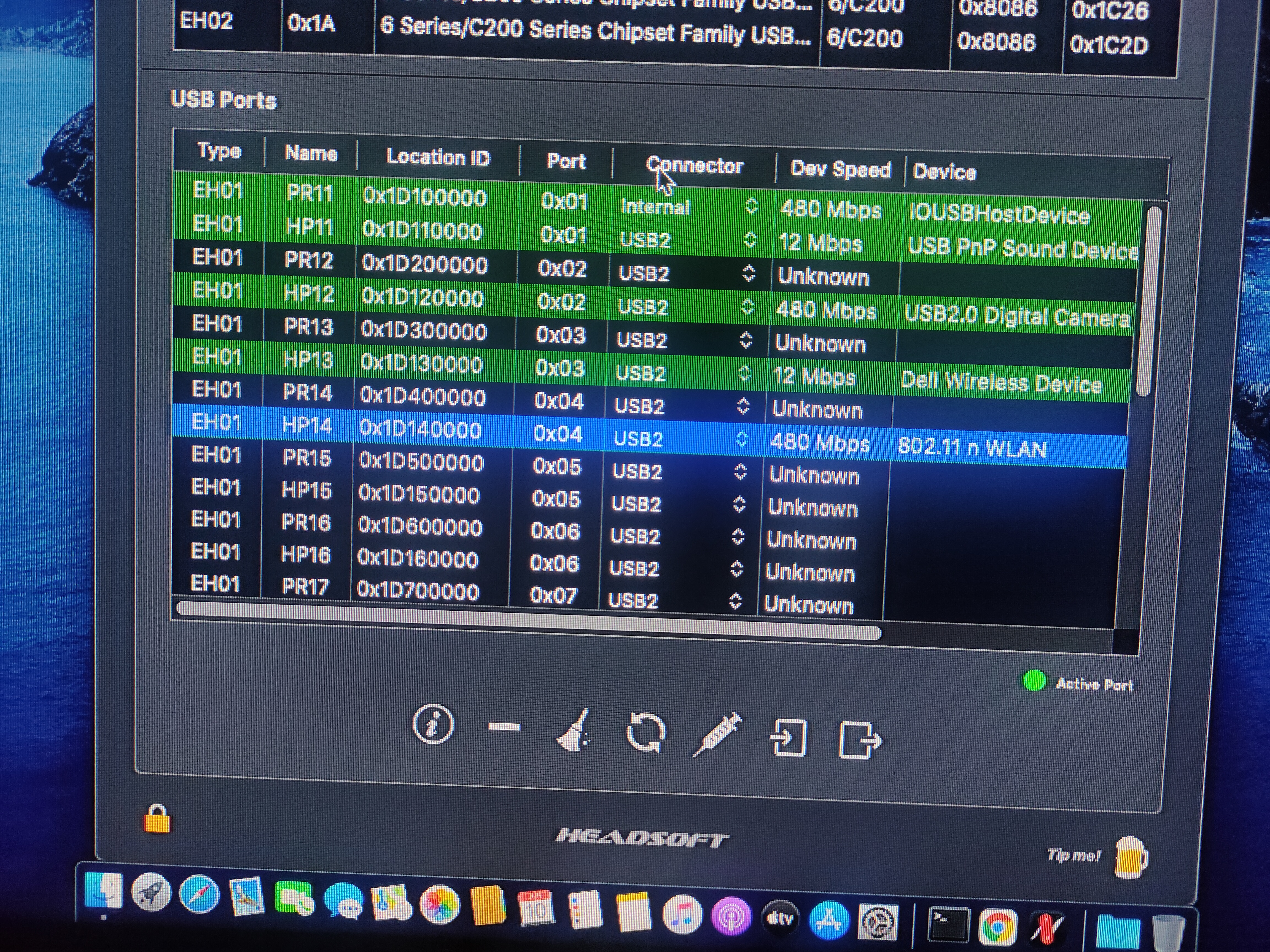

Slice Posted June 11, 2021 Share Posted June 11, 2021 1 minute ago, sahib1517 said: Anything for my wireless usb adapter? You should investigate what chip is inside the adapter. Exactly name, model, vendor and deviceID. Quote Link to comment Share on other sites More sharing options...
sahib1517 Posted June 11, 2021 Author Share Posted June 11, 2021 It just show Ralink Quote Link to comment Share on other sites More sharing options...

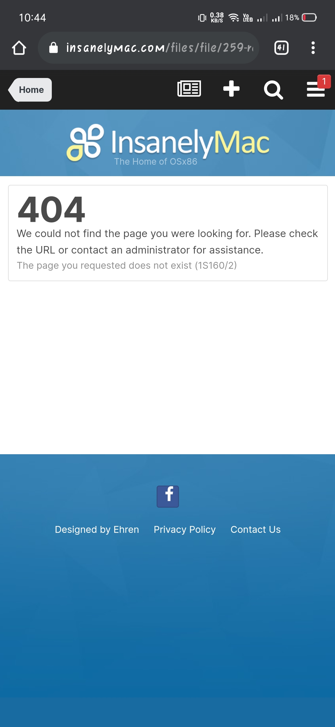

Slice Posted June 11, 2021 Share Posted June 11, 2021 48 minutes ago, sahib1517 said: It just show Ralink The official drivers for Mac exists https://www.mediatek.com/products/broadbandwifi/rt5370 1 Quote Link to comment Share on other sites More sharing options...

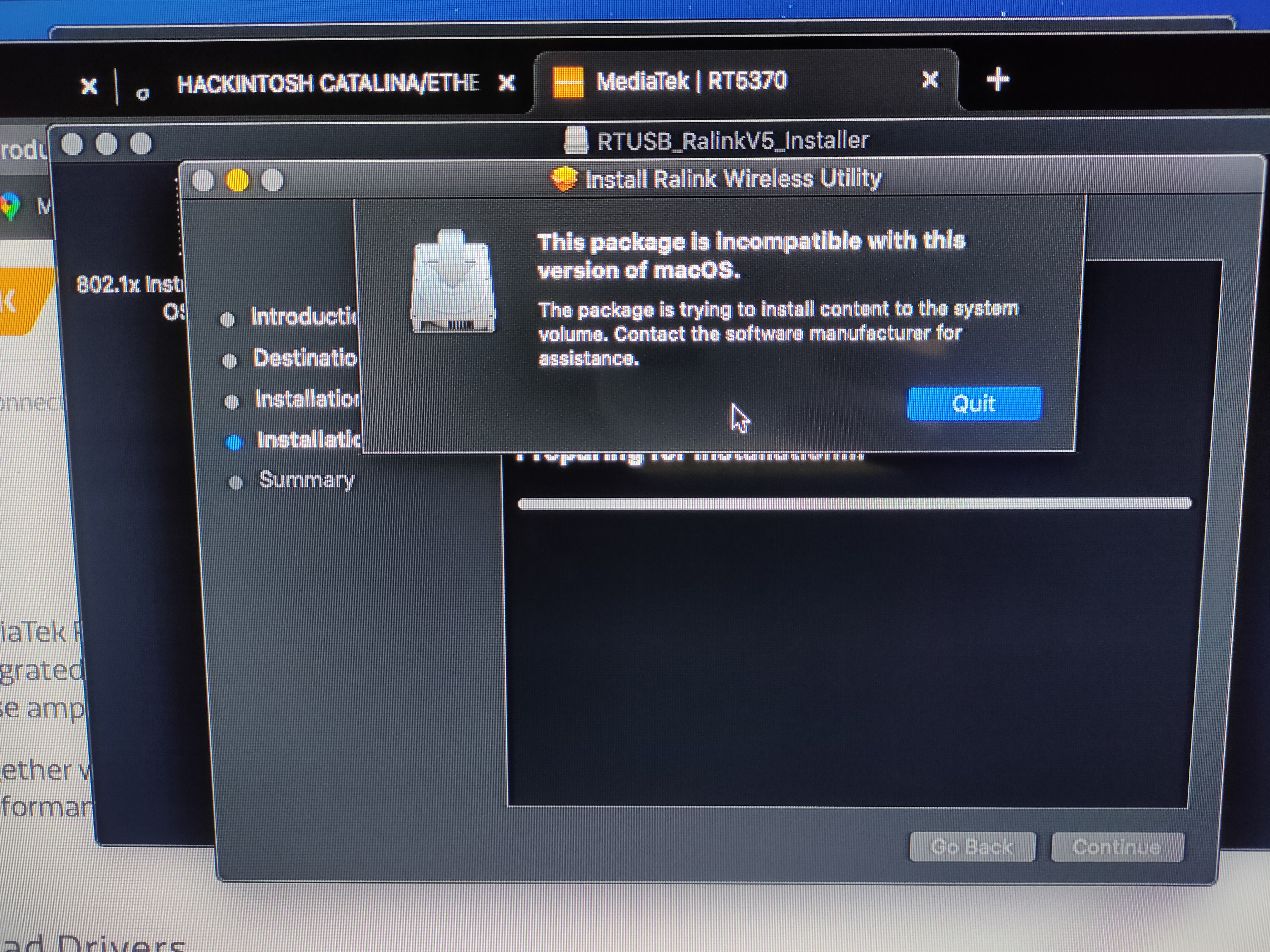

sahib1517 Posted June 11, 2021 Author Share Posted June 11, 2021 It giver me this error Quote Link to comment Share on other sites More sharing options...
Slice Posted June 11, 2021 Share Posted June 11, 2021 Contact MediaTek with this question. Or install the driver manually. Quote Link to comment Share on other sites More sharing options...
sahib1517 Posted June 11, 2021 Author Share Posted June 11, 2021 install the driver manually. Please assist me with this Quote Link to comment Share on other sites More sharing options...
