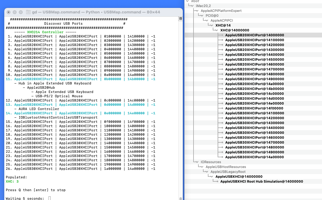

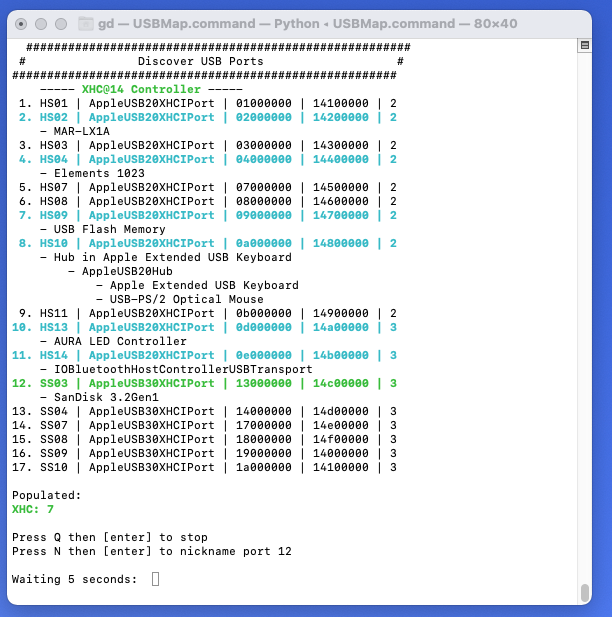

Similar problem on my built.
Big Sur 11.4
ASUS TUF Gaming z490 Motherboard.
1 USB 2.0 Port
7 USB 3.0 Port
1 USBc port (which Ido not use at the moment)
USB 3.0 Devices work on all ports (USB2.O and USB3.0)
USB 2.0 devices only work on the one USB2.0 port and do not get recognized on the USB3.0 Ports
I have SMBIOS imac 20,2
I tried Hackintool, USBinjectall and corpnewt's script Usbmap.command.
The result is the same: If I plug in an USB2.0 device into a USB3.0 Port, it will not be recognized.

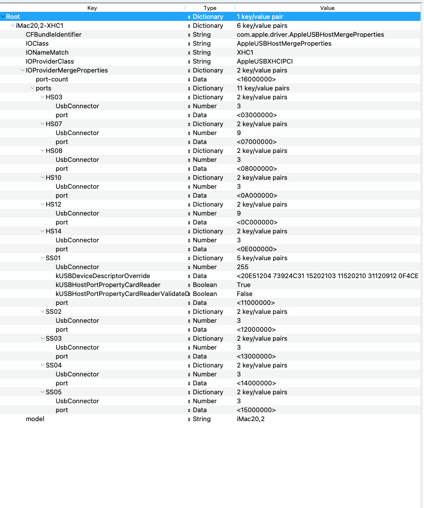

This is the BIG Sur USB Port .plist for Imac 20,2
1144045653_Screenshot2021-06-05at11_41_37.thumb.png.a0946e62aa6084ac6db3f25b56889865.png
Anyone any idea how to solve this?
Solved:
I managed to get all my USB PORTS working on BIG SUR 11.4
OPENCORE EFI:
1. Delete SSDT_RHUB.aml (also in config.plist with propertree - snapshot)
2. in config.plist under Kernel - Quirks set XhciPortLimit to False. save config.plist.
3. delete all USB related Kexts in OC-Kexts folder especially USBincejctall (also in config.plist with propertree - snapshot)
Restart, reset NVRAM restart
Download corpnewt / USBMap
Open it with USBMap.command
choose D - discover ports.
Now you should see all your USB2.0 Ports.
Plug in a USB2.0 !! Device into every USB port on your PC even into the USB 3.x and USB c ports.
USBMap.command will populate all your USB 2.0 Ports.
Set your Ports to USB 2.o as discribed here:
https://dortania.github.io/OpenCore-Post-Install/usb/intel-mapping/intel.html
(the T:2,4,6,7,8:2" - Thing)
After you have populated all your ports, hit Q and then P in USBmap.
Now you see all your USB Ports mapped (populated)
Hit P to enable all populated Ports and then q for quit.
Then in:
OPENCORE EFI:
1. in config.plist under Kernel - Quirks set XhciPortLimit to TRUE
save config.plist
Open USBmap  with USBMap.command
Now you should see all your USB3.0 Ports.
Plug in a USB3.0 !! Device into every USB port on your PC even into USB c ports.
USBMap.command will populate all your USB 3.0 Ports.
Set your Ports to USB 3.0 as discribed here:
(the T:2,4,6,7,8:3" - Thing)
Now you see all your USB2.0 AND USB3.0 Ports mapped (populated)
Hit D to disable all empty ports.
Hit K or L to built your USBMap.kext. depending on your MacOS
Copy USBmap.kext into EFI - OC- Kexts Folder.
open config.plist with propertree and make a snapshot to populate the new USBmap.kext in the config.plist
Restart, reset nvram, restart.
Voila, all Ports should work.
Now you see:
some people set Port 10 and 11 (Bluetooth) to 255 instead of "3" to make it an internal port. If your Bluetooth doesn#t work, you can try this.
in config.plist under Kernel - Quirks set XhciPortLimit to False or true, it doesn#t really matter anymore. I have it on False because I have populated more than 15 Ports - However, I don#t know if that really matters or has any meaning and I do not care because:
IT WORKS !!!

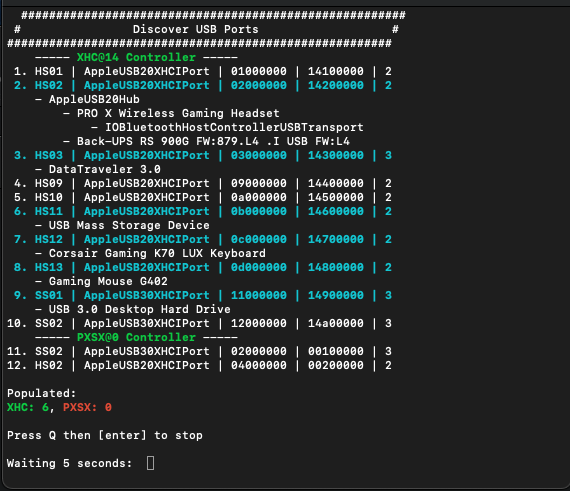

After a lot of time to try making usb working after upgrade from Catalina to Big Sur (directly 11.4), finally:
After reading several guides about the usb problem, I solved it only thanks to that of kentsoon.
Only HS03 port is working USB2 instead of USB3, don't know why!
