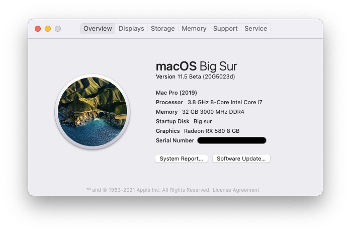

SSD: Samsung Evo 980Pro 512GB , for Big Sur

GPU: Sapphire Pulse RX580 8GB

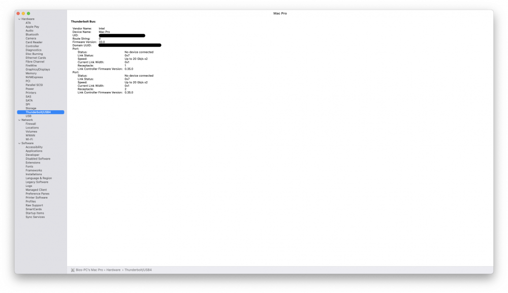

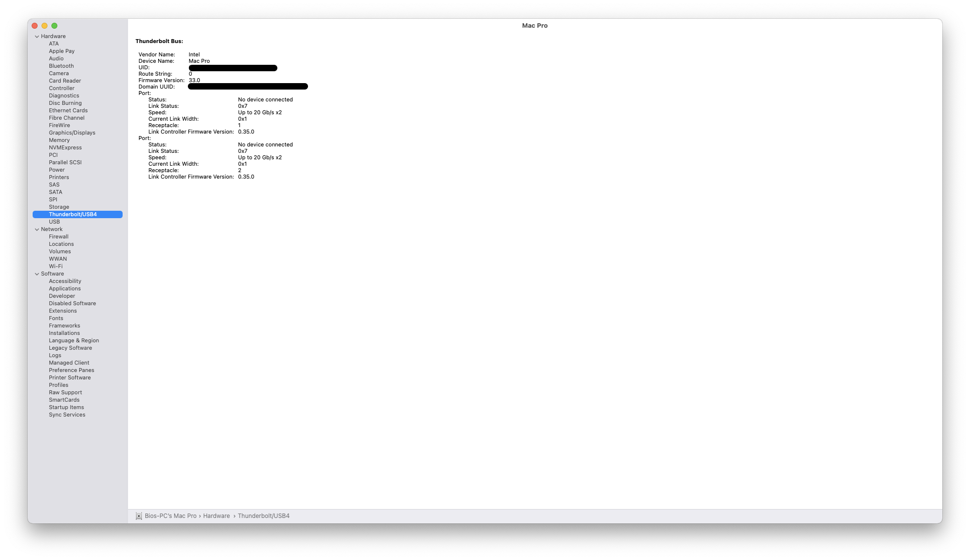

ThunderBolt: Built-in Thunderbolt 4 , with custom SSDT from @MaLd0n , GC-AlpineRidge Thunderbolt 3 V2 , with custom Mac Firmware From KGB ( I flash it with raspberry pi)

the thunderbolt card not loose usb connection so if I connect usb keyboard and mouse it worked.

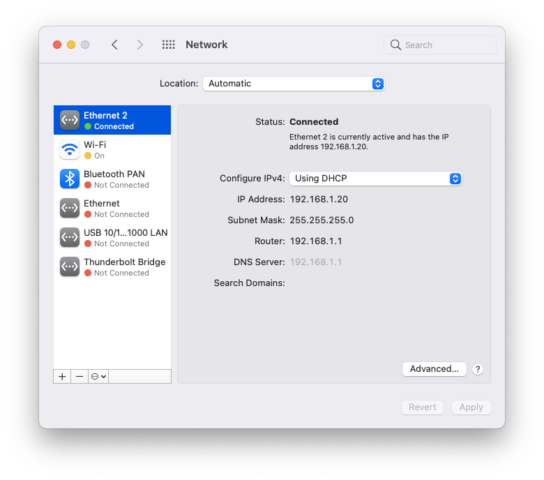

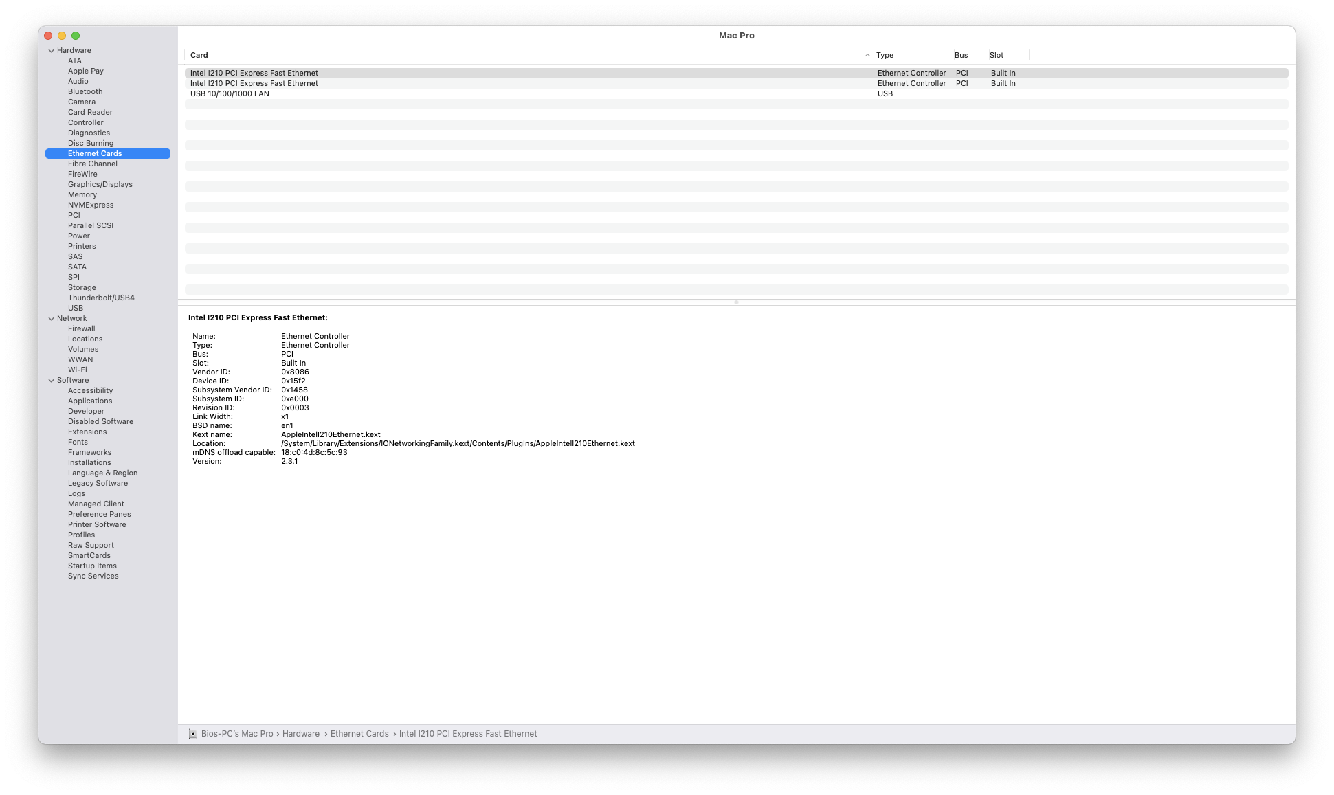

Thanks for the info. I add a question to @Allan. I see 2 Ethernet and 1 USB LAN. All of them are working? I suppose that USB LAN and 1 Eth work fine but comment something about this.

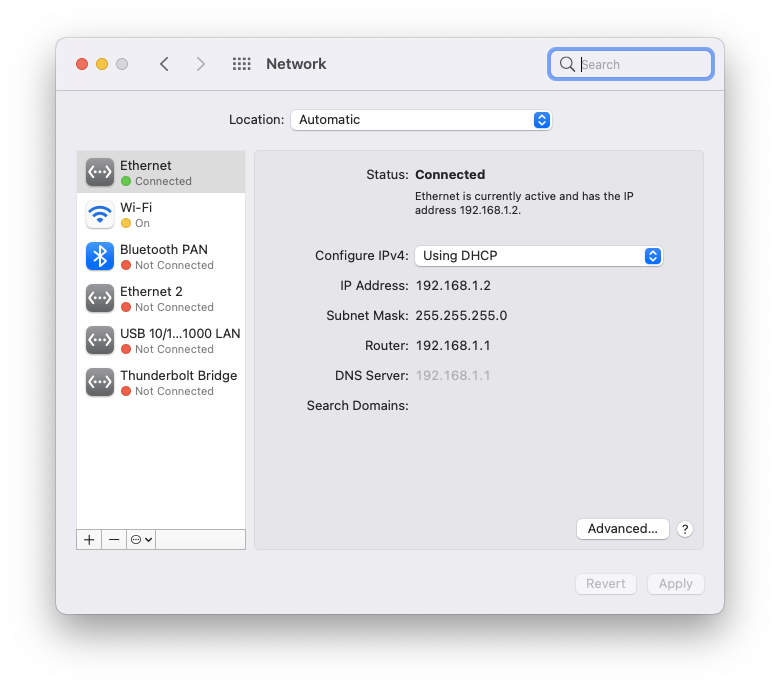

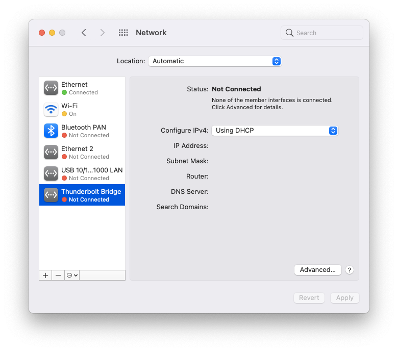

@Allan  yes , thunderbolt fully working , @miliuco  all network adapter is working , 2 ethernet adapter intel i225-v 2.5gb , usb network from docking station connected to usb-c at the alpineridge thunderbolt

Eth 2,5 Gb are working at 2,5 or at 1gb? How have you installed them, DeviceProperties in config.plist, @MaLd0n DSDT or any method?

I don't have router that can give me 2.5Gbit , It works on 1gb with my router and I got full speed internet 1000mb/100mb fiber

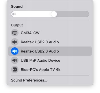

ALC4080 work perfect without any kext or injections because its usb onboard sound card
for ethernet card I use FakePCIID.kext and FakePCIID_Intel_I225-V.kext with DeviceProperties  device-id F2150000

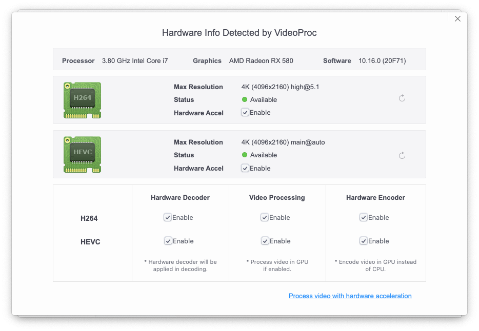

enjoy192928254_ScreenShot2021-05-27at23_38_54.thumb.png.c848b2d63104823aaa06115ff0e762a4.png1507575481_ScreenShot2021-05-27at23_38_08.thumb.png.55598fb6dc9236058ef31e1a0bae06fd.png438079996_ScreenShot2021-05-27at23_39_45.thumb.png.c0712ddaf110995e6181efb9576219e3.png

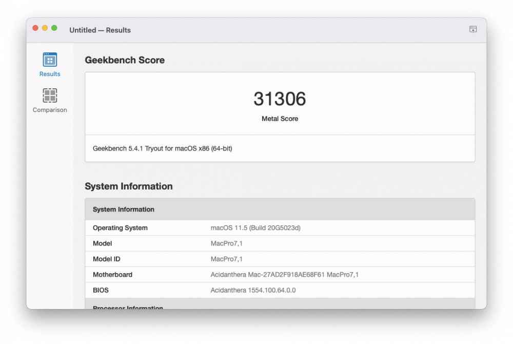

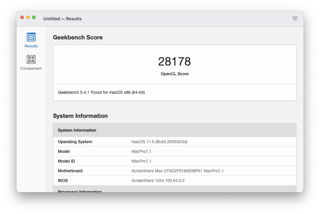

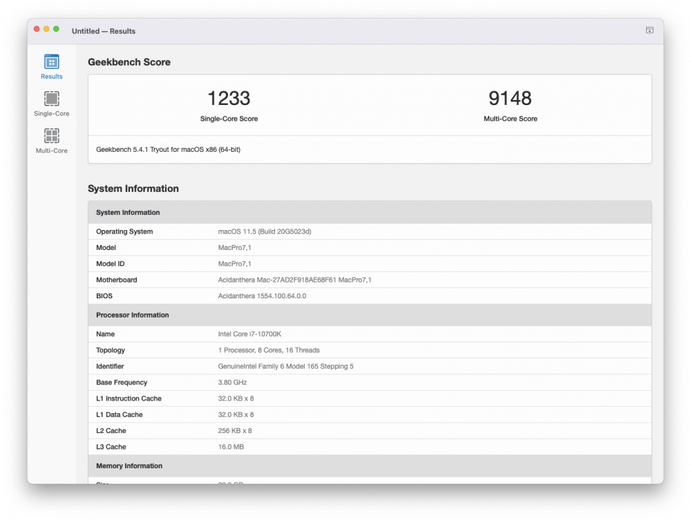

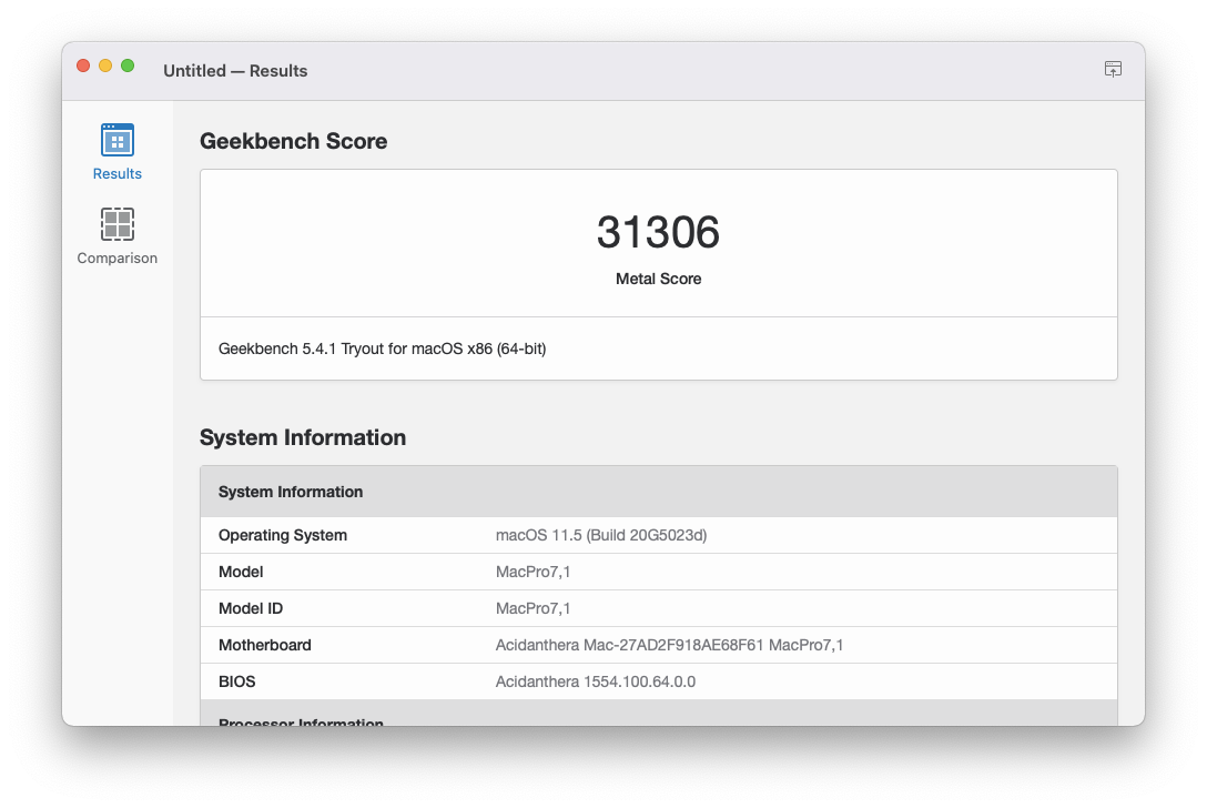

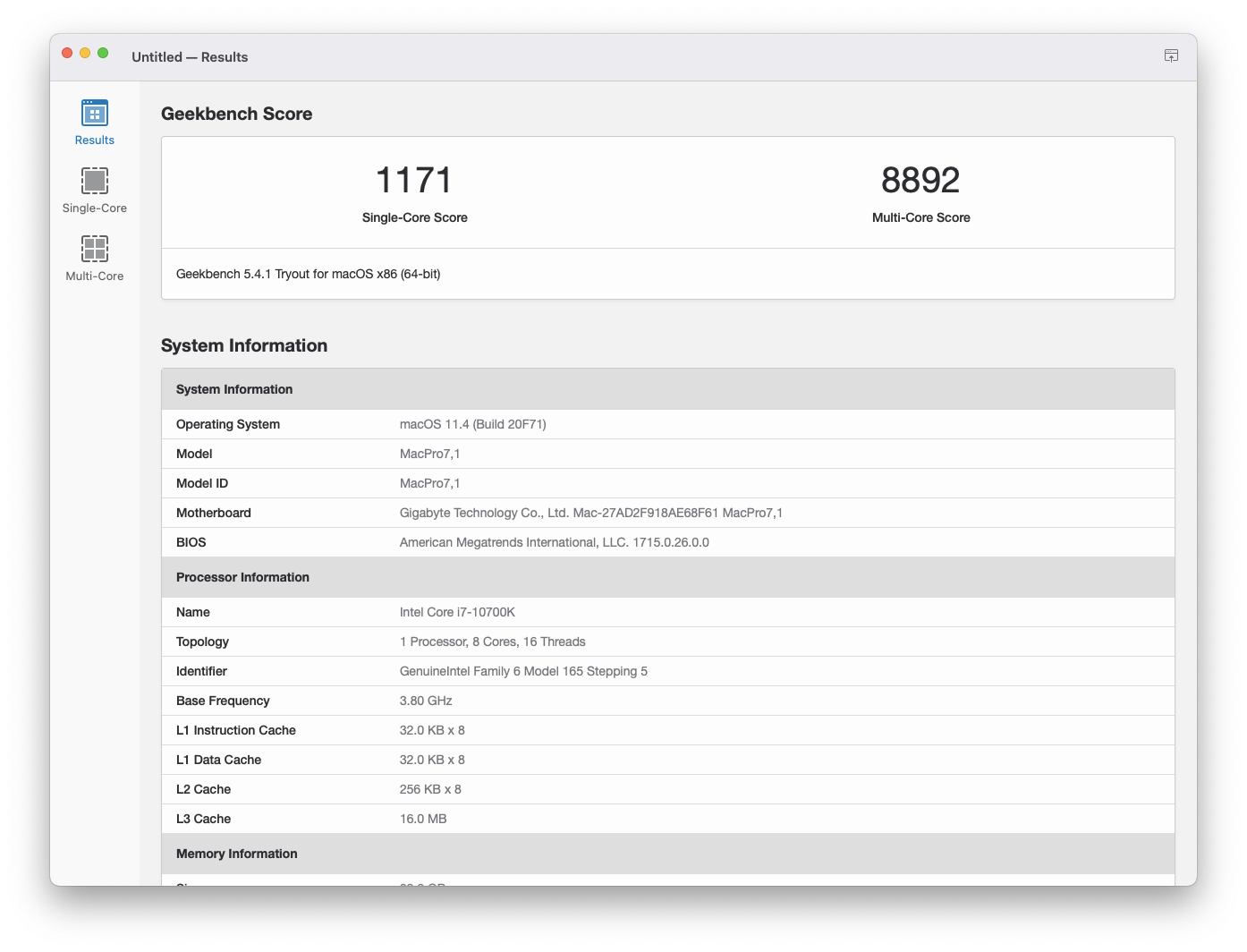

One comment. I see 31306 as score for RX 580 Metal and MacPro7,1 SMBIOS. Imo GeekBench 5 has a behaviour, at least with RX 580, so the score is high (48000 - 50000) only when the graphics card is below 35-40º, which only happens shortly after starting. When the RX 580 is above 45º (its operating temperature in my case is around 50º) GeekBench 5 drops to approx. 30000.
I say that it is a particularity of GeekBench 5 because if I use other Benchmarks (Black Magic RAW Speedtest, Unigine Valley, etc.) the scores are the same when the dGPU is cold and when it is more than 50º.
For the rest I congratulate you, you have a very good machine, enjoy it.
