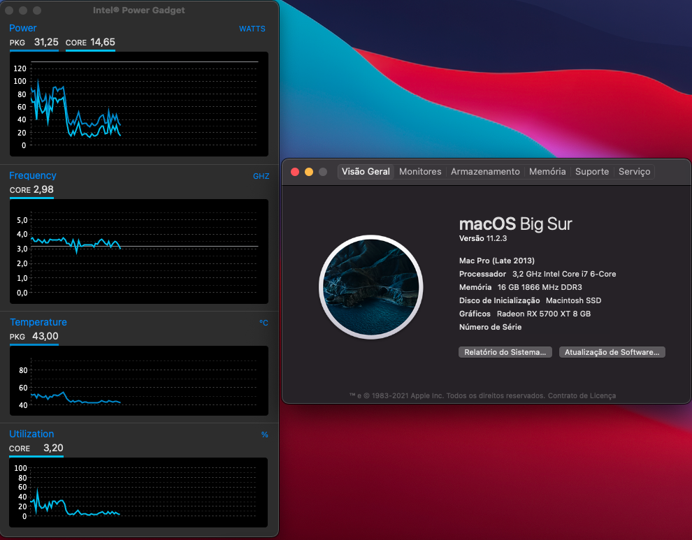

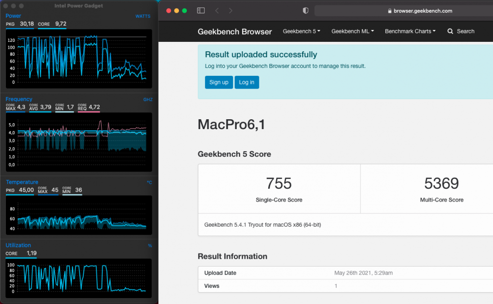

Here are the results:
Big Sur 11.2.3
1457013305_CapturadeTela2021-05-26s05_29_33.thumb.png.50061252fa53644d3d5ef84f736dce73.png

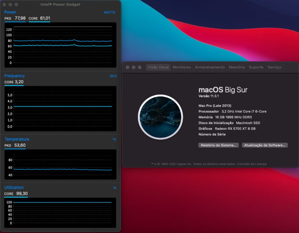

Big Sur 11.3.1 (same result in 11.3 and 11.4)

It's not the Index, I did several tests. I even thought it was a problem with the Intel Power Gadget, but the benchmarks and freezing of the system show the opposite.
To keep it registered: I tested it with both FakeSMC and VirtualSMC, changing the correct drivers as well.
Look at the photo below
3 hours ago, 5T33Z0 said:
You should run Activity Monitor as well to see what causes the high CPU useage. Sometimes services can cause abnormally high CPU useage temporarily.
Dont show nothing. I just overclocked a little to 4.2Ghz to see if anything changed, but it still consumes 99%.

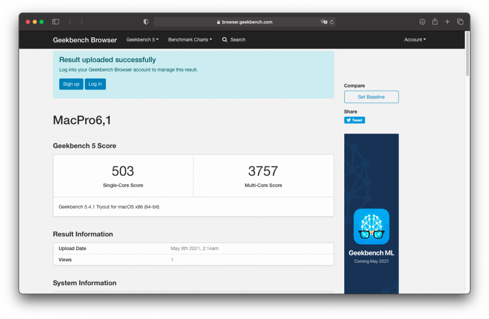

As I said to Allan, I thought it could be a mistake on the Intel Power Gadget, but the benchmarks have dropped, and I'm feeling more heat coming out of the case.
At 11.4 the benchmarks went up a bit, I'm getting 612 single and 4800 multi, but it's still not normal
Edited by Vinicius P. Miranda

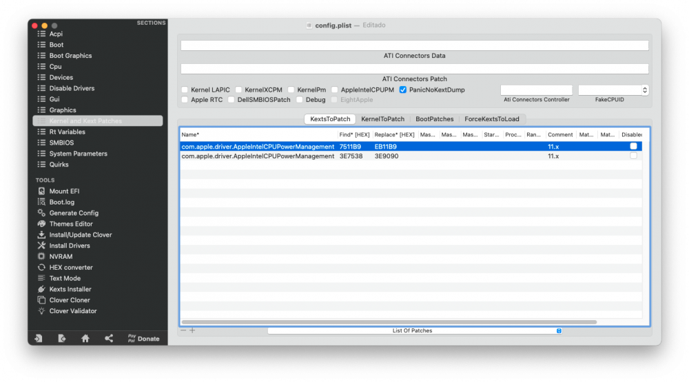

Hervé,
I don't need any of that, it was that mess because I was testing things. "CPU Type" is just for showing my CPU correctly in "About this mac". It's just cosmetic.
The problem is even in 2 patches of Kexts. I used these two patches that I show in the image below, from Catalina to Big Sur 11.2.3 (Clover and OC) to make the power management work very well. Recognizing even overclocking. Without one of these patches Power Management won't work, without the other the hack won't boot.
On 11.3+ these patches have stopped working, I can boot with or without them, but power management does not work. Something has changed in these Find values but I don't know where to look to find the correct value and replace it in Find.
These two patches that stopped working:
162523999_CapturadeTela2021-05-30s07_51_32.thumb.png.a4226dbec20f359c280451987651198c.png

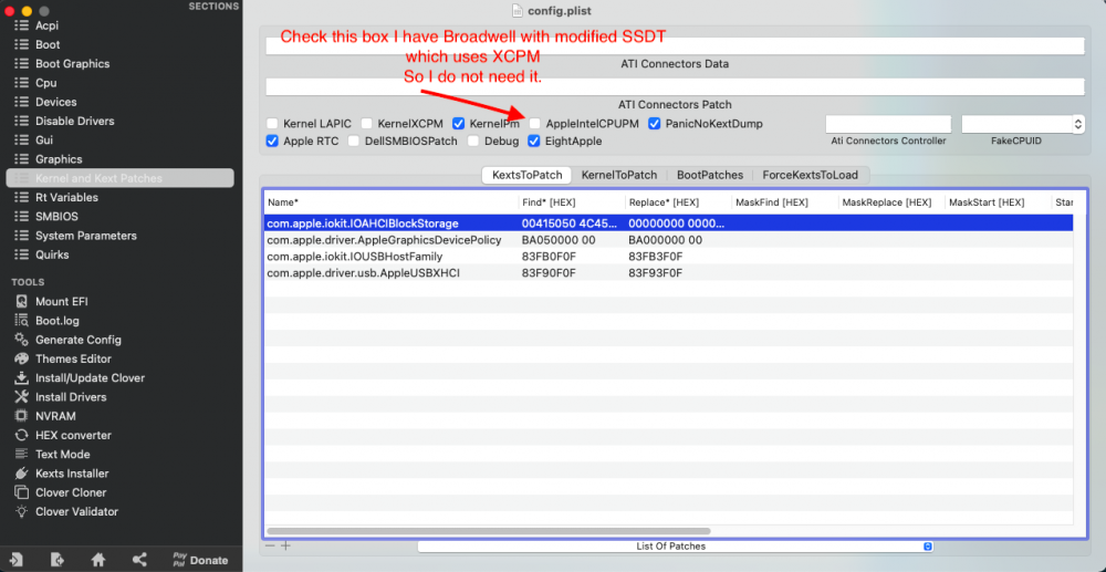

  • 1 month later...
I think if not mistaken correct me if incorrect.  Herve is saying use the Clover built in patch.  Not the one you have inserted.
Then try and test.  Just the ones you have inserted disable them and see what happens?339647405_ScreenShot2021-07-13at9_25_07PM.thumb.png.71c7e315a31b6b8a1704fddbdb2673e8.png
