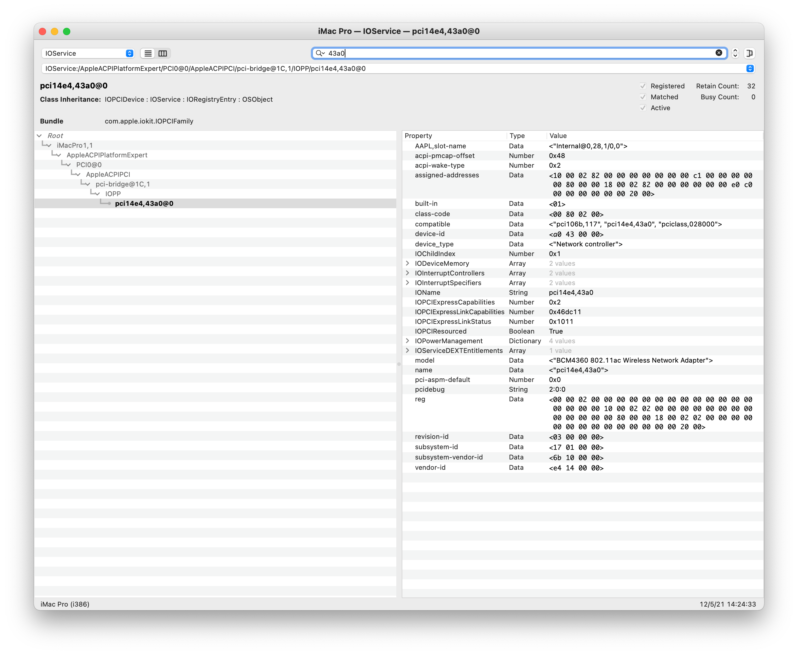

kuruu Posted May 12, 2021 Author Share Posted May 12, 2021 Thanks! Yes, I can see the device in IORegExplorer. Here is a screenshot and the compressed ioreg is attached. iMac Pro.zip Link to comment https://www.insanelymac.com/forum/topic/347706-bcm94360cs2-no-wi-fi-but-kext-is-loaded/#findComment-2757759 Share on other sites More sharing options...

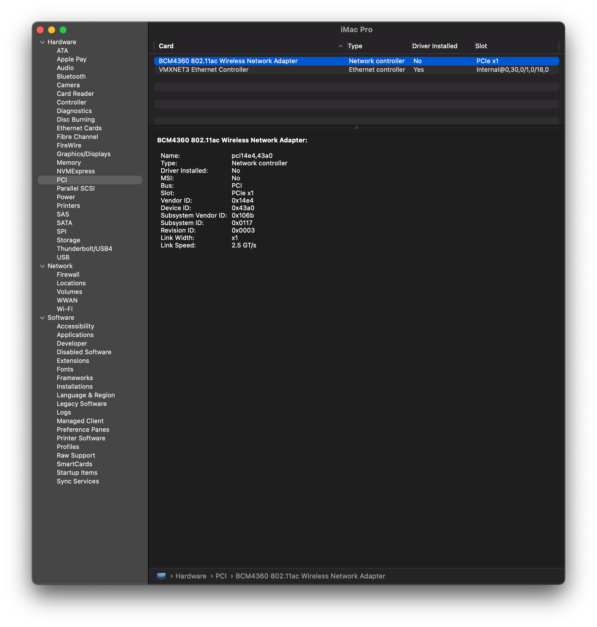

kuruu Posted May 12, 2021 Author Share Posted May 12, 2021 I tried to inject the PCIRoot device, and it shows up under PCI of System Information, but says "Driver Installed: No" EFI_May.zip Link to comment https://www.insanelymac.com/forum/topic/347706-bcm94360cs2-no-wi-fi-but-kext-is-loaded/#findComment-2757773 Share on other sites More sharing options...
