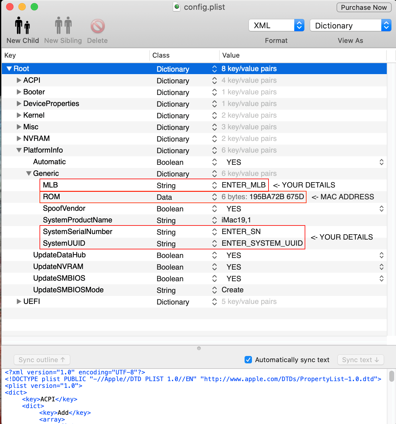

AudioGod Posted April 6, 2021 Share Posted April 6, 2021 (edited) I went on a mission to get myself a Asus Crosshair VIII Hero DARK HERO as a freebie and failed miserably but in my pursuit for the motherboard I hassled the company so much that to shut me up they gave me a ASUS ROG STRIX X570-E GAMING instead. Anyway, as it happens to be my personal all round favourite X570 motherboard it would of been rude of me not to tear down my system and rebuild it with the X570-E mounted inside it instead. Everything is working apart from the internal mic inputs and SideCar but everything else like Sleep, PowerNap, Wake, All iCloud functions inc AirDrop, iMessage, Handoff, AppleWatch Unlock etc etc work perfectly. I have fully mapped USB manually on all ports and there's no micro stutters or freezes or anything else strange that you can think of. Build Spec CPU: AMD Ryzen 9 5900X Motherboard: Asus STRIX X570-E (Bios Revision - 4021) RAM: Corsair Pro Vengeance 32GB DDR4 3600Mhz (Tuned) Graphics: Sapphire RX 6800 Case : Lian Li PC-O11DW Dynamic. NVMe: Samsung 970 EVO 1TB & Samsung 970 EVO Plus 1TB SSD: Samsung 860 EVO 1TB HDD: Seagate Barracuda 1TB PSU: EVGA SuperNOVA 850 G5, 80 Plus Gold 850W WiFi-Bluetooth: BCM94360NG 1200Mbps 802.11ac Sound: Onboard & Native Instruments Audio 6 Cooling : Arctic Liquid Freezer II 360 AIO Operating Systems: Big Sur, Monterey Beta, Windows 10 Pro, Ubuntu 20.04.2.0 LTS Bootloader: OpenCore 0.7.2 SMBios MacPro7,1 ACPI SSDT's - All bypassed for other OS SSDT-PLUG.aml (CPU power management) SSDT-SBRG.aml (Correcting EC, RTC memory & IRQ conflicts) SSDT-SBUS-MCHC.aml (SMBus Support) SSDT-USBX.aml (USB power tables) SSDT-HPET.aml (HPET _CRS (Needs _CRS to XCRS Rename)) Kexts Lilu.kext - V1.5.6 VirtualSMC.kext - V1.2.7 WhateverGreen.kext - V1.5.4 AppleALC.kext - V1.6.5 SmallTreeIntel82576.kext - V1.3.0 LucyRTL8125Ethernet.kext - V1.1.0 AMDRyzenCPUPowerManagement.kext - V0.7.0 RestrictEvents.kext - V1.0.5 USBMap.kext - ASUS ROG STRIX X570-E What Works Sound including the case's front headphones 3.5mm port Both Ethernet Ports WiFi / Bluetooth USB Type C, 3.0 & 2.0 (All ports Mapped & Open) Sleep & Wake Sleep and Shutdown via the Power Button Power Nap Hardware Acceleration AirDrop iCloud iMessages FaceTime AppleTV Netflix & Amazon Prime via Safari Handoff Continuity Apple Watch Unlock What Doesn't Work SideCar Internal Mic Input As the iMacPro has now been discontinued I thought it was only right to stop using smbios iMacPro1,1 for my EFI setups and use MacPro7,1 instead but this also means the EFI is only good to use with Catalina and Big Sur. For any OS older then Catalina you would need to switch the smbios to iMacPro1,1 and modify the config.plist to suit it. One of the advantages with using smbios MacPro7,1 is there are no renames necessary for the USB controllers allowing me to keep the USB mapping as close to how AMD/ASUS intended the USB Mapping to be. A few very minor tweaks and changes might be needed to be done to make your system setup perfect so please make sure you read the Install & Post Install notes so you can make those last few changes quick and easily. BIOS Settings Enter BIOS -> Press Delete -> Enter Setup Exit -> Load Optimised Defaults Ai Tweaker -> Ai Overclock Tuner -> D.O.C.P. Advanced -> CPU Configuration -> SVM Mode -> Enabled Advanced -> Onboard Device Configuration -> PCIEX16_1 -> Auto Advanced -> APM Configuration -> Power On By PCIe -> Disabled Advanced -> PCI Subsystem Settings -> Above 4G Decoding -> Enabled Advanced -> PCI Subsystem Settings -> Re-Size BAR Support -> Disabled Advanced -> USB Configuration -> Legacy USB Support -> Auto or Disabled Boot -> Boot Configuration -> Fast boot -> Disabled Boot -> CSM -> Launch CSM -> Disabled Boot -> Secure boot -> OS Type -> Windows UEFI mode Boot -> Secure boot -> Key Management -> Clear Secure Boot Keys Install Notes Using PlistEdit Pro, Xcode or ProperTree add your details by modifying the following Nvram Important - Before booting into MacOS using the new EFI for the first time make sure you reset your Nvram. (At the bootpicker press Space to reveal the option) Try to make this a habit and do it whenever you make system changes or upgrading the EFI to a newer version etc etc. GPU If your not using a RX 6800 or any other Navi GPU then remove agdpmod=ignore from the boot arguments. Recovery Drive I have the Recovery Drive and ClearNVRAM option hidden as standard in OpenCanopy, To reveal the options all you have to do is press the Space Bar when you get to the BootPicker.IMPORTANT - PATCH INFO FOR SETTING THE CORRECT CORE COUNT FOR YOUR CPU Core Count patch needs to be modified to boot your system. Find the two algrey - Force cpuid_cores_per_package patches and alter the Replace value only. Changing BA000000 0000/BA000000 0090* to BA <CoreCount> 0000 0000/BA <CoreCount> 0000 0090* substituting <CoreCount> with the hexadeciamal value matching your physical core count. Note: The three different values reflect the patch for different versions of macOS. Be sure to change all three if you boot macOS 10.13 to macOS 12 See the table below for the values matching your CPU Core Count. CoreCount Hexadecimal 6 Core 06 8 Core 08 12 Core 0C 16 Core 10 32 Core 20 So for example a 6 Core 5600X would result in these replace values, BA 06 0000 0000/BA 06 0000 0090 Or a 12 Core 5900X that I have it setup as standard would result in these replace values, BA 0C 0000 0000/BA 0C 0000 009012 Core EXAMPLE Finally and as always, MAKE SURE YOU RESET YOUR NVRAM BEFORE BOOTING INTO THE NEW EFI. Current EFI - OpenCore 0.7.4 (04/10/2021) SMBios MacPro7,1 Asus X570-E 074 EFI .zip EFI NOTES Spoiler 04/10/2021 The EFI has now been updated to the my latest version. Changes made include, LucyRTL8125Ethernet 1.1.0 Lilu 1.5.6, AppleALC 1.6.5, WhateverGreen 1.5.4, VirtualSMC 1.2.7, RestrictEvents 1.0.5, SMCAMDProcessor 0.7 New Universal AMD Patches Monterey 12.0 Compatible, SIP Can now be toggled within OpenCanopy, OpenCanopy Icons Updated, OpenCore Updated to Revision 0.7.4 (Monterey Beta 8 Ready), 2.5Ghz Ethernet Auto Negotiation Fixed, Memory Mapping is now Being done via RestrictEvents, About This Mac now displays the correct AMD Processor info done via RestrictEvents, Plus other minor tweaks and changes to the config. SCREENSHOTS Spoiler Post Install Notes GPU If your not happy with your geekbench results or want better frame rates while gaming and do not use audio over HDMI or DP then go into the Config.plist and navigate to Kernel -> Patch, Scroll down to the very last patch in the list (39) and enable it followed by disabling the patch directly above it (38). Save, Restart and your find your GPU geekbench score and frame rates in games will be better. EXAMPLE Spoiler Intel Bluetooth & WiFi Personally I prefer to use a native WiFi/Bluetooth Combo Card so I swapped out the Intel wireless combo card for a BCM94360NG instead. If you would like to use the internal Intel wifi and bluetooth combo card then make sure you download and install the correct kexts from here. https://github.com/OpenIntelWireless Windows BootCamp I have bypassed OpenCore when booting into any OS other then MacOS so Windows and Linux won’t see your PC as a MAC and no parts of the ACPI or your smbios Details will be loaded into any other OS. This also means that bootcamp for windows will not work so if you wanted to use this feature then all you need to do is allow OpenCore to inject your smbios details again by making the following changes to the Config.plist. Kernel -> Quirks -> CustomSMBIOSGuid -> No PlatformInfo -> UpdateSMBIOSMode -> Create If you need help then you’re welcome to get in touch and please do let me know how the EFI works for you. BENCHMARK RESULTS Spoiler Edited October 4, 2021 by AudioGod 3 Link to comment https://www.insanelymac.com/forum/topic/347305-audiogods-asus-rog-strix-x570-e-big-sur-monterey-beta-opencore-074-efi/ Share on other sites More sharing options...

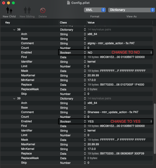

AudioGod Posted May 3, 2021 Author Share Posted May 3, 2021 OpenCore 0.6.9 EFI Update (Big Sur 11.3 Ready), 3rd May 2021 The EFI has now been updated to the my latest version. Changes made include, LucyRTL8125Ethernet 1.1.0 Lilu 1.5.3, AppleALC 1.6.0, WhateverGreen 1.4.9, VirtualSMC 1.2.3, RestrictEvents 1,0,1 SSDT-SBUS-MCHC.aml Rewritten SSDT-SBRG.aml Rewritten agdpmod=pikera has been replaced with agdpmod=ignore OpenCore Updated to Revision 0.6.9 (Big Sur 11.4 Ready), 2.5Ghz Ethernet Auto Negotiation Fixed Memory Mapping is now Being done Via RestrictEvents Plus other minor tweaks and changes to the config. Note 1 - If your not using a 5700 XT or any other Navi/BigNavi GPU then remove agdpmod=ignore from the boot arguments. Note 2 - Do not try to carry across your old OpenCore Config.plist to the new EFI as to many changes have occurred in 0.6.8. Use the new Config.plist instead. For OpenCore Using PlistEdit Pro add your details by modifying the followingFinally and as always, MAKE SURE YOU RESET YOUR NVRAM BEFORE BOOTING INTO THE NEW EFI.OpenCore EFI Update V0.6.9 - 03/05/2021 Asus X570-E 069 EFI.zip 1 Link to comment https://www.insanelymac.com/forum/topic/347305-audiogods-asus-rog-strix-x570-e-big-sur-monterey-beta-opencore-074-efi/#findComment-2757054 Share on other sites More sharing options...
AudioGod Posted June 7, 2021 Author Share Posted June 7, 2021 (edited) OpenCore 0.7.0 EFI Update (Big Sur 11.5 Ready), 7th June 2021 The EFI has now been updated to the my latest version. Changes made include, LucyRTL8125Ethernet 1.1.0 Lilu 1.5.3, AppleALC 1.6.1, WhateverGreen 1.5.0, VirtualSMC 1.2.4, RestrictEvents 1.0.2, HFSPlus Updated, SIP Can now be toggled within OpenCanopy, OpenCanopy Icons Updated, OpenCore Updated to Revision 0.7.0 (Big Sur 11.5 Ready), 2.5Ghz Ethernet Auto Negotiation Fixed, Memory Mapping is now Being done via RestrictEvents, About This Mac now displays the correct AMD Processor info done via RestrictEvents, Plus other minor tweaks and changes to the config. Note 1 - If your not using a 5700 XT or any other Navi/BigNavi GPU then remove agdpmod=ignore from the boot arguments. Note 2 - Do not try to carry across your old OpenCore Config.plist to the new EFI as to many changes have occurred in 0.6.8. Use the new Config.plist instead. Note 3 - If you are using a 6 or Less Core Ryzen then go into the Config,plist and under PlatformInfo->Generic Change the ProcessorType from 0 to 1537, This will list your CPU info correctly inside About This Mac. For OpenCore Using PlistEdit Pro add your details by modifying the following Finally and as always, MAKE SURE YOU RESET YOUR NVRAM BEFORE BOOTING INTO THE NEW EFI.OpenCore EFI Update V0.7.0 - 07/06/2021 Asus X570-E 070 EFI .zip Edited June 7, 2021 by AudioGod Link to comment https://www.insanelymac.com/forum/topic/347305-audiogods-asus-rog-strix-x570-e-big-sur-monterey-beta-opencore-074-efi/#findComment-2760054 Share on other sites More sharing options...

AudioGod Posted August 2, 2021 Author Share Posted August 2, 2021 OpenCore 0.7.2 EFI Update (Monterey 12.0 Beta 4 Ready), 2nd August 2021 The EFI has now been updated to the my latest version. Changes made include, LucyRTL8125Ethernet 1.1.0 Lilu 1.5.5, AppleALC 1.6.3, WhateverGreen 1.5.2, VirtualSMC 1.2.6, RestrictEvents 1.0.3, SMCAMDProcessor 0.7 New Universal AMD Patches Monterey 12.0 Beta4 Compatible, SIP Can now be toggled within OpenCanopy, OpenCanopy Icons Updated, OpenCore Updated to Revision 0.7.2 (Monterey Beta 4 Ready), 2.5Ghz Ethernet Auto Negotiation Fixed, Memory Mapping is now Being done via RestrictEvents, About This Mac now displays the correct AMD Processor info done via RestrictEvents, Plus other minor tweaks and changes to the config. Note 1 - If your not using a RX 6800 or any other Navi/BigNavi GPU then remove agdpmod=ignore from the boot arguments. Note 2 - If you are using Catalina then in the Config.plist under Misc->Security Change SecureBootModel=Default to j160 or Catalina will not boot. Note 3 - If you are using a 6 or Less Core Ryzen then go into the Config,plist and under PlatformInfo->Generic Change the ProcessorType from 0 to 1537, This will list your CPU info correctly inside About This Mac. Note 4 - The SmallTreeIntel82576.kext is not working under Monterey 12.0 so if you plan on playing around with the new OS for now make sure you use the 2.5GHz ethernet port instead. For OpenCore Using PlistEdit Pro add your details by modifying the following IMPORTANT PATCH INFO TO SET THE CORRECT CORE COUNT FOR YOUR CPU Core Count patch needs to be modified to boot your system. Find the two algrey - Force cpuid_cores_per_package patches and alter the Replace value only. Changing BA000000 0000/BA000000 0090* to BA <CoreCount> 0000 0000/BA <CoreCount> 0000 0090* substituting <CoreCount> with the hexadeciamal value matching your physical core count. Note: The three different values reflect the patch for different versions of macOS. Be sure to change all three if you boot macOS 10.13 to macOS 12 See the table below for the values matching your CPU Core Count. CoreCount Hexadecimal 6 Core 06 8 Core 08 12 Core 0C 16 Core 10 32 Core 20 So for example a 6 Core 5600X would result in these replace values, BA 06 0000 0000/BA 06 0000 0090 Or a 12 Core 5900X that I have it setup as standard would result in these replace values, BA 0C 0000 0000/BA 0C 0000 009012 Core EXAMPLE Finally and as always, MAKE SURE YOU RESET YOUR NVRAM BEFORE BOOTING INTO THE NEW EFI.OpenCore EFI Update V0.7.2 - 02/06/2021 Asus X570-E 072 EFI .zip 3 Link to comment https://www.insanelymac.com/forum/topic/347305-audiogods-asus-rog-strix-x570-e-big-sur-monterey-beta-opencore-074-efi/#findComment-2764118 Share on other sites More sharing options...

AudioGod Posted September 7, 2021 Author Share Posted September 7, 2021 OpenCore 0.7.3 EFI Update (Monterey 12.0 Beta 6 Ready), 7th September 2021 The EFI has now been updated to the my latest version. Changes made include, LucyRTL8125Ethernet 1.1.0 Lilu 1.5.6, AppleALC 1.6.4, WhateverGreen 1.5.3, VirtualSMC 1.2.7, RestrictEvents 1.0.4, SMCAMDProcessor 0.7 New Universal AMD Patches Monterey 12.0 Beta 6 Compatible, SIP Can now be toggled within OpenCanopy, OpenCanopy Icons Updated, OpenCore Updated to Revision 0.7.3 (Monterey Beta 6 Ready), 2.5Ghz Ethernet Auto Negotiation Fixed, Memory Mapping is now Being done via RestrictEvents, About This Mac now displays the correct AMD Processor info done via RestrictEvents, Plus other minor tweaks and changes to the config. Note 1 - If your not using a RX 6800 or any other Navi/BigNavi GPU then remove agdpmod=ignore from the boot arguments. Note 2 - If you are using Catalina then in the Config.plist under Misc->Security Change SecureBootModel=Default to j160 or Catalina will not boot. Note 3 - If you are using a 6 or Less Core Ryzen then go into the Config,plist and under PlatformInfo->Generic Change the ProcessorType from 0 to 1537, This will list your CPU info correctly inside About This Mac. Note 4 - The SmallTreeIntel82576.kext is not working under Monterey 12.0 so if you plan on playing around with the new OS for now make sure you use the 2.5GHz ethernet port instead. For OpenCore Using PlistEdit Pro add your details by modifying the following IMPORTANT PATCH INFO TO SET THE CORRECT CORE COUNT FOR YOUR CPU Core Count patch needs to be modified to boot your system. Find the two algrey - Force cpuid_cores_per_package patches and alter the Replace value only. Changing BA000000 0000/BA000000 0090* to BA <CoreCount> 0000 0000/BA <CoreCount> 0000 0090* substituting <CoreCount> with the hexadeciamal value matching your physical core count. Note: The three different values reflect the patch for different versions of macOS. Be sure to change all three if you boot macOS 10.13 to macOS 12 See the table below for the values matching your CPU Core Count. CoreCount Hexadecimal 6 Core 06 8 Core 08 12 Core 0C 16 Core 10 32 Core 20 So for example a 6 Core 5600X would result in these replace values, BA 06 0000 0000/BA 06 0000 0090 Or a 12 Core 5900X that I have it setup as standard would result in these replace values, BA 0C 0000 0000/BA 0C 0000 009012 Core EXAMPLE Finally and as always, MAKE SURE YOU RESET YOUR NVRAM BEFORE BOOTING INTO THE NEW EFI.OpenCore EFI Update V0.7.3 - 07/09/2021 Asus X570-E 073 EFI .zip Link to comment https://www.insanelymac.com/forum/topic/347305-audiogods-asus-rog-strix-x570-e-big-sur-monterey-beta-opencore-074-efi/#findComment-2765834 Share on other sites More sharing options...
