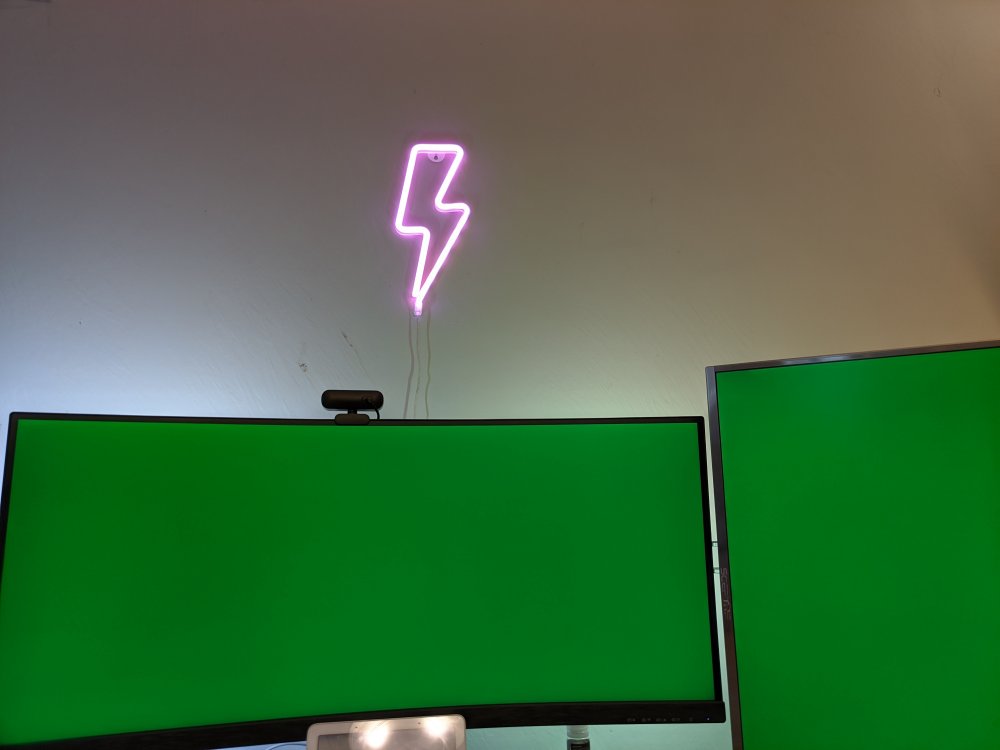

tmeuze Posted March 25, 2021 Share Posted March 25, 2021 Hi all, My 0.6.7 OC build is working almost perfectly, except I am getting graphical glitches and regular "green screen of death" issues that make my computer completely unresponsive. The glitches and short occurrences of the green screen happen mostly when switching Mission Control spaces, but eventually and increasingly frequently, an unrecoverable GSoD will happen out of the blue. This will occur on both of my monitors (1x DP, 1x HDMI). Unplugging and plugging them back in produces the same result. USB devices such as my wireless mouse will disconnect. The only resolution is to forcefully power cycle my machine. This used to happen maybe once a week, and I used to accept it as a side-effect of hackintoshing. After increasing frequency and frustration (at least 3x per day now), I upgraded from OpenCore 0.6.3 -> 0.6.7, with a brand-new config.plist, built manually word-for-word from the guide, hoping it would fix the issue. I have also tried switching to @AudioGod's EFI here, but the issue persists. Anyone here experienced this or have found a fix? You would think this is a GPU hardware issue (and it still may be), but I cannot reproduce it in Windows, despite stress tests and long gameplay. Nothing interesting in the system log, and no kernel panic. Boot args are: keepsyms=1 agdpmod=pikera ncpi=0x2000 (I added ncpi=0x2000 on recommendation from a Reddit thread about a similar issue) I appreciate any help or insight with this. Quote Link to comment https://www.insanelymac.com/forum/topic/347165-green-screen-of-death-radeon-rx-5700-xt-opencore-067-big-sur/ Share on other sites More sharing options...
AudioGod Posted March 25, 2021 Share Posted March 25, 2021 (edited) Check for this issue https://spin.atomicobject.com/2018/08/24/macbook-pro-external-monitor-display-problem/ If it’s not that then try this https://github.com/Pavo-IM/AGPMInjector And if your going to use the boot argument ncpi=0x2000 then make sure above 4g is disabled in the bios. Never run both. Edited March 25, 2021 by AudioGod 1 Quote Link to comment https://www.insanelymac.com/forum/topic/347165-green-screen-of-death-radeon-rx-5700-xt-opencore-067-big-sur/#findComment-2753877 Share on other sites More sharing options...
tmeuze Posted March 26, 2021 Author Share Posted March 26, 2021 17 hours ago, AudioGod said: Check for this issue https://spin.atomicobject.com/2018/08/24/macbook-pro-external-monitor-display-problem/ If it’s not that then try this https://github.com/Pavo-IM/AGPMInjector And if your going to use the boot argument ncpi=0x2000 then make sure above 4g is disabled in the bios. Never run both. Thank you so much for your response. I don't believe the EDID issue applies to me. I'd never heard of AGPMInjector; I am booting with this now, and will update this thread with the results. Thanks, again. Quote Link to comment https://www.insanelymac.com/forum/topic/347165-green-screen-of-death-radeon-rx-5700-xt-opencore-067-big-sur/#findComment-2753934 Share on other sites More sharing options...

tmeuze Posted March 30, 2021 Author Share Posted March 30, 2021 Hi @AudioGod, thanks again for your help. New symptom now - instead of green screens, I now just get completely blank/black screens. What I've tried so far includes: EDID Patching AGPMInjector kext Reseating GPU power cables Clearing NVRAM I will say, it seems to be less frequent than before, so I've got that going for me. Any other possible causes or ideas on this? Thank you, Quote Link to comment https://www.insanelymac.com/forum/topic/347165-green-screen-of-death-radeon-rx-5700-xt-opencore-067-big-sur/#findComment-2754280 Share on other sites More sharing options...
