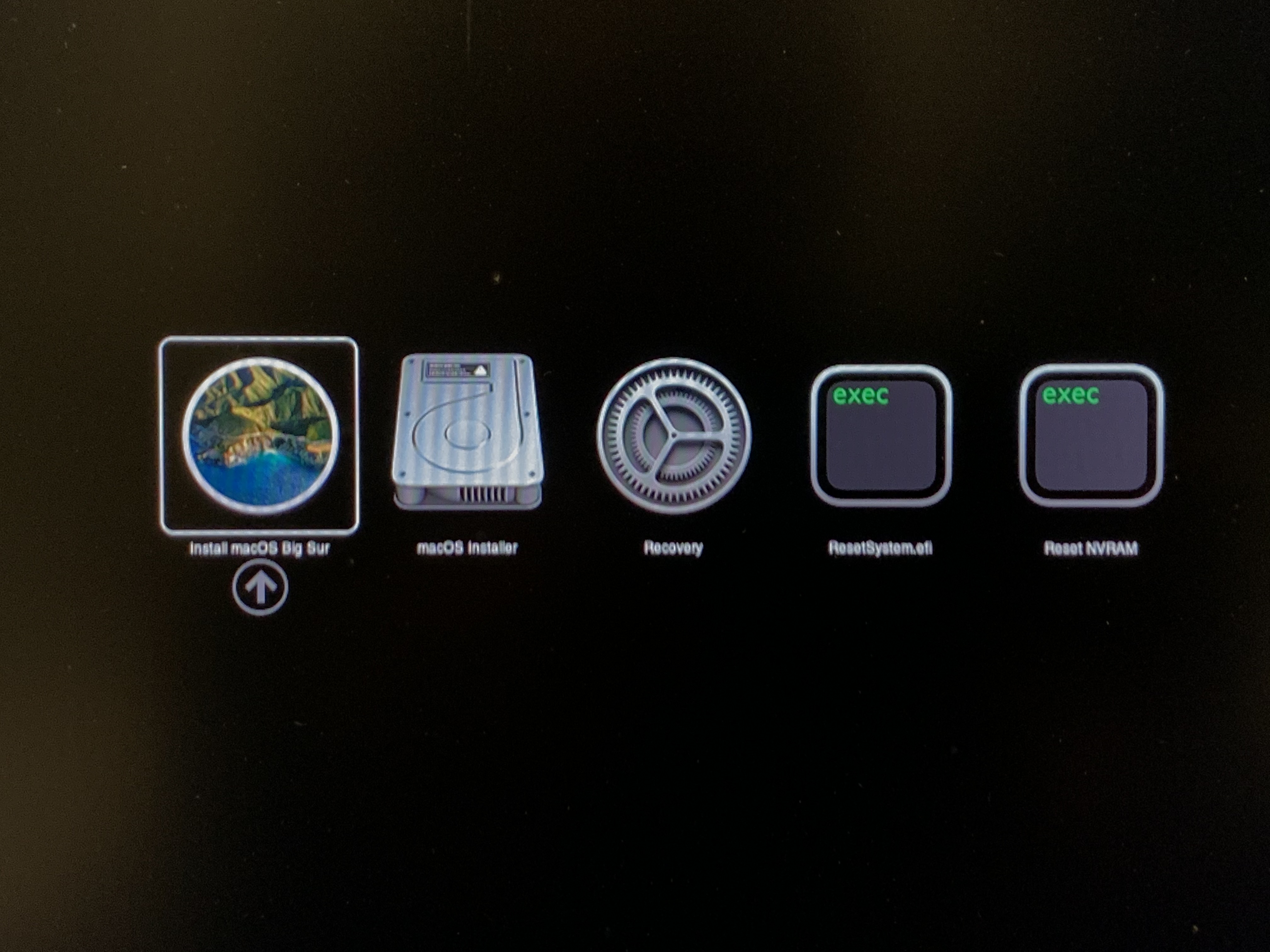

xthunder Posted January 24, 2021 Author Share Posted January 24, 2021 Yes.... The Picker looks like this: After the initial installation is done, the default Picker should be on the "macOS Installer" but it comes up with "Install macOS Big Sur" so I hit right arrow and boot up with "macOS Installer".... Some times, it would reboot before GUI with Apple logo comes up... Some times, it would go on with GUI with Apple logo but about 1/6th way(progress bar), it would reboot... I am keep choosing "macOS Installer" every time it reboots but it does pretty much the same.... Link to comment Share on other sites More sharing options...

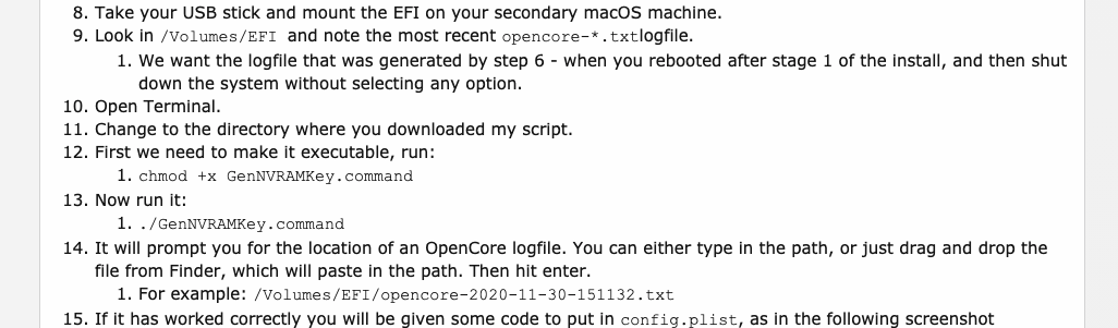

ANTIKO Posted January 24, 2021 Share Posted January 24, 2021 Most likely you have a problem with NVRAM. I have prepared the files for you, follow this link. https://www.tonymacx86.com/threads/x299-big-sur-support.302143/page-107#post-2203225 Архив.zip Link to comment Share on other sites More sharing options...
ANTIKO Posted January 24, 2021 Share Posted January 24, 2021 (edited) 10 minutes ago, Антико said: Скорее всего у вас проблема с NVRAM. Я подготовил для вас файлы, по этой ссылке. https://www.tonymacx86.com/threads/x299-big-sur-support.302143/page-107#post-2203225 Архив.zip 1,99 МБ · 1 загрузка If you are not able to perform these steps and send me the file. Edited January 24, 2021 by Антико Link to comment Share on other sites More sharing options...
xthunder Posted January 24, 2021 Author Share Posted January 24, 2021 I was able to obtain: <key>msu-product-url</key> <data>bXN1LXByb2R1Y3QtdXJsOi8vRjgxRTQ5Q0EtOUQ0Qy00QTRCLUFCMUYtNDBBRTM0NjkyQzE2L21hY09TJTIwSW5zdGFsbCUyMERhdGE=</data> (for my setup, of course) from OpenCore debug file(s) - one thing that I have to change in the GenNVRAMKey is 'python' -> 'python2' since on my system python is default to python3 and it was giving me an error: encoded = binascii.b2a_base64(s, newline=False) TypeError: a bytes-like object is required, not 'str' I am about to try continuing the installation with updated config.plist. Wish me luck! 1 Link to comment Share on other sites More sharing options...

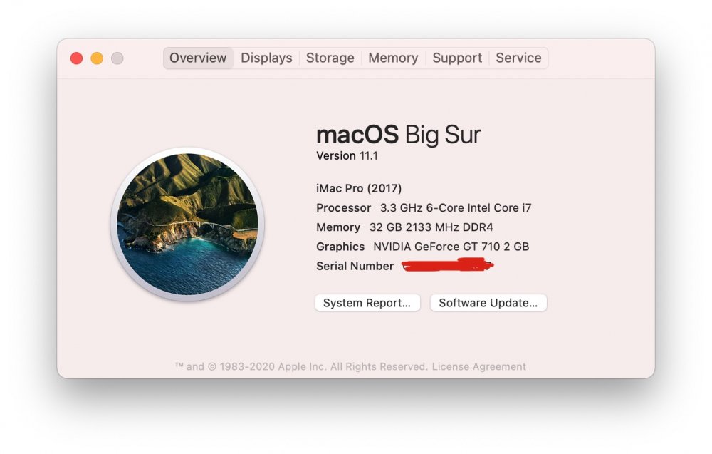

xthunder Posted January 29, 2021 Author Share Posted January 29, 2021 Thank you everyone!!!!! Especially @Антико!!!! I had to complete the initial install on other computer and move it back into Asus X99-A II/i7-5820k/GT710 but it is finally working correctly so far. I am currently using Opencore 0.6.5 The NVMe showed up as external disk so I have to find the device path and add that to config.plist and now it shows up as internal HD. So far everything seems to be working fine AirDrop works fine with FV-T919 I still have to finish configuring a few more things and once I get everything sorted out I will post my EFI so others can use it as a reference. Thanks again!!!! 1 Link to comment Share on other sites More sharing options...
xthunder Posted February 4, 2021 Author Share Posted February 4, 2021 Hello All, So I have been running with the attached OC-0.6.5 based EFI on my X99-A II for almost a week now without any issue. I had to get the Big Sur(11.1) installed on a Skylake machine and after fully configured, I brought it over to X99-A II with the attached EFI. Again, I really appreciate all the help that @Антико provided!!! I almost gave up on it LOL Everything works great including AirDrop with Fenvi FV-T919! Only complain waking up from sleep takes a bit more time than I would like - the machine itself powers up quickly and all but it takes 15-20 seconds for the screen to show up.... AND... I am still trying to find a good set of Serial/Board Serial/smUUID... I have been trying but since I am looking for a valid(?) set for iMacPro1,1, it is just really hard to find a set. And it seems like Apple has blocked my WAN IP from checkcoverage site so it is harder for me to check LOL Thank you and I hope my reference EFI(attached) helps for anyone else who has X99-A II with similar problem. EFI.zip 1 Link to comment Share on other sites More sharing options...
