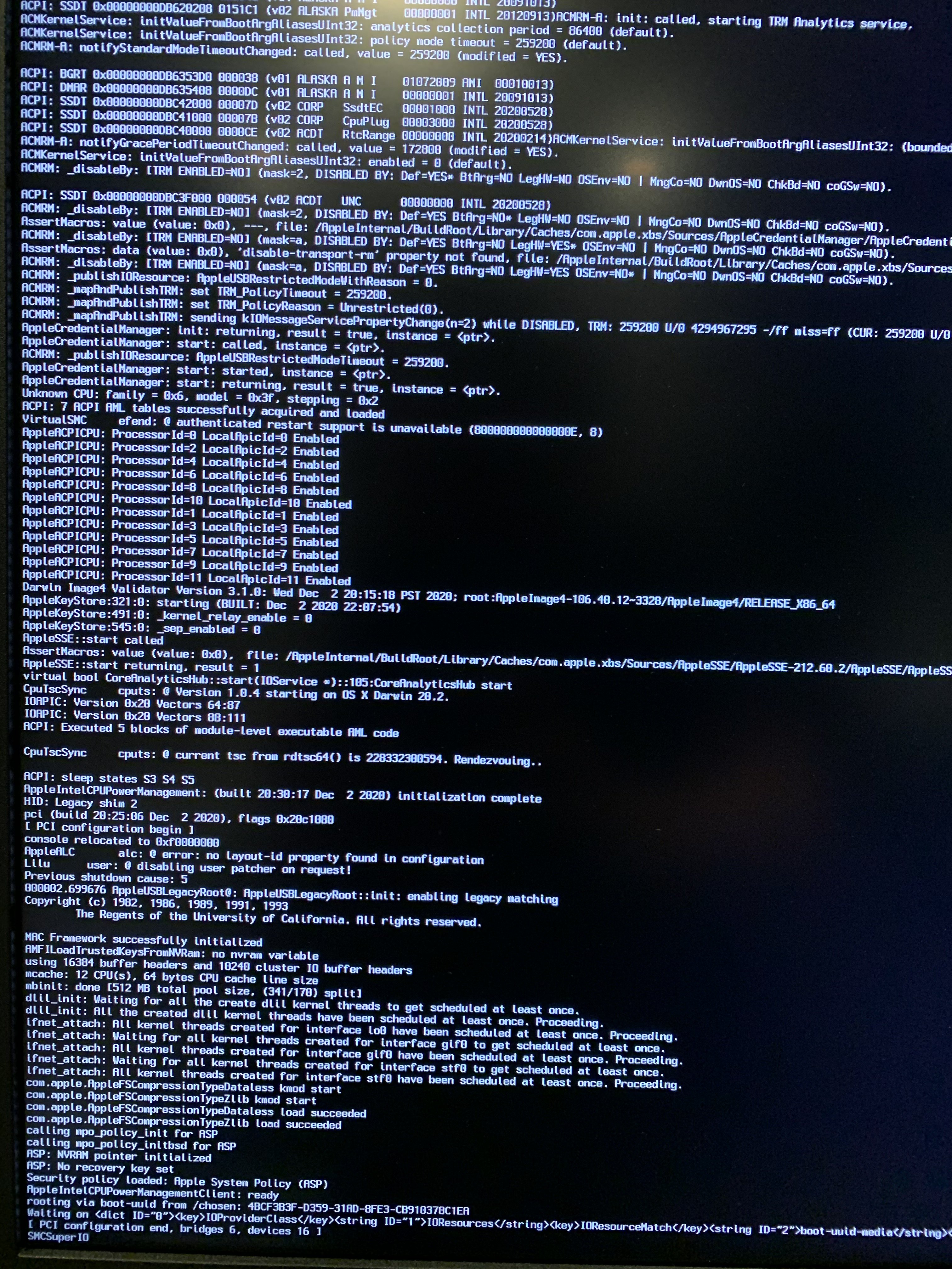

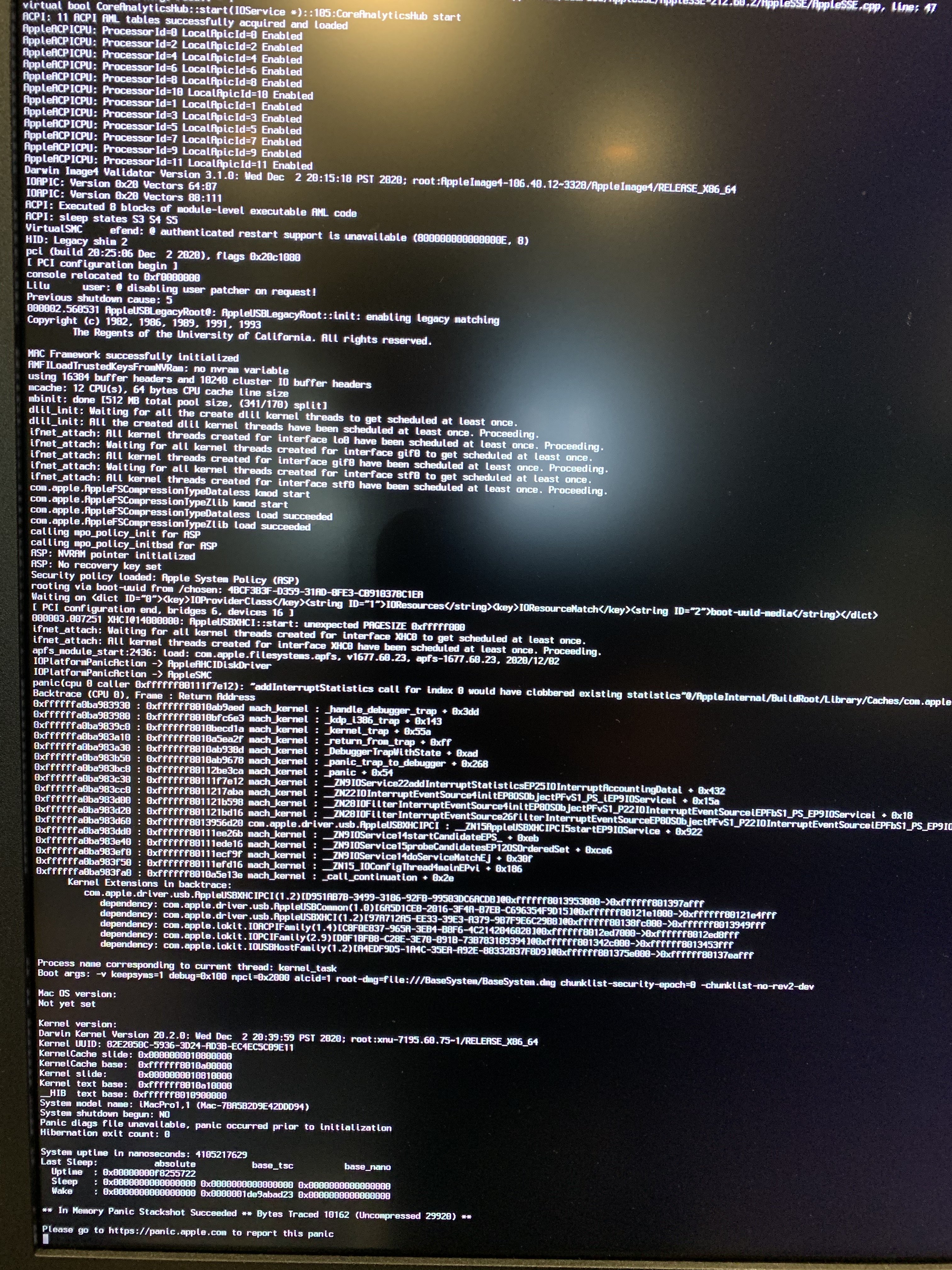

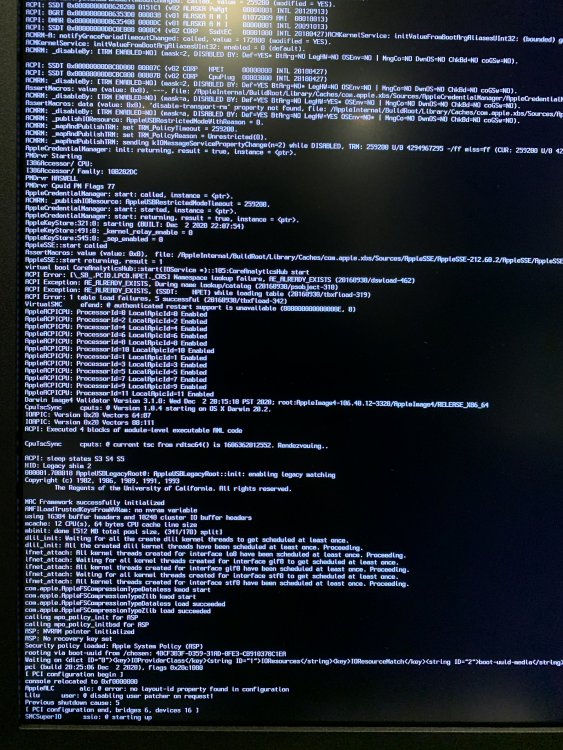

xthunder Posted January 20, 2021 Share Posted January 20, 2021 (edited) Hello All, I am trying to Big Sur 11.1 on Asus X99-A II with i7-5820k Haswell-E & GeForce GT720 and getting the panic (screenshot attached) I am also attaching the EFI/OC dir with config.plist and the latest opencore log from the EFI partition. I have followed Dortania's guide after capturing DSDT from Windows 10 and create all ACPI/aml files. It gets stuck after "[PCI configuration end, bridges 6, devices 16]" then short after it says: IOPlatformPanicAction -> ApleAHCIDiskDriver IOPlatformPanicAction -> AppleSMC I added "CtlnaAHCIPort.kext" and tried to switch FakeSMC from VirtualSMC but pretty much same result. I tried with different USB port but the same... Now, I originally tried with Crucial P1 M.2 2280 500GB nVME but now I moved to SATA SSD but still the same. I also have removed Fenvi FV-T919, just to see if I can get the OS to install... Any help will be appreciated. Thank you. Asus X99-A II i7-5820k G.Skill Ripjaws V DDR4 2400MHz 4*16GB Nvidia GeForce GT720 Fenvi FV-T919 config.plist opencore-2021-01-20-115003.txt OC.zip Edited January 20, 2021 by xthunder Link to comment Share on other sites More sharing options...

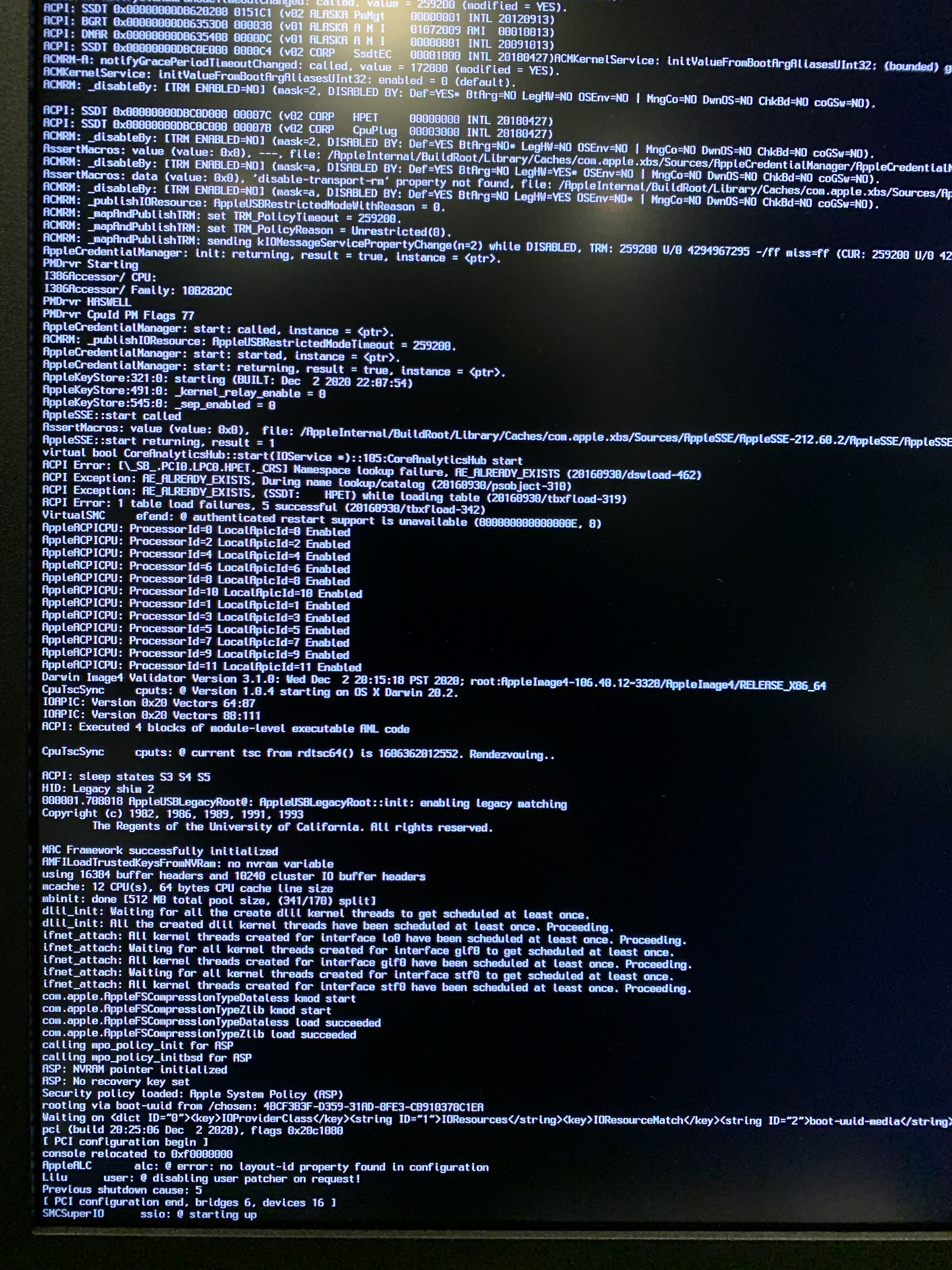

xthunder Posted January 21, 2021 Author Share Posted January 21, 2021 Thank you for your reply and here is what I am getting with your EFI... It just sits on "SMCSuperIO" line... Link to comment Share on other sites More sharing options...

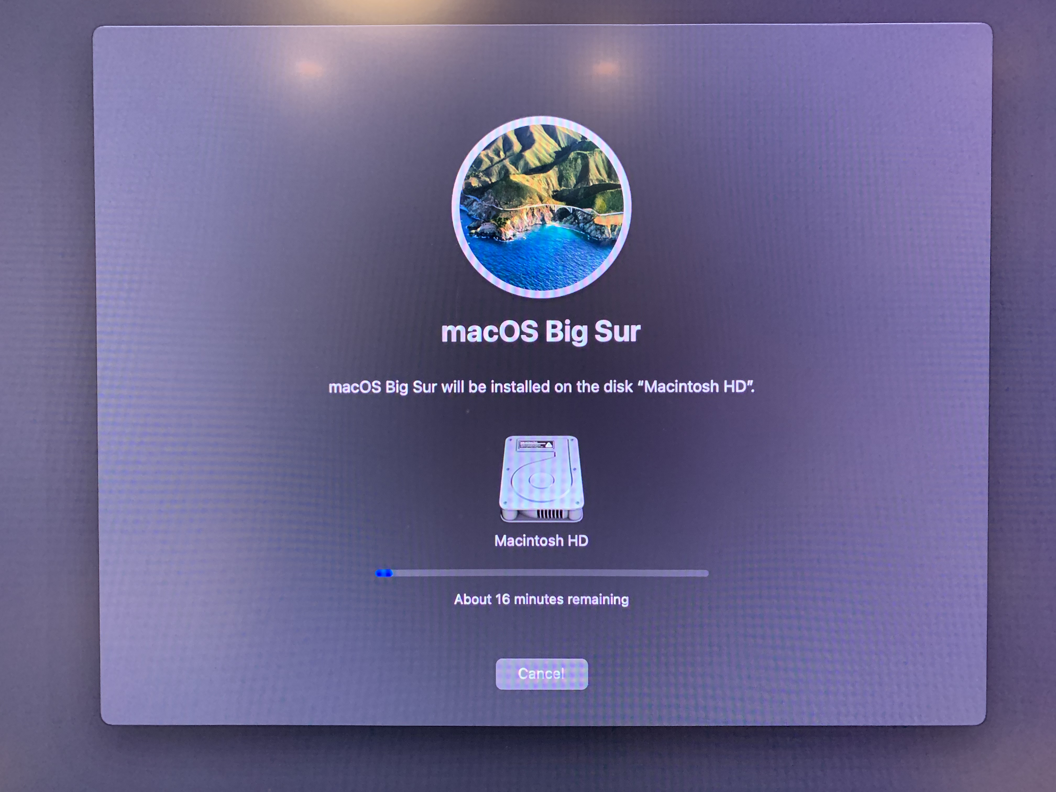

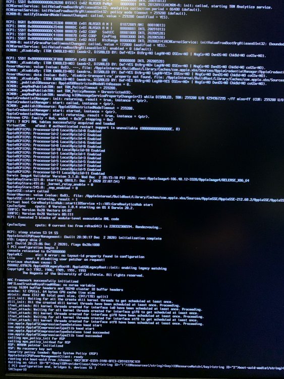

xthunder Posted January 22, 2021 Author Share Posted January 22, 2021 Hello Антико, Some progress - after disabling "Above 4G Decoding", I was able to initiate the install: However, after choosing "macOS Installer", I see several page worth of verbose messages then it reboots.... I tried "macOS Installer" from the picker over and over and a few times, it would show Apple Logo with the progress bar and the bar would go about 1/5 way then reboots.... then it does the same over and over.... pages of verbose text then reboots.... and again... Any other idea? Link to comment Share on other sites More sharing options...

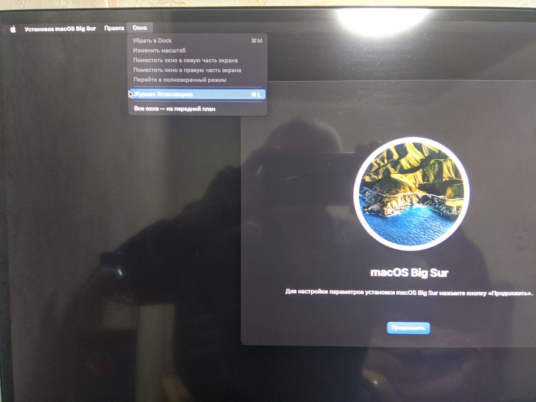

xthunder Posted January 22, 2021 Author Share Posted January 22, 2021 Hello Антико, Since it is after Open Core USB installation, I would assume that the Apple Installer Log file is location on the SSD... I just attached the SSD from another Hackintosh but there is only one disk volume(?) called "Macintosh HD" in "Containder disk" and the that only has one directory called "macOS Install Data" but I do not see any log file... Do you know where the Apple Installer Log file is located on the disk? So it seems like that USB Big Sur Installer finishes successfully since it goes as far as like 12 mins left message then shows proper shutting down messages and reboot. I noticed that the Open Core Picker does not automatically selects the "macOS Installer" so I hit the right arrow once to have it boot up with "macOS Installer" and this is where it reboots after pages of verbose messages... before Apple Logo with progress bar... Let me know the location of the Apple Installer Log or anything else to try. Thank you! Link to comment Share on other sites More sharing options...
ANTIKO Posted January 22, 2021 Share Posted January 22, 2021 (edited) 5 minutes, I'll make a screenshot))) Save only the errors, on a flash drive, on another SSD. Edited January 22, 2021 by Антико Link to comment Share on other sites More sharing options...

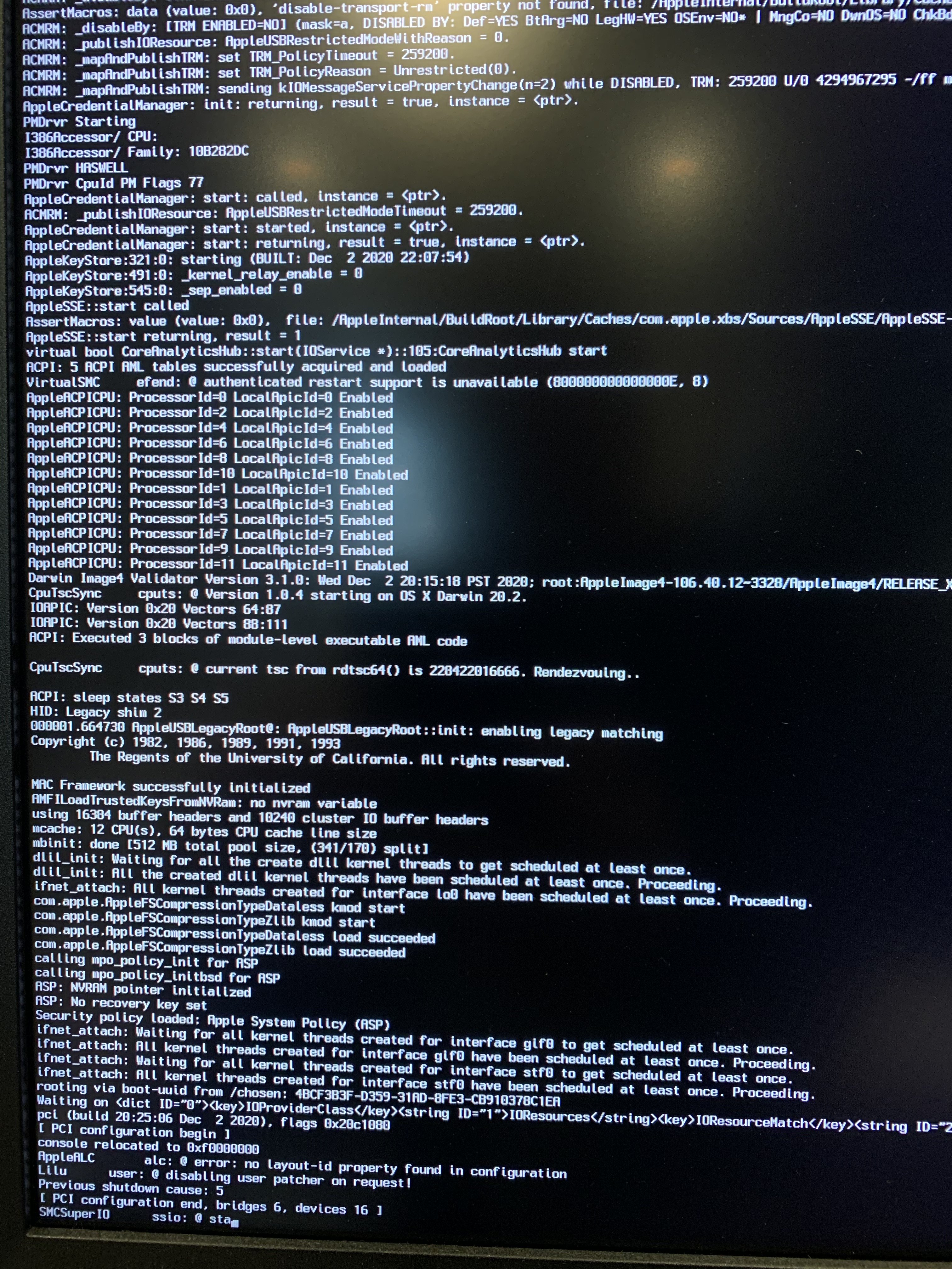

xthunder Posted January 23, 2021 Author Share Posted January 23, 2021 Hello Антико, I just did a reinstall of Big Sur while capturing the Installer log onto different USB. The log file is attached... When I choose "macOS Installer" icon(2nd from the left) from the Picker, after pages of verbose text messages, it seems like it will go as it shows the Apple logo with progress bar under... It will go as far as about 1/6th way then it will reboot.... If it choose "macOS Installer" again, it will reboot while displaying verbose text messages before the Apple logo comes up.... Thank you. Installer Log 22-Jan-2021.txt Link to comment Share on other sites More sharing options...

xthunder Posted January 23, 2021 Author Share Posted January 23, 2021 (edited) This EFI is not good..... The picker only shows the USB and the HD(which still has the Install macOS from previous try) and what makes worse is that it shows pages of verbose text messages then just reboots - video attached.... (The video quality sucks since I have to reduce the size to below 10MB....) IMG_0089.mp4 Edited January 23, 2021 by xthunder Link to comment Share on other sites More sharing options...
