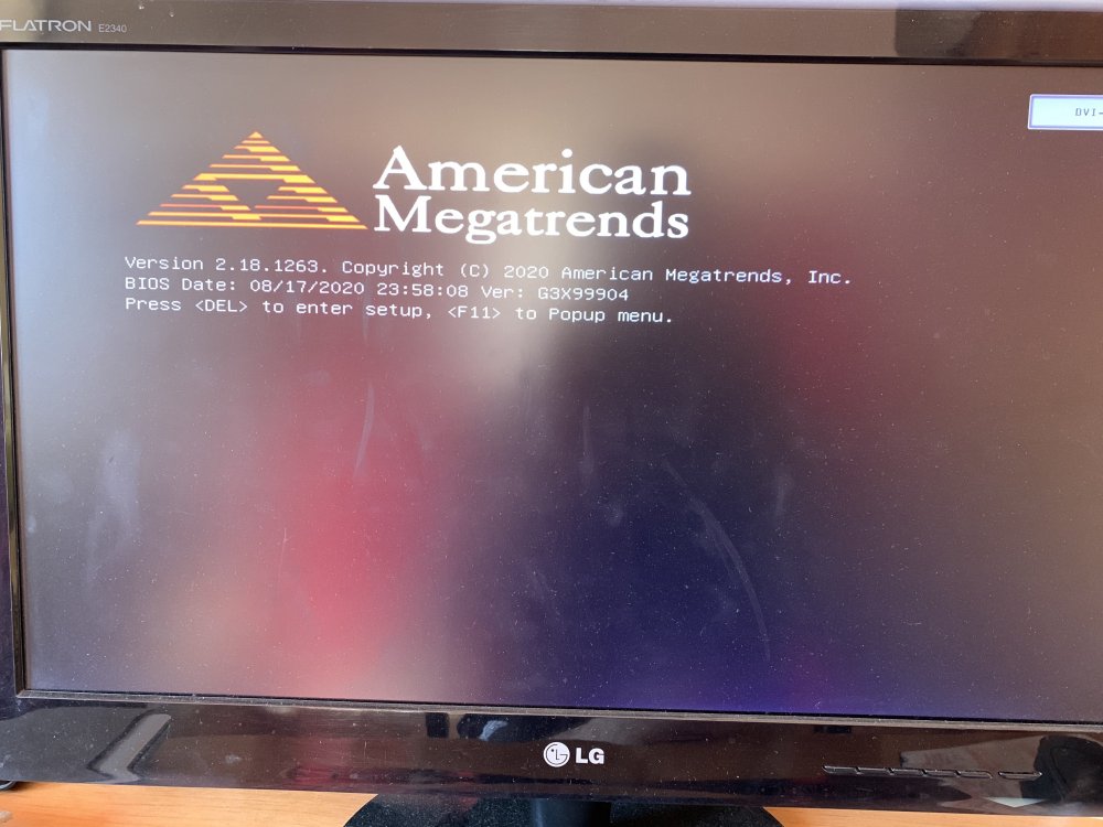

razor7 12 Posted December 12, 2020 Posted December 12, 2020 (edited) Hi! After reading the whole OpenCore Install Guide I was able to install BigSur on my rig: Huananzhi X99 F8 (See picture) Intel Xeon E5-2680 v4 64 GB RAM ECC Aorus RX580 8GB NVNe Samsung 970 Evo Plus 500GB NVNe Kingston SA2000M81000G 1TB Uploaded EFI folders are, one for the install USB (with full debug enabled and logging to file in the USB stick) and the other for the post install EFI overwrite. It lacks cosmetics for OpenCore. BIOS settings I was able to find in my BIOS (? means not found): Disable - Fast Boot - Secure Boot - Serial/COM Port ? Parallel Port - VT-d (can be enabled if you set DisableIoMapper to YES) - CSM ? Thunderbolt ? Intel SGX ? Intel Platform Trust - CFG Lock (MSR 0xE2 write protection) CodeRush's UEFI patch Enable - VT-x - Above 4G decoding ? Hyper-Threading - Execute Disable Bit - EHCI/XHCI Hand-off ? OS type: Windows 8.1/10 UEFI Mode ? DVMT Pre-Allocated(iGPU Memory): 64MB - SATA Mode: AHCI In the step Making the installer on MacOS (I created the install USB from another hackintosh with High Sierra) I had to run this command, because BigSur is not documented there: Quote sudo /Applications/Install\ macOS\ Big\ Sur.app/Contents/Resources/createinstallmedia --volume /Volumes/MyVolume PS: I strongly recommend newcomers like me to read the full OpenCore install guide https://dortania.github.io/OpenCore-Install-Guide/ At the ACPI step, create each file manually, it's not so difficult and you get tailored ACPI files EFIs.zip Edited December 12, 2020 by razor7 miliuco, nmano and vinhkm6 2 1 Share this post Link to post Share on other sites

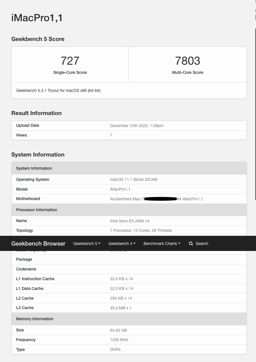

AslashA 17 Posted December 24, 2020 Posted December 24, 2020 Can you show the Geekbench result? Share this post Link to post Share on other sites
razor7 12 Posted December 24, 2020 Posted December 24, 2020 Here in Hackintosh Share this post Link to post Share on other sites
AslashA 17 Posted December 27, 2020 Posted December 27, 2020 You've got the processor power management in the wrong way. The results should be higher! For comparison, look at my result. Share this post Link to post Share on other sites
razor7 12 Posted December 27, 2020 Posted December 27, 2020 Hi! Thanks for sharing, I get the same result in macOS and Windows 10, what can I do to improve the score? Share this post Link to post Share on other sites
AslashA 17 Posted December 28, 2020 Posted December 28, 2020 Hmm. It's strange that you have so few points in Windows too. You probably need to check your BIOS settings. Share this post Link to post Share on other sites
razor7 12 Posted December 28, 2020 Posted December 28, 2020 Ok, any ideas where to tweak BIOS? Share this post Link to post Share on other sites
