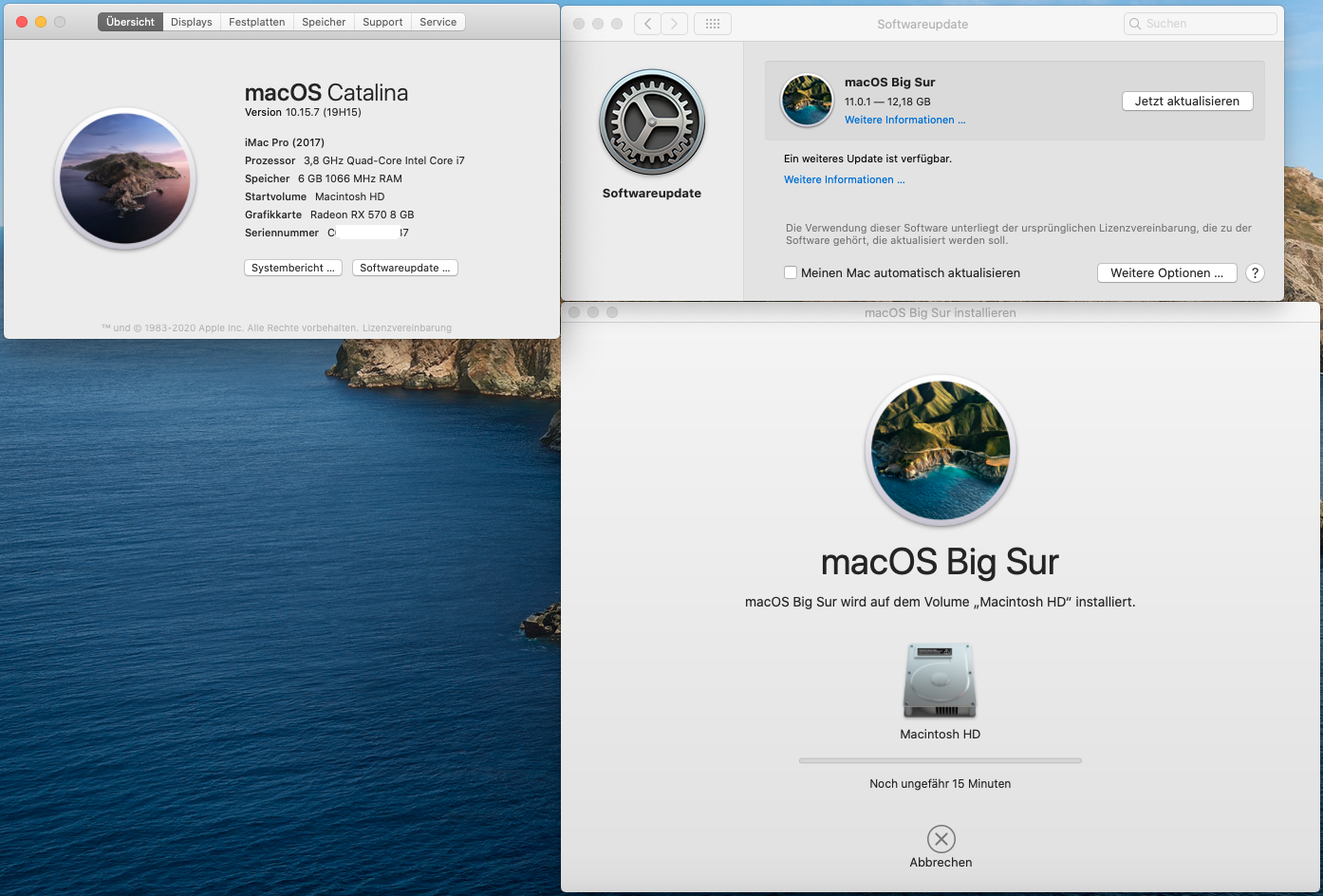

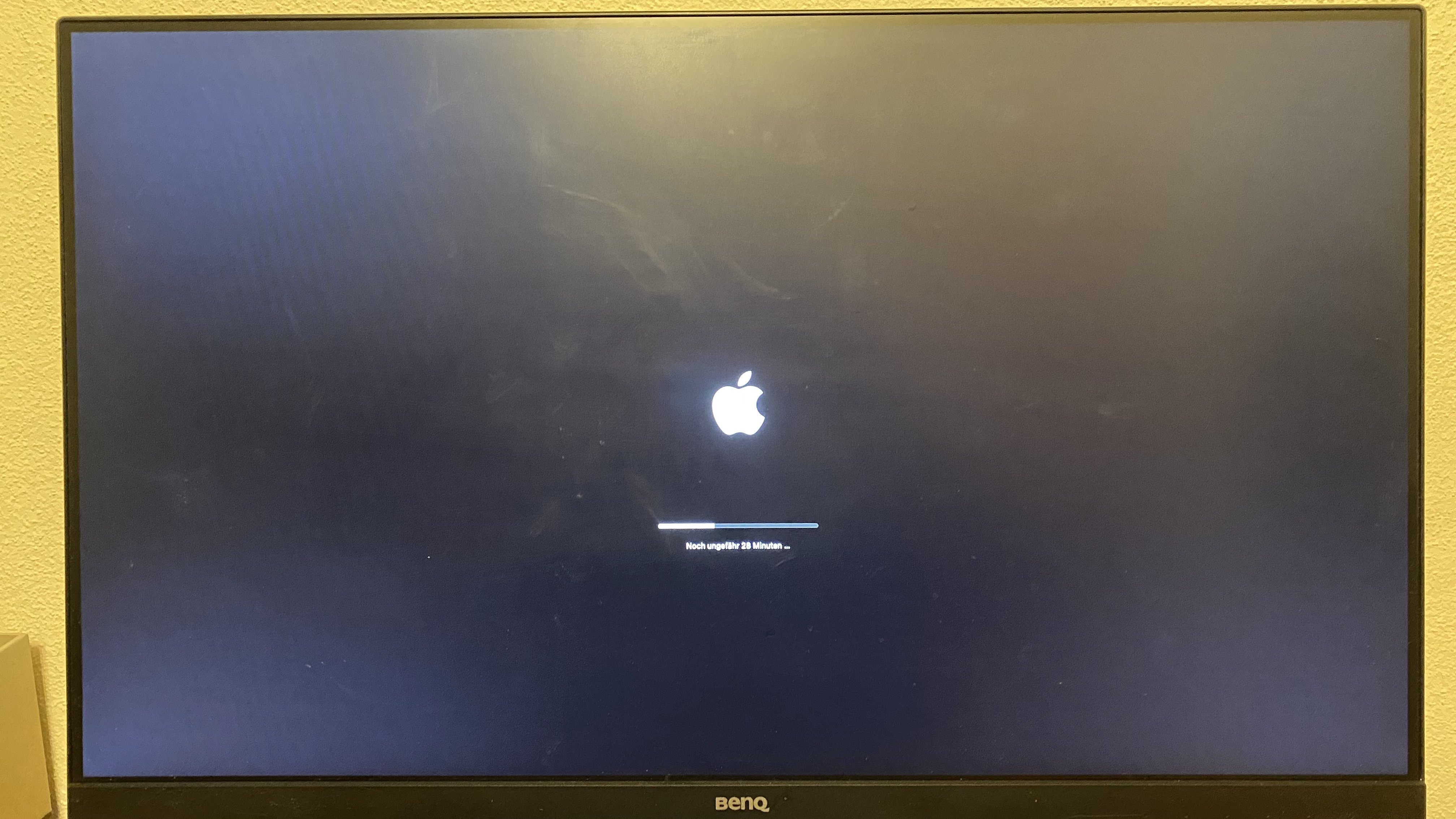

pac-man Posted November 29, 2020 Share Posted November 29, 2020 (edited) I have legacy system (ASUS Rampage III / i7 920 CPU) with a working Catalina System running and previously booted by Clover. Since the last days I have switched to OpenCore and finally now I have a working legacy System booted by OpenCore. Nearly everything is working but I can't upgrade to Big Sur. In the System Software-Update Preferences I have downloaded the Big Sur Upgrade and have started the Upgrade Process. After the first restart a new partition "macOS Installer" was found and this volume I had selected for continuing the upgrade Progress. Sadly the upgrade ends to a "endless reboot without progress" and I don't know why.... What I have done so far: 1. Working Catalina with Upgrade Process startet 2. My used EFI: EFI.zip Note: Folders Microsoft and Resources cleared due to upload file size limit... 4. Opencore Logfile: opencore.txt Does anyone knew why my system won't upgrade? Regards pac-man Edited November 29, 2020 by pac-man 1 Link to comment Share on other sites More sharing options...

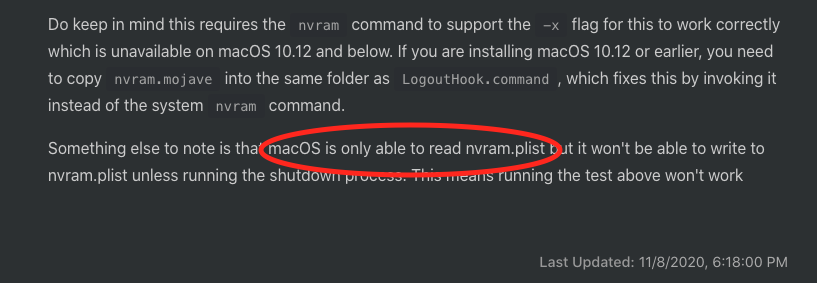

pac-man Posted December 1, 2020 Author Share Posted December 1, 2020 Wow, thats really hard. This means that legacy systems without native NVRAM will no longer be able to upgrade to Big Sur...? What about this statement? Is there a difference between macOS and the installer? Is the installer not be able to read the nvram.plist as mentioned? Link to comment Share on other sites More sharing options...
1Revenger1 Posted December 1, 2020 Share Posted December 1, 2020 There are no shutdown hooks in the installer that can be used to save into the nvram.plist. So reading works just fine, but it fails to write on shutdown since there aren't logout hooks we can use to actually write nvram.plist. @pac-man 1 Link to comment Share on other sites More sharing options...

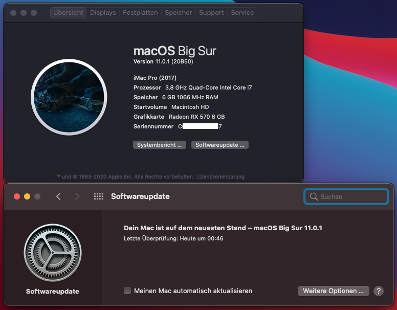

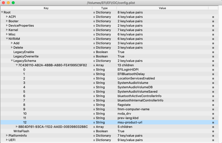

pac-man Posted December 3, 2020 Author Share Posted December 3, 2020 (edited) Please mark topic as solved... Positive news for all other people with same problem! I have found the final solution to be able to upgrade from Catalina to BigSur on the legacy system itself: 1. You have to have a working "Emulated NVRAM" as described here: https://dortania.github.io/OpenCore-Post-Install/misc/nvram.html 2. Add the additional value "msu-product-url" to the "LegacySchema" section under "7C436110-AB2A-4BBB-A880-FE41995C9F82" 3. Add the necessary value to the NVRAM using following command: sudo nvram msu-product-url="msu-product-url://$(diskutil info /System/Volumes/Data | grep "Volume UUID" | awk '{print $3}')/macOS%2520Install%2520Data" 4. Upgrade to BigSur from inside Catalina 5. The system restarts now to a working updater 6. After several restarts the system is updated to BigSur 7. Remove NVRAM variable and previous added OC config Entry "msu-product-url" 8. Have Fun with BigSur Edited December 3, 2020 by pac-man 4 1 Link to comment Share on other sites More sharing options...
