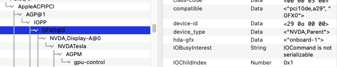

Try the attached SSDT to enable Nvidia GPU on OC.
Copy the attached file SSDT-GFX0-210.aml to EFI/OC/ACPI
Copy the attached file config.plist to EFI/OC
config.plist
SSDT-GFX0-210.aml

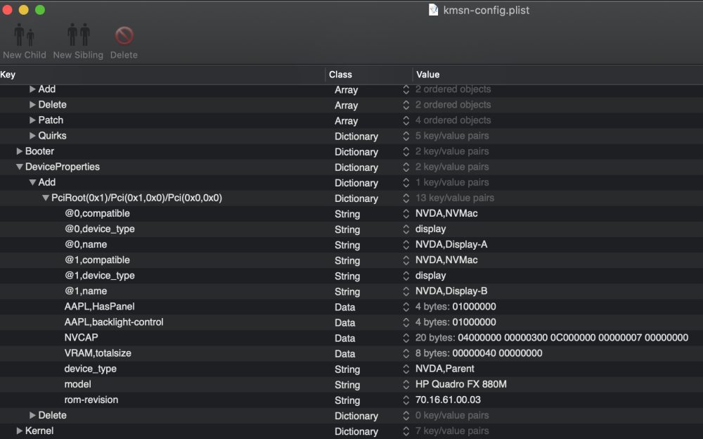

Your config.plist file does NOT match the IOREG output.
That is, the IOREG file shows that your Mac is a MacBook Pro 16,3 but your config.plist file shows that you are using iMacPro1,1.
It appears that you have taken someone's desktop config file for your laptop.
E.g. in the ACPI section, you are adding SSDT-PMC.aml but that is usually for a desktop system with Z370 chipset :unsure:
Model ID has a large impact on Graphics and CPU power management.
MacBookPro16,3 is a strange choice for such an old i5 520M CPU - especially for power management and battery life.
For your laptop you should be using MacBookPro6,2 - but that does not support Catalina so you could try -no_compat_check boot-args.
If MacBookPro16,3 works for you then good luck.
I am surprised that you have working system with Quadra FX880M since that GPU is based on GT216M chip and only supported up to High Sierra I think. But then I do not have experience of Nvidia on laptops.
Any way, based on the IOREG you posted, I have added Device properties for your FX880M and changed the SystemProductName to MacBookPro16,3. You need to Fill In the missing platformInfo fields and try it.
kmsn-config.plist

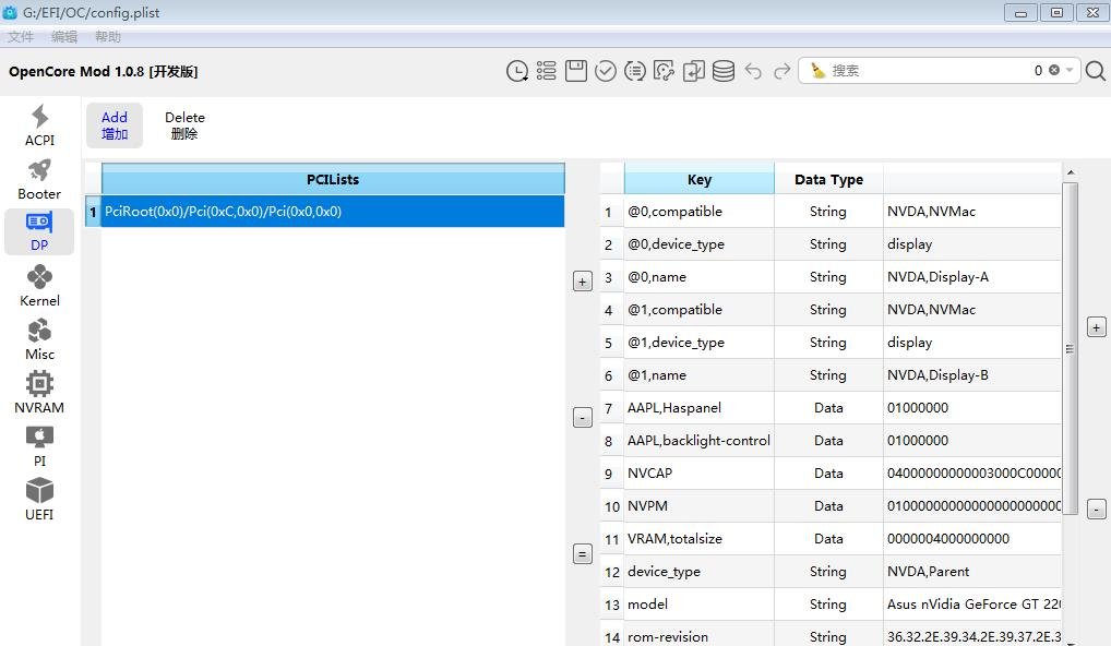

Hello! Can help my laptop repair video card, the ASUS - k40id,graphics GT320M, clover<key>NVidia</key><true/> opencore?
See above said there are two kinds of methods, the SSDT OC DeviceProperties。
C0000. ROM in clover press F6 to extract, vgabios. ROM extracted in the Windows software。
Hackintool exported pcidevices plist。
thank you!
c0000.rom vgabios.rom pcidevices.plist
