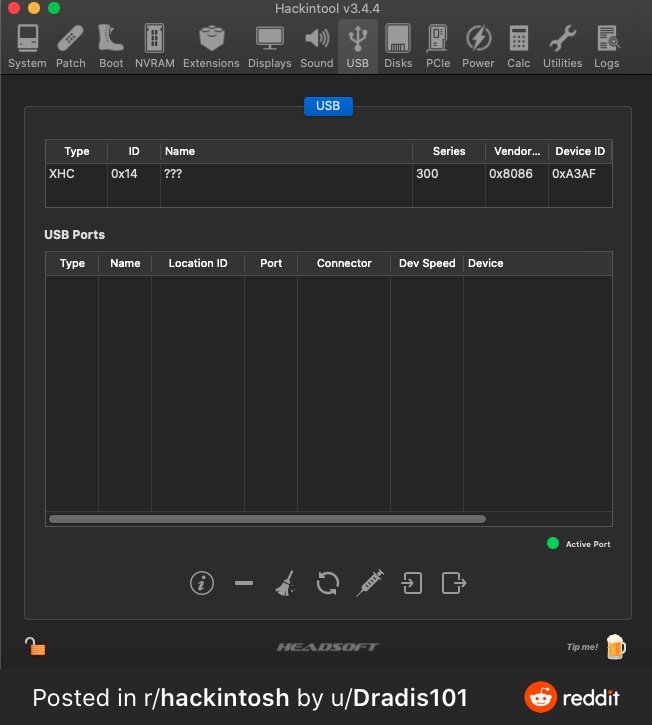

Dradis Posted August 11, 2020 Share Posted August 11, 2020 I finally got my Opencore Hackintosh up and running, but I'm still having trouble with the USB ports. My USB 2.0 Ports work just fine, but my 3.0 ports don't work at all. Absolutely nothing happens when I plug anything into a 3.0 port. I'm trying to follow the guides for mapping USB ports, but one of the first steps is to use Hackintool to identify your ports. Hackintool shows that I have no USB ports at all, not even the ones that work. Btw, a flash drive and my keyboard were plugged into USB 2.0 ports and working at the time this screen shot was taken. USBInjectAll.kext is in use. Kernel > Quirks > XHCIPortLimit is set to TRUE in config.plist. Can anyone please tell me how to make these USB ports work? Thank you. System: Asus Prime B460M-A Intel i5 10400 Intel UHD 630 iGPU Opencore 0.6.0 macOS 10.15.6 Link to comment Share on other sites More sharing options...
Dradis Posted August 11, 2020 Author Share Posted August 11, 2020 well, someone on Reddit gave me the advice I needed. In case anyone else is having the same issue, it was fixed by removing SSDT-RHUB.aml. 1 Link to comment Share on other sites More sharing options...
